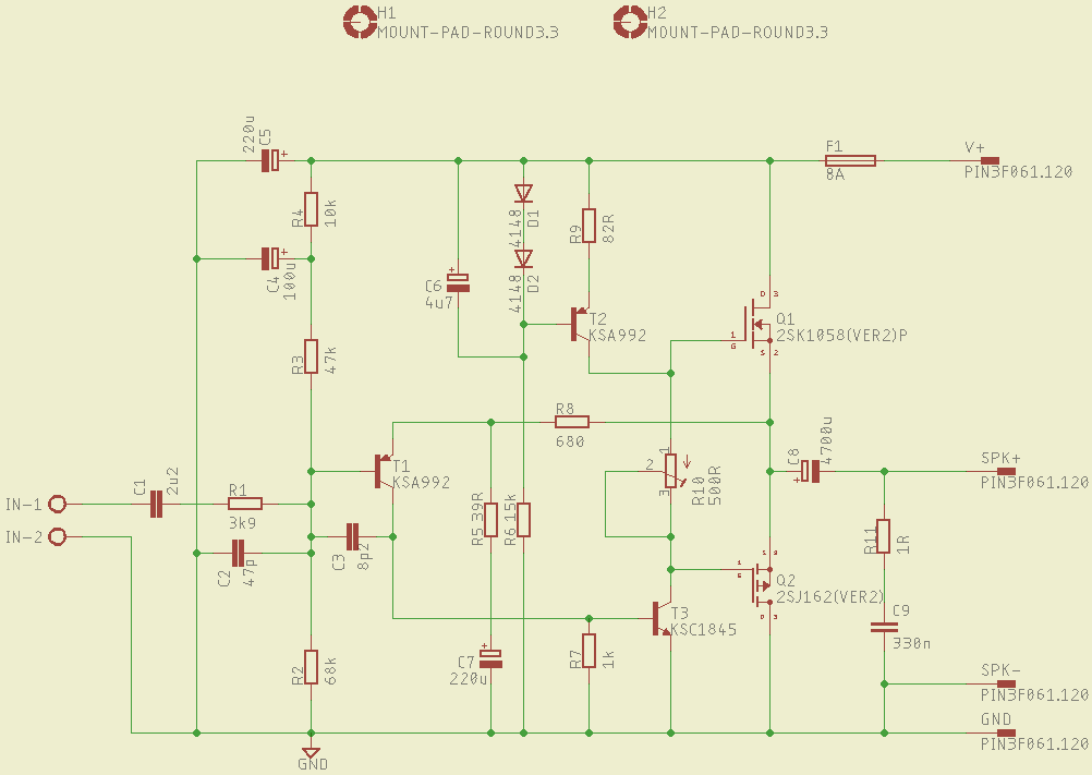

As you should see in my post above, I replaced the 270 k pulll up resistor with something else to make the voltage at the emitter of the input transistor idle about 1/2 the rail voltage. This minimizes 2nd harmonic distortion on large signals if the operating point stays near there.Just having had a close look at the circiutry in #1 again: Shouldn't the voltage divider provide a potential of about half the supply voltage for the first transistor's base?
Best regards!
As I had a very high gain input transistor and needed compatibility with a high impedance PAS2 tube preamp, I also increased the pulldown resistor to achieve about 500k input impedance.
Here is the R.A. Penfold mosfet amp circuit for single supply up to 100v. I have built it and it works. It's similar to the MJR mosfet amp discussed elsewhere on the forum

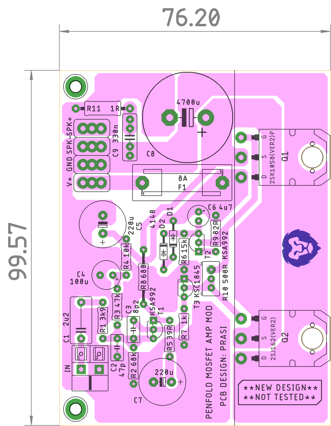

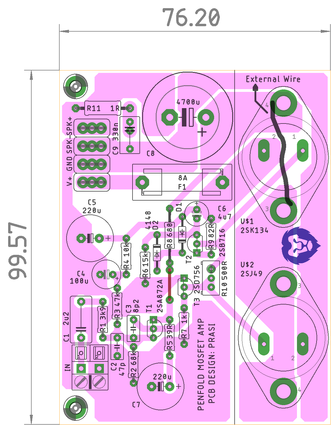

PCB for # 278 . Done quickly, please point errors or ask me to do something differently.
thimios, is this what you are looking for?

Can someone tell, if this amp will work with modern more easily available devices? Just an exercise towards curiosity!.

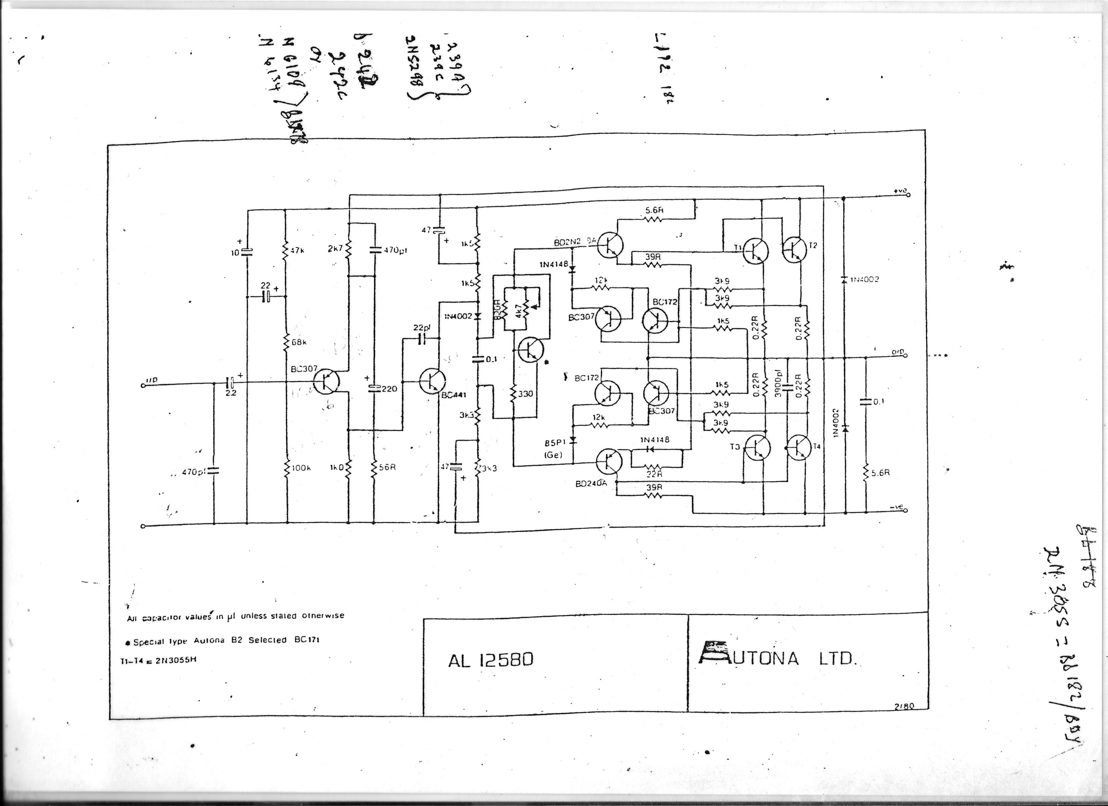

Hi Prasi, like I said I did build the circuit and it did work although I did double up on the fets. I should imagine it would work just as well, if not better with the BUZ series fets or perhaps with a few modifications IRFP240/9240. Personally I did prefer the AL125 it seemed to have more bottom end. It would be great if someone could simulate it in LT spice ( something I am not too familiar with ). I have since found the original article for the AL125 module in the October 1980 copy of Pratical Electronics. As soon as I can scan and post it

, but I must say, its a bit confusing schematic with + and - shown as expressed by anti and also i/p and o/p ground connection not shown.
, but I must say, its a bit confusing schematic with + and - shown as expressed by anti.
Prasi,do not take the effort of a pcb making before someone can post a clear schematic and make sure that is a working amplifier in simulation at least.
"-" is the "power ground". So connect the "-" to the VAS ground and all will be clear fast. Add a 4700uF -or so- output cap and you're good to go. The schem posted here is imho a more "true" one - an opinion based solely on my eyeballing expertise.
Google finds this: Archives: Vintage Audio – The Autona 125 module – Online Parts International
And this: Autona AL125 - Analog Ian
So if you're really into vintage ... imho a good idea would be to cobble up a derated 80W or so version with 4x TIP3055 and a BD139-16 instead of the BC441.
IF you are adamant to follow the autona circuit ...
