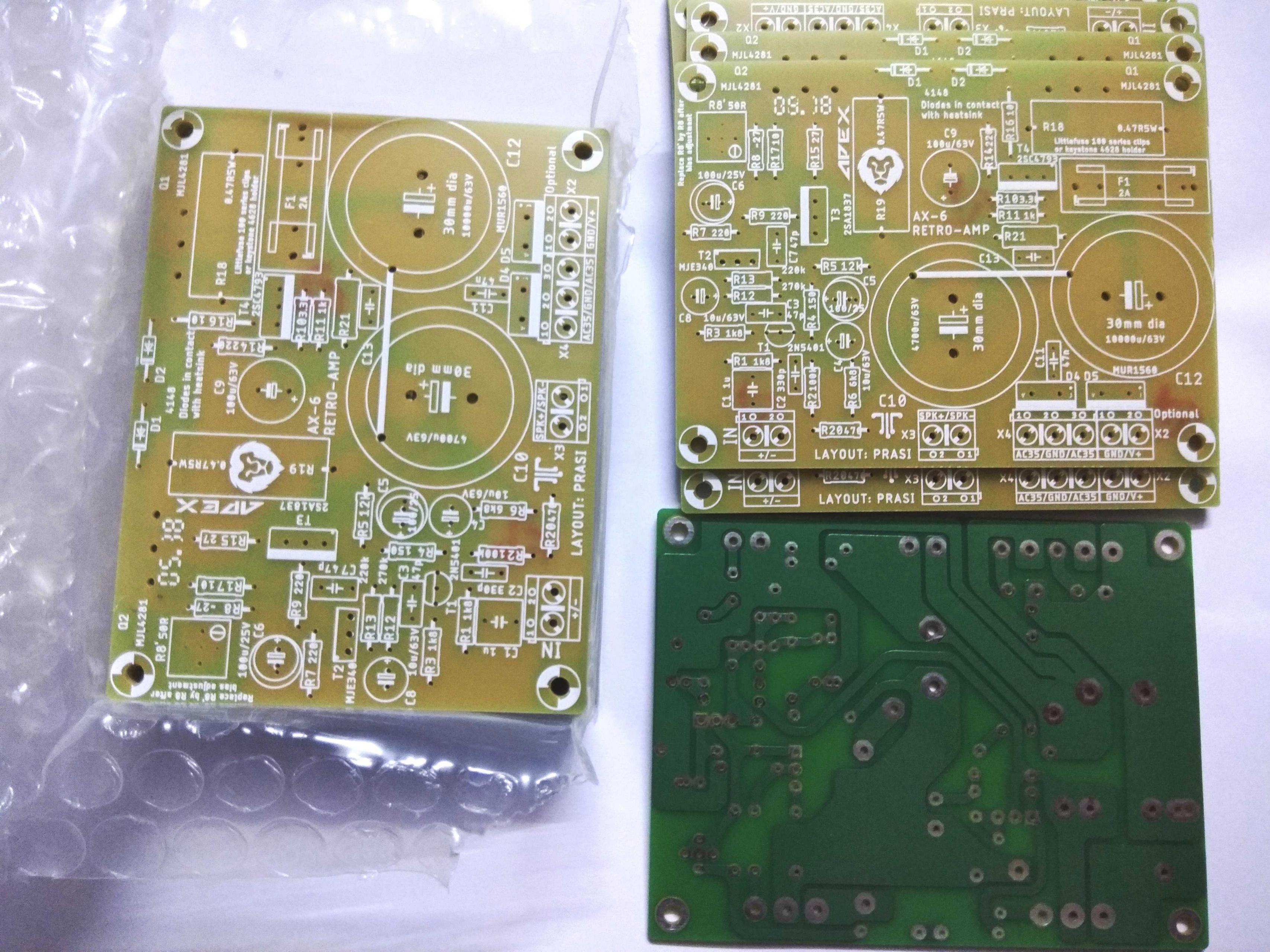

got the pcbs made to spec.70um Cu. ready to ship out.
Pl let me know your paypal via PM along with full postal address. Will send an invoice. For Indian member, it will be bank transfer.
Next step, Mouser BoM for Bix.

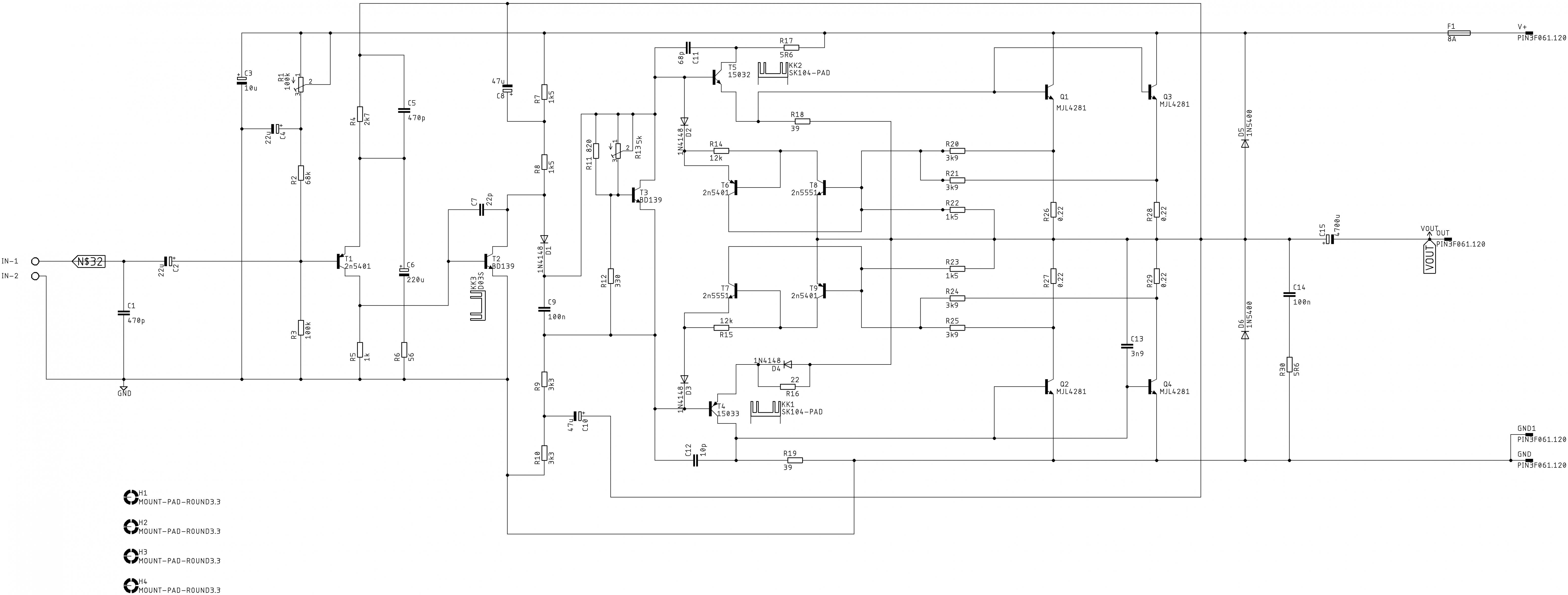

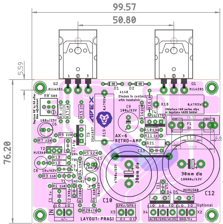

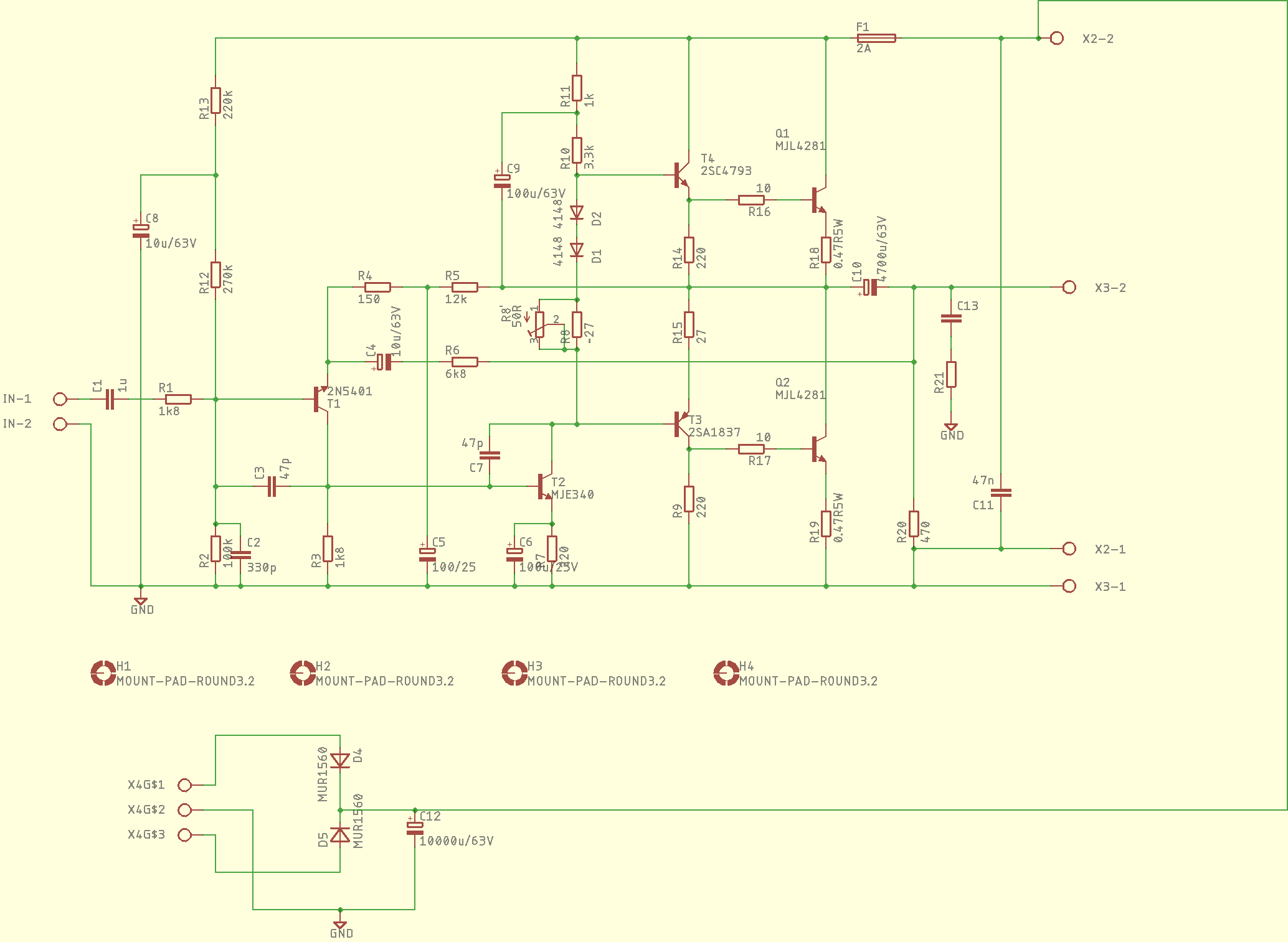

Hello avtech23,
Sorry, here is the schema and layout. Which one are you referring to?
I will try to check this again some time later.
regards
Prasi
I think it was tested by mouna and he decided to keep the apex original schema.
yes indeed. i found original apex design better sounding to me.my only modification was to exclude the two diodes and resistor and add a vbe multiplier with bd139 mounted on same place with output device.
I dont have the amp any more but i will build it again..my only concern is to use 2N3773 or 2SC5200..i dont know which ones would sound better..
