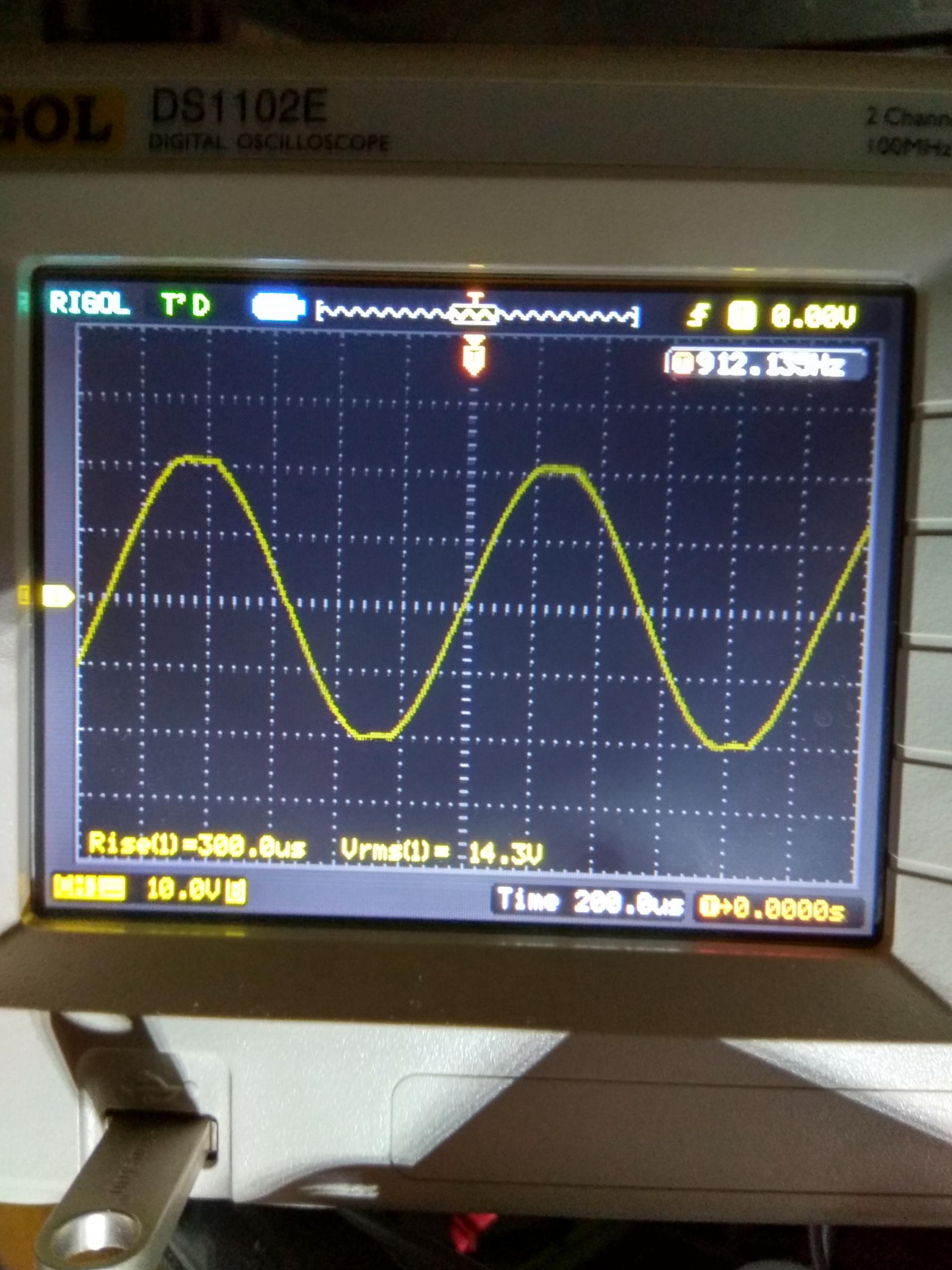

Clear voltage (dummy load 6R)before negative side clip is 13v only when input voltage is 350mV.
The mind point voltage is 23v.

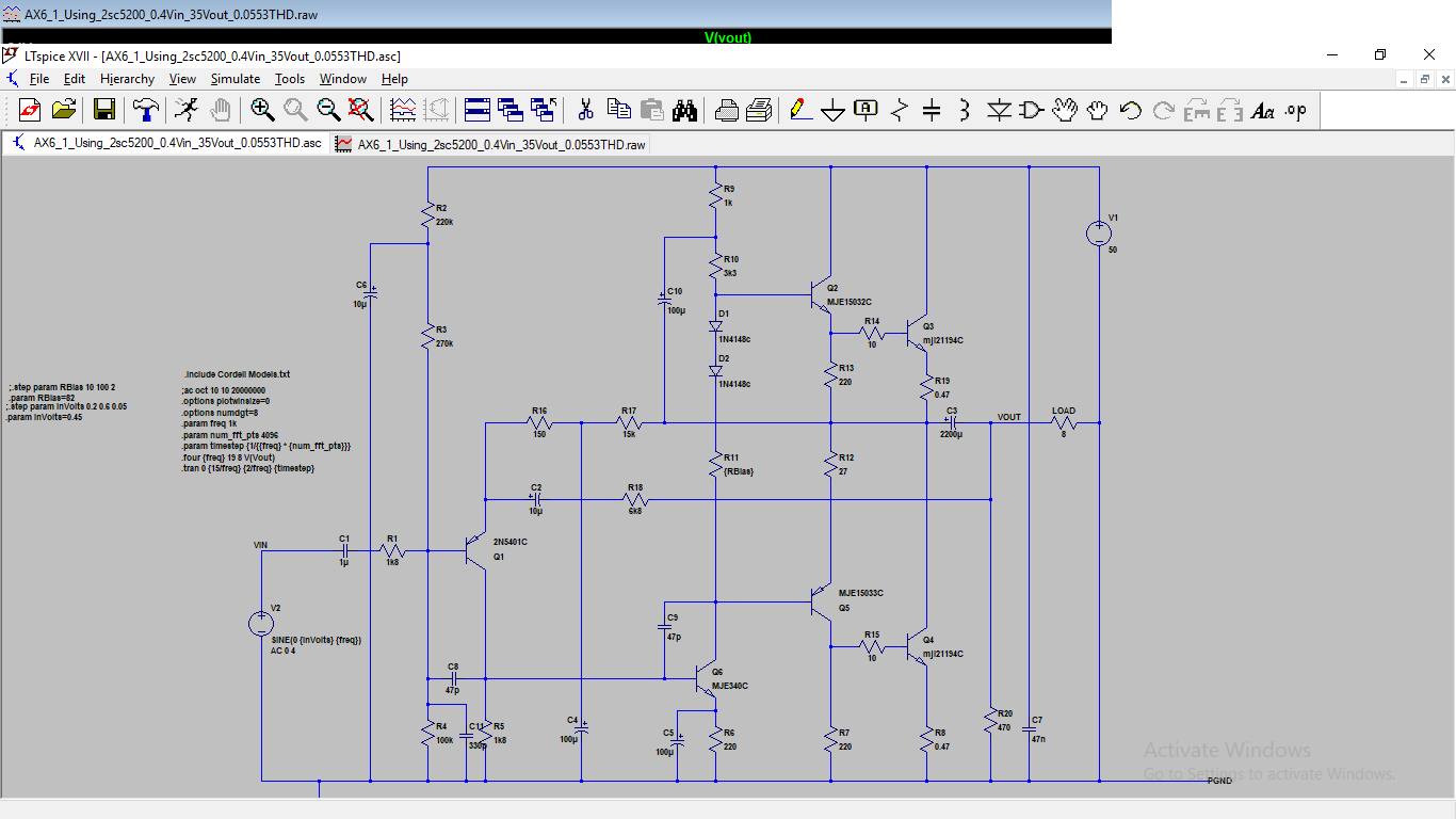

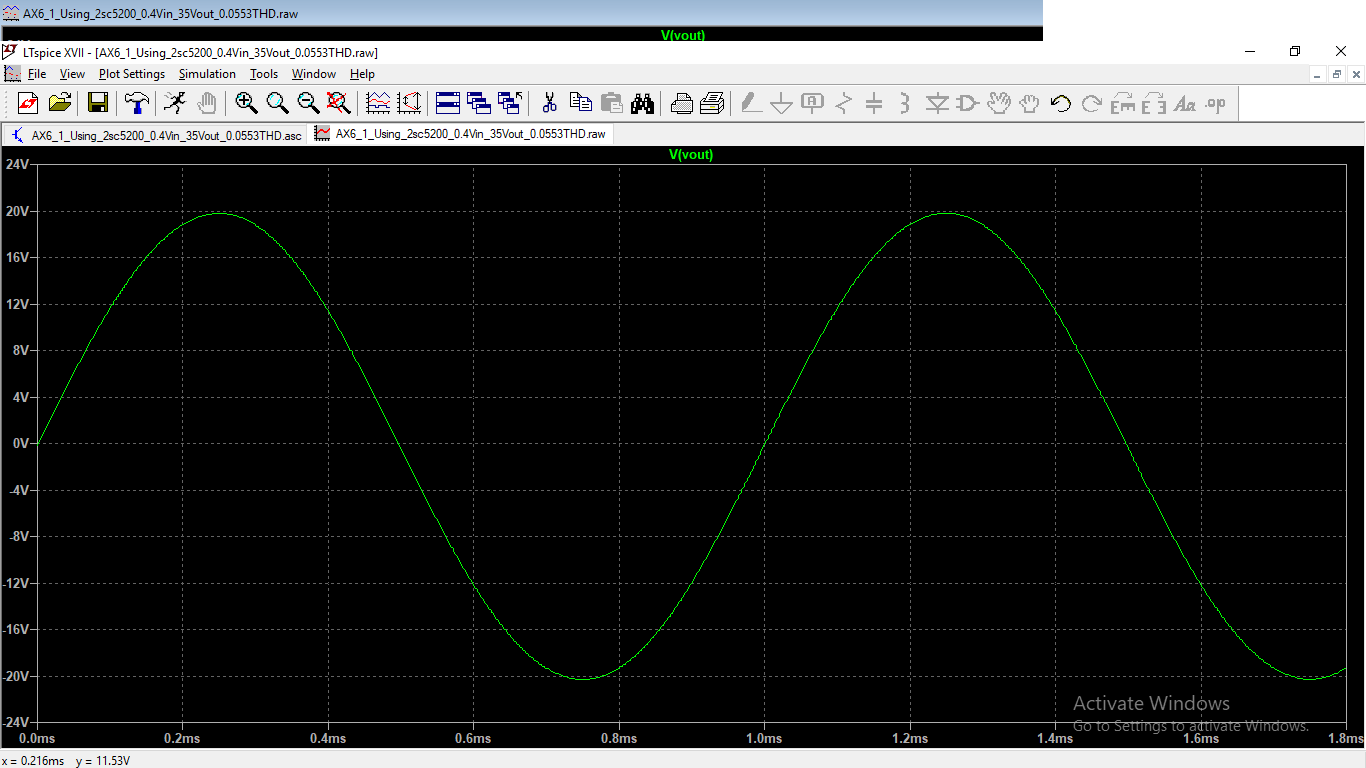

simulation using avtech's file shows
R5 (Pcb) or R17(in sim)= 15k makes both halves of the o/p nearly equal.
whereas 12k makes negative half clip earlier.
Ha ha i have just now put a 50K trimmer in R5 position and adjust for 25V o the mind point(+of the C10) now the clip is symmetrical but still at 14V. When input is 330mV.
What is the output voltage that simulation indicate when clip?
just about 20v with a 50 v supply and 0.45v input. these are peaks.
if you posted rms 14v, then your measurements match perfectly.
20v with a load?
I see 14v on a 6R load when input is 330mV.
Without any load clip is at 15.8V output.when input is 350mV.
please see above edited post. If you are reporting rms values, then your measurments match up with sim. So amp will give 25W/8R, and in your case its giving 32W/6R.
It is as per spec. sorry for the confusion.
Aha BINGO!!! 😎please see above edited post. If you are reporting rms values, then your measurments match up with sim. So amp will give 25W/8R, and in your case its giving 32W/6R.
Simulation and real life in agreement!
yes! perfect match of sim and actual, I have become a bit wiser with LT spice with this little exercise, thanks to avtech and you.... . please tell us what is the final trimmed R5 value you have presently.

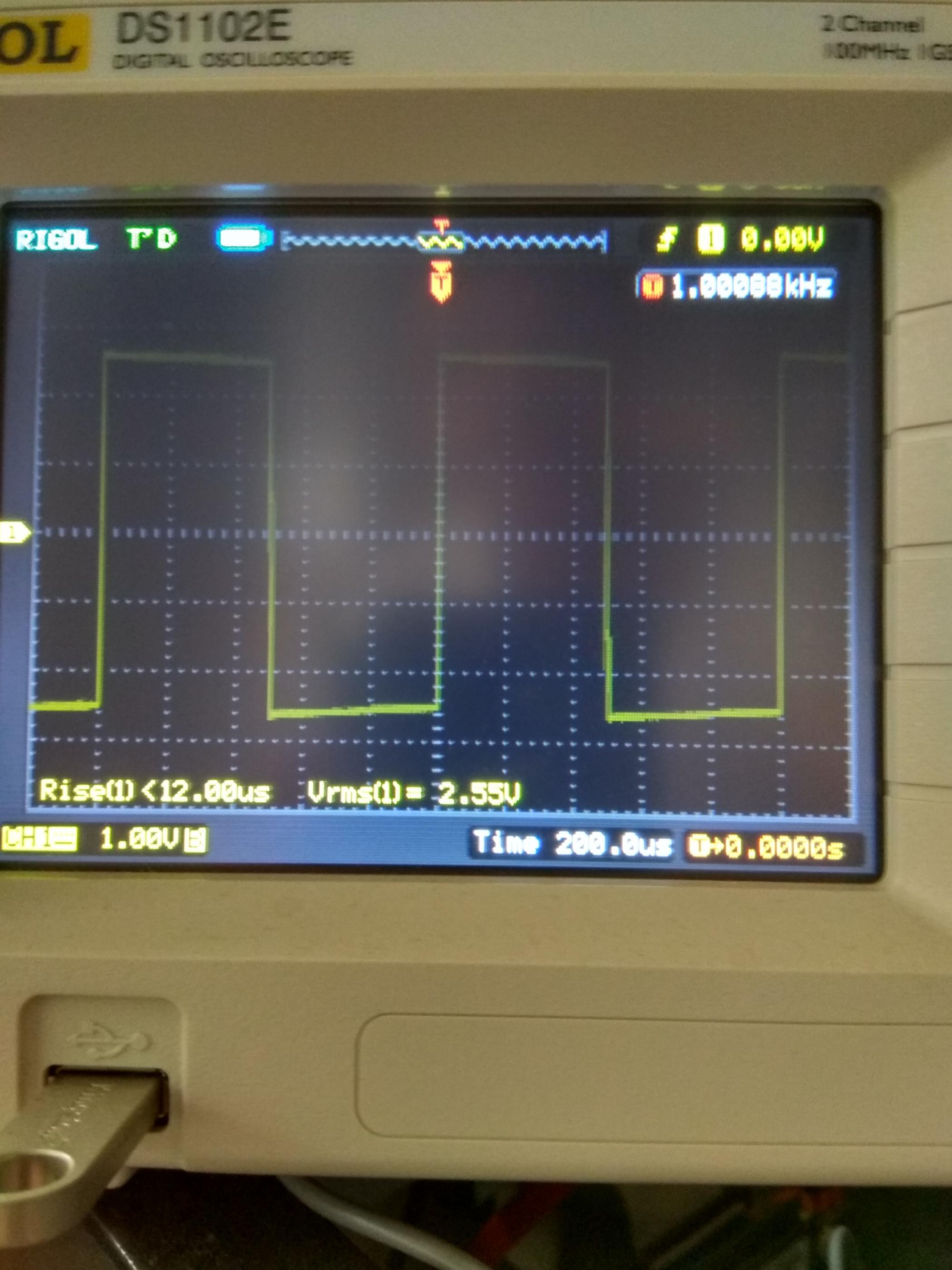

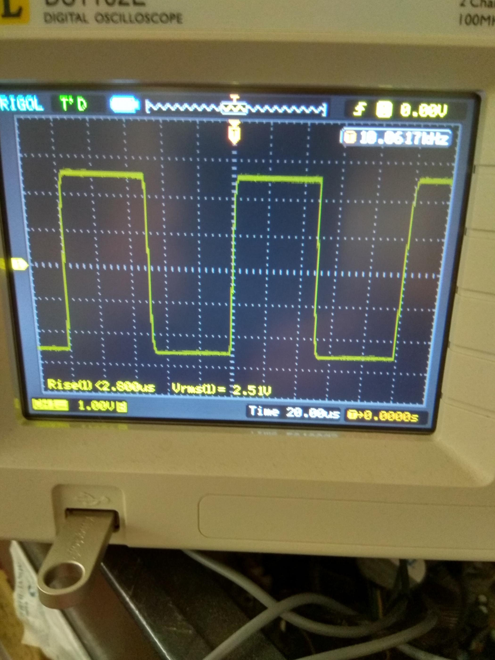

Crossover distortion visible.
This start to disappear at 14mA bias setting.

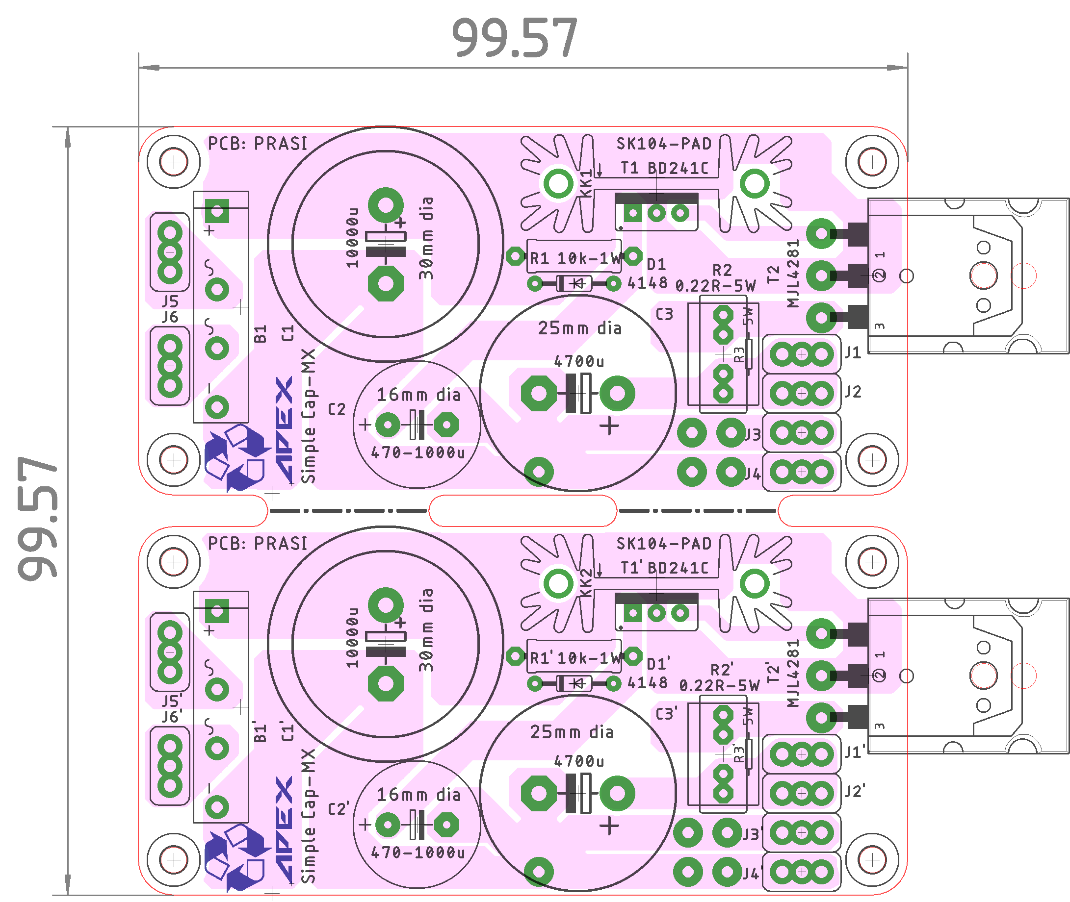

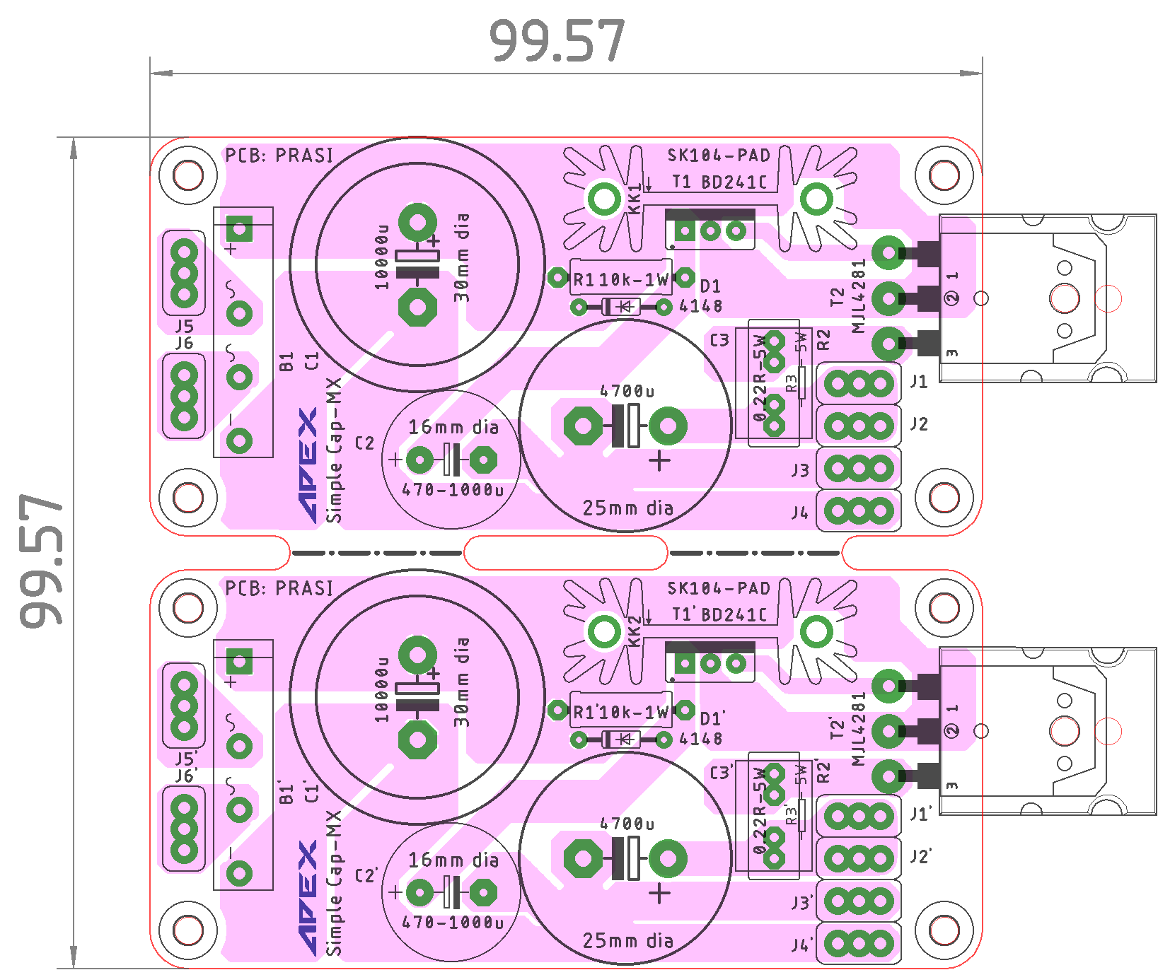

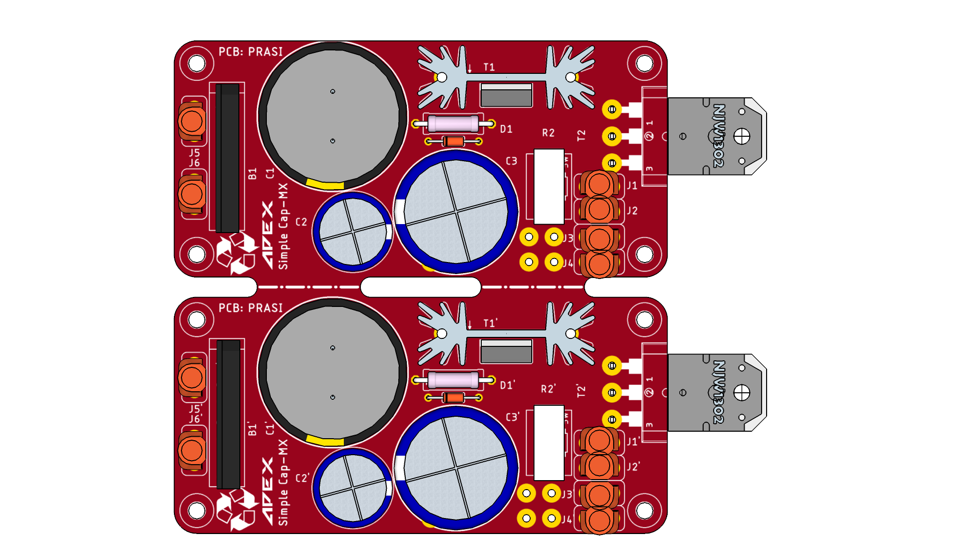

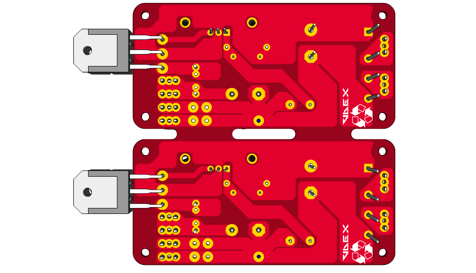

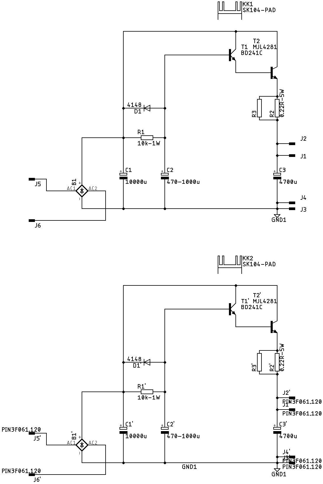

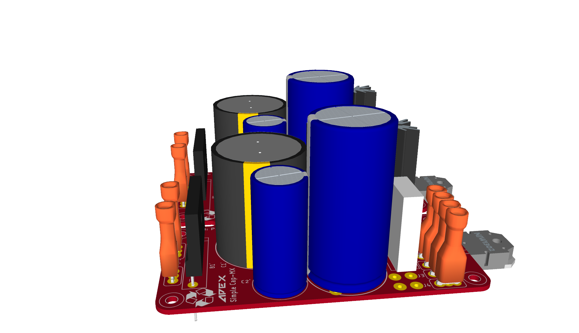

sch, stuffing guide, Diy pdfs and gerbers for the apex simple cap mx. untested.
regards
Prasi
regards
Prasi

Spice file
I found some spare time to clean up the sim files.
Attached is a relabelled spice file that reflects the most recent schematic in terms of component designators. This should alleviate confusion between the sim and the schematic when refering to specific components.
This version has the output silicon that I am currently working on, so change these devices to match whatever you are using.
I am using a .step command for voltage input to find the clipping point as well as one set up for RBias to help with finding appropriate values. Set these to ;.step and reactivate the .param with your desired values once you have identified them.
Just for your viewing pleasure, I have also uploaded another version with gain set to around 25 and (I think) global feedback altered via R6. This drops the simulated THD from around 0.055 to 0.027.
This was done by reducing the 6k8 R6 to 3k6:
Gain = 1+(R6/R4) = 1+(3600/150) = 25.
