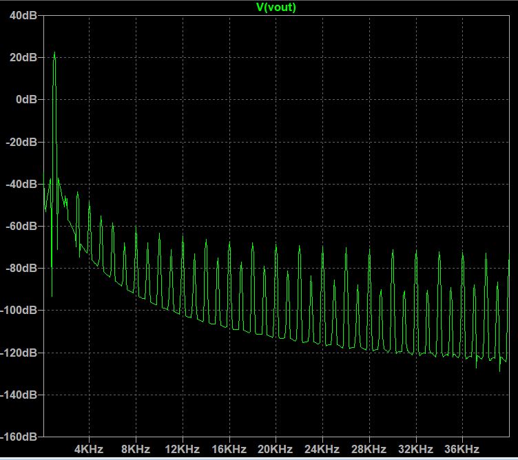

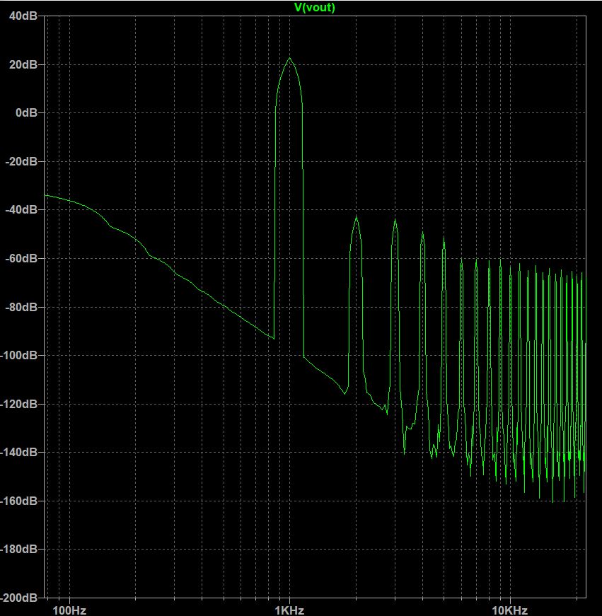

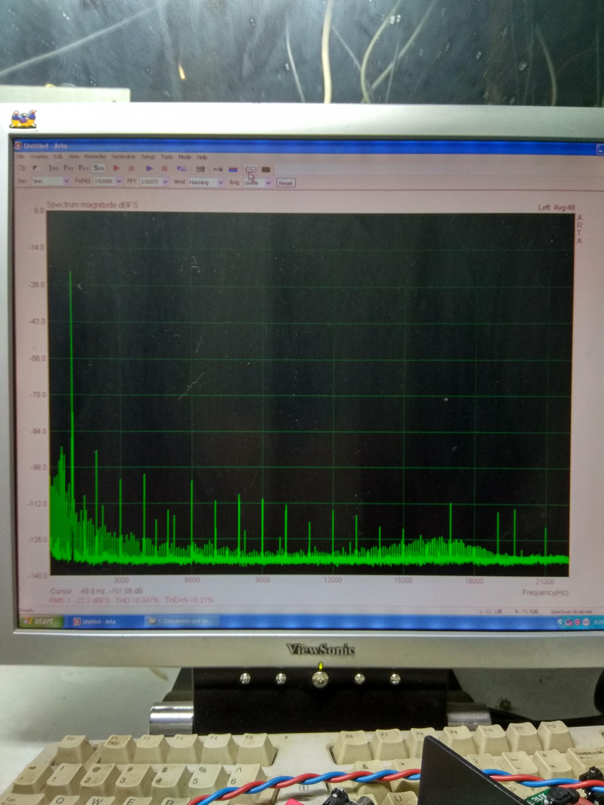

Crossover distortion visible.
This start to disappear at 14mA bias setting.
Very nice, so anywhere between 20 to 50 mA should be good to go, depending on one's wish.
Thanks for posting this.
I found some spare time to clean up the sim files.
Attached is a relabelled spice file that reflects the most recent schematic in terms of component designators. This should alleviate confusion between the sim and the schematic when refering to specific components.
This version has the output silicon that I am currently working on, so change these devices to match whatever you are using.
I am using a .step command for voltage input to find the clipping point as well as one set up for RBias to help with finding appropriate values. Set these to ;.step and reactivate the .param with your desired values once you have identified them.
Just for your viewing pleasure, I have also uploaded another version with gain set to around 25 and (I think) global feedback altered via R6. This drops the simulated THD from around 0.055 to 0.027.
This was done by reducing the 6k8 R6 to 3k6:
Gain = 1+(R6/R4) = 1+(3600/150) = 25.

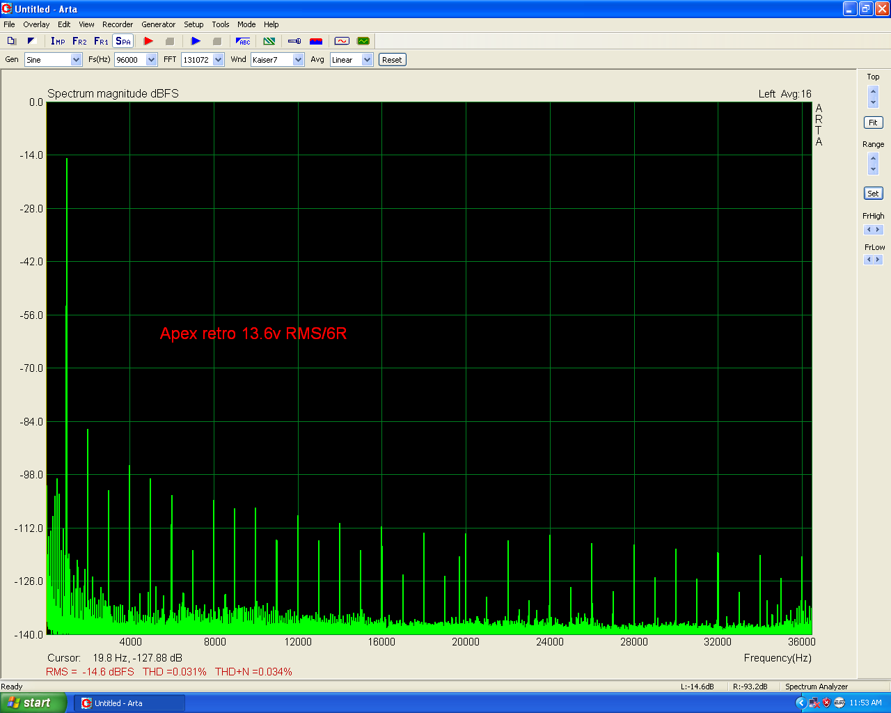

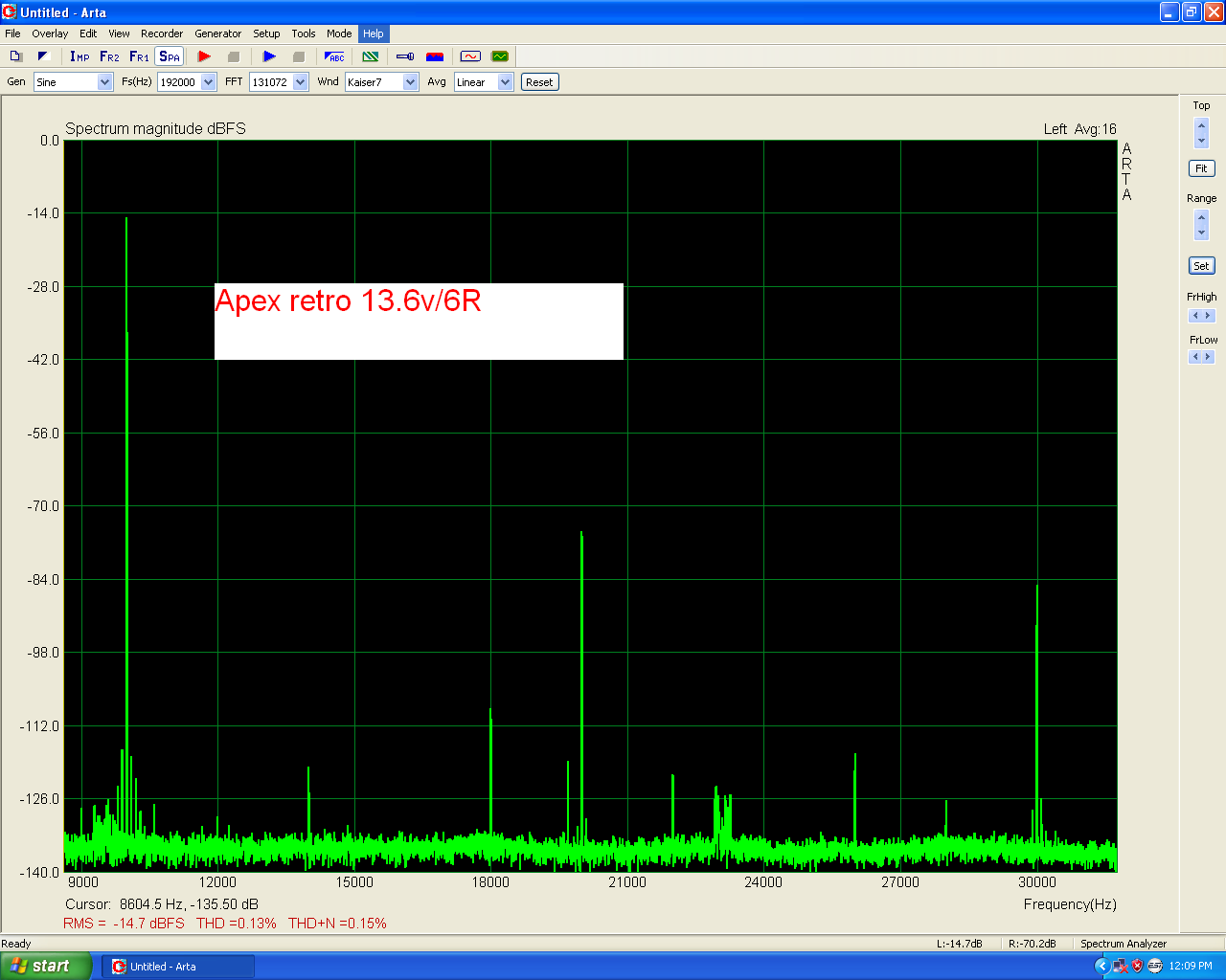

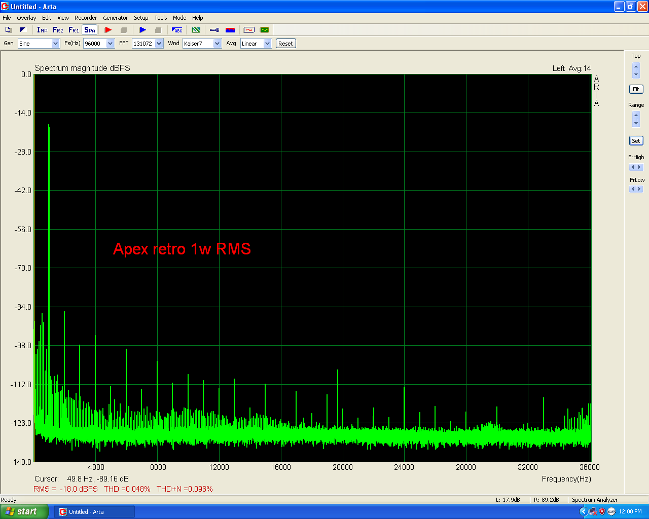

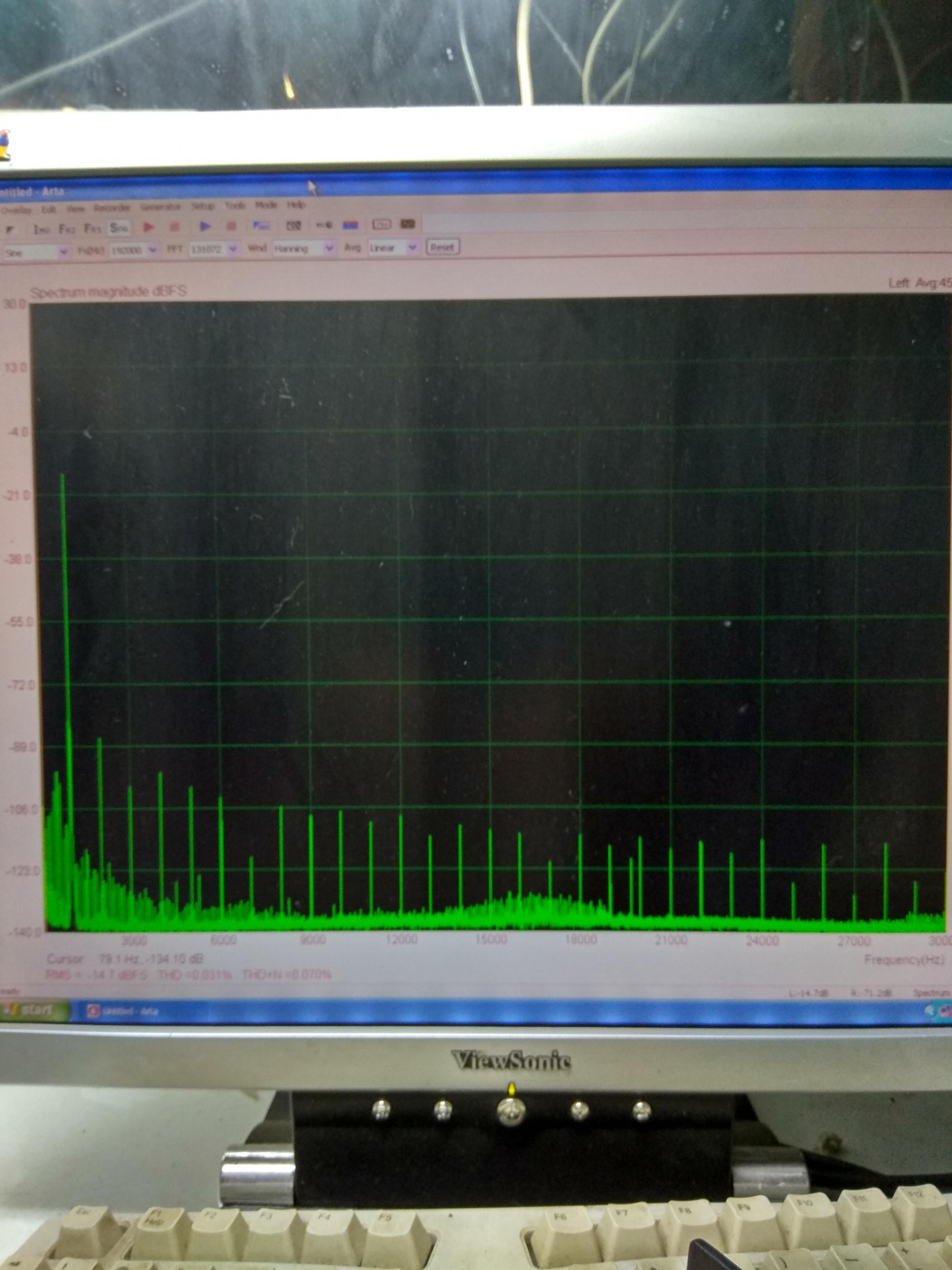

Looks quite different. I may be doing something wrong. I use the Hann window when doing FFT and reduce the scale to the audible range usually. But I have played around and can't get similar results to what you have measured.
Your 13.6v, is that RMS? If it is, then 13.6*1.414 = 19.23v peak into 6 ohms which is very close to the 19.38 the simulator came up with.
Is your bias resistor (R8) set at 33R? And do you have 6.8k for R6?

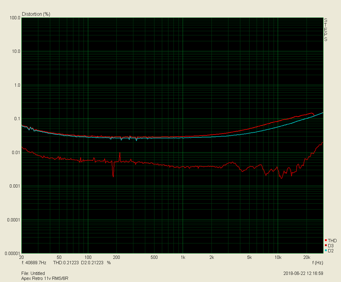

It is at 13.6V RMS/6R
No, R8 is a 220R multiturn trimmer.ADJUSTED for 10mv/0.47R.
R15=10R+15=25R.
Sim gives: 19.26v (13.62v RMS) which agrees with what you got. THD doesn't agree but there could be many reasons for that.
R8 will be in the region of 57 ohm to get 10mV (~21mA bias).
Using Kaiser7, linear Hz scale to emulate your ARTA screenshots, I get the attached FFT. I've not used the K7 before and it gives different results to the Hann or Blackman windows that I tend to use.

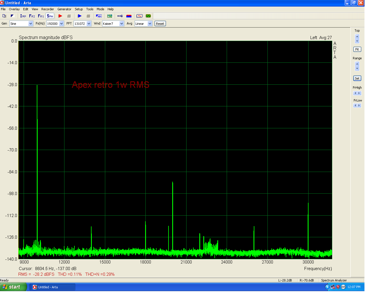

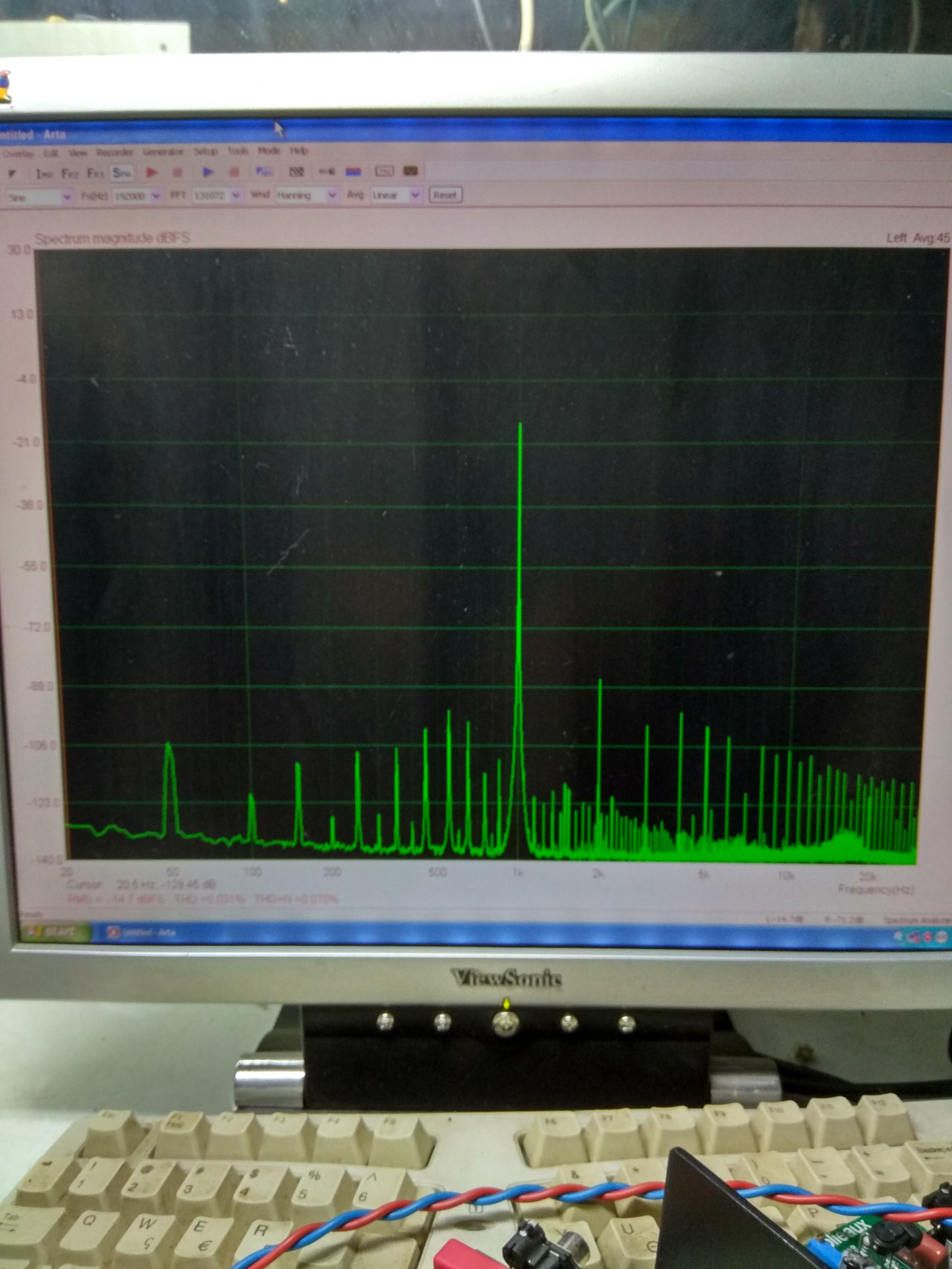

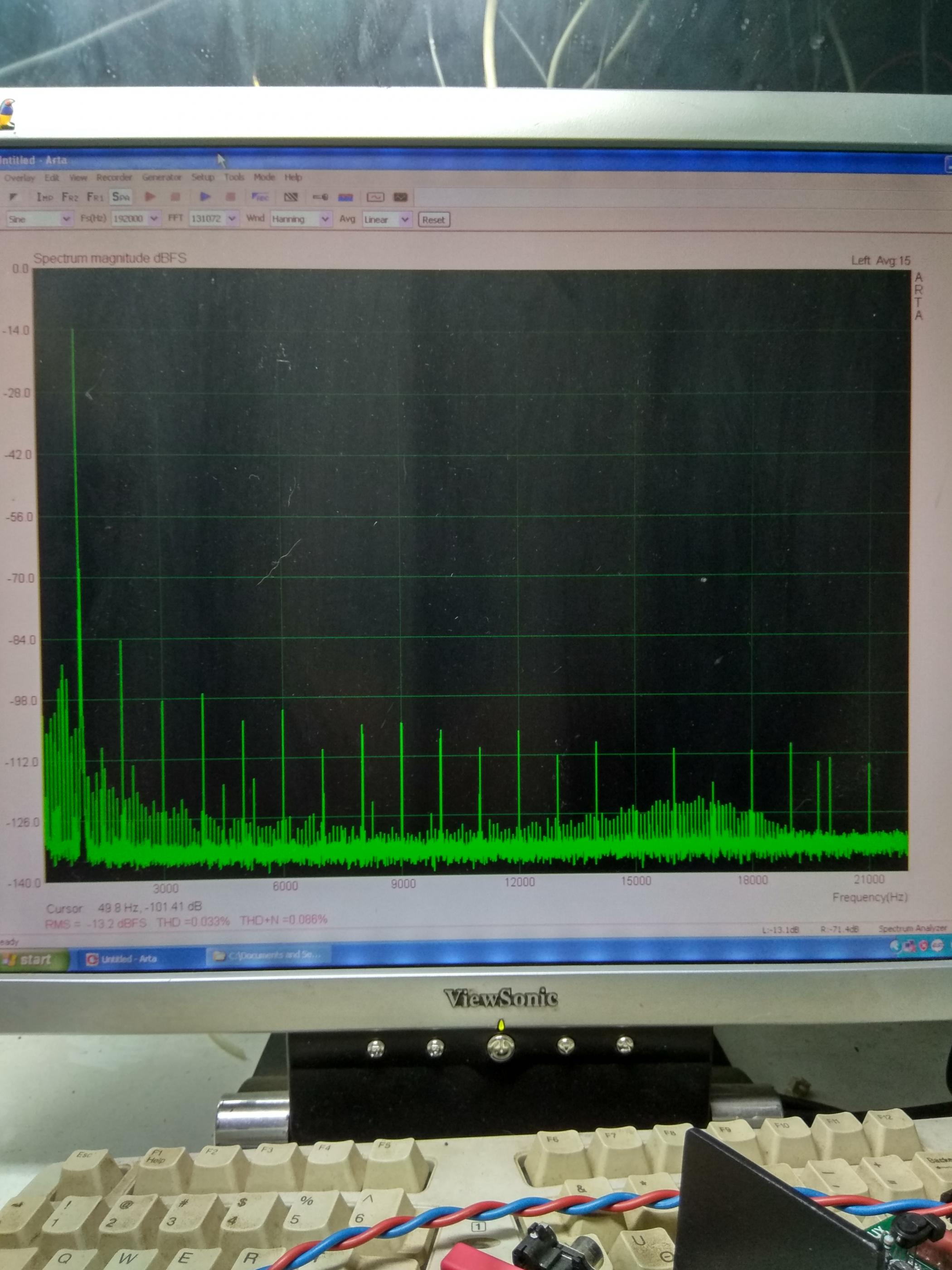

Hanning 1w RMS/6R.
Hanning 13.6v RMS/6R.

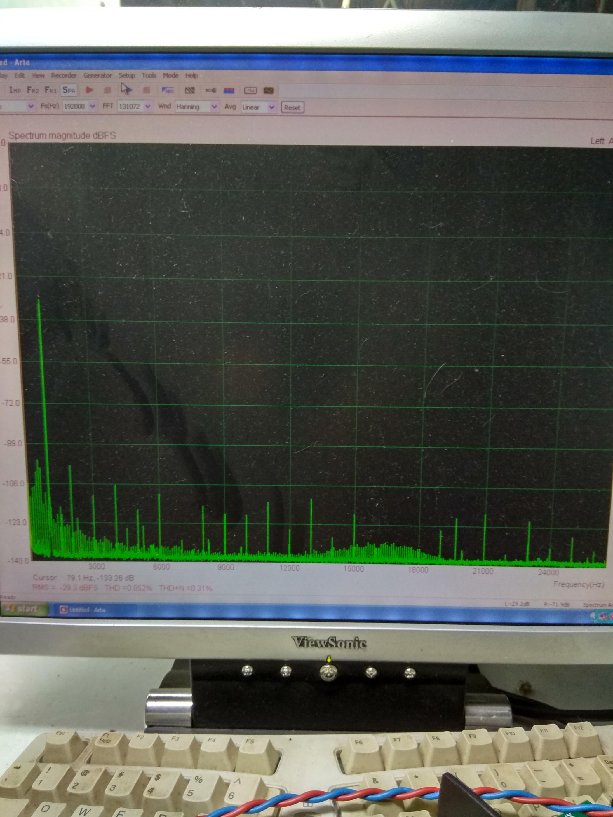

Last photo 2.8v RMS on a real 6ohm speaker.

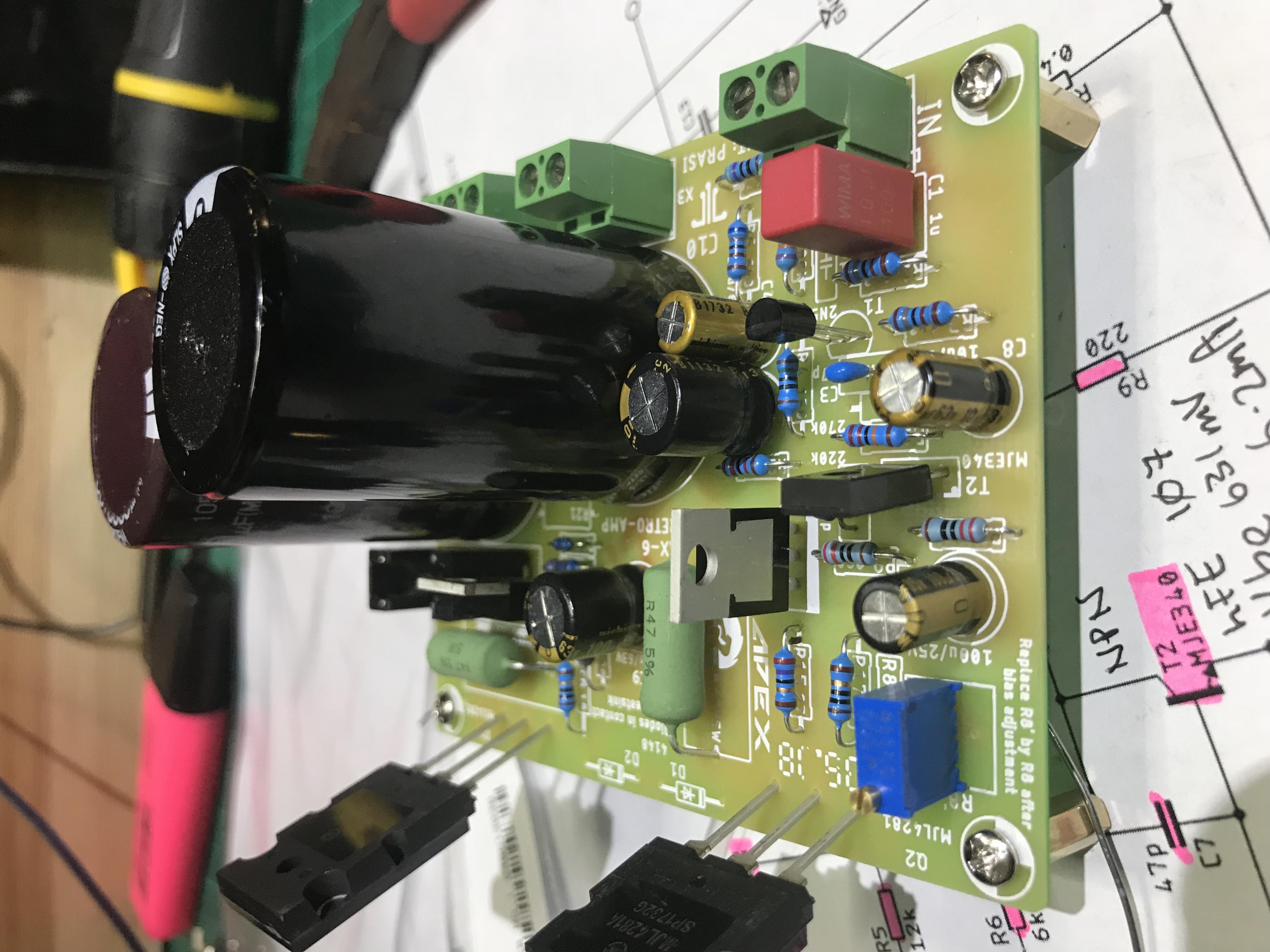

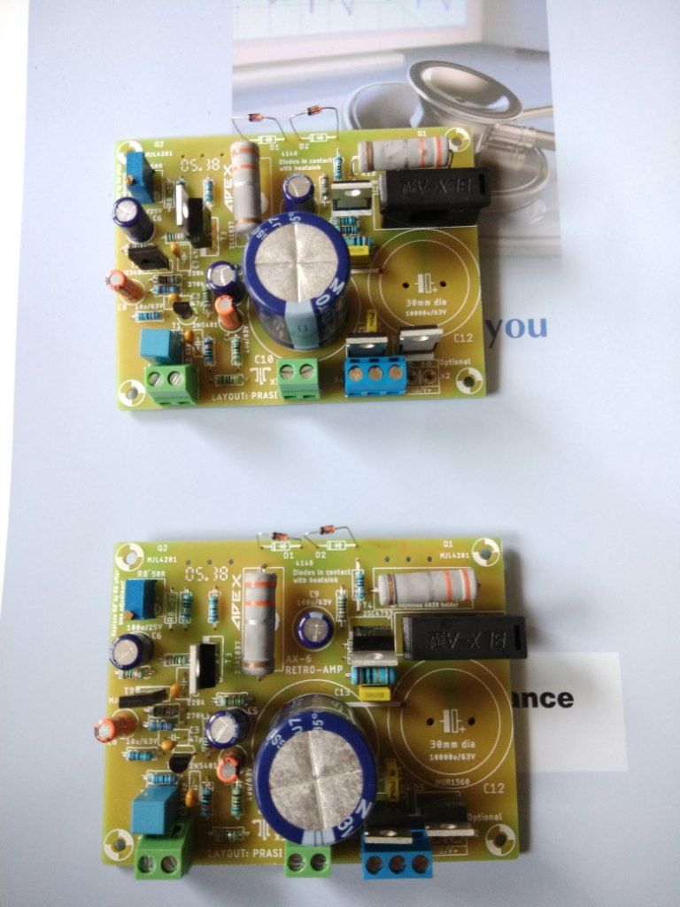

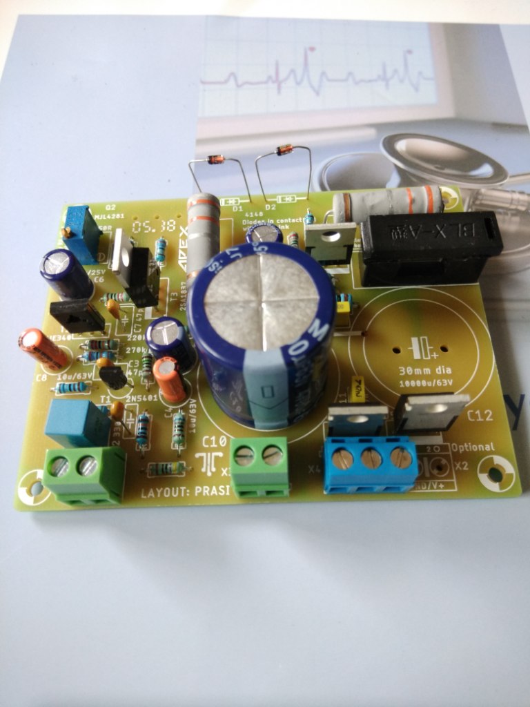

slowly but surely, only missing PS cap and o/p transistors (going to use MJL21194.)
Diodes have long legs so they can be stuck to heatsink with kapton tape like pingrs suggested.
Jumper is on btm, like thimios.
I have a 100ohm trimmer in R8' position and no R8. R5 value is 15k.
Drivers are MJE15032/33.
Other than that it follows silk more or less
regards
Prasi
regards
Prasi
Prasi,well done!Bias in my board is absolutely rock stable with one diode inside a hole, just use heat shrink tube for insulation.slowly but surely, only missing PS cap and o/p transistors (going to use MJL21194.)
Other than that it follows silk more or less.
R3
regards
Prasi
R5 is the d. c feedback resistor and affect the gain. Make sure that amplifier will be stable.
