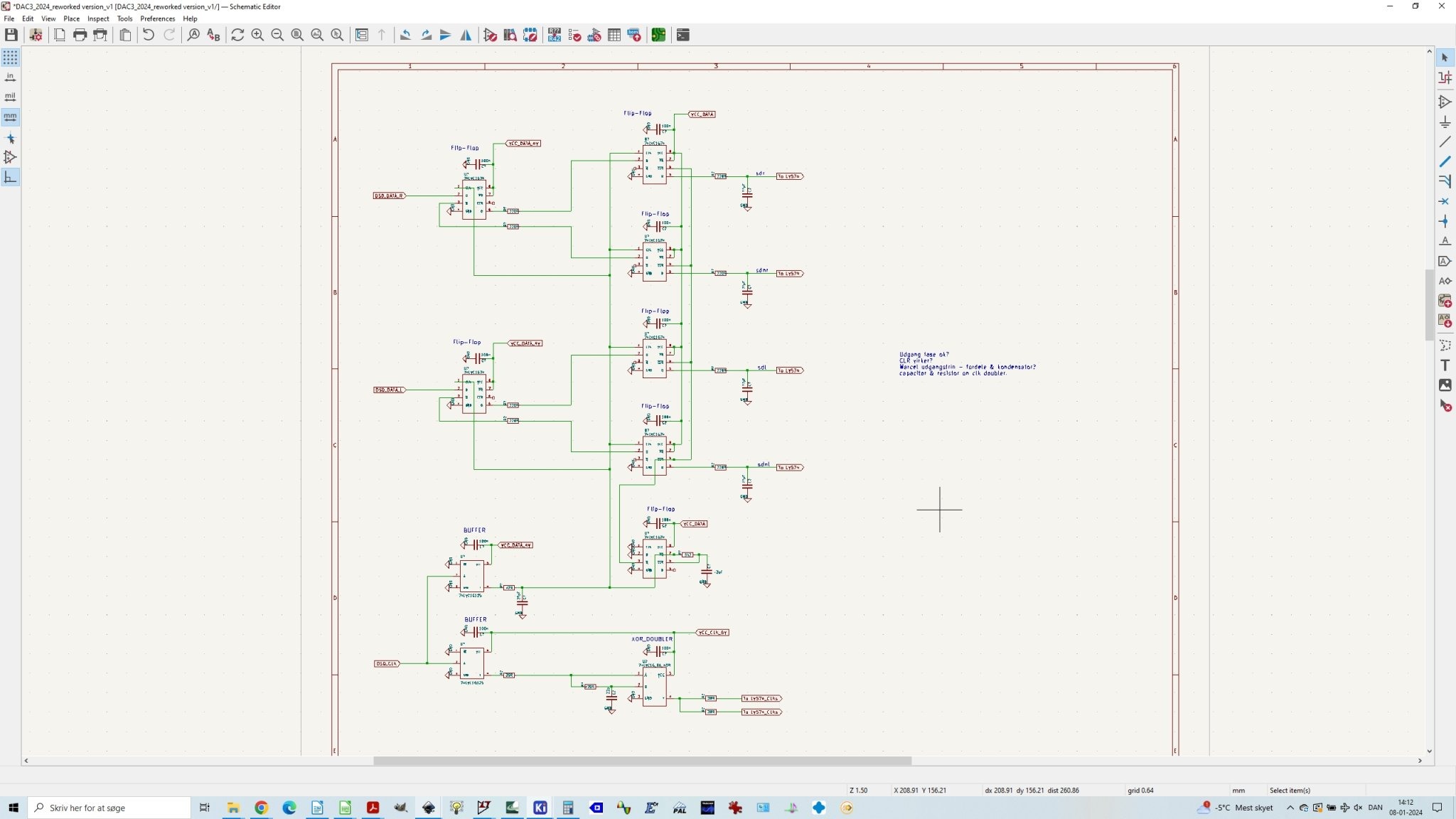

Hi all,
I remain inspired by Marcel's RTZ FIRDAC and thus have been considering ways to possibly/hopefully optimize the clock path to the LV574 output FFs. I have also been wondering how the output stage works ...
About the RTZ functionality:
Currently with Marcel's reference design, the XOR clock doubler (U28A) signal is guided both to the output FFs (the LV574s) and to the right-most row of FFs (U22, U24, U26, U27) handling the data going to these LV574s. In an attempt to reduce the load and trace spread of the XOR clock doubler I have considered alternate approaches and have come up with the attached schematic.
It is supposed to work with e.g. something like JLSounds' USB card where the DSD_CLK is quite precise and consistent over time, i.e. situated in the middle of the DSD_DATA streams. I have also attempted to keep the DSD_DATA phase structure of Marcel's DAC.
My guess is that the attached design would work up to (and maybe higher than) DSD512, however, there might be one caveat which is the reason for this post (please note that the attached schematic screendump is a bit tiny as it couldn't be fit on my screen in a more feasible way. So I have also attached a .pdf file of the schematic).

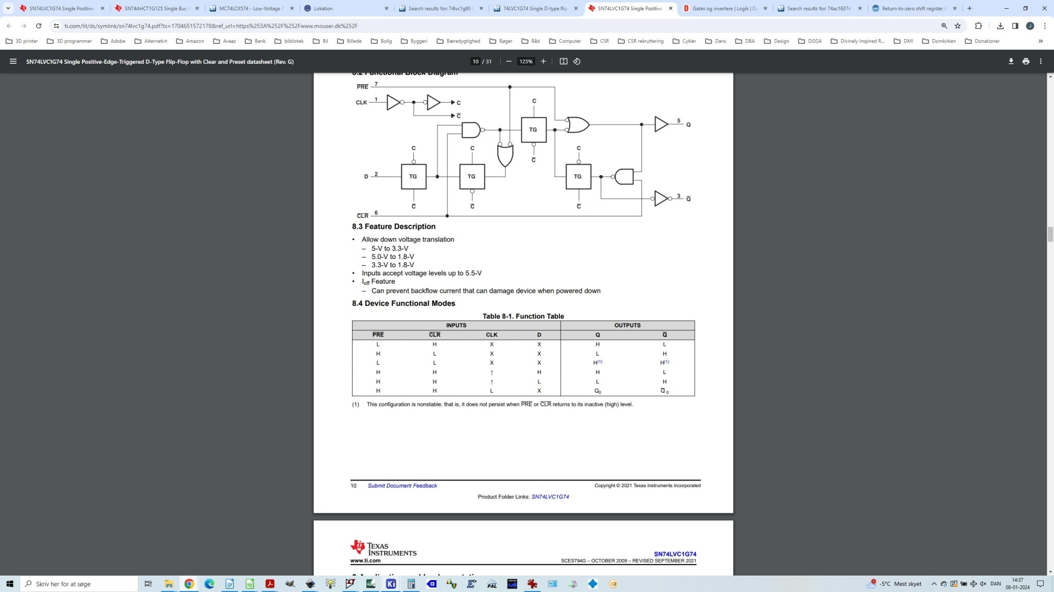

The caveat might be the functionality of the FF handling the RTZ of the DSD DATA stream (the lower-most FF just above the XOR doubler, functional table attached). Here I use the preset & clear functionality of this lower-most LVC1G74 to clear the outputs of the DSD_DATA FFs every time the incoming DSD_CLK goes "low". That is: when the DSD_CLK goes low, _PR on the lower-most FF goes low a couple of ns later which causes a "0" on its Qnot output. This in turn "sets" a "0" on the Q outputs of all of the FFs handling the data to the LV574 output FFs. This is intended ... So far, so good.
Following this, however, the lower-most FF's _CLR is also pulled to "0" which causes both of this FF's outputs to go "high". This is also fine - maybe except for this double-"high" state not being stable. Thus, when the DSD_CLK again goes "high", according to the datasheet it will first pull _PR to "high" (this will leave Qnot on "high" as per the datasheet). When both _PR and _CLR are returned to "high" this lower-most FF is not again able to react to a clock pulse - except that both its data and clock input are grounded.
Now, the caveat to this design might be that although according to the data sheet it should work I do not know if this lower-most FF when going through this cycle may exhibit some kind of "unforeseen behavior". Might one of you know about this? Does it seem plausible that it will work?
BTW the various non-VCC capacitors are to be inserted in case adjustment of the timing is needed.
