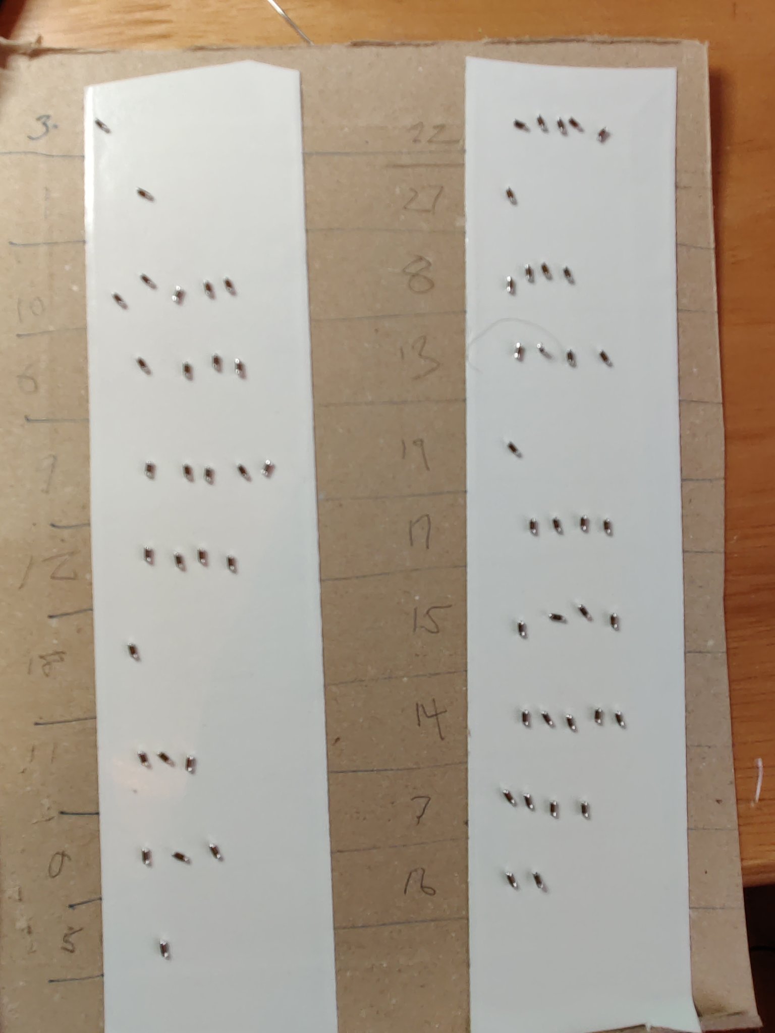

Well, I have made the same alteration in my 2nd DAC unit and compared with the A/B switch and I can now say with certainty that (to my ears) the 2 DACs are indistinguishable. This is good since it proves that the effect the resistor change had was reproducible and consistent.
I now have a test-bed to test further alterations on one and compare again.
What I don't know is whether the change in spacial definition and tone was due to the resistors themselves or the fact that they are now far more closely matched. The obvious way to test that would be to buy an excess of the Susumo RR types and match them up in the same way and swap them out in one DAC. I am just not sure I care enough though to put myself through that. lol.

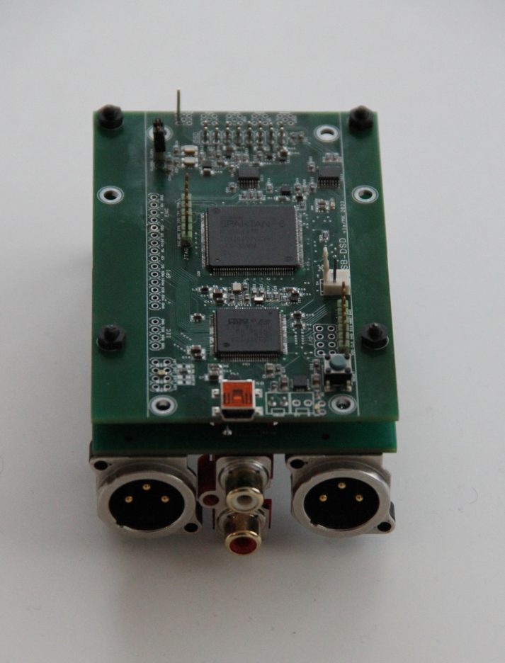

I decided to integrate my STM32F7 USB-I2S board with PCM2DSD to have RTZ dac with PCM input.
RTZ board and the USB-DSD board have same form factor and can be connected directly with pin header or if needed with MMCX for DSD + MCK. The USB-DSD board is quite versatile as in addition to isolated DSD it has isolated I2C and GPIOs for connecting to e.g. AKM or ESS dacs. It has NZ2520SDA clocks but can also use external clocks instead via MMCX. It also supports displays and encoders.

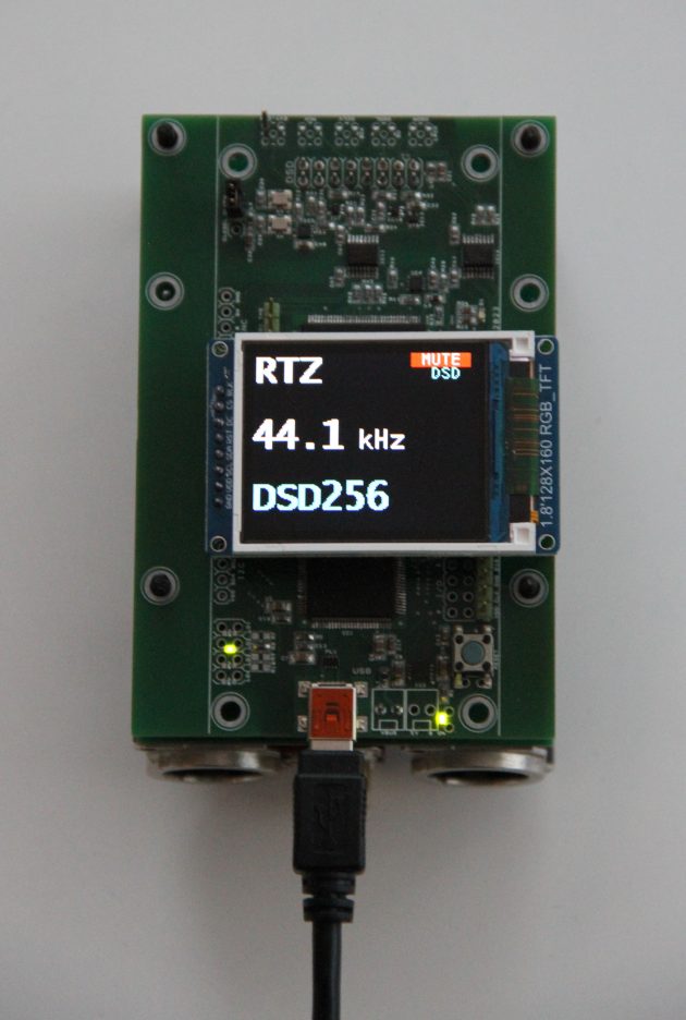

Here with a 128x160 IPS display:
Admittedly encoder or display is not very useful for RTZ dac as it does not have volume control or any settings. But with AKM or ESS dacs encoder and display are definitely needed.

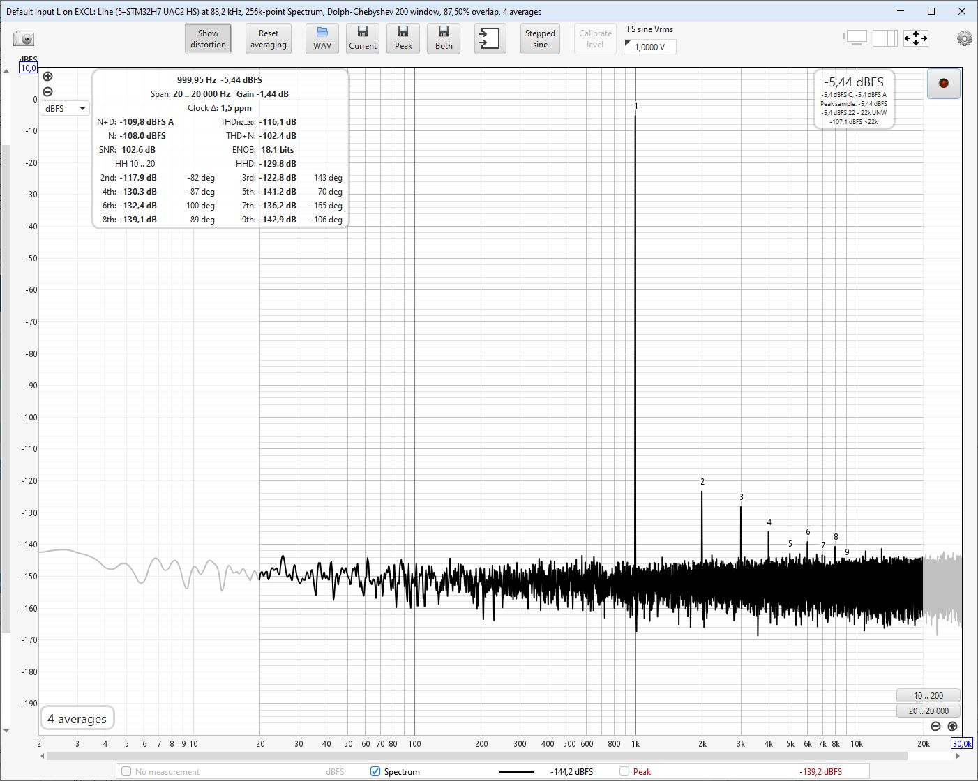

I had some issues running the "latest" pcm2dsd firmware as it did not work properly for 44k1 sample rate (or multiples). I need to check that further. I'm currently using the firmware by @xx3stksm (https://www.diyaudio.com/community/threads/simple-dsd-modulator-for-dsc2.370177/post-6671447) as it runs without any hickups.
Here is 1k -4bFS @88k2:
My plan is to fit the dac, display and PSU ("SilentSwitcher") in a 160x100mm Hammond 1455 box. I just need to make a front panel board for the display and encoder.
