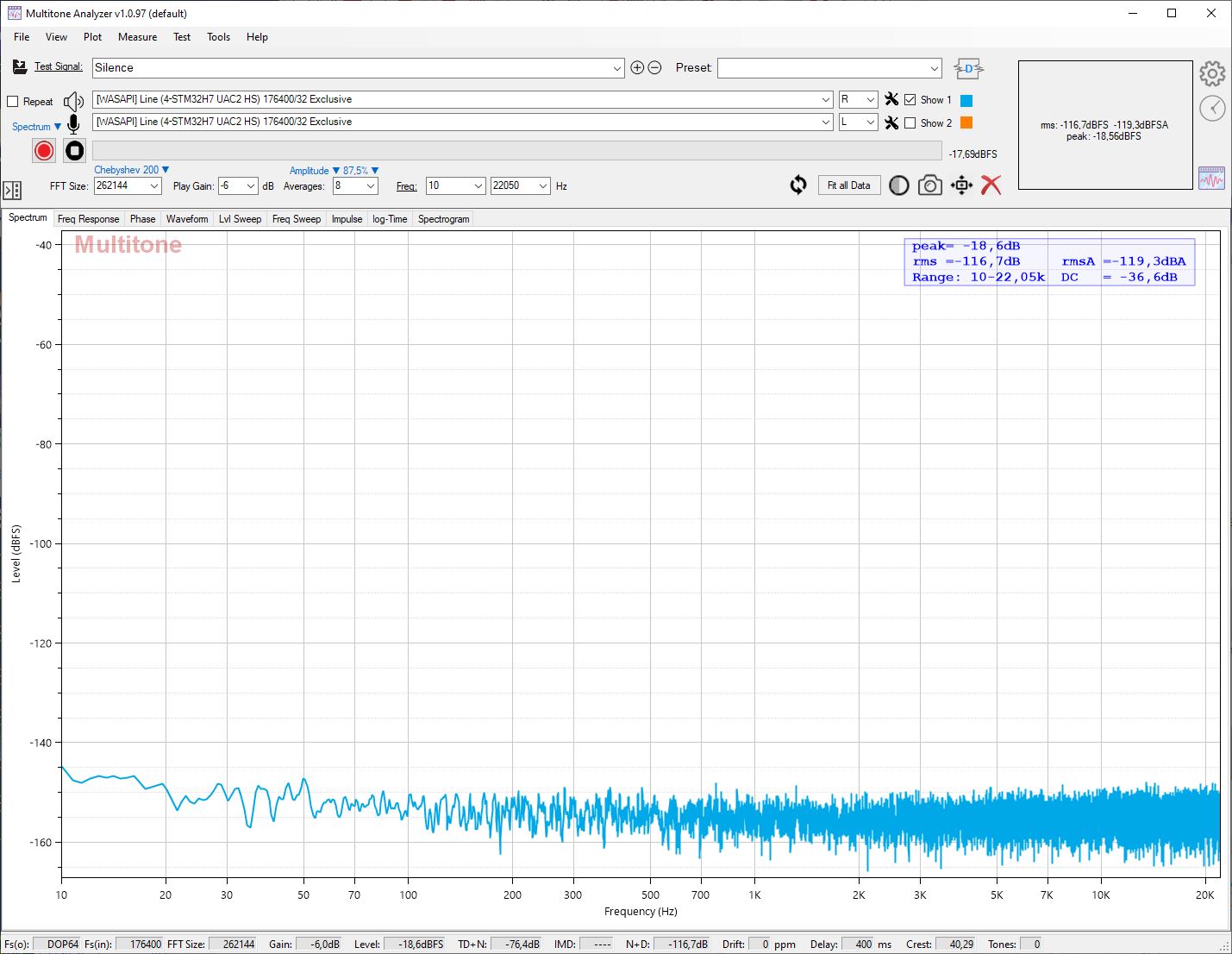

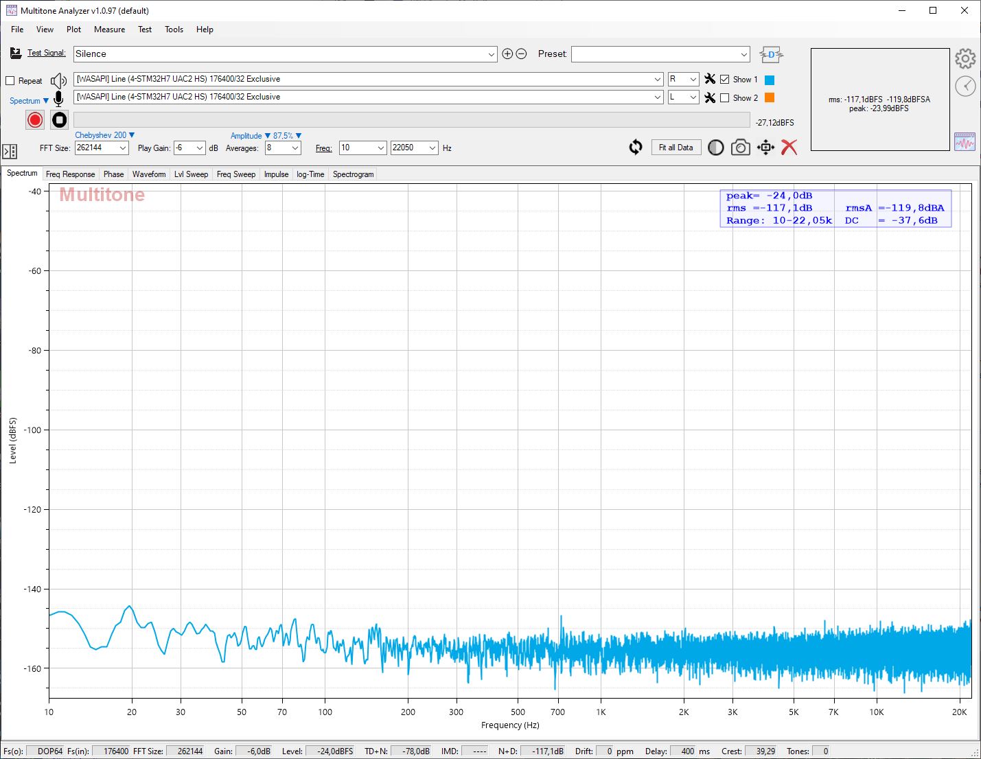

The measured noise floor with 270 ohm resistors for the data lines is between -105.96 dB(A) and -109.29 dB(A), depending on whether the data cable passed through a ferrite ring and on the precise measuring method. I previously got -104.59 dB(A) with 39 ohm resistors, so I think it's safe to conclude that the hold time fix doesn't worsen the noise floor.

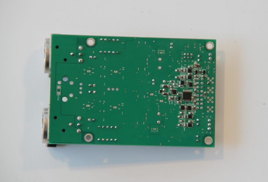

I made another layout of RTZ as my original layout had slight imbalance between channels (higher noise in other channel). I suspected this was due to layout as digital section was not placed symmetrically in relation to channels.
Here are pictures of the new board. I placed the digital section on bottom side, not to have lower noise but mainly for layout symmetricity. This also allowed me to make the board even smaller than the previous (now 67x100mm). Another change was to add a DCLK reclocker (2 flip flops) which also meant that MCK input is needed.
While my aim was to have more balance between channels the performance actually improved also.

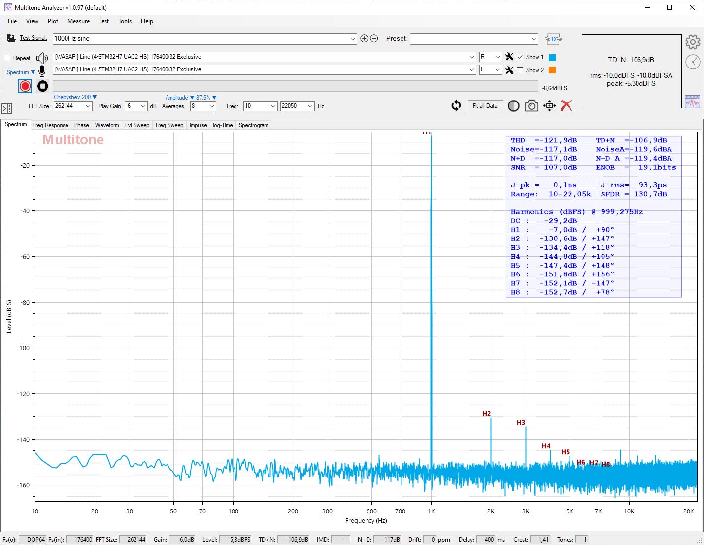

Here is SNR at DoP64:
So A-weighted noise improved by about 2.5 dB.

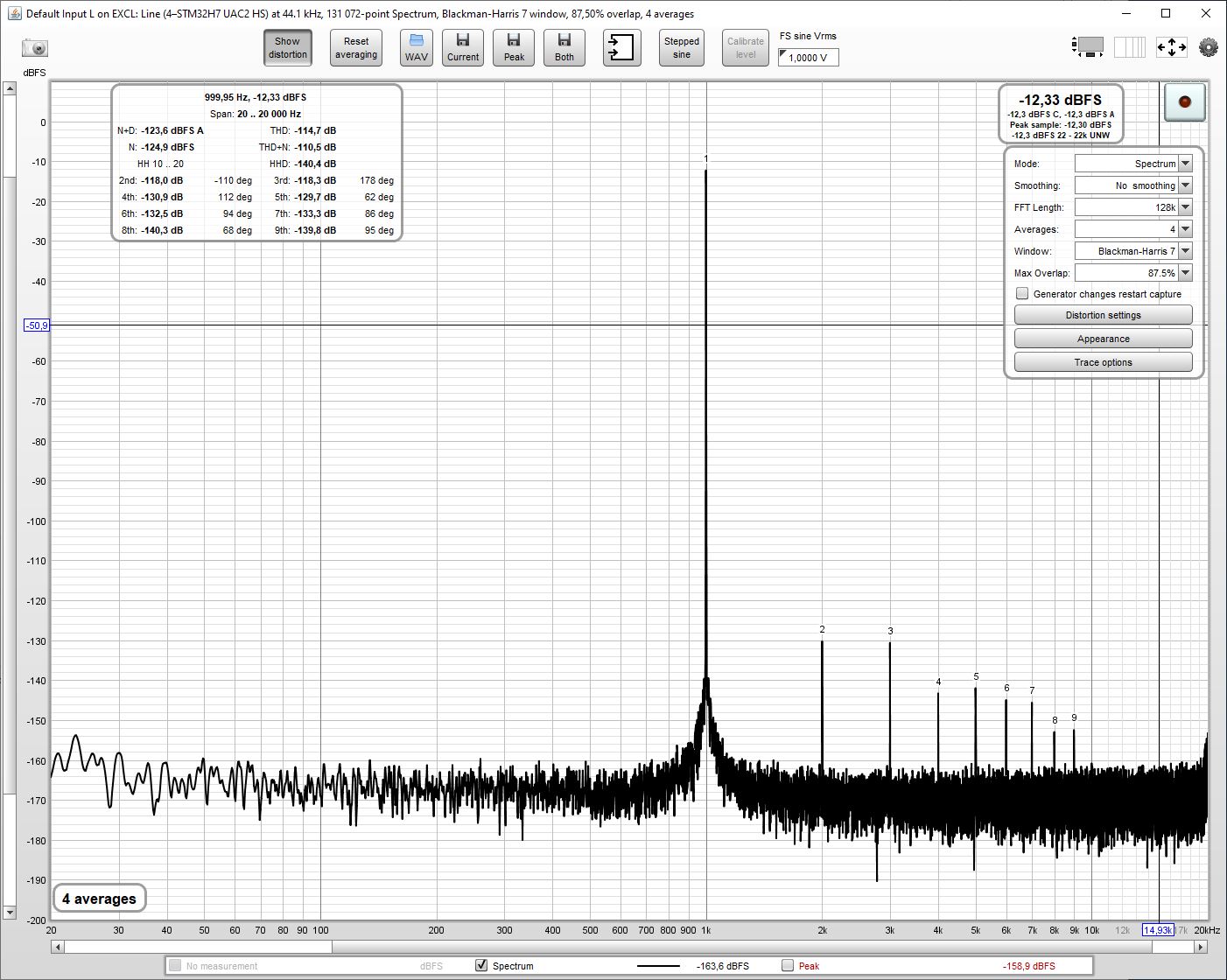

Here is 1kHz at Dop64:
Reactions: 3 users

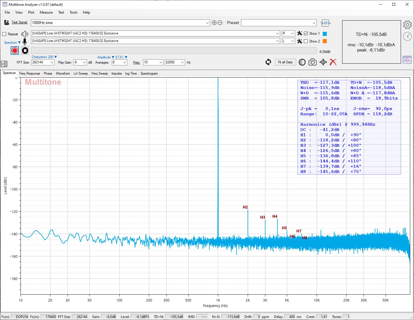

As some have already noted soundwise this dac is very good and especially the soundstage seems to be a strong point. But to not get too carried away with subjective superlatives I did some level matched AB testing against my ES9038Q2M (dual mono) and ES9039Q2M dacs using DSD128 as input. ESS dacs were used in sync mode. As usual with more control the differences became very small. On most recordings I could not hear any real difference. However on certain recordings RTZ dac seemed to have slightly wider soundstage. Whether or not that is better depends on subjective preferences.
Reactions: 1 user
