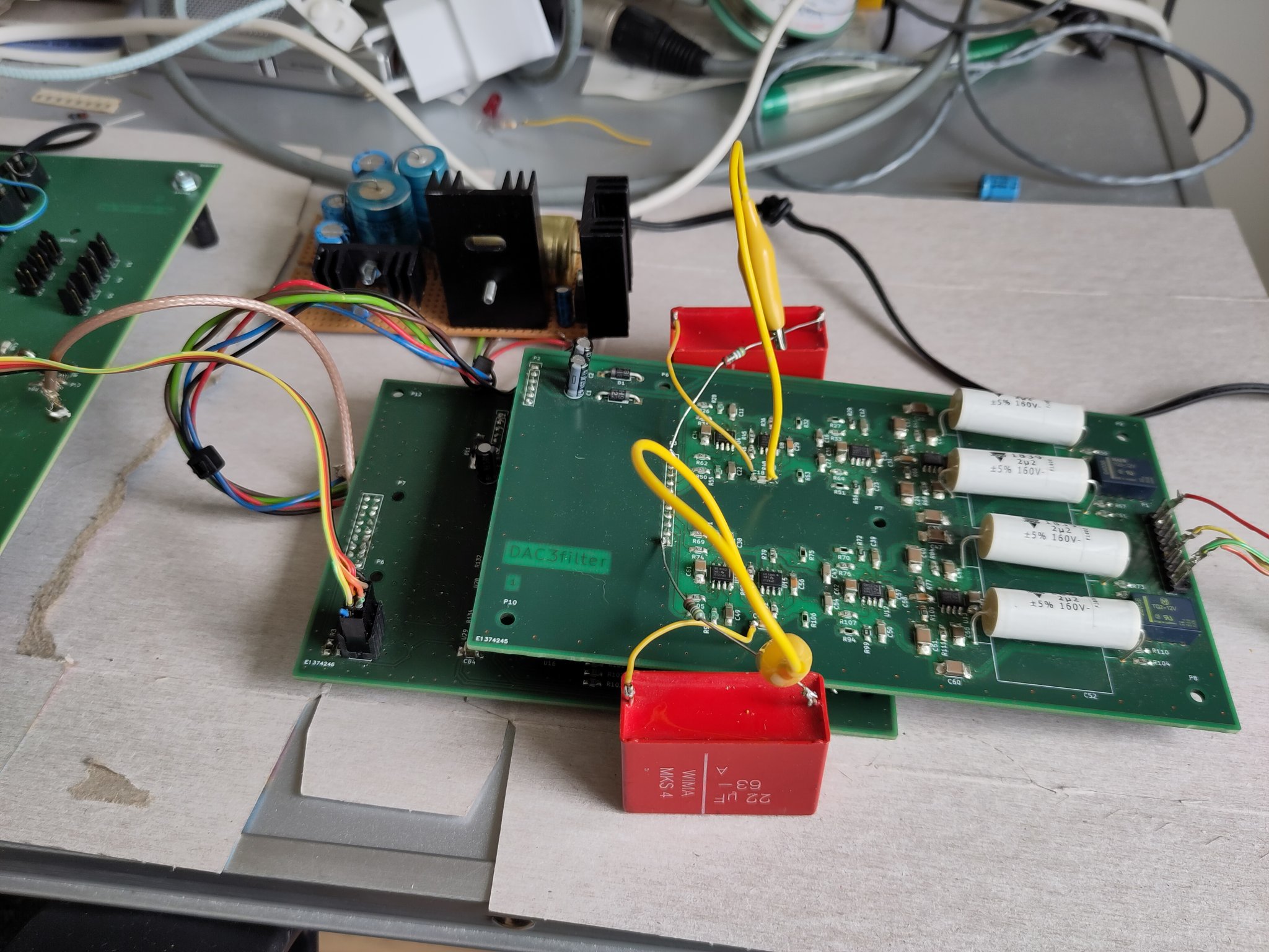

I've replaced the electrolytic capacitors to slow down the common-mode loops with 22 uF, 63 V WIMA MKS 4 film capacitors, added 4.99 kohm metal film resistors to ground to keep the capacitors properly biased and added wires with alligator clips for easy connection and disconnection. It's still a sighted test.
My subjective impression so far is that I hear no difference whatsoever whether the big capacitors are or are not connected - which doesn't mean much, as I'm a middle aged man with tinnitus and I expected not to hear any difference.
Hi Marcel,
Thank you for trying.
However, perhaps worth noting I think my experiment and yours may be significantly different. Again what I did is shown in the pic at: https://www.diyaudio.com/community/...t-register-firdac.379406/page-65#post-7426445 The idea was to slow down the common mode attenuation to approximately RC = 1 (which is a pretty good time constant for a DC servo). What I actually ended up with, given parts on hand, was RC = .5, which is calculated from the two 1M resistors in parallel, times the 1uf Wima cap in the pic.
With 22uf and 2k resistors, that would give a time constant of .022, which I think would put the DC servo corner frequency too high up into the audio band such that LF audio, where the ear is sensitive to phase as it affects LF transients, will be incorrectly reproduced. In that sense, even a time constant of .5 that I used is already a bit of compromise.
May I ask if your filter board still had the last stage intact? If so, that may have further made our experiments significantly different in terms of the final sound produced.
Looking at the situation from a different perspective, if we suppose that some people might not be able to tell any difference if the common mode attenuation works up into the MHz region, as verses if it is limited to a DC servo, then why not just make it a DC servo in the first place and leave it at that? Some people will probably hear a beneficial difference in SE mode, and other people might hear no difference. At least some people might benefit.

Because from a technical point of view, it's an illogical way to dimension the common mode loop. Of course anyone can build it the way they like, but I'm not going to change it.
Regarding the loop bandwidth, there is more in the loop than just the integrator. The attenuator (3.9 kohm and 680 ohm) and the gain of the first filter stage (at low frequencies 1 + 845 ohm/(3020 ohm/8) if the shift register output resistance is 10 ohm) also play a role. In my case, the loop bandwidth should be about 3.478 Hz (time constant 45.7559 ms).
The last filter stage is intact on my board.
