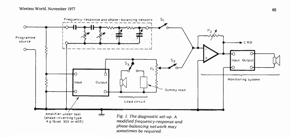

Not doubt subtractive tests can be made. Questions are about the limits of the test setup and equipment. Are subtractive tests highly accurate for -120dB linear distortions evaluations? Or what are the practical limits? How is the test equipment itself vetted, is it with PSS spectral measurements? With another subtractive test set? If it works well then why do we use AP machines? Just trying to get a feel for this type of methodology, its history, its limits, etc.
See
Andrew R. Collins, "Testing amplifiers with a bridge", Audio, March 1972, pages 28...32.
Peter J. Baxandall, "Audible amplifier distortion is not a mystery", Wireless World, November 1977, pages 63...66
What I wrote in post 1868 is not correct, as they did use active circuits other than the device under test, but not in the part of which the signal gets attenuated and the distortion does not.

Marcel,
Is there an article and or schematic of exactly what Quad did way back when? Just curious.
"The technique can obviously be implemented in various detailed ways, and Fig. 1 shows one arrangement which is suitable when the amplifier under test is of the phase -inverting type."
From Peter Baxandall's article in WW Nov 1977 "Audible amplifier distortion is not a mystery" (pages 63-66)

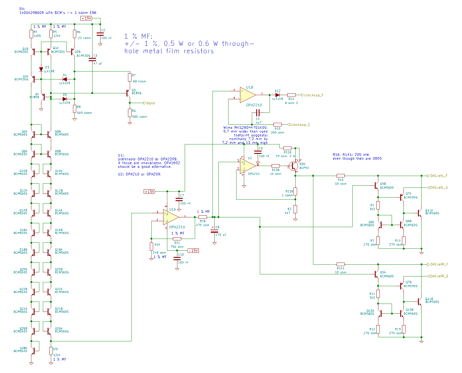

If you would want to build a Nazar-style shunt regulator with my low-noise bandgap as a reference, you could try something like this. Mind you, it's just a sketch, it requires more work to ensure stability and reliable start up. Besides, the reference designators of the new parts are not consistent with the rest of the DAC schematic. The impedance of the RC filter R18-C8 has been reduced because of the large bias currents of the regulators.

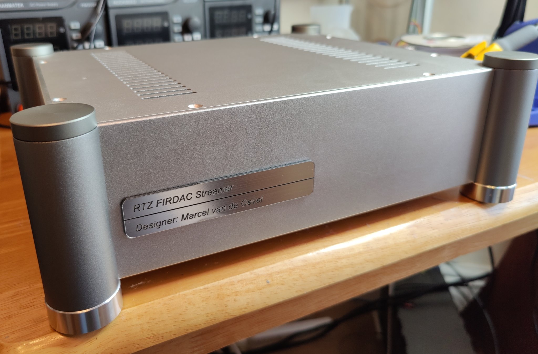

I thought I'd give a quick update on my progress with the RTZ DAC. I've built two RTZ DACs so far, the 2nd one being the device I will be taking to the next "Owston" meet-up in the UK in a few weeks time. This 2nd DAC is using the Simple PCM2DSD for I2S to DSD conversion and an LVDS link of the I2S and MCLK signals from a Logitech Transporter. For the purposes of the Owston event the Transporter will be driven from my CDPro2 CD transport, since it is far easier than trying to set up a whole portable infrastructure to feed the Transporter from LMS, etc.
I recently switched back to the "simplified filter" using @nautibuoy's pcbs and am powering it now from its own diyAudio super-reg.

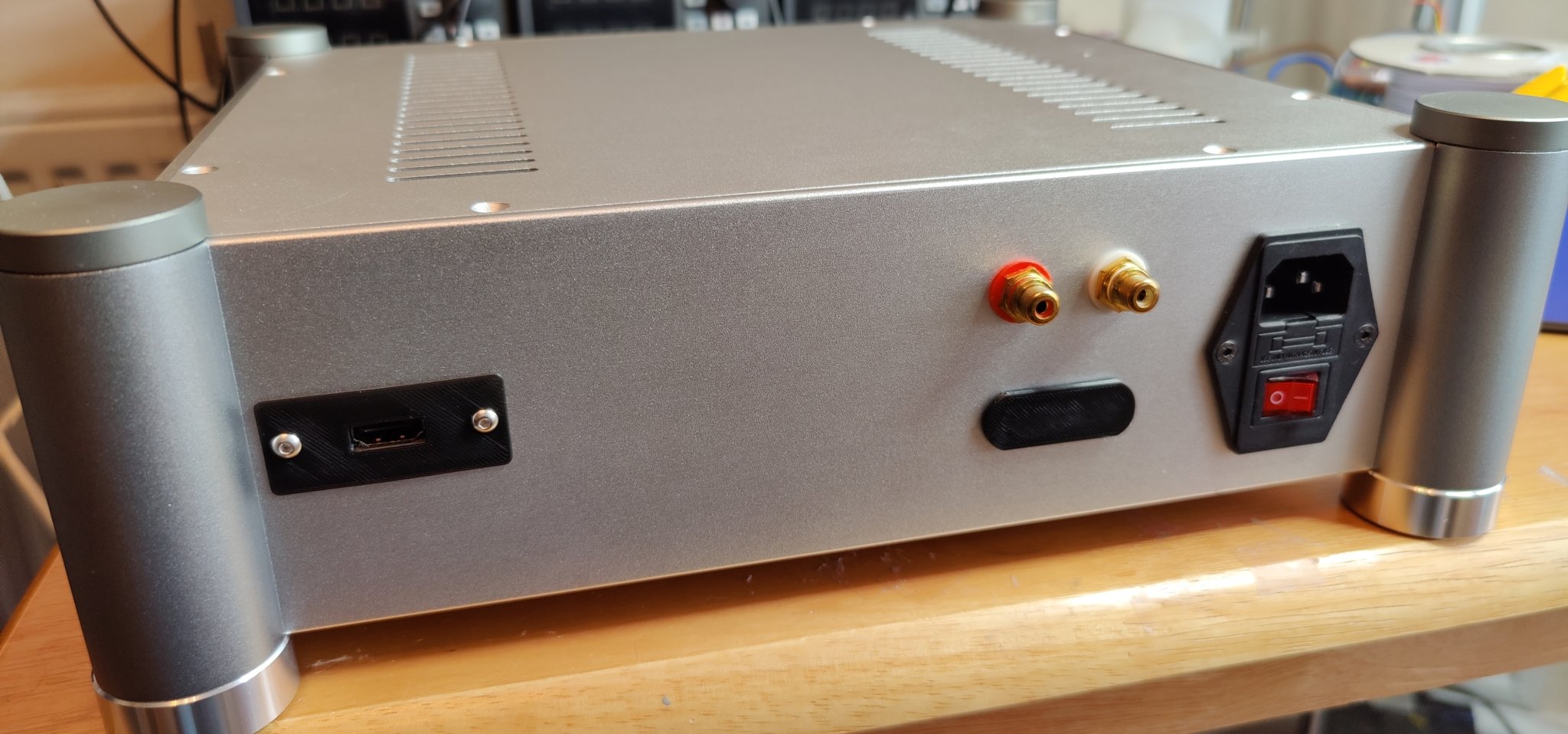

And the back:

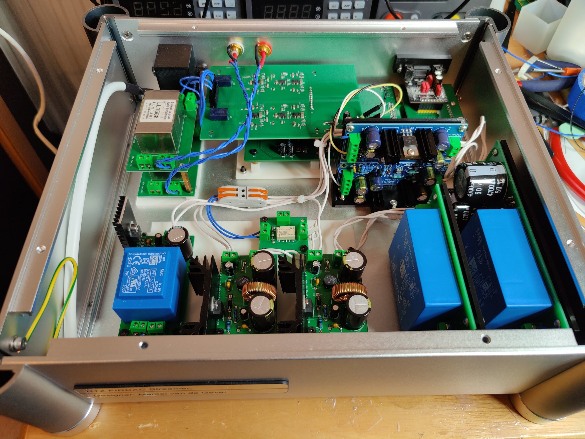

And inside:
I have bodged in the +/- 15v wires to the filter board currently as I am using this as a test-bed to easily swap out the filter board for the passive one, the original filter, etc. (Although the space is not available in this box to fit the original filter, as can be seen, however I can do that on the other DAC since it's case is larger and was originally arranged for that pcb to fit.
I am very pleased with the outcome of both the DACs. I have more experimentation to do but for now I am just satisfied to listen to this day in day out.
