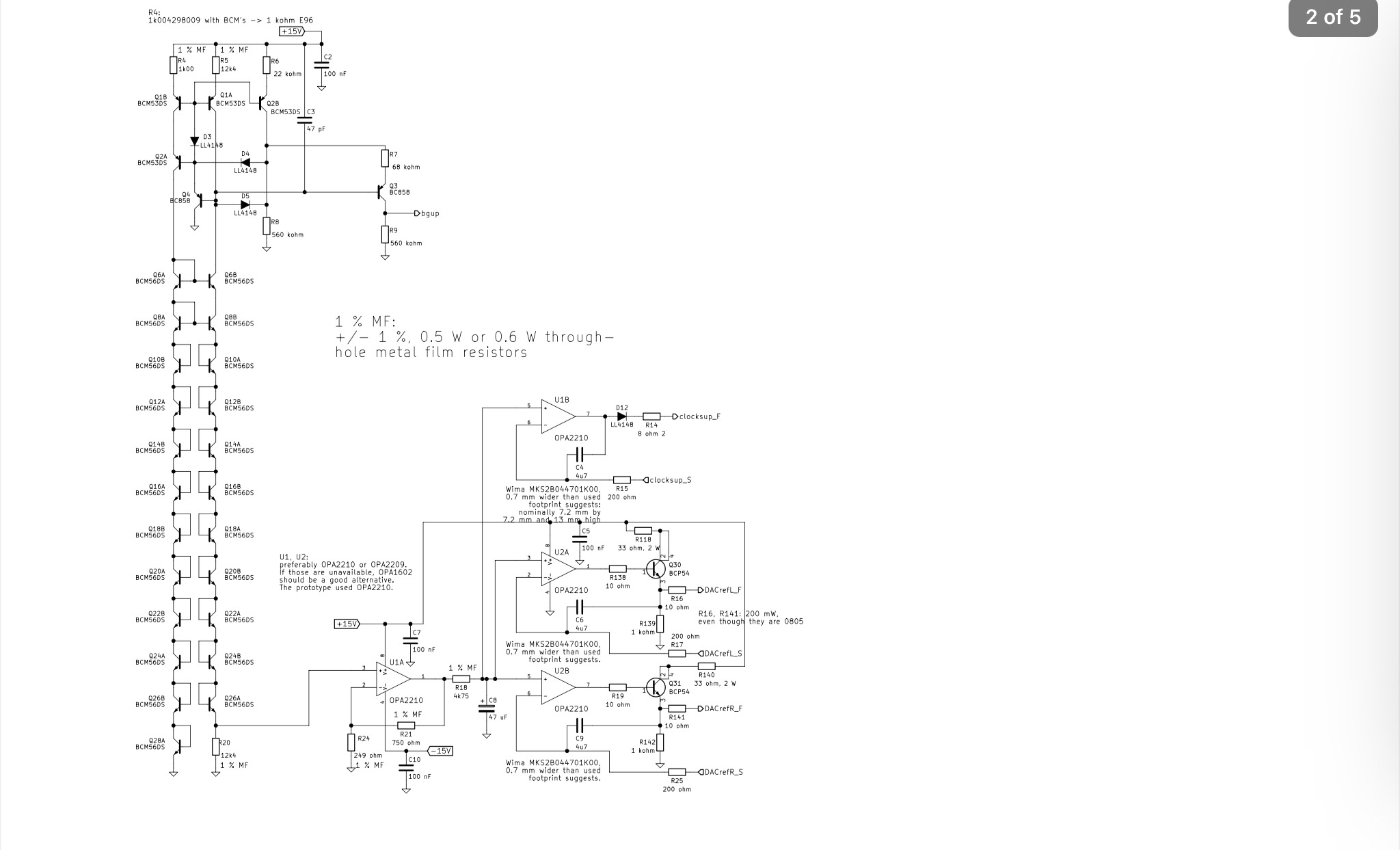

Did anybody else try the Nazar-style shunt regulator mod posted by Marcel #1,865
In the process… TBA
Some context: ~DAC designers here have moved away from Shunts to series types. e.g. TPA Tridents shunts to Trident SR (using ADM7151). Now DDDAC (Doede) new version eschewing the original Tentlabs shunts for something similar, some custom series types- again indicating better performance.
We will see how the Nazar type turns out…
@MarcelvdG, thanks a lot for the concept circuit. I will get back to you later if I need any help🙂
Shunt or series regulators, either way they have to be tuned/matched to the load. They can be designed well or poorly, given the load. For example, for the new Andrea Mori Sonic Empire DSD dac prototype they tested in the range of 10 - 20 different shunt designs in an effort to find the optimum one for their needs. Soon, I hope to have one here to see for myself. Maybe by the end of the week, but then I have to set it up. And this is the same type of thing I hear from other professional audio designers. Shunts are not a given for good sound. They have to be designed to work optimally with the load.
Please keep us updated Acko
I’ve tried shunt and series regs for various dacs including twisted Pear buffalo’s, so far I’ve always preferred the shunts . I did not like TPA Tridents so use alternative ones .
I’m currently using shunts with very high bandwidth error amps for the +5v , +/-15v FIRDAC board and +/-15v for the active filter board .

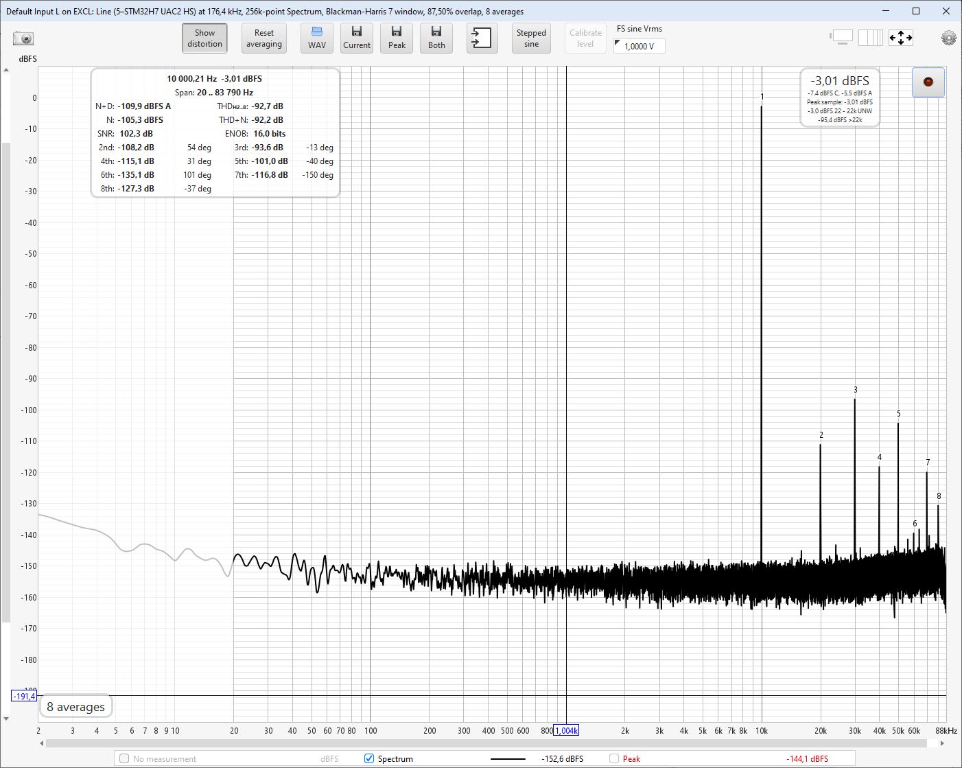

I'm aware that measurements are now out of fashion in this thread but I've noticed that "stock" filter has somewhat elevated distortion at 10kHz.
This is stock filter (without 3rd stage).
With a simple modification I could improve this by almost 20dB.
Since I'm under NDA I may be able to share what I find with Marcel, but probably can't share details publicly. However anybody with a pair of ears should easily find out the solution just by listening.
