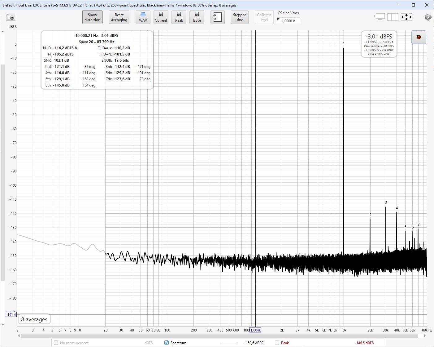

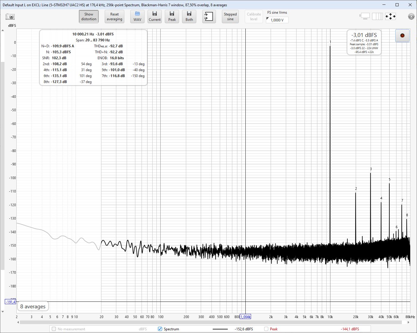

Definitely not out of fashion , just that some of us can't do themI'm aware that measurements are now out of fashion in this thread but I've noticed that "stock" filter has somewhat elevated distortion at 10kHz.
This is stock filter (without 3rd stage).
With a simple modification I could improve this by almost 20dB.
Since I'm under NDA I may be able to share what I find with Marcel, but probably can't share details publicly. However anybody with a pair of ears should easily find out the solution just by listening.
The NDA was a joke pointed at post #2060. Of course I'll publish the modification but having discussed this with @MarcelvdG I need to do more testing to find out if there are side effects.

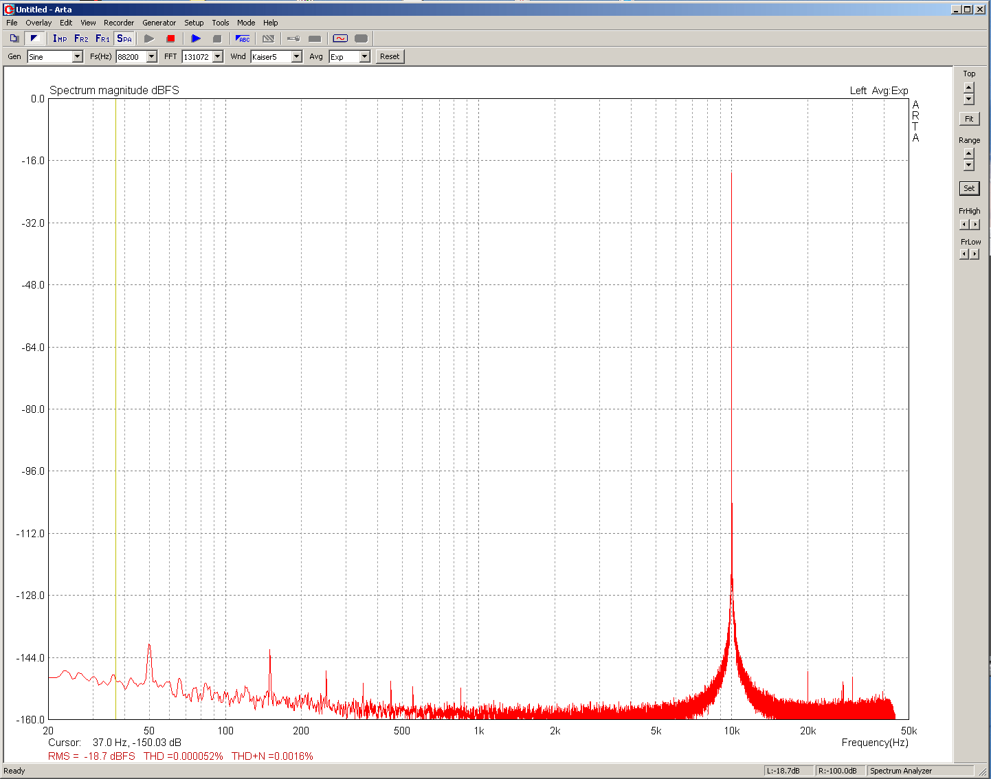

Hmm.. in the profound past I had replaced the NJM2068D opamps (6V/usec) in my EMU1616m card's Dac ouput filter and ADC input stage sections - to OPA1612 (27V/usec) bipolar, low noise, moderate speed parts. The better slew rate cause less slewing distortion, which could become detrimental in an active filter/ IV position at the output of an S/D dac..
The first thing I noted was that while at 1kHz the results did not change too much, at 10kHz the distortion decreased an impressive way. Very similar to what Bohrok had shown here..🤔. The OPA2210 is having 6V/usec slew rate specification..

Edit: I place it here, because I can not edit my previous post anymore: The screenshot is the tweaked ADC input section with opa1612, and recording a Victor's 10kHz oscillator.

The increased distortion at 10kHz seems to be caused by the common-mode noise suppressor circuit (around U8 & U15). My quick & dirty fix was to "eliminate" it by removing 3k9 resistors R46 & R89. This works as expected in differential mode but as @MarcelvdG promptly pointed out unfortunately not in single-ended mode as common-mode noise is increased and there will be DC offset unless 3rd filter stage is used. I mostly use differential mode so I failed to notice the DC offset.
I tried modifying the CM noise suppressor in other ways but with no tangible impact on 10kHz distortion. And it remains a mystery why the distortion is so much higher with higher frequencies. So unfortunately no solution exists yet.
I have to slightly disagree with this as distortion starts to rise at much lower frequencies than 10kHz. I just happened to notice it at that frequency. Also IMD will increase. Whether or not this is audible is another question but still it would be nice to have frequency independent distortion profile.Harmonic distortion at 10 kHz is just a measure of how well or how poorly a circuit can handle signals with a relatively large rate of change. The fact that the harmonics are above the hearing range of most humans (but well within the hearing range of cats and dogs) doesn't change that.
