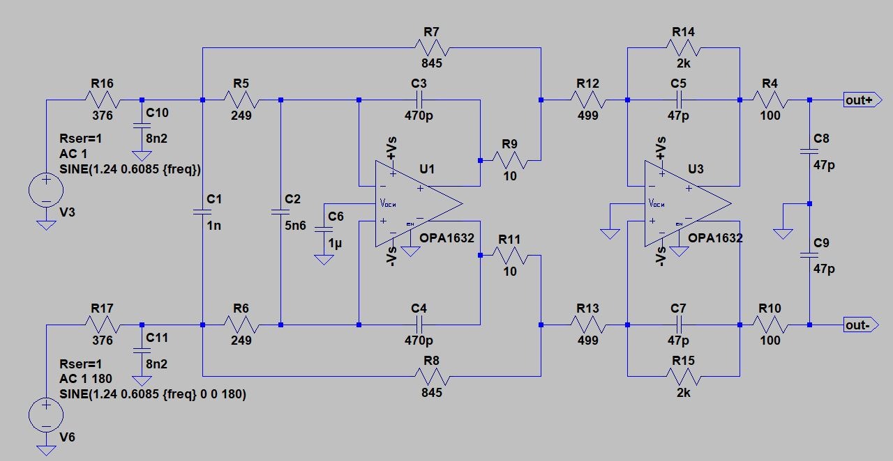

So the question is: how can these large differences be explained. When I remember correctly, in my case the filter was equiped with the OPA2210, what amps did you use ?
And does the used DSD frequency make a difference for the 10Khz distortion that you measured, I made my measurement at DSD256.
The "stock" filter is exactly the same as Marcel's first 2 filter stages. Only difference is layout and passive component selection. Opamps are the same as in Marcel's. My dac uses the PCM2DSD converter so input is DSD256. Since the distortion is low without the CM loop my assumption is that the problem is with CM loop opamp. Maybe it is too "slow" as JosephK suggested. I have also made slight variations to the CM loop passive components making the loop "faster" or "slower". These changes also impact differential distortion (albeit only slightly) which further points to CM loop being the issue.

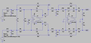

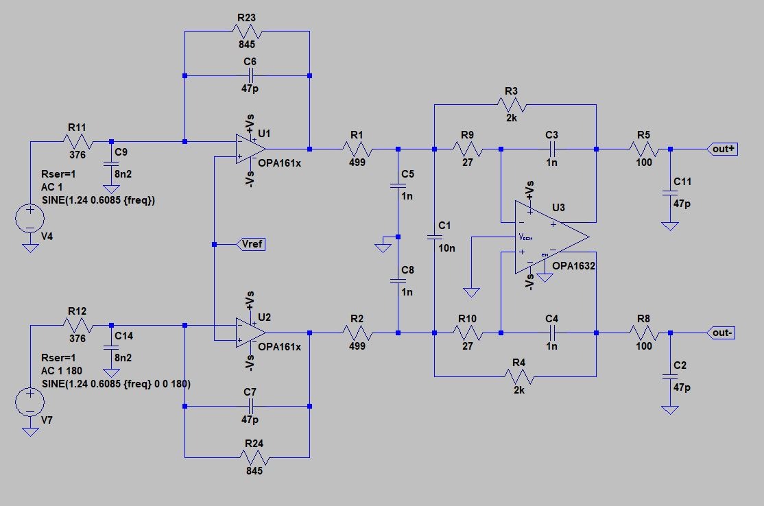

Is there a reason why this relatively bog-standard output stage would not work with RTZ?
Non I can see.
But why not swap the I/U conversion to OPA1632? And you might want to increase capacitor values in the I/U conversion feedback loop.
One of the downsides of using OTS FDA's can be noise performance in SE mode, due to relatively common mode noise levels from the common mode feedback loop, which is why I prefer the Birt circuit.
Thor

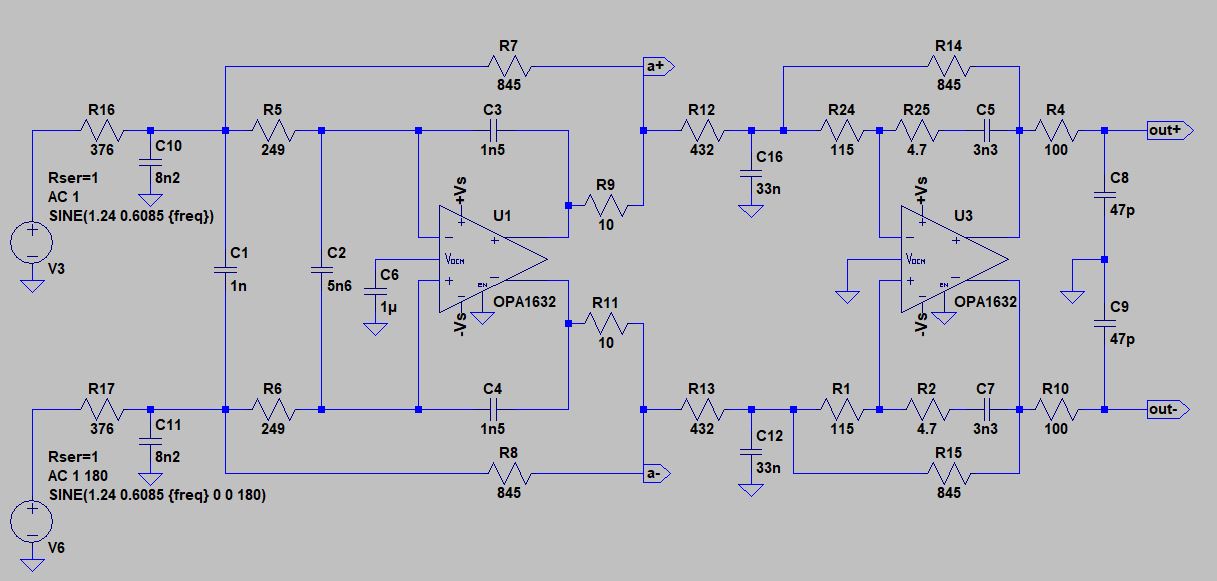

Forgetting about the hundreds of possible alternative filter topologies for a moment, does anyone understand why the common-mode loop of the original filter has a substantial influence on the differential distortion? If so, why only on the 10 kHz harmonic distortion and not on Hans's intermodulation distortion measurement?
The noise floor on Hans's IMD measurement is about 20 dB higher than on mine so it hides most of the stuff seen on my measurement.
And regarding the level on my measurement since CCIF IMD is 1:1 ratio clipping starts at -3dBFS. It is not possible to use 0dBFS level.
As I said earlier at least in simulation the CM suppression of stock filter is not perfect. Could it be that HF CM noise/distortion results in differential mode noise/distortion elsewhere in the filter?
Yes your noise level is 20dB lower, because you are probably using a bin width that’s 1/100 of the one that I used.
But nevertheles the more important IMD products in the one digit ppm range are clearly visible with some 20dB above the noise.
I used the 19 & 20Khz tones at -6db each, giving a level at 0dBFs peak and on average -3dBFs.
That seems to correspond with your findings.
Would be nice to see your spectrum at this maximum level to compare with mine.
