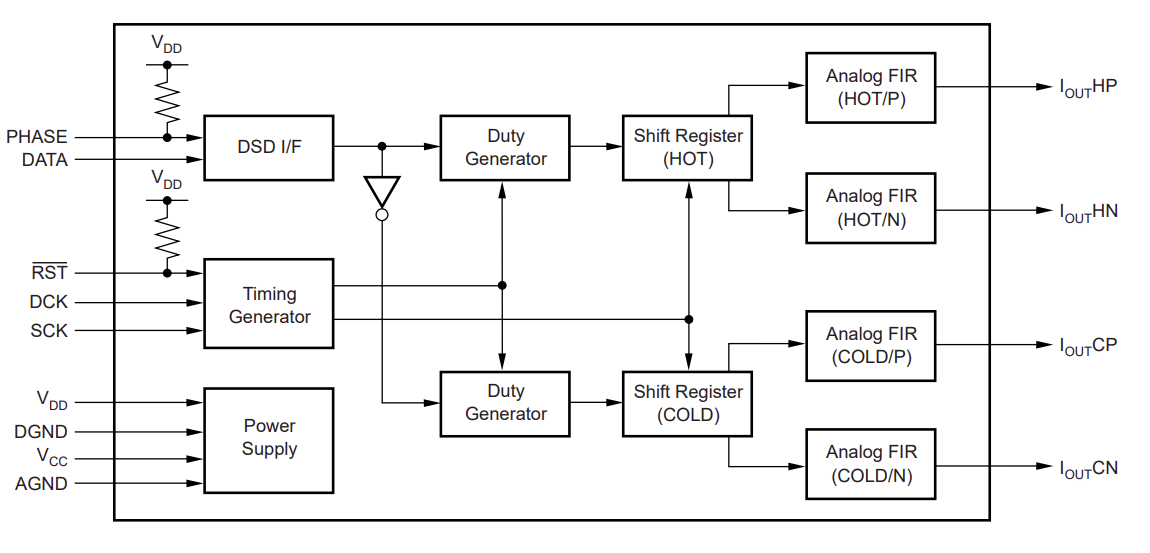

I find the solution in the analogue stage for the BB DSD1700 (which was kind of the same in an IC) telling as to what the RTZ system does to the analogue stage.
First again the DSD1700 principle design:

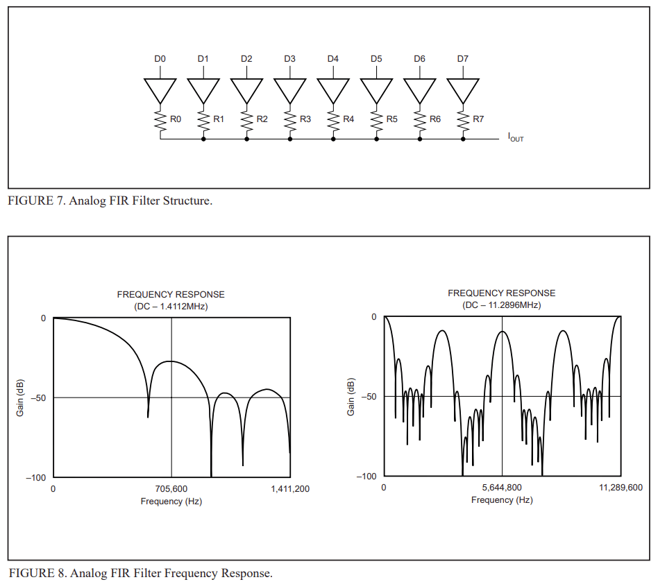

It is a single channel DAC with individual FIR DAC's as so:
Resistors are NOT equal weight.

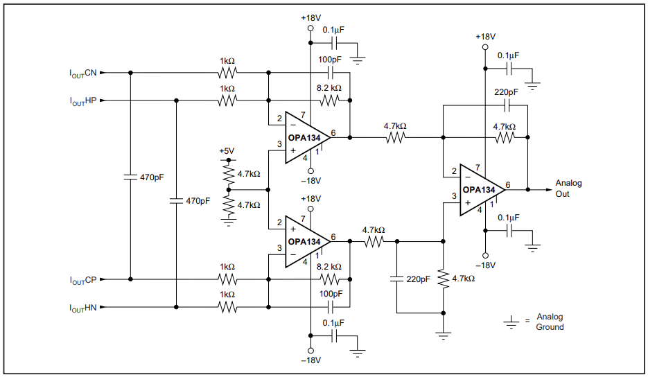

And here the recommended output stage:
Notice the 1k in series after the first filter stage. The whole structure causes less than ideal SNR and other issues.

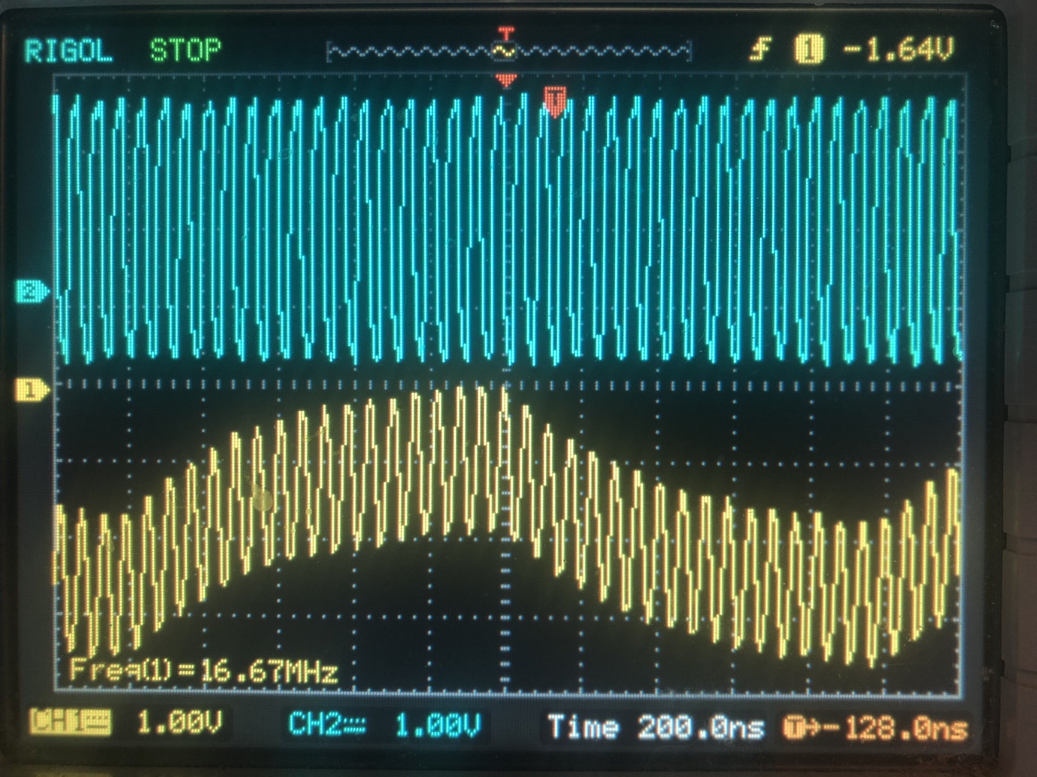

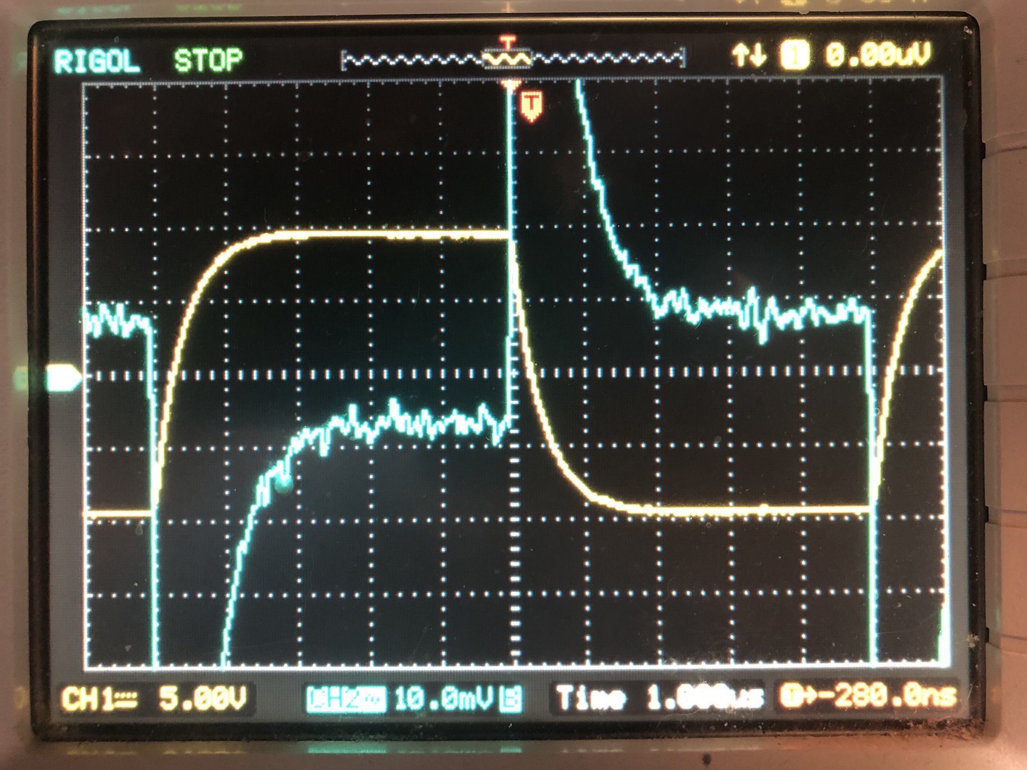

My focus is on the I/V conversion.
Can it be concluded that the RMS values of both forms of conversion of the digital waveforms is equal, notwithstanding that transient glitches exist and notwithstanding gain differences? In other words if the analog conversion was perfect, regardless of glitches, would the two be only as distorted as the theoretical nature of the digital allows?
The reason for asking is that I am working on an I/V for D/A that seems could also handle such extreme signals directly, with preliminary results depicted by the screenshots below. Don't know how they compare with other networks.

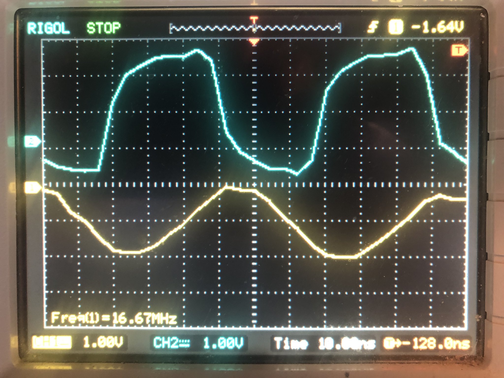

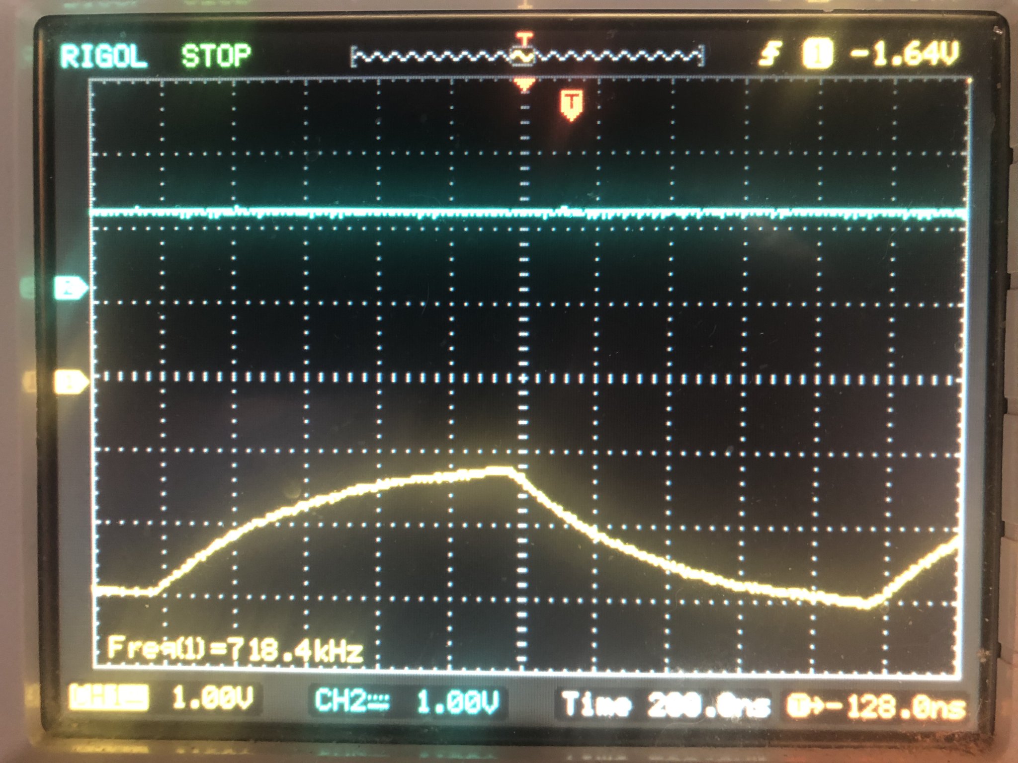

1. The first screenshot depicts a 500KHz square wave feeding into a low pass filter with ~250KHz low pass response.
2.The second depicts the same square wave but with an additional 16.9344MHz signal imposed on the inverting terminal (using a clock module that was lying around intended for implementation in a Sony CD player). In this screenshot the output doesn't indicate any form of rectification or non-symmetric amplitude variation in the mix. In other words the original waveform would remain in tact if the ~17 MHz was subsequently filtered out.
3. This is an expanded scale of screenshot 2 at 10nSec/ div., showing perhaps 5nSec rise-times of the oscillator. The output shows good symmetry in rising and falling edges despite the rapid input rise/fall times. Although such signals would not be imposed at this point it demonstrates exceptional suppression of lesser amplitude signals that could become imposed there.
4. The fourth is just the output of a 100KHz square wave (yellow trace) +/- 10 Volt output (+/- 5mA into 2K Ohm) with ~250KHz low pass response. The white trace is the signal across the inverting/non-inverting terminals magnified 100x. For comparison Walter Jung conducted similar x100 tests in using an AD811.
https://cfas.waltjung.org/High_Performance_Audio_Stages_Using_TransZ_Amps.pdf
Although the scale reads 10mV/ division, with 100x magnification the scale is equivalent to 100uV/ division, meaning that the output settles to <+/-100uV in 2uSec for +/-10V (+/- 5mA) input changes.
![IMG_04.jpg IMG_04.jpg](https://www.diyaudio.com/community/data/attachments/1190/1190968-da9d9feec548d468d8400a1669c64da3.jpg)

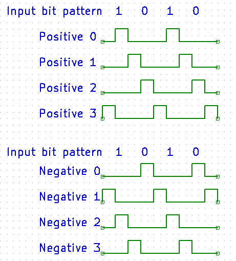

For clarity, I've added notes p0...p3 and n0...n3 to show what signals should occur on what 74LV574A outputs if the DAC should happen to work the way I intended it to work.
("Input bit pattern" refers to the input bit pattern of the entire DAC, not the input pattern of the 74LV574As.)

Marcel's claim is to the effect that what he has done is equivalent to two dacs offset in time.
Yes, actually MvG has done with with FOUR single BIT DAC's (giving a 4-Tap FIR filter).
But what has not done, is to interleave two DAC's in such a way that when one DAC's output is in the "Zero" phase of the RTZ cycle, the second DAC is in the "Data" phase of the RTZ cycle.
Your claim seems to be that it will take another physical dac to do what Marcel is trying to do.

Its seems simple enough. Show the waveform Marcel's dac produces as opposed to the waveform your dac would produce just before going into the output stage.
I did.
When Marcel can produce a sequence of 16 random zero’s and ones for sdinR, and we can agree upon this pattern,
I suggest to use "DSD Silence" (0x69h) as pattern. I use TINA TI, it has good logic models and an generator that is easily set up.
I will simulate the whole Marcel circuit, and also versions with a second DAC for “interleaving” and a version with crosscoupling as in the DSD1700.
DSD1700 is more subtle, HOWEVER it does not inerleave.
If you simulate it understand the following:
1) DSD1700 uses 75% Duty Cycle RTZ, not 50% (giving 3dB more usable level)
2) DSD1700 uses two sets of shift registers in exactly the way as MvG does, to create a geometry that minimises errors in the analogue supply. It will not show up in a simulation, UNLESS you include such effects in your sim.
3) DSD1700 is likely interleaved (two duty cycle generators are shown in the principle diagram).
3) DSD1700 uses 8-Tap FIR with weights that can be approximated indirectly from the response shown, using a suitable tool.
4) DSD1700 uses separate bit switches, it does not drive the resistors from the shift registers directly.
Arguably, a kind of discrete DSD1700, with two balanced 8-tap shift registers per channel and Kaiser window weights, a 75% Duty Cycle RTZ gate derived from MvG's current RTZ DAC would be a development likely capable of improved overall performance, at greatly increased complexity.
