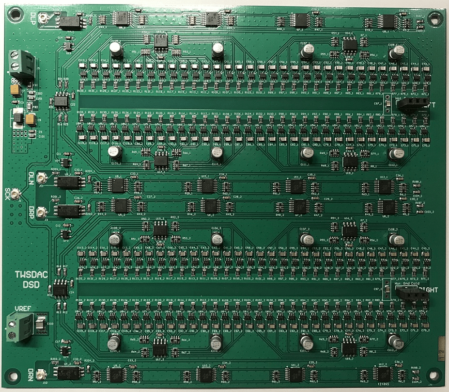

Getting back to all of the problems with noise, FPGAs, ground bounce, etc., only dacs I know of that are designed to minimize those sorts of problems are those of Andrea Mori. I think Marcel has figured out what Andrea is doing, but I don't think I should describe the architecture in detail here. That said there is a pic of an earlier version than I am using at TheWellAudio website:
Image taken from https://www.thewellaudio.com/twsdac-dsd/
Picture of a PCB does not tell much about PCB design quality. Instead SNR is commonly used indicator of digital PCB design. This thread has plenty of SNR measurements of various Marcel's RTZ dacs. For comparison do you have any SNR measurements of WellAudio dacs?

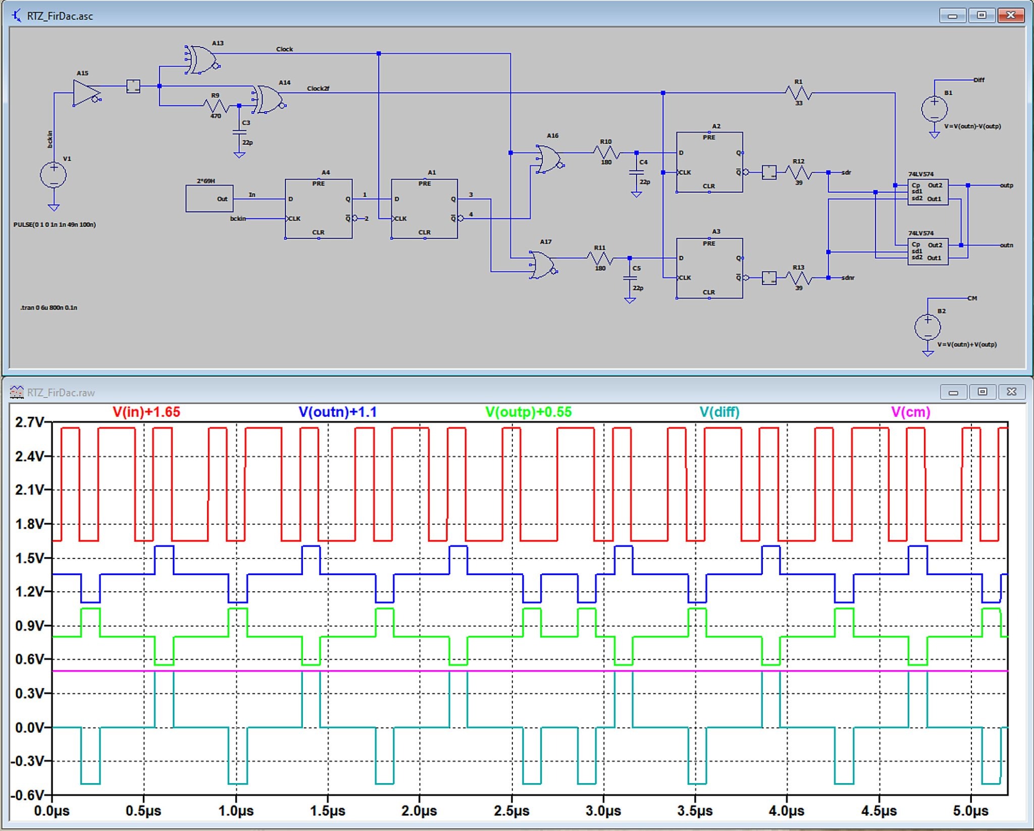

I made a simulation of Marcel's Firdac as close to the real world as possible.
The only thing I did not take into account is the eventual Vref ripple on the shiftregisters caused by current-peaks while changing the flip-flop's output state, But apart from disruptions caused by ultra short current peaks, the way signals and shiftregisters are interleaved may prevent changing Vref from playing a significant role.
I used a repetitive 69h or 01101001 input signal which is generated in a subcircuit and used a 10Mhz BCK, almost equal to DSD256 and LTSpice operated at a 0.1nsec resolution.
Small subcircuit boxes were inserted at vital places to give a 5 nsec delay on tr and tf, since the digital components in LTSpice have no delay.
The shiftregisters are subcircuits made from D flipflops, each having a same delay box added at their outputs.
The 3k01 Firdac resistors are already made part of this subcircuit.
In the attachment below signals taken at various positions are level lifted in the image to get a better view on each individual signal.
From top to bottom:
Input signal: continuous 69h
V(outn): output from Firdac 1
V(outp): output from the Firdac 2
V(CM): Common Mode signal of both output signals showing a perfectly stable signal
V(Diff): Differential Mode signal whith twice the amplitude as the SE signals.
From supposedly CM products is no proof whatsoever at this stage.
So implementing cross-coupling or adding a second set of Firdac's seems a waste of time
Hans
Hmmm, No. But are we sure that an unloaded FIR DAC output with various parasitic in the logic IC's, which may or may not be modelled correctly.
How are you modelling the inputs and outputs? Ideal logic, simple static model or dynamic models with dynamic impedance's?
What are you doing to account for the whole analogue stage? Nothing?
Anyway, I already said you guys of "nothing here" win. No need to spend more time.
Honestly, I am not sure what you are simulating and why. But it is nothing like the Sim's I am running and I would not expect the same results. And you don't need to convince me, I already admitted defeat.
What question is your simulation attempting to answer and how can you be sure it will give the right answer? Example, we could look at the differential RTZ signal top make the common mode issue attested in the literature on the topic in fact exists in our sim and then look at the DAC and make sure it removed this.
