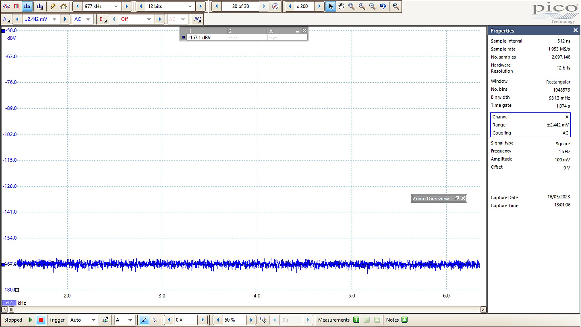

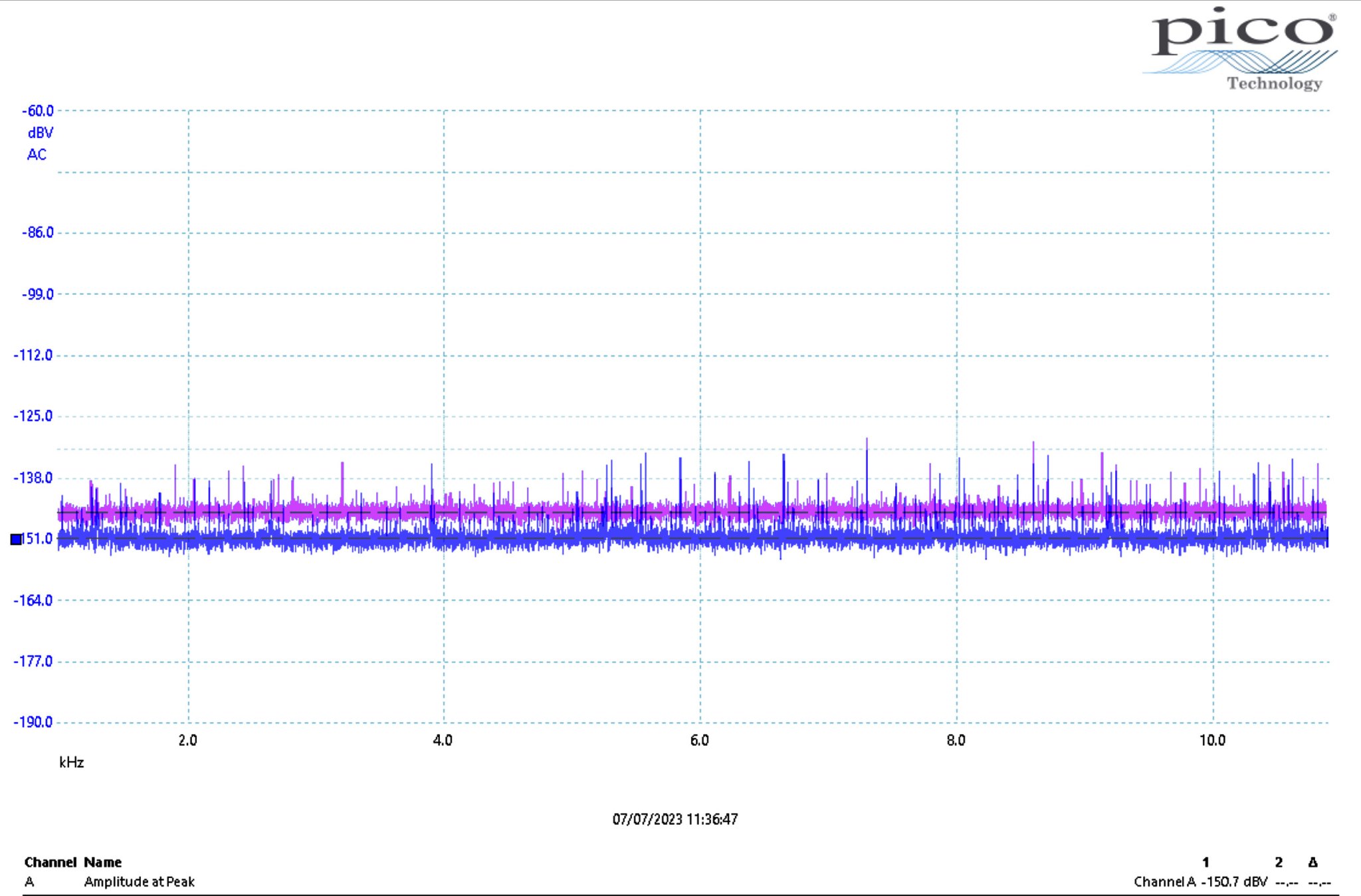

Maybe these images can help for further investigations.
The reconstruction's filter output was measured in diff mode while feeding the the Firdac with 0101010 or 55h, generated by Marcel as DSF files for various DSD rates without having applied noise shaping.
This pattern should give a constant output from the Firdac shiftregisters and should ideally result in a flat noise spectrum from the reconstruction filter in the audio band.
The same test was done with a silent track, noise shaped during the conversion from PCM to DSF giving an idle tone of 01101001 or 69h with added noise.
Now the content of the shiftregisters is varying and so is the output, but after filtering the diff mode signal should still be the same as with 55h since the average between both patterns is still the same.
Now the following attachments are shown.
1) The noise spectrum of my measuring chain when terminating the input with the same 2*50R resistors as the output of the reconstruction filter.
Noise spectrum is flat without peaks at -167.1dBV.

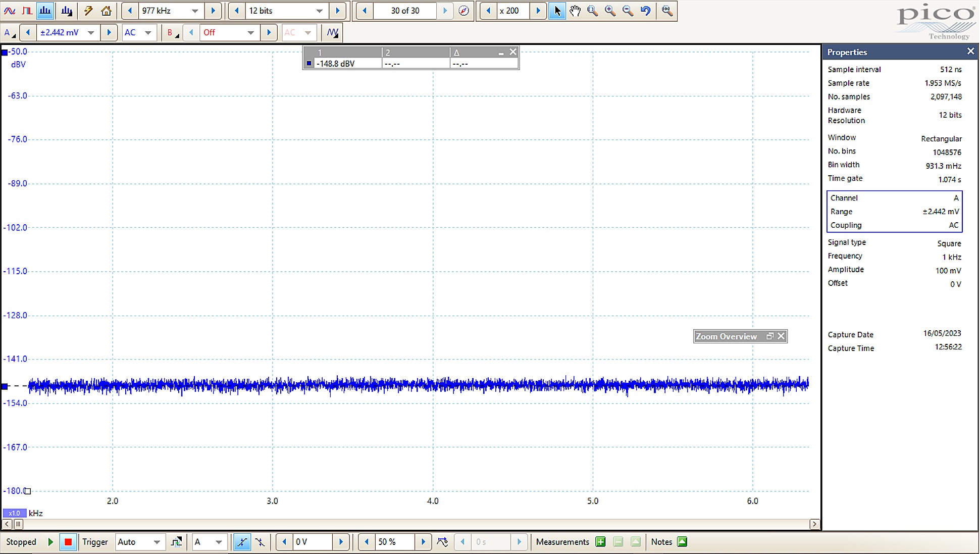

2) Then the noise was measured from the reconstruction filter alone with the 8n2 caps shortened at -151.6dBV.
3) Next is the spectrum shown while playing a silent track through Marcel's Solid State Dac, just as a reference to the RTZ Firdac.
Spectrum is still very nice and flat at -148.8dBV without any peaks.

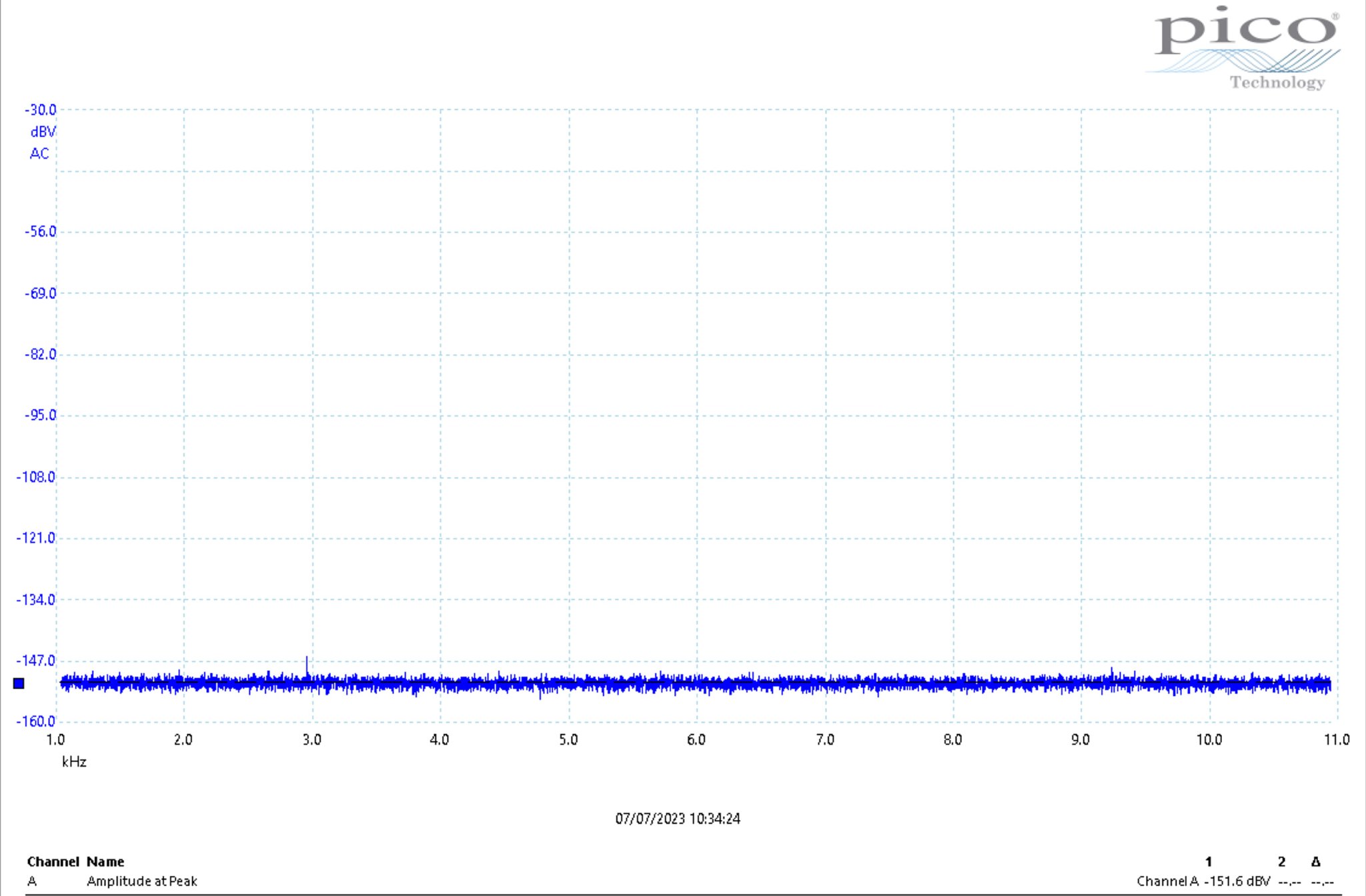

4) Output from the RTZ Firdac for DSD 256 while showing in one image both the 55h in blue and the 69h pattern in purple.
The purple spectrum for the silent track is 6dB above the 55h spectrum with resp -144,4 and -150.7dBV.
Since the filter alone is already at -151.6dBV, the 55h spectrum is in fact a number of dB's lower in level, but the point is that both spectra are far from clean for which I don't have an explanation.
For the 55h pattern no noise shaping was done, so that can't be the cause.
It could be the Amanero producing these spikes or the RTZ Firdac.
The other thing that strikes is that in both spectra the large peaks are at exactly the same frequencies.

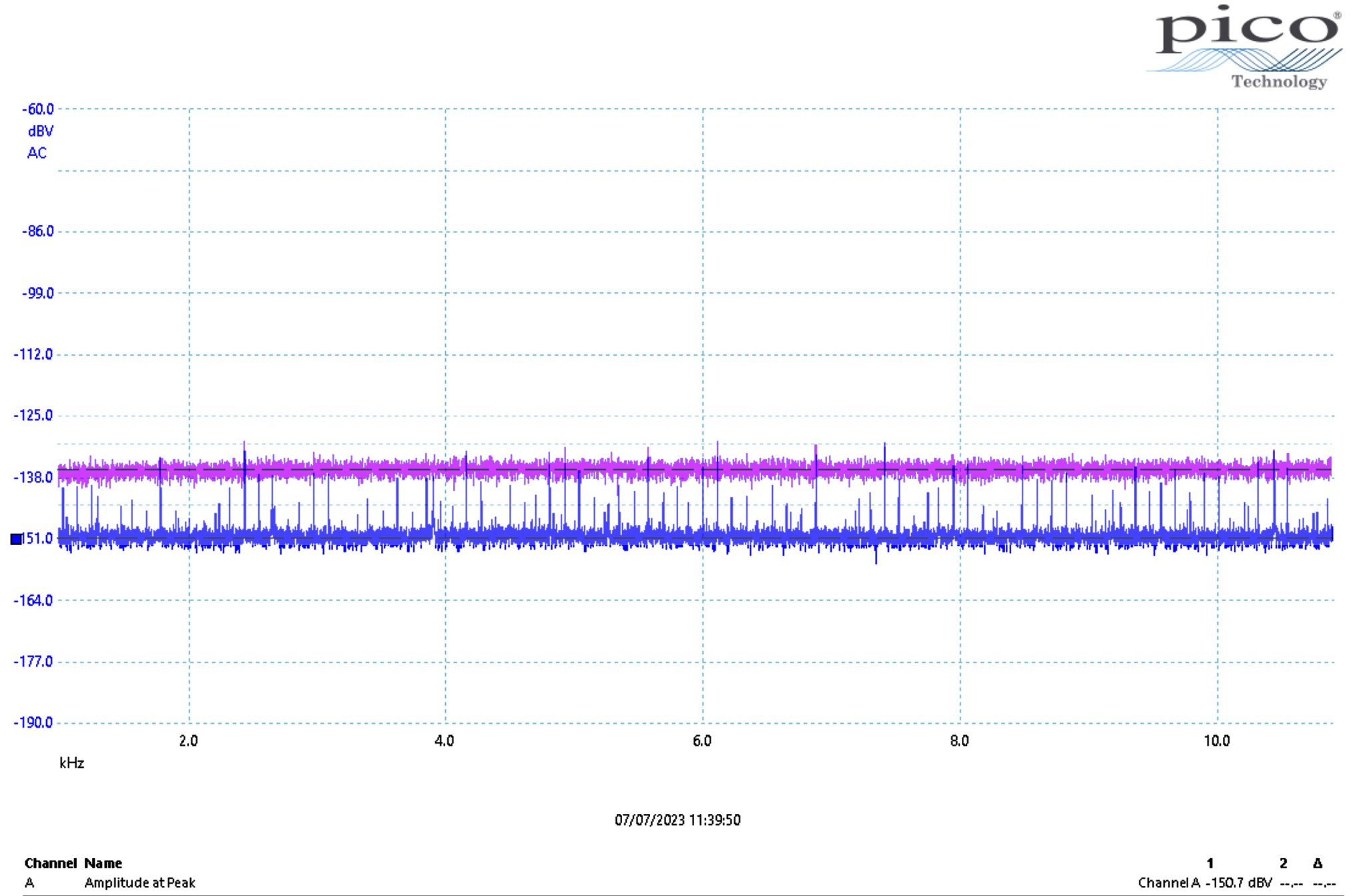

5) The same as in 4) but now for DSD512.
The blue spectrum is still at exactly the same level of -150.7dBV, but the purple silent track level is quite a bit higher at -136.5dBV.
Since both blue spectra are still at the same level, I suspect again the Amanero for worsening the 69h pattern level that much.
But the point is that again both spectra are far from clean, and closer inspection learns that the spectral lines are roughly 150Hz apart.
Looking again at the DSD256 spectrum, the spectral lines are ca.75Hz apart and for DSD128 even 37.5Hz.
So, the reason for showing 1)to 3) was to be certain that the spectral peaks in 4) and 5) are from the DSD circuitry and not from my measuring gear.
And since the spectral peaks are equidistant an directly related to the DSD rate it cannot be caused by mains interference IMO.
But at least RTZ Firdac plus Amanero sounded less to me as the Solid State Dac, which seems to make sense when looking at these spectra.
To exclude that all these anomalies are not caused by the RTZ Firdac, a better converter as the Amanero will have to be used.

Hans,
Thank you for the information. Already did have a pretty good idea about the Amanero and few other issues external to the dac itself. If and when I end up with a dac here I will see that those things are attended to first. Maybe I will build a dac, but not an output stage. Will have to see.
Mark
Hans,
"Using Amanero" in your case means:
Amanero local clocks are used? Or do you have local clocks that are used in the first reclocker of MvG's DAC, reclock BCK and then drive MvG's DAC?
The clocks on Amenero are not that clean. Actually the BCK from all the USB -> I2S is not very clean.
Marcel's original design needs a super clean BCK, the clock doubler will add jitter (in part because it cannot have 50% Duty
All my USB audio products use NC7 popcorn logic Flip Flop's to re-clock BCK & Data, from the local Crystal or DLL Clock synthesiser.
A lot of the clock problems with these converters appears to be sloppy programming. Edges are not aligned and while all FPGA's and devices like XMOS allow the outputs to be driven by latches clocked from MCK, it is usually not done.
Past that, what you see with DSD256 vs DSD512 as noise rise I have observed with both integrated circuit and "discrete" DAC's (not always at DSD512, but at DSD2048 it gets dicey very rapidly. DSD1024 is also pushing it in terms of SNR).
My interpretation has always been that we are now at points where the logic update speed is so fast, issues from lead frame and bond wire impedance no longer decay to steady state before the next clock edge. If not sending an absolute steady state pattern (e.g. 0xAAh or 0x55h) that allows the system to "settle" to a degree.
As RTZ adds extra transitions it would be more sensitive to this problem than NRZ. A workaround is to lower the switching frequency and use multiple DAC's in Quadrature, I think it needs a FPGA to create the relevant data streams. I cannot think of a way that uses simple logic. Running (for example) four FIR DAC's at DSD512 interleaved gives an effective DSD2048 sample rate.
Switching (for example) to much physically smaller QFP IC's (from TSSOP) in discrete DAC's reduced the problem. Logic families are also an issue.
Ideally we want super fast logic in QFP etc cases for all the control logic, but that means 1.8V logic.
For the actual DAC part ideally we would run from +/- 15V with a "center" position for RTZ and either +15V or -15V passed to the resistor chain as 1 or -1 with zero being the rest position.
For now, logic fast enough to do appx. 12MHz without issues and able to handle 30V doesn't exist.
I also found that Op-Amp's really dislike RF noise on the inputs. using a passive filter to remove as much as possible from reaching active circuitry helps. Filtering the "noise shaping" noise, at least above ~50...10kHz helps.
I found such issues to be both audible and possible to be measured indirectly.
