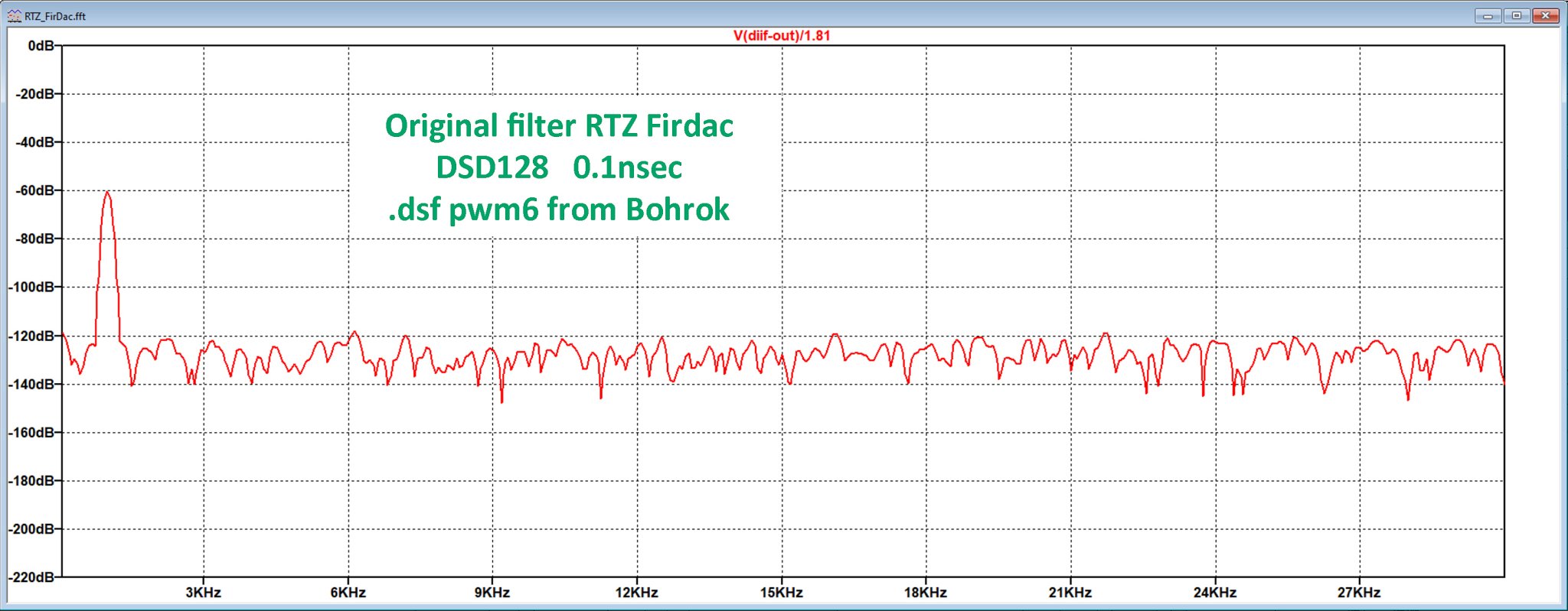

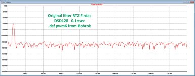

Bohrok was so kind to send me a -60dB .dsf file that in his case lead to visible modulation products in his measured spectra.
Simulating this file in my LTSpice model could not show any spectral lines caused by modulation.
Like in the above posting it could be that smaller filter bins are needed to reduce the noise level, ultimately making those spectral lines visible.
But if so, is anything happening below -130dB a reason for concern ?
The other reason could be that the real analog filter isn't behaving as perfect as the LTSpice filter.
Because the AK4493 showed clean spectra with the same .dsf files, the cause is clearly the senstivity for HF noise in the filter and that's why I designed a hybrid filter that may result in a much lower sensitivity for this modulation problem.
Will show the hybrid filter tomorrow with some results from simulations.

Reply to post #2700:
Well, the noise floor in the simulation is around -130 dB with respect to something and the intermodulation products bohrok2610 measured are around -130 dB DSD. However, if I understand you correctly, the FIRDAC is not included in the simulation, so neither is its suppression around odd multiples of fs/2.
That should make it a lot worse. For example, assuming 30 dB of suppression, second-order intermodulation products should get 60 dB worse, well above your simulation noise floor (*). I don't know why that doesn't happen.
By the way, it's a plain old fifth-order sigma-delta modulator without PWM.
(*): For the same reason, running the DAC at twice or some other multiple of the bit clock frequency could make the intermodulation products stronger and, hence, easier to measure. The RTZ behaviour and the spikes due to unequal propagation delay times are then retained.

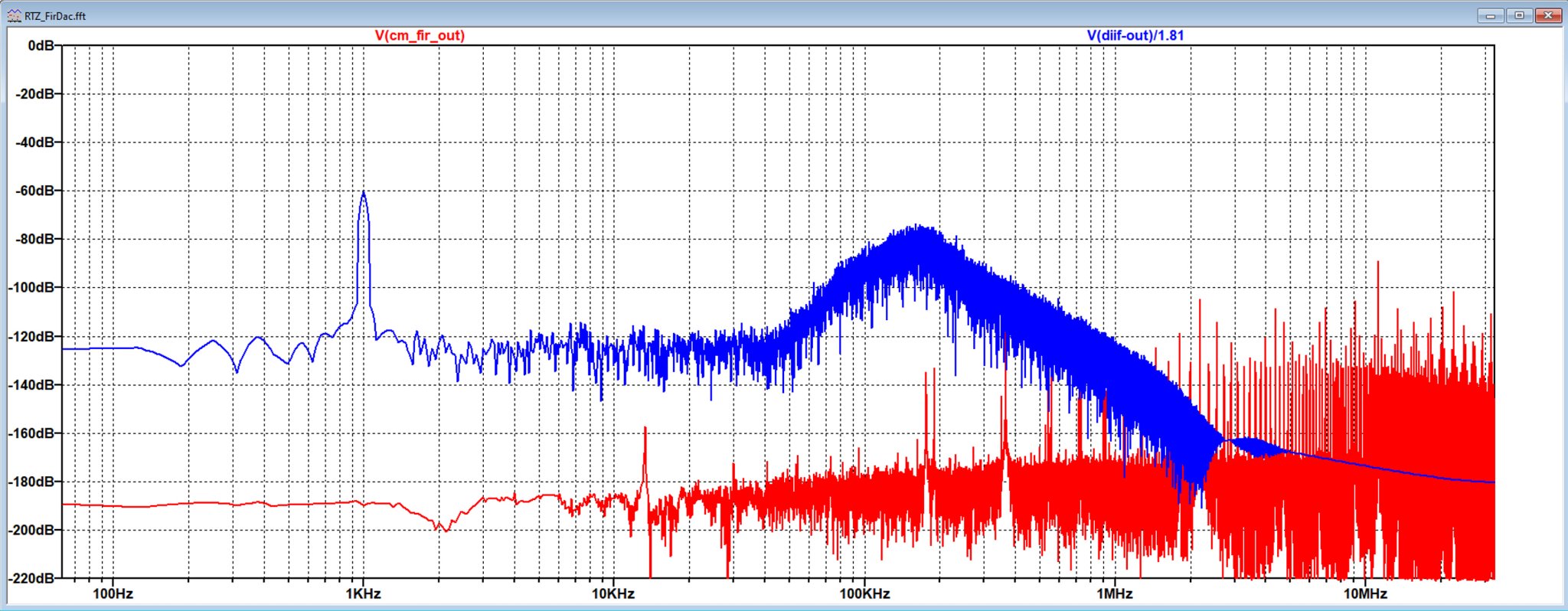

it’s a misunderstanding that the Firdac was not included so all suppressions as from fs/2 and upwards are there, but here I only showed the spectrum up to 30Khz.
0dB in my images is maximum output, as can also be seen in the -60dB image from the Bohrok file.
I’ll show tomorrow the whole logarithmic spectrum with all the suppressions.
So, I simulated the whole chain digital and analogue, starting by offering the split cintent of the .dsf file and the BCK to the input of the of the RTZ Firdac that includes each vital digital element, see first image in #2629.

With the simulated noise level at ca -130dB ref full scale, with a filter bin of 62.5Hz, the S/N calculates to -130 + 10*log(20,000/62.5) = 105.0 dB or 106.8 dBA.
This is almost within 1 dB of the value of 105.3 dB-A that I measured on the real RTZ Firdac as reported earlier.
So the model is already getting quite accurate in some ways.

P.s. I have added the logarithmic spectrum up to 16Mhz that I promised in #2703, showing odd multiples of fs/2 when processing Bohroks -60dB .dsf file.
The bit clock used had a frequency of 5.64Mhz.

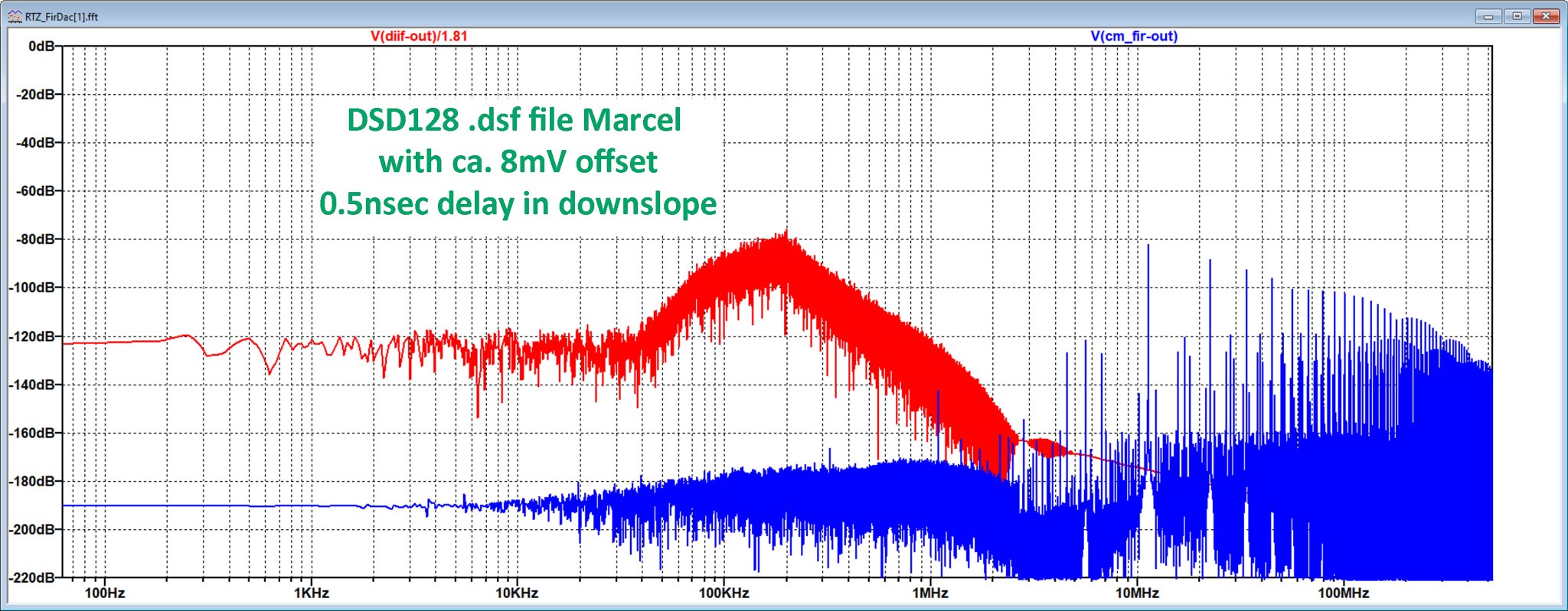

What I have is an exact copy of your shiftregister design but you are right that I have no spikes with the 0.1nsec step time in LTSpice. Is it your opininion that those spikes are causing the intermodulation products?
Peaks around half the sample rate and its odd multiples seem to cause the issue, even though the FIRDAC suppresses them. One reason why they leak through to some extent is the fact that they are not exactly in the notch at fs/2 but a few kilohertz higher or lower, but any FIRDAC imperfection could make it worse.
You could try giving each flip-flop 1 ns more delay from high to low than from low to high, and make the FIRDAC resistors slightly unequal.

Marcel, This what I get with a delay on the downgoing slope that is 0.3nsec more than on the upgoing slope for all Firdac flip flops.
In the spectrum below, processed with the -60dB Bohrok .dsf file, you see in blue the diff output from the original Firdac filter and in red the CM signal on both 8.2nF input caps.
Next picture will be with your .dsf file with DC offset.
Hans
