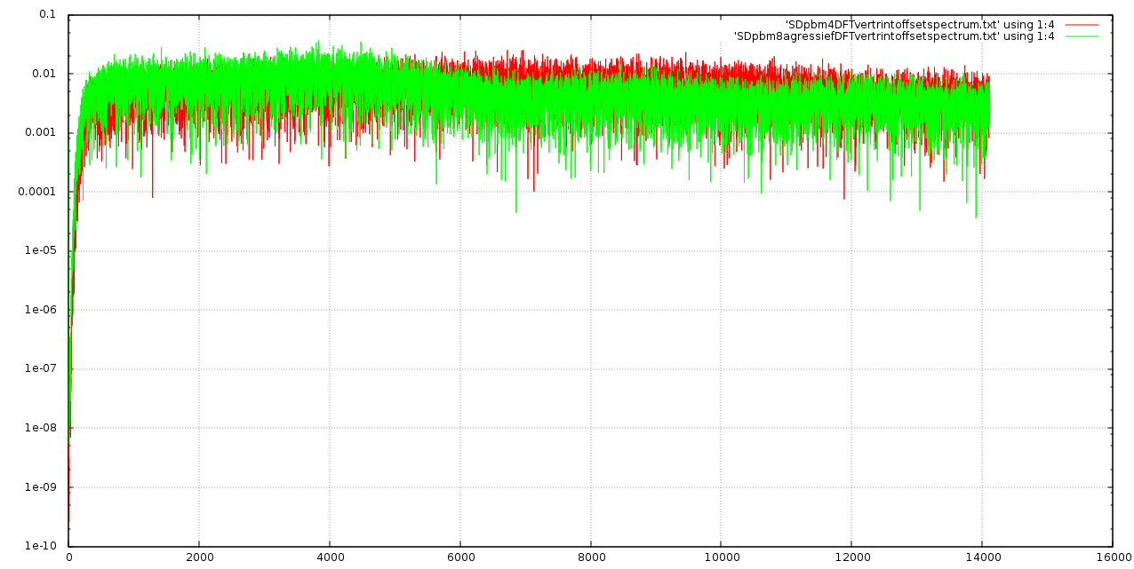

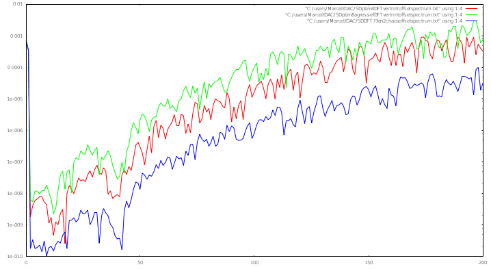

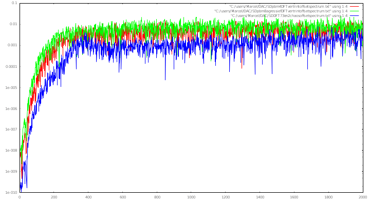

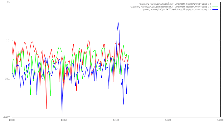

To illustrate the difference in out-of-band spectra, I've dug up a few old plots for the sigma-delta modulator algorithms of my valve DAC, simulated at 28.224 MHz with just a DC offset at the input. Horizontal scale in kHz, while on the vertical scale, 0.5 corresponds to 0 dB DSD and 0.05 to -20 dB DSD. The plots don't go above 14.112 MHz, but everything aliases above 14.112 MHz, of course.
Red: PWM4 quasi-multibit
Green: PWM8 quasi-multibit
Blue: very chaotic single-bit modulator
(One of the 0 to 14.112 MHz plots is without the chaotic modulator, so you can see the others better.)
Although the chaos reduces the tones around 14.112 MHz substantially (they are not nearly as high as the 2.8174 MHz tone of post #2696), the tone below 14.112 MHz is clearly visible for the single-bit modulator (and the one just above 14.112 MHz is out of the range of the plot). For the other modulators, I don't see any obvious tones.
Apologies for the poor resolution of the pictures.

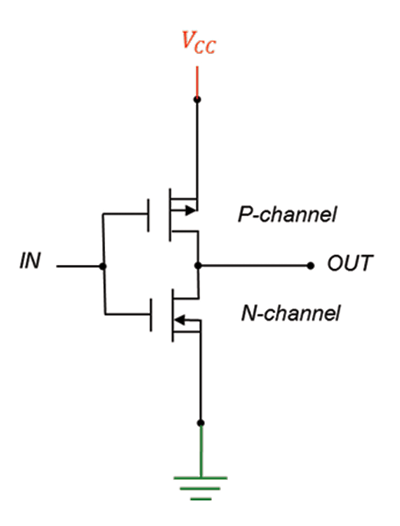

This is both a CMOS output and a CMOS input.
The input capacitance (Ciss) of the P-Channel input is linked to Vcc while the input capacitance of the N-Channel is linked to "GND" (remember, Ground isn't)
So with any transition one of these capacitors is charged while the other is discharged.
We all learn that in PCB Layout any high frequency signal trace should be matched with "Ground", which commonly these days is a ground plane.
BUT, for the P-Channel device actual "Ground" is Vcc and "Ground" is actually it's Vcc.
Thus in CMOS VCC and VSS should be treated equally. What amazes me that this was all in Ott's tome decades ago.

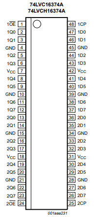

One idea to make Marcel's Firdac more effective in digital filtering , would be to change the two sets of 4 parallel shift registers into two sets of 8 registers in series, that implies just changing two connections.
This will change the first notch rom fs/2 to fs/4 and may help to cope in a better way with the HF noise.
Hans
At a DSD128 rate, that will theoretically improve the suppression of a tone 5 kHz below half the sample rate by 0.000135 dB while removing the cancellation of systematic mismatch between the flip-flops due to unequal on-chip wiring. It should make the audio noise floor somewhat less sensitive to the phase noise floor of the bit clock.
Yes.
The idea is that in every cycle, either U7 Q0 and U9 Q1 or U9 Q0 and U7 Q1 produce a pulse, in order to make the reference current as data-independent as possible. Adjacent flip-flops on the same chip will have relatively little random mismatch between them, much less than between chips of the same type, but there could be systematic differences between Q0 and Q1 due to different on-chip wiring. The swapped connections on the other 74LV574A are supposed to correct for that.
You will spoil that to some extent when you use the two 74LV574As as 8-tap shift registers. I can't estimate how much or how little effect that will have.

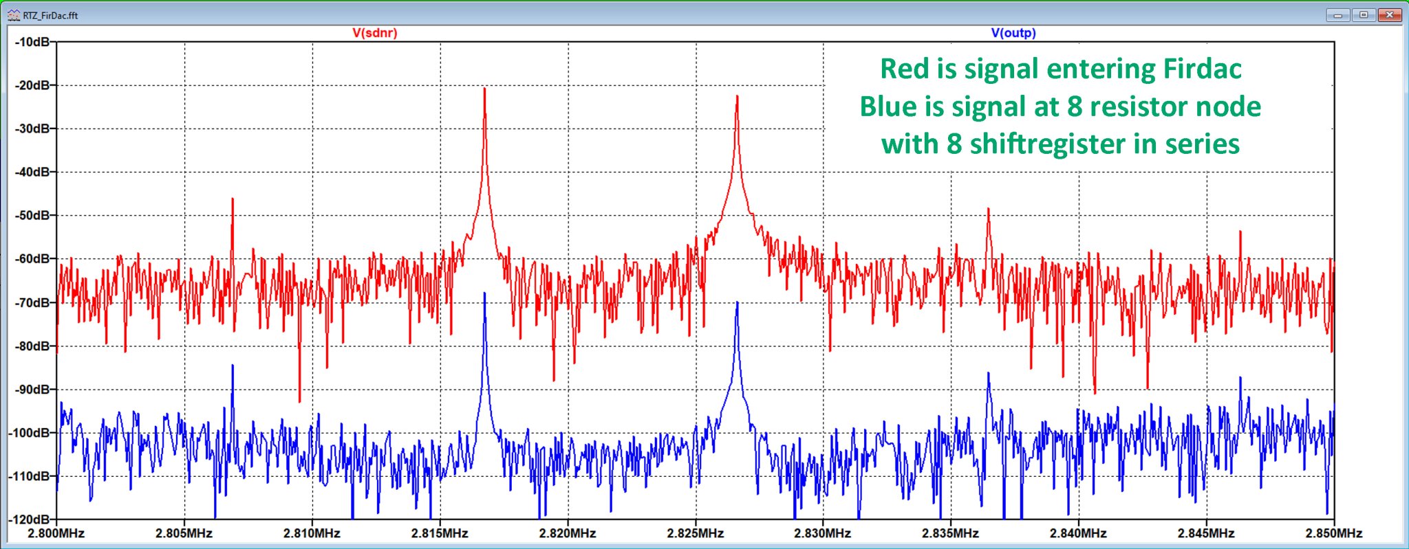

Regarding Sigma-Delta streaming signal processing for FIR filtering, please see the attached. It appears to involve requantizing, which may change the sound in some unintended way. For instance, please consider all the modulators in HQ Player. Many people find they all sound different, and not all of them equally good.

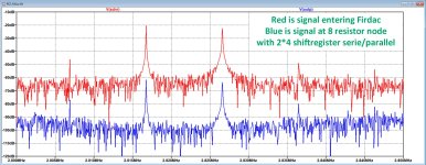

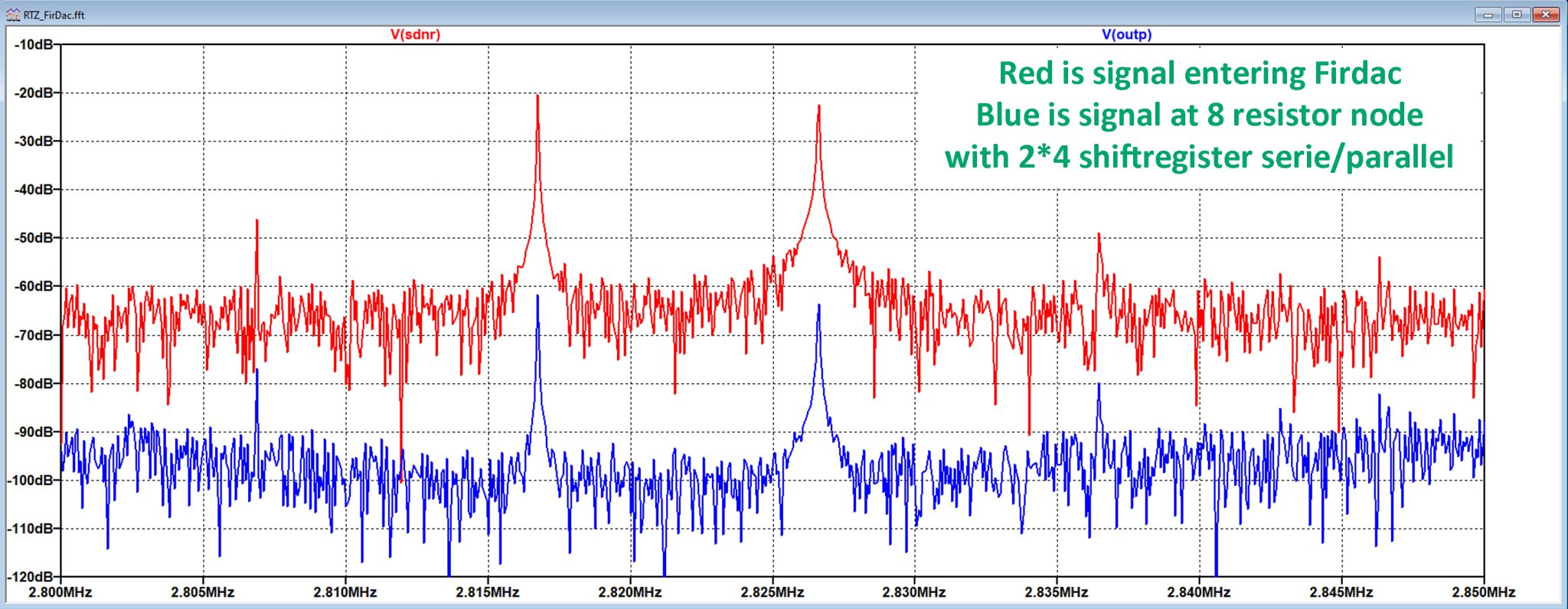

I compared 2x4 with 1x8, while using your DSD128 .dsf file with ca. 8mV offset, the output of the shift register connected to a 4th order Butt. filter.
For the FFT data was sampled with 1Ghz and no window function.
In the two images below, the spectrum is simulated from one of both signals entering the Firdac's shift register in red, together with the signal at the node where the 8 resistors are coming together, this output corresponding to the Firdac's input signal, in blue.
The 5Khz that you mention around fs/2 is clearly visible before and after the Firdac's shift register, but in case of 1x8, the 5Khz peaks are 6dB lower in level.
Hans
