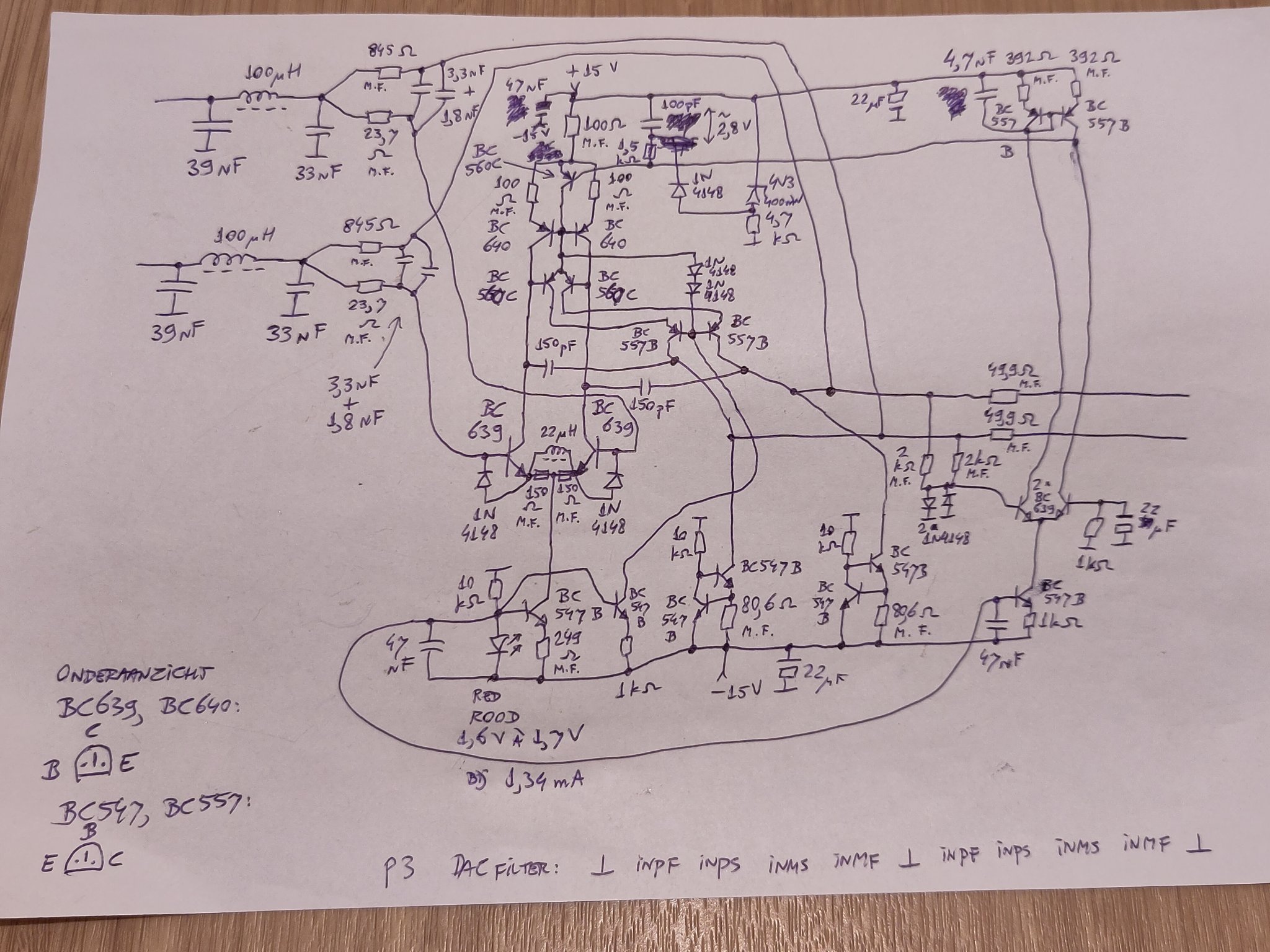

Marcel,
The proposed circuit performs well.
Since I did not have the BC639, I used a ZTX851, all other transistors as specified.
1) With the ZTX851, the 22uH inductor gave a slight hick-up around 8Mhz, without inductor the FR showed a steady downslope.
2) With this circuit there is no real SE output for those convinced that SE is superior.
3) Using the ZTX851, noise was 8.5dB lower as with the OPA2228.
Hans
P.S. I forgot to mention that CMRR is just ca. -70dB with perfectly matched transistors and resistors up to 1Mhz with a -50dB peak at 100Khz.
Do you think this is good enough ?

No idea how well or how poorly my discrete filter works yet, but at least it is stable.

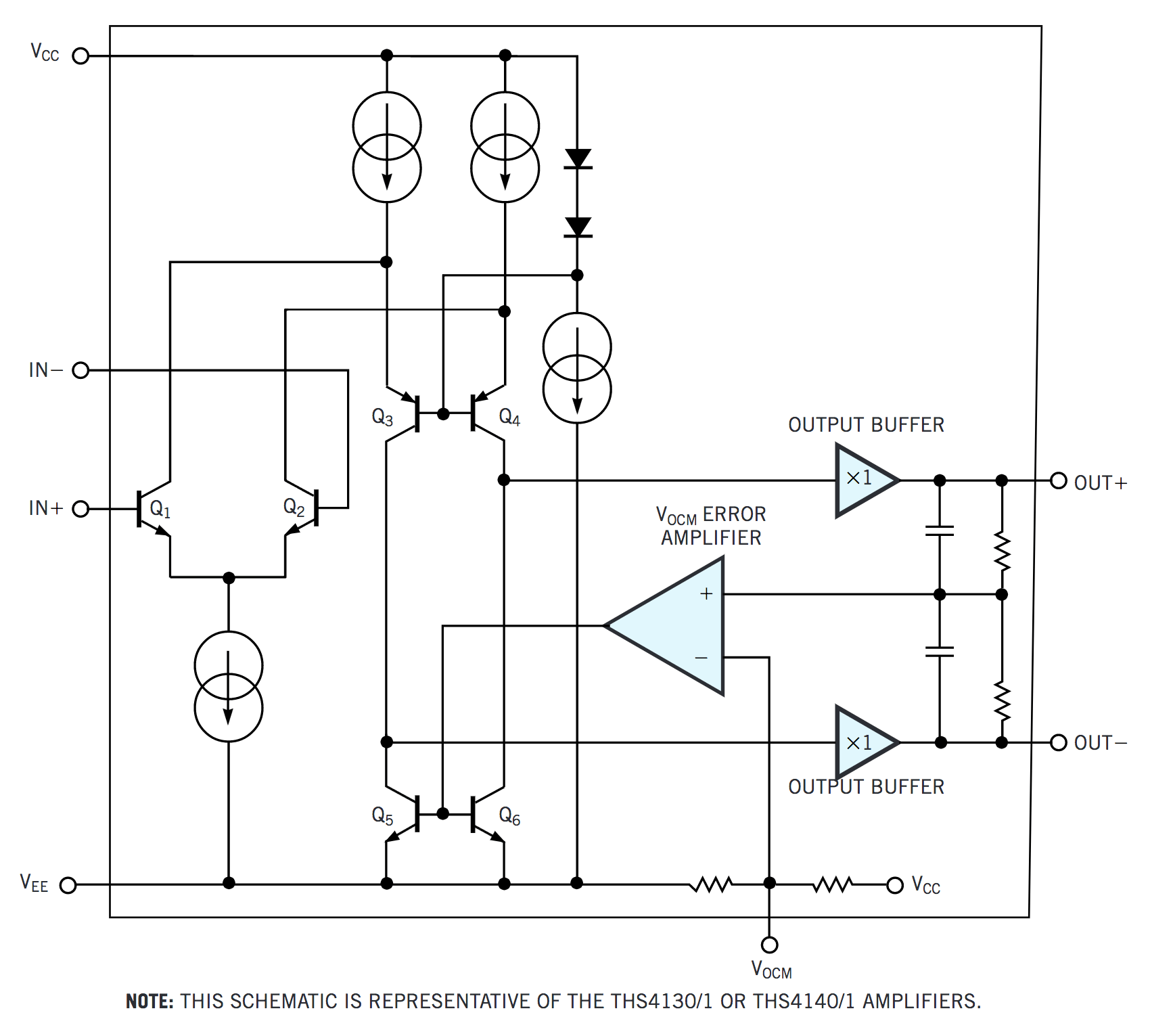

Did you consider a folded cascode FDA type structure?
If the output buffers are fast enough, this should be unconditionally stable as there is just a single gain stage.

Why the variety of transistor ?my discrete filter
I have a cascoded differential pair as second stage, rather than two voltage followers - a differential pair because it reduces the signal swing at the first stage's output and cascoded because a back-of-an-envelope calculation based on Cherry and Hooper's differential gain equations showed that Early effect would be a dominant source of distortion in the second stage. Except for the right half plane zero and the polarity, there is not much difference between the response of a current-driven emitter follower with a capacitor to ground and a current-driven common-emitter stage with Miller compensation.
Regarding the polarity, with a finite tail current source impedance, my circuit has inherent positive common-mode feedback while one with a voltage follower second stage would have had inherent negative common-mode feedback. For my circuit, the common-mode loops need to be strong enough to prevent common-mode latch-up or instability. It is not a very big disadvantage, but it is a disadvantage.
In any case, the common-mode stability issues I had were due to an incorrect calculation of the common-mode loop transfer.
The BC639 and BC640 have far lower base resistances than the BC546 to BC560 family, but those have more current gain and somewhat higher fT's at a given current. I've used the BC639/BC640 where voltage noise matters and the BC546...BC560 family everywhere else.
By the way, I originally wanted to use an antiparallel connection of PNP transistors for the input stage, but settled for antiseries (that is, a differential pair) because I found no practical way to bias the antiparallel version. With a PNP differential pair, the circuit was essentially the present circuit upside down: PNPs and NPNs and positive and negative supply swapped compared to the present circuit.
When I later started thinking about what might go wrong if one supply starts up faster than the other, I figured that the current sources from the positive supply might blow up the DAC core if they would become active before the negative supply came up (reference supply lifted via the ESD and drain-bulk diodes in the shift register). I could fix that by either adding some circuitry to prevent the current sources from starting without a negative supply or putting the whole thing upside down and settle for an NPN differential pair input stage.
Some rough noise measurements showed that the base resistance of the NPNs was low enough not to dominate the noise, so I simply went for the NPN input pair version.
Marcel,
Interesting. I would have expected a small aberration around the corner frequency of the zero determined by 22 uH and two times 150 ohm, but that should be roughly 2.2 MHz.
You can still use only one output if you want to.
Hans
At first sight, I'd say it is still good enough to ensure passive filter component tolerances will dominate. Did you look at the ratio of the differential and common-mode transfers?
Very interesting. Can't wait to find out how it sounds. However a little concern about the 22uH inductor (understood its there for good reasons). Hoping a good part for its intended purpose will be found.
It's just a frequency compensation component inside a feedback loop. It should be far less critical than the 100 uH inductors.
Yes, but the signal at one output will still be determined by both Firdac outputs, other than in the current filter where one output has the processed info of just one Firdac.You can still use only one output if you want to.
No, I looked at the ratio of output versus common mode input.Did you look at the ratio of the differential and common-mode transfers?
Hans
Wasn’t that exactly what Mark did and maybe others also ?With the original filter, each output signal depends on both FIRDAC outputs as well, unless you disable the common-mode loop somehow
I’ll show the CMRR simulation tomorrow.I don't understand what you mean by your last sentence.
That will answer the question.
Hans
Of course. So your point is that compared to the original filter, it is more difficult to modify this filter such that the single-ended output signals each depend almost exclusively on one of the FIRDACs. That's true, of course.
