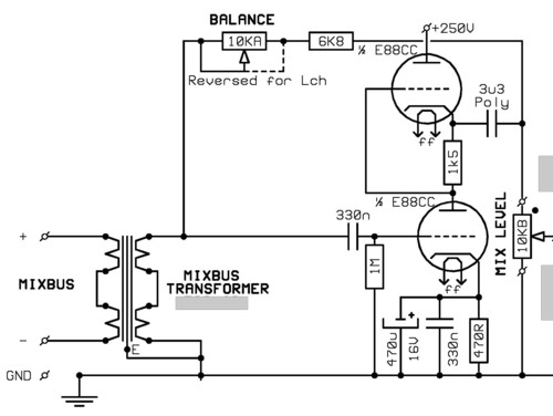

Here a principle design of a Mix-Bus with a zero field transformer (Gyraf G-16 Active Summing Mixer):
The DAC's current and/or resistors form the input resistors of the Zero Field Circuit.
The tube stage can be anything you like, you could (for arguments sake) do a 12AX7 with 12AU7 Cathode follower instead of an ECC88 SRPP.
Ideally the transformer is low DCR and for a DAC that likes to see a virtual ground, use a large step-up (like 1:10).
The transformer output operates into an active virtual ground the impedance of which is down to the OLG of the Amplifier. If we can make the impedance negative we can compensate the winding DCR.
Used like this the transformer sees very little signal levels and thus distortion is minimal, also - frequency response becomes very wideband.
There is very little loading on the dac to unbalance it.

If you are "in the middle" all bet's are off. Either a (virtual) ground (see zero field above) or open circuit are best.
With ESS 9018 the best sounding setup I ever found was a 10K:10k mu-metal core transformer with +26dBu @ 50Hz level handling, followed by a Cathode follower (more precisely, an Alan Wright SLCF with a total of 2 double triodes and +/-200V rails, DC coupled output, "Romy Da Kat DC coupled servo Bias". Transformer connected BAL in SE out.
So Signal path:
DAC -> TX BAL in -> TX SE out -> 1 Resistor, cascoded triode as follower, cascoded triode as CCS/White follower
But that needed a heroic transformer just to handle 2V RMS from the DAC in voltage mode with low distortion.
I never tried a zero field setup, but as the TX vendor send me the wrong item and will not change it, I now have the opportunity to try it out with ES9038 on a Rod Rain DAC PCB.

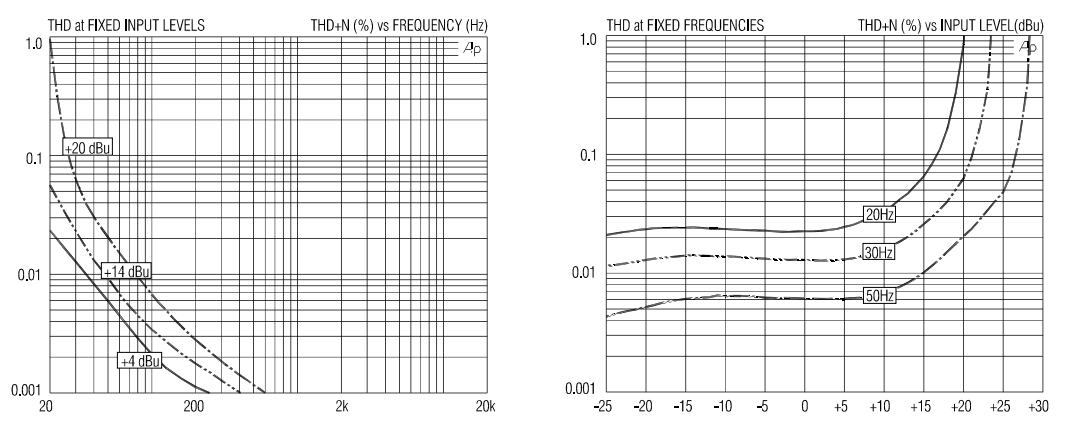

Level vs frequency and distortion for an extremely respectable line input transformer (10k:10k)
from:
Jensen JT-11P-1 Transformer Data
As we see, as little as +4dBu / 1.23V input voltage exceeds 0.001% THD or -100dB below 250Hz, which is the music's foundation. Due to the underlying mechanics this HD will be H3 and odd order.
HD goes up pretty linear level for any given frequency.
So for +10dBu (2.46V) distortion will double for a given frequency.

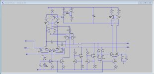

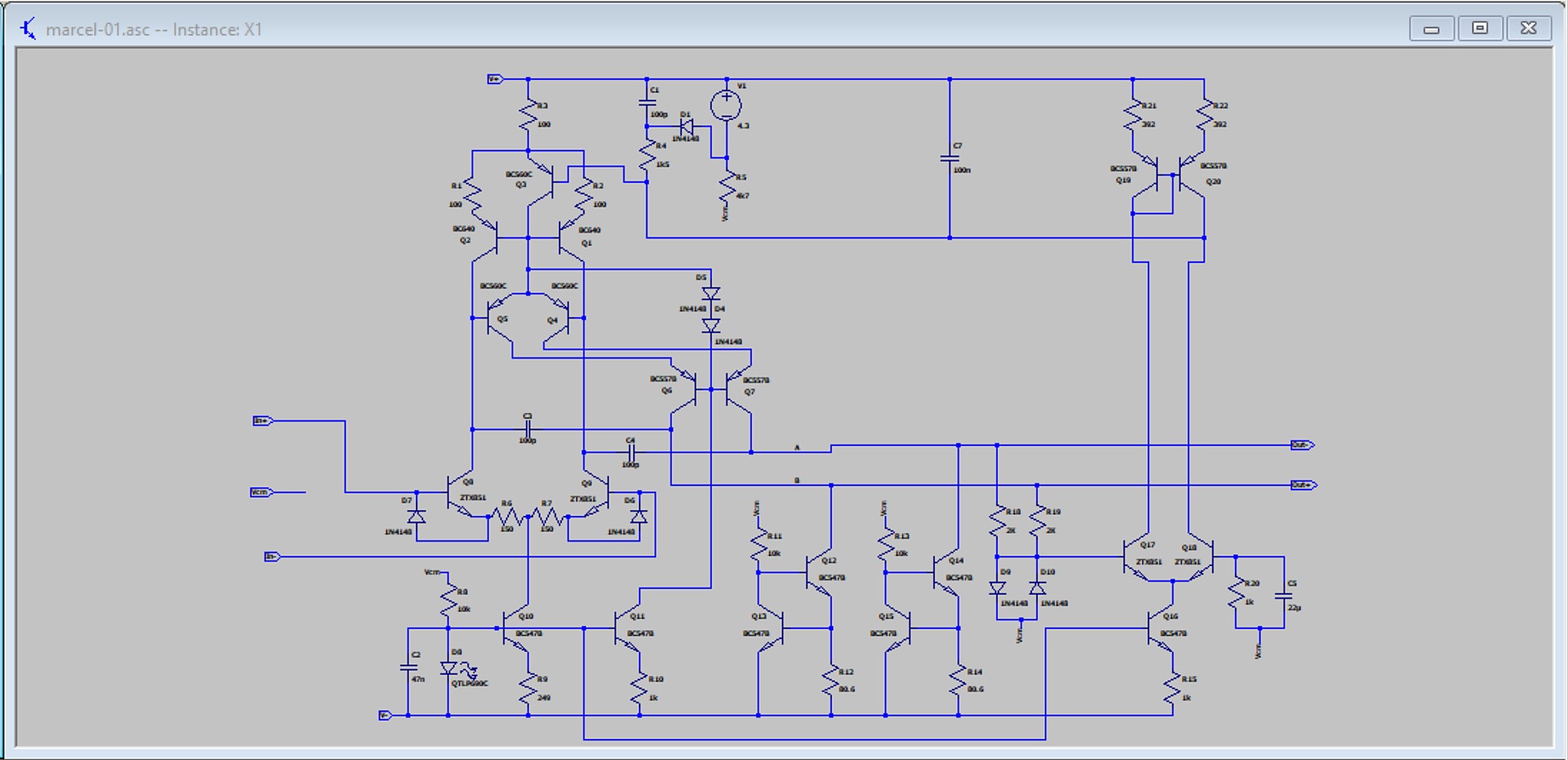

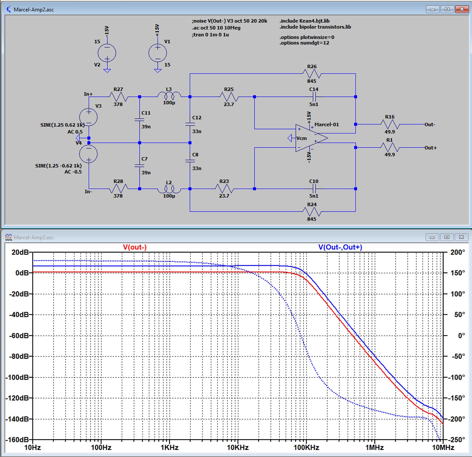

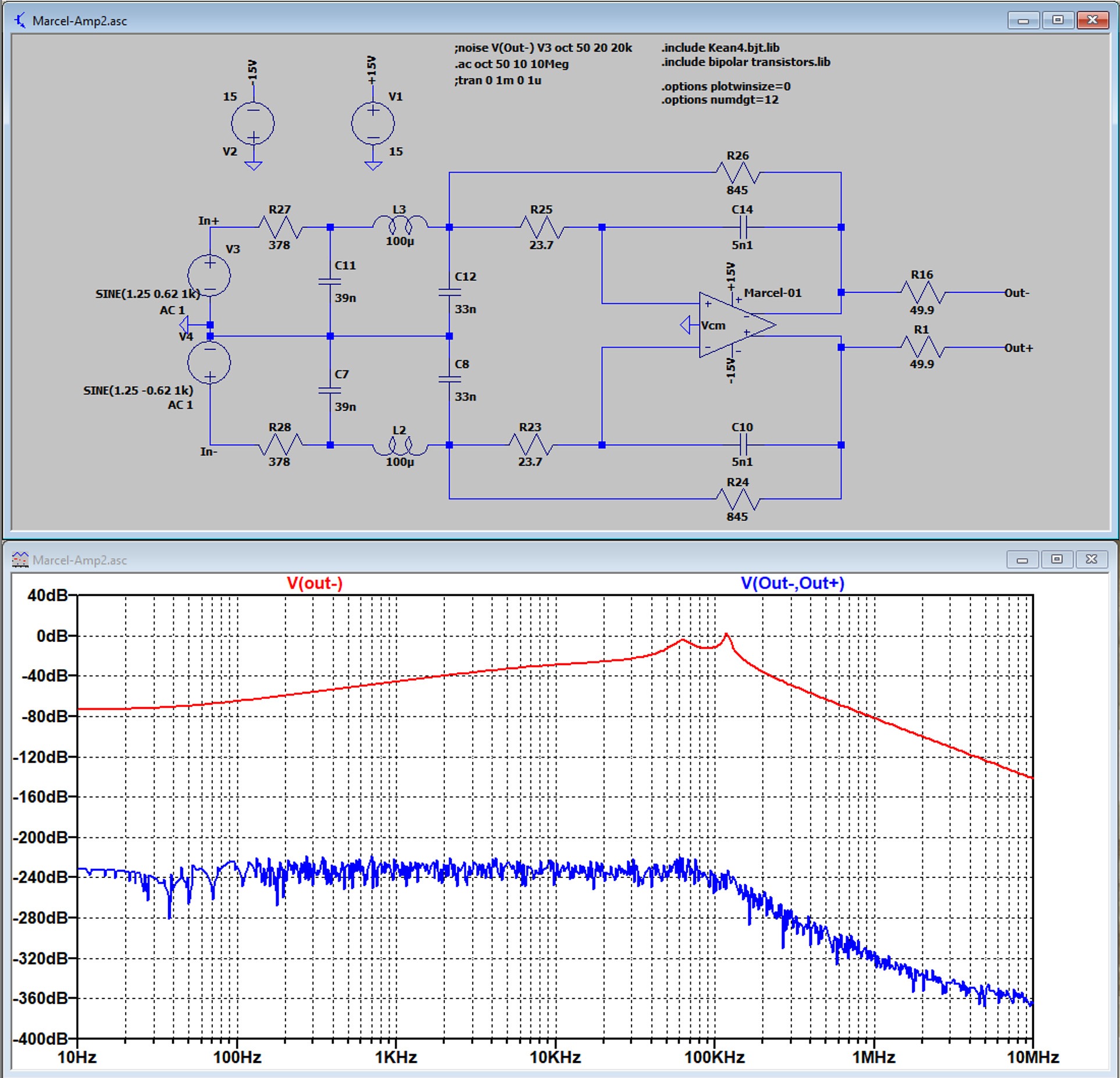

Yesterday I looked at the proposed Marcel circuit only in AC mode and at its noise production.
Today I also simulated in Transient mode and found that the amp was oscillating.
This was caused by the part at the right, responsible for shifting the output signal to around zero volt.
In the upper right corner of Marcel's proposal in #3304, there is a 4.7nF cap inserted on one side of the current mirror.
Increasing or decreasing it's value didn't bring a solution,
So, I had to remove this one and add a 100nF cap to the other side of the current mirror, called "B" in Marcel's sketch.
Also the 22uH at the input pair could be discarded, at least with the ZTX851's that I used, because I was not successful in finding correct spice models for the BC639.
I made a subcircuit from the proposed amp and called it "Marcel-01" see first attachment.
In the second attachment the subcircuit is inserted in the complete filter design, driven by the two Firdacs represented as voltage sources with a serial resistance of 378R.
In the second attachment also the FR is shown, both SE and Diff for 0dB input, directly showing the overall gain.
The third attachment shows the CMRR on the SE and Diff outputs for a 0dB signal on both inputs.
The CMRR in Diff mode is excellent, but in SE has worsened at higher frequencies because of the the added 100nF cap that was needed for stability.
Maybe there is an alternative solution to get the amp stable that does not affect CMMR in SE that much..
Hans
The huge transistors you use for Q17 and Q18(?) probably cause the pole and the right half plane zero of this differential pair to end up too close to the origin.
BCP53 and BCX53 are supposed to be equivalent to the BC640, and BCP56 and BCX56 to the BC639. Maybe you can find Spice models for those.
If not, if LTSpice allows fractional m or mult factors (I don't remember which of the two is Spice syntax), you could give your ZTX851's an m factor of about 0.1 to 0.2.
Removing the 22 uH degrades the noise performance at high frequencies, as should be obvious from inspection of the circuit.

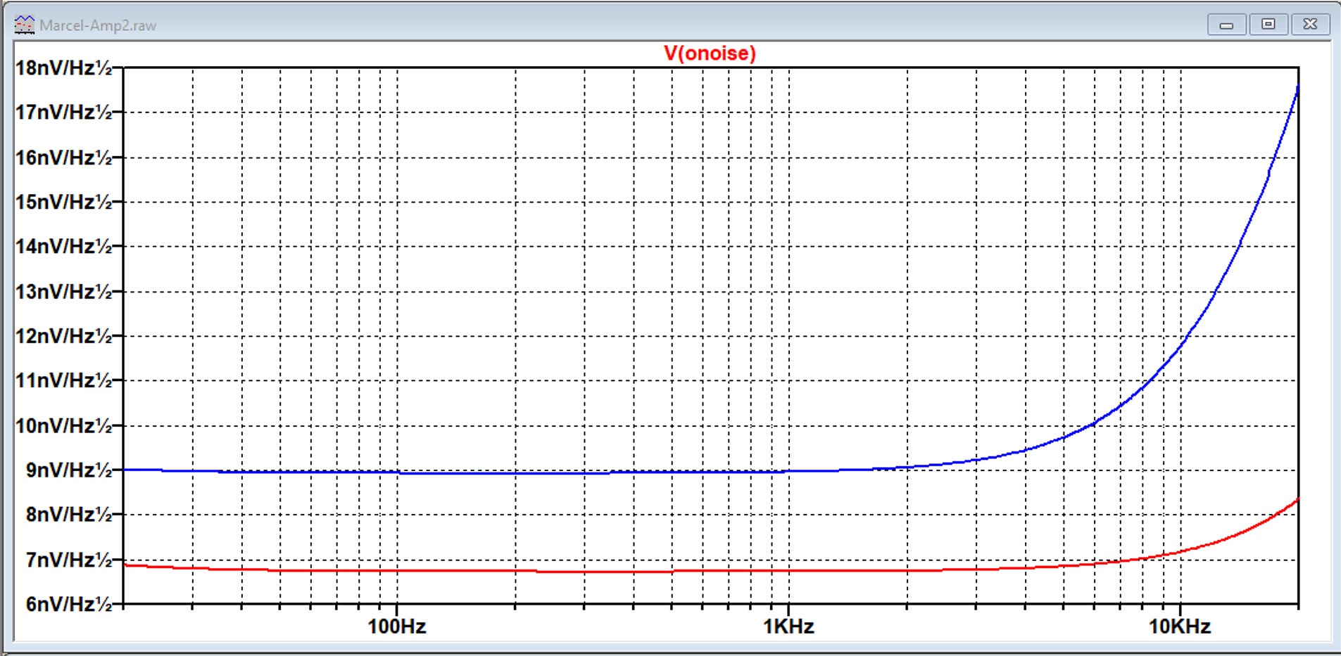

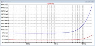

Marcel,
Yes, you are right, adding the 22uH reduced the noise at high frequencies, so it must stay.
See attachment with SE output noise for 22u in Red and without inductor in Blue, resp. 1.0uV and 1.8uV from 20Hz to 20Khz.
I also tried the BCP56 that you mentioned instead of the ZTX851 and indeed C7 the 100nF cap could now be removed without affecting stability.
I could also put the original 4n7 cap back, but saw no difference in stability.
Because of the 100nF that's no longer there, the CMRR has also been greatly improved at high frequencies.
See second attachment.
Hans
