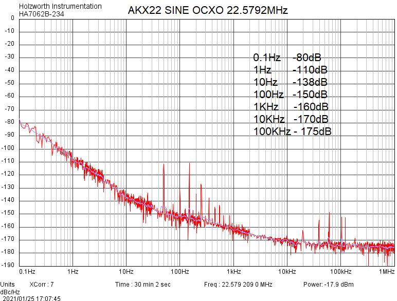

The next concern is clocking. I have got clocks that are higher performance than others (I think?). Shown attached. Both sine and hcmos types are about the same in terms of phase noise performance. All in a compact module. I can use this to drive my own DACs directly and can be used with Marcel’s also without the need for converters. Andrea’s one is lower performance sine type to start with and then after conversion on his fifo board is even worse. As you mentioned, it very important for DSD clocking with low jitter clocks. So, how can I bypass the on-board clock circuit and feed a better one. I do remember Andrea mentioning about his sonic empire clocks that address the loss of quality, any news on this?
There is a board to bypass the FIFO completely. It converts DSD over I2S bus into the signals needed to run the dac board. If you want to use your own master clocks and not use the FIFO board then you probably have to design your own RTZ circuitry or copy something like Marcel's
Once you have the RTZ data signals, a way to select clock families, and a master clock divider for DSD sample rates below DSS256, then you can reclock the prepared I2S bus signals using your master clock. Of course, you may want to have phase noise measurement gear on hand to test performance and make sure its up to your specifications.
Also, you would probably also want to send copies of your master clocks to your USB board so that it operates synchronously with your other clock circuitry.
Basically, you would have to do the same thing with Marcel's dac since his digital circuitry is probably not going to preserve the phase noise of your clocks. You would have to reclock all signals before they go to the shift registers. Then the shift registers will probably degrade the phase noise.
My guess would be that the UHS logic family reclocking D-flip flops that drive the resistors on Andrea's dac board will probably preserve your phase noise better than shift registers.

Bottom for me, If I were going to use that FIFO I would design my own master clock board and reclock every signal after it left the FIFO.
Again if it were me and if using MCHStreamer I might consider hacking it and feeding it my own clocks. Then I would just reclock the I2S output signals and skip the FIFO.

Actually, the point I was making: the sine-to-square circuit on fifo-lite board look similar to his stand alone module - degrades the incoming clock quality to start with. Unless improvements has been made on his fifo version.There is a board to bypass the FIFO completely. It converts DSD over I2S bus into the signals needed to run the dac board. If you want to use your own master clocks and not use the FIFO board then you probably have to design your own RTZ circuitry or copy something like Marcel'sOnce you have the RTZ data signals, a way to select clock families, and a master clock divider for DSD sample rates below DSS256, then you can reclock the prepared I2S bus signals using your master clock. Of course, you may want to have phase noise measurement gear on hand to test performance and make sure its up to your specifications.
