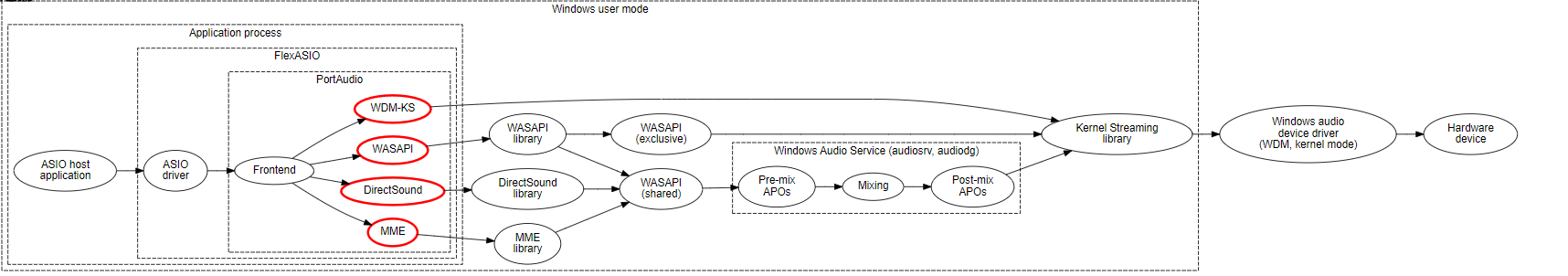

ASIO or WASAPI Exclusive should sound the same for DSD. They may or may not sound exactly the same for PCM, depending. The main difference between the two drivers for DSD is that for some USB boards it is possible to play higher sample rate DSD if using ASIO.
Here is the the thing, for PCM in particular you want to avoid the part of the Windows sound system labeled as "Windows Audio Service" in the diagram below (don't know what it might do to DoP):
The problem is that plain WASAPI, which is shared, goes right through Windows Audio Service which will then resample your audio without telling you if it thinks it needs to. In many cases it will probably think it needs to. If that happens then SQ will suffer somewhat. Not everyone notices it though. They just live with inferior sound without knowing it.
Also, the diagram above is from the FlexASIO documentation. The ASIO driver shown in the diagram is for FlexASIO or ASIO4All, not for full-blown ASIO.

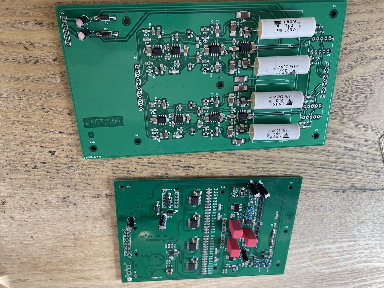

So I tried a very low voltage current limited start up of each board seperately. Hmm something is shorting on both boards, but only after I move from 1V to 2V.
Turns out I have my opamps soldered in backwards
All follow this so it will be a little job. I suspect that there's no damage (certainly nothing appears to be bad electrically other than the wrong way around). So that's the next task when I have some time and I'm not too tired. I could kick myself as the long line obvious points to pin 1 now I look at it.
Oops, good thing you had a current limiter...
When you swap the positive and negative supply pins of just about any IC in a junction isolated process, you forward bias lots of substrate diodes all over the chip. It's usually destructive without current limiter and harmless when the current limit is set low enough not to overheat anything.

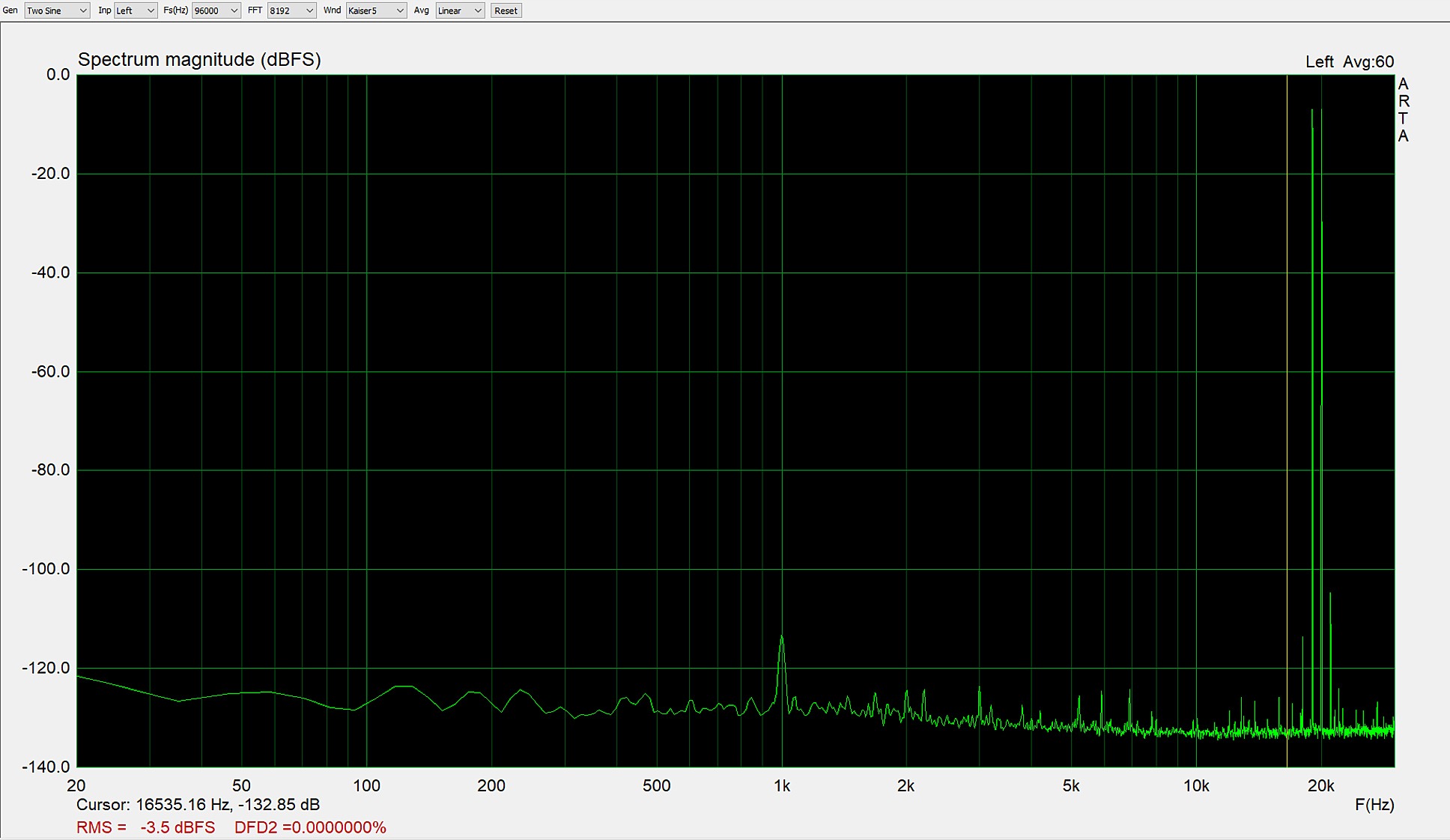

During discussions with Hans Polak, it was found that it can sometimes be handy to have a DSD file with repetitive 101010... patterns. For a FIRDAC with a notch at half the sample rate, it eliminates ultrasonic quantization noise, folding effects due to ultrasonic quantization noise and non-linearities or crosstalk issues, and it largely suppresses the effect of far-off clock jitter, leaving only the plain old analogue circuit noise. Attached is a zipped dsf file with just over one minute of 101010... in DSD64. Mind you, the file becomes more than 1000 times larger when you unzip it.

First - the correcting the filter board opamps. The board is pulling 37mA on both +15 and -15V rails. After painstaking operation.. seems ok for now.
Next - the DAC itself..
So I've completed correcting the orientation of the ICs in the DAC, the 15 supply draw seems ok at the moment, currently running through the logic section and that seems ok running the clock and a channel with a siglent sig gen. Seems ok so far but I have to go through the other channel too.
