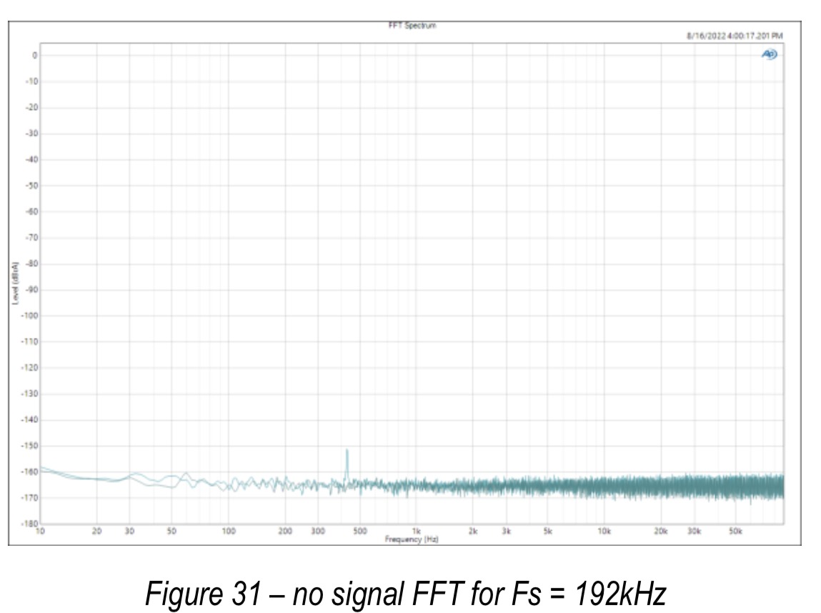

It is not possible to tell what shows or doesn't show in FFTs without seeing the FFT. So no need to repeat that ad nauseam.

You are entitled to your opinion but repeating it does not make it "the truth". And without measuring you cannot know if it can be measured.IMHO most likely the answers will turn out to be some collection of whatever isn't being measured very well.
Everything physical can in principle be measured. And everything is physical. So the question might arise as to what could be we be measuring that we aren't? How could we do some meaningful non-PSS measurements? Should be possible. To some extent it has already been discussed before. How about leveraging the Hilbert Transform for envelope detection of a pulsed or stepped amplitude sine wave? It can be done, I'm just not crazy about doing all the work myself. This is a hobby, not paid work.
