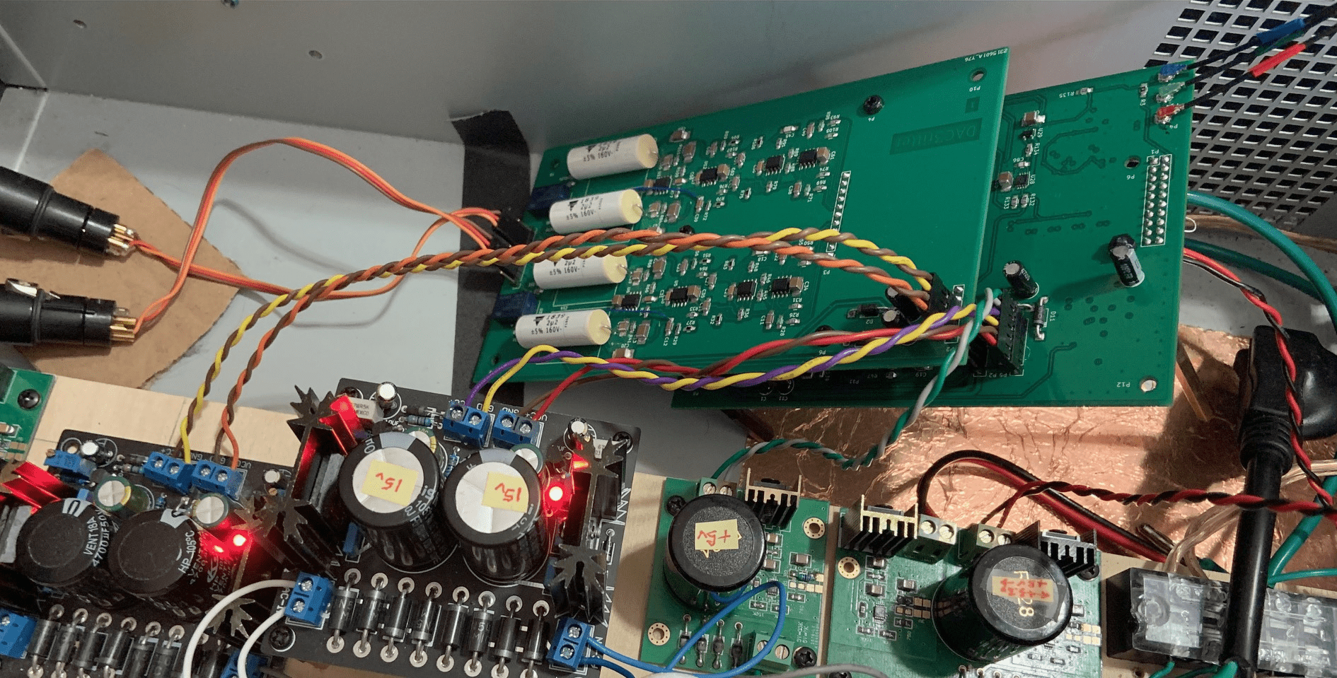

As an update, we have done some more listening here. Find there are some tradeoffs between using the filter board as versus the passive filter. Therefore, some experiments are being lined up to see if certain changes the output board will help or hurt. Don't know, really could go either way. Also, as Hans has been suggesting, the filter board will get its own clean voltage regulators. That in itself may help some. Also, some more parts will arrive at some point to see if we can further improve clocking. Aim is to learn as much as we reasonably can from having the dac on loan here. However, could be be less frequent between reports going forward as some of these things may take some time. Have to see how it goes.
Present status of dac looks like this:
One end or the dac is tipped up for the u.fl cables to reach (which will be fixed later when the clocking is revised). Change this time was to run the filter board on clean +-15v power. As usual the only shared grounding is at the load (at the filter board in this case). This modification did change the sound in a way I like better. Vocal sibilance in some performers who tend to have more of it now sounds, for example, less like a lisp and more like normal 's' sound. Similarly cymbals now sound less like bursts of noise and more like real cymbals. Maybe some more comments on the change later after more people have listened.
EDIT: Now running analog output to line amp in SE mode, which sounds more clear. Balanced sounded more muffled and blurred in comparison. Would not call the difference subtle IMHO.
