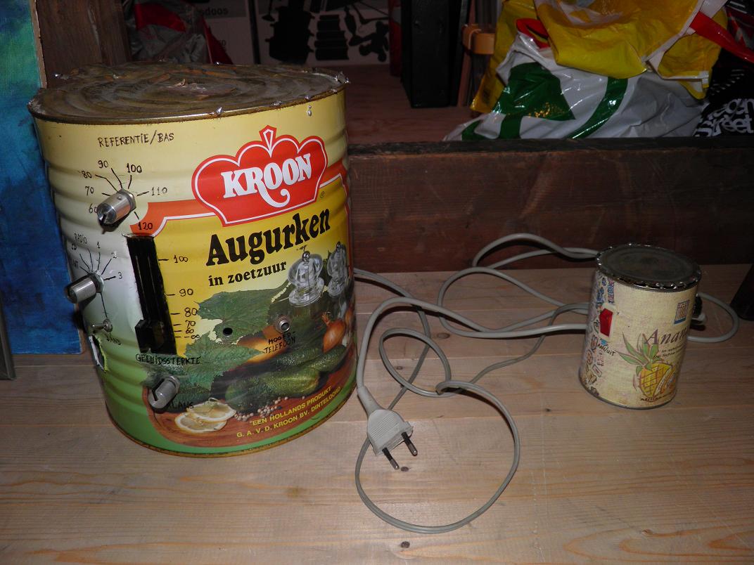

I don't know when I will have the time to actually do it, but here is what I will do:
I'll take my old preamplifier from the attic. It is completely discrete, single-ended and class A and has a headphone amplifier built in.
I'll hook it up single-endedly (it only has single-ended inputs anyway) to the prototype RTZ shift register FIRDAC, which I will modify such that I can use my ABX switchbox to switch between large and small common-mode loop bandwidth. The FIRDAC will be driven from the digital part of my earlier solid-state DAC, which will be driven from the S/PDIF output of a DVD player. Everything is double insulated, so there will be no ground loops.
I'll do 20 trials with the digital part of the solid-state DAC in PWM8 mode (which results in a relatively clean out-of-band spectrum; lots of noise but no idle tones or other aberrations) and 20 with it in chaotic mode and report the raw results.
For what it's worth, the last time I was involved in organizing a blind test on this forum, a test related to DAC pre-echoes, there were six participants, five of whom were convinced they clearly heard a difference but had completely random results, and one who wasn't convinced at all that he heard any difference and who had everything right except for one recording - a recording he complained about, because he considered the sound quality to be insufficient. (He complained before the results were published.) He did worse on a retest, but again had the largest pre-echoes correct on all recordings except the one with insufficient quality. Unfortunately the test was too small to really draw hard conclusions. See the attachment for details.
