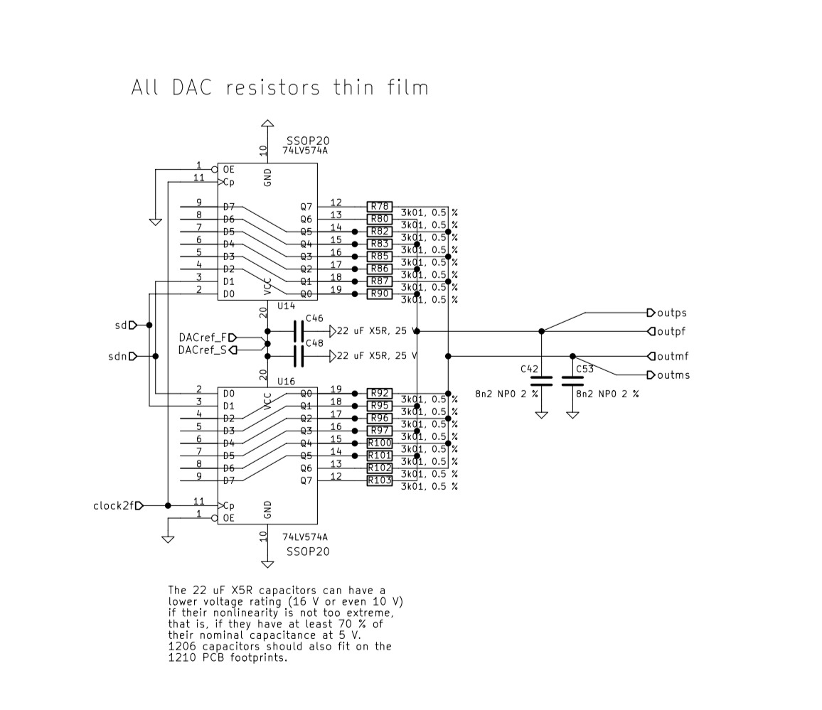

Each shift register is slightly non-linear because the high output resistance is different from the low output resistance. Looking at both shift registers together, the number of high outputs is independent of the data. Hence, the effect of the unequal resistances largely cancels when you look at the differential output.
Regarding matching, when you look carefully how the flip-flops are connected, you will see that there are really four four-tap shift registers, two for the non-inverted and two for the inverted data. U14 and U16 each form a shift register for the non-inverted as well as the inverted data, but the flip-flops that handle the inverted data in U14 handle the non-inverted data in U16 and the other way around. That's all done for matching: taking advantage of the close matching between flip-flops on the same chip and cancelling the effect of unequal on-chip wiring to the supply and ground pins.

Absolutely. We use differential pairs for all sorts of things.There is nothing wrong with using a differential structure to cancel out some imperfections.

As you don't have the schematics of Andrea's dacs it is somewhat difficult to judge whether or not nothing has been left to chance. E.g. the reclocker & isolator you presented in #1259 seems to use single flip flops which may lead to metastability.Regarding the comparing of dacs. To clarify a bit, Acko has been asking about both dacs in other than just this thread. Also, the dacs are both RTZ FIRDACs so it is kind of natural to compare them. They do differ in design philosophy in some ways however, with one more like leaving nothing to chance, no stone unturned, and so it costs more. The other is going more for elegance and aiming to only do as much as really needs to be done to get the desired result, so it is less costly.
Didn't say I haven't seen any schematics at all, only said for this DSD dac. Also didn't say I don't know how to reverse engineer a dac from inspection, scope measurements, etc.
One concern I have here is that its not my place to give away certain details of Andrea's technology no matter how I come by the knowledge. That's up to him. Or someone else, if they want to buy one to reverse engineer.
Regarding the reclocker board I posted a pic of, think I said its an accessory board for the FIFO board. The FIFO board transmits signals synchronously so that metastability at the accessory board should never occur. It it does then there is a bad cable or something that needs troubleshooting.
