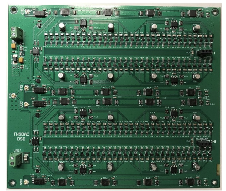

Looking at all the different boards he is offering, it’s quite a busy chap.
And looking at his DSD board, it seems he is using a very long Firdac, with most likely different weight factors to relief the function of the reconstruction filter.
Hans
Doesn't use different weight factors. I swapped hundreds of resistors to see how they sounded compared to the ones that came with the dac. Didn't find better ones, but found some considerably worse. Current/excess noise seems to be the main factor. Unfortunately, its not something usually specified for metal thin film resistors.

IIUC the long FIRDAC structure is mainly to desensitize the dac to clock doublers.
Anyway, if you study the pic carefully you can figure out quite a lot.

Instead of the 8 resistor output of Marcel’s Firdac, I count 32 resistors, so the first sinc zero will be 4 times lower, potentially resulting in a simpler less demanding analog reconstruction filter.Doesn't use different weight factors. I swapped hundreds of resistors to see how they sounded compared to the ones that came with the dac. Didn't find better ones, but found some considerably worse. Current/excess noise seems to be the main factor. Unfortunately, its not something usually specified for metal thin film resistors.
Hans
It could also be eight times lower. My FIRDAC has four taps with (ideally) half bit clock cycle delays between them and with equal weights, so uniform weighting over two bit clock cycles. See post #1342 for an explanation why I use so many flip-flops and resistors per tap.

Marcel,
I never looked in detail to U14 and U16,
but now that I did I have an understanding problem.
The same signals clocked into U16 in D1, D3, D5 and D7 are at the same time also clocked into U14 in D0, D2, D4 and D6, contributing at the output in both cases as the same 4 bit summed total, say Sum1.
Exactly the same happens into U16 in D0, D2, D4 and D6 being equal to U14 in D1, D3, D5 and D7 in both cases again contributing at the outputs in the other 4 bit equal summed total say Sum2.
The summed 8 bit outputs of U14 and U16 now become in both cases Sum1+Sum2, so completely identical instead of complementary.

Look carefully how the resistors are connected. The eight outputs of U14 are not summed. The resistors average or sum (depending on how you look at it, in Thevenin voltage or Norton current) four outputs of U14 with four of U16.
The noninverted data with zeros in between are shifted to the even outputs of U14 and the odd outputs of U16, and then averaged/summed with eight resistors.
The inverted data with zeros in between are shifted to the odd outputs of U14 and the even outputs of U16, and then averaged/summed with eight resistors.
These averages/sums are therefore in antiphase.The filter takes their difference.
