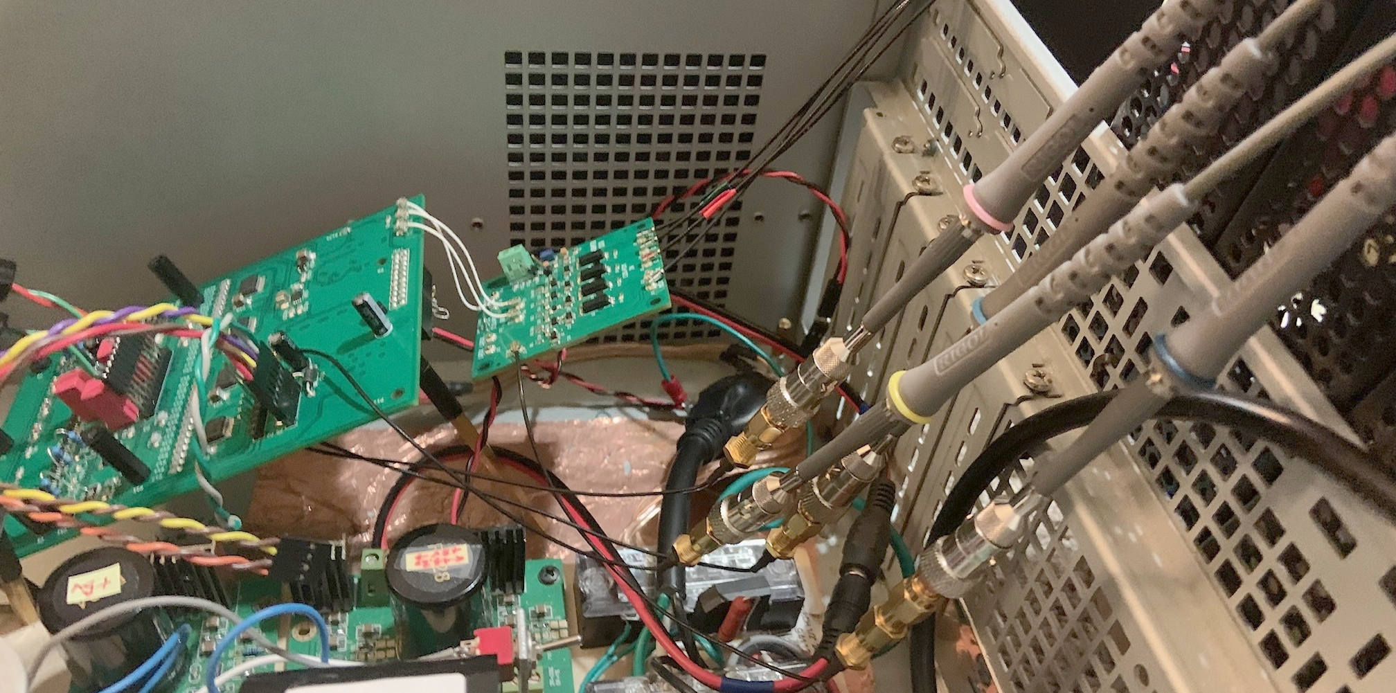

The crystals are in the Acko Labs AKX-22 clocks. They clock Andrea's FPGA-based FIFO buffer board. The FPGA outputs the clock and data signals to drive Marcel's dac. However, the FPGA outputs are not isolated and reclocked, as Andrea does those things on his dac boards. So what this board I just added does is isolate and reclock the FPGA outputs. It also allows Marcel's dac to be fed over very short length coax cables.
Nothing. I was trying to explain to Hans what was in the picture to start with. Conceptually your dac takes the place of Andrea's dac in the picture, so just imagine Andrea's PCM dac being replaced by your dac combined with the reclocker board hooked up as it is now.
OK, so the DAC isn't driven by a bit clock that comes straight out of an FPGA, but rather by a flip-flop on a reclocking board, and the data going into that flip-flop come from the FPGA. Thanks, that makes sense.

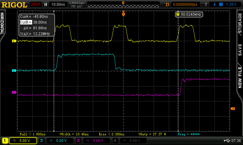

Decided to install some u.fl connectors on Marcel's dac dac. They will allow connections to the clock and data lines going to the shift registers. First they will be used to capture scope traces of the existing signals. After that the existing drive circuitry will be disconnected by removing the series termination resistors. External clock and data signals can the then be introduced through the u.fl connectors. Part of the reason for doing it this way is to make it reasonably easy to undo the changes and revert to original operation. Also probably better to have connectors on the board rather than delicate, small coax pigtails hanging off. Downside is that installing connectors is a bit tedious, and for me it requires working under the microscope. Probably ready to try playing SACD rips (DSD64) with reclocked BCLK before too much longer.
