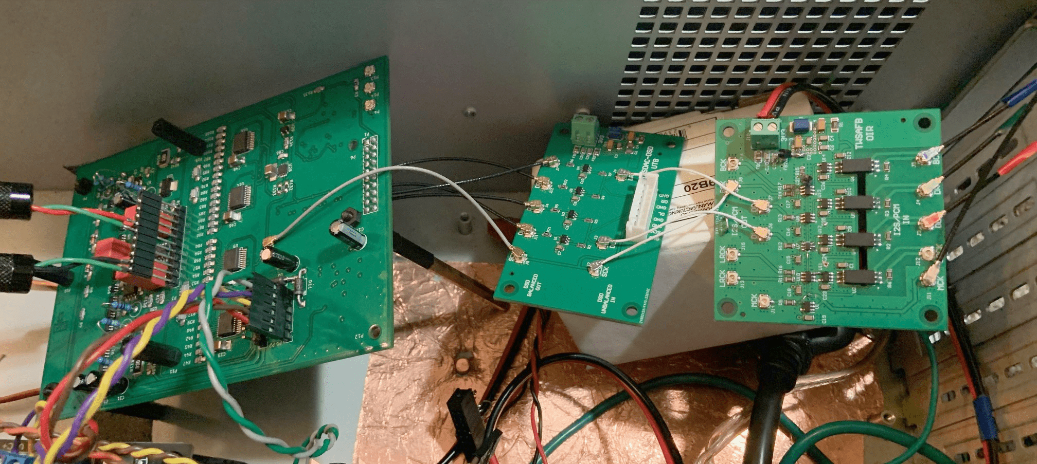

Here is what the present setup looks like:
Sound is getting increasingly precise with the crystal RTZ, but I also hear more clearly an ugly HF distortion and 'S' sounds that are too 'Sh' sounding. Also, at the moment playback is limited to no greater than DSD128 due to use of the reclocked BCLK (instead of using MCLK) to clock the dac.
Maybe will try some things to see about the bright, HF distortion (or correlated noise, whatever it is). Looking at the schematic it appears the are some 22uf, X5R caps to ground at the power pins of the shift registers (on Vref!). May try replacing those with some SMD film caps or something to see if the power supply is a source of some remaining issues.
Also at some point want to get DSD256 working. For now the now-more-clearly-audible distortion is more of a bother.

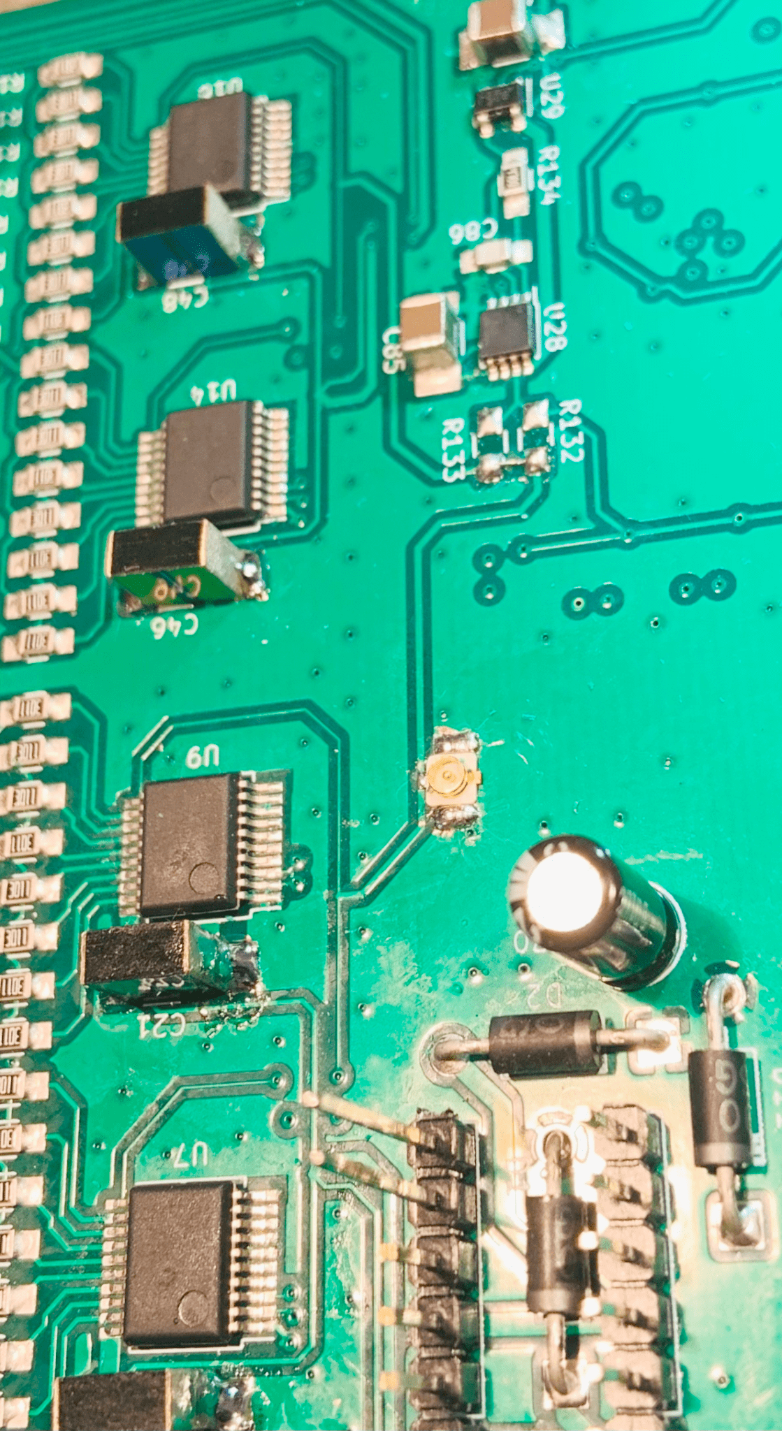

Another experiment:
4-each, 22uf, X5R caps replaced with Rubycon 22uf, 16v, film P/N - 16MU226MD35750
Not cheap, but sound is very different. Initial impression is full, warm midrange, big soundstage, very nice listening. Not even burned in yet. Will let it run awhile and see if anything changes. (Just noticed one of the caps doesn't look fully wetted with solder on the ground plane side. Will check more closely later and touch up if needed.)
Wow, €10,- a piece,
Other than mentioning polymer, Rubicon doesn’t tell what polymer the dielectricum is made of.
The same change could be done to the X5R and X7R caps on the analog reconstruction filter, although less expensive 10uF alu smd’s and polypropylene or NP0 100nF could be used.

Not sure those are going to stay. Give it a day or two. Main thing to note is that Vref tends to be audibly sensitive to changes like that. Its possible at some point an external Vref supply will be tried. Still thinking about it.Wow, €10,- a piece,
Changing IC bypass caps to film will quite likely change the distortion profile and impact the sound. Before jumping to conclusions about possible sound improvements the performance should be re-measured to verify that perceived changes in sound are not due to colorations.
My experience is opposite though I don't use X5R. Here is a recent example of what happens with film (or C0G) as bypass caps in a very similar circuit:
