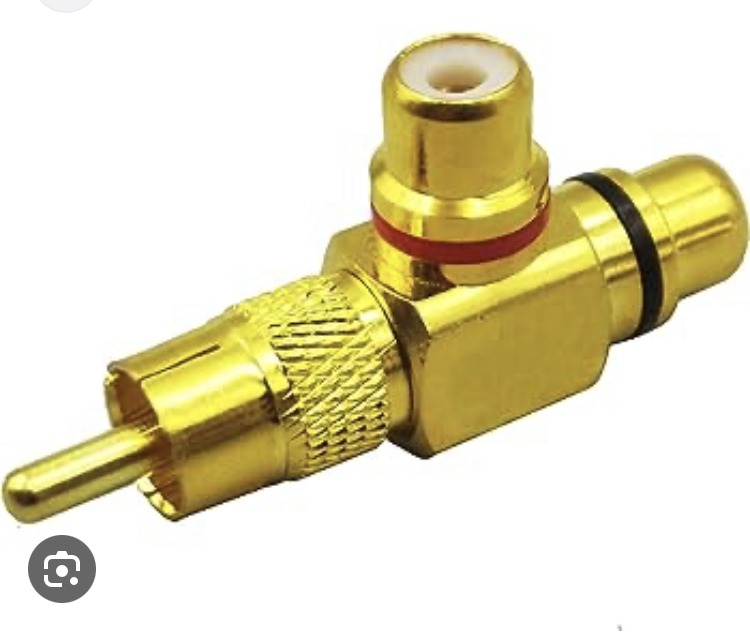

This would be all you need, see attachment.
No disassembly or whatever.
But its up to you, I don’t want to push, its just because you wanted to keep no stone unturned

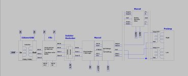

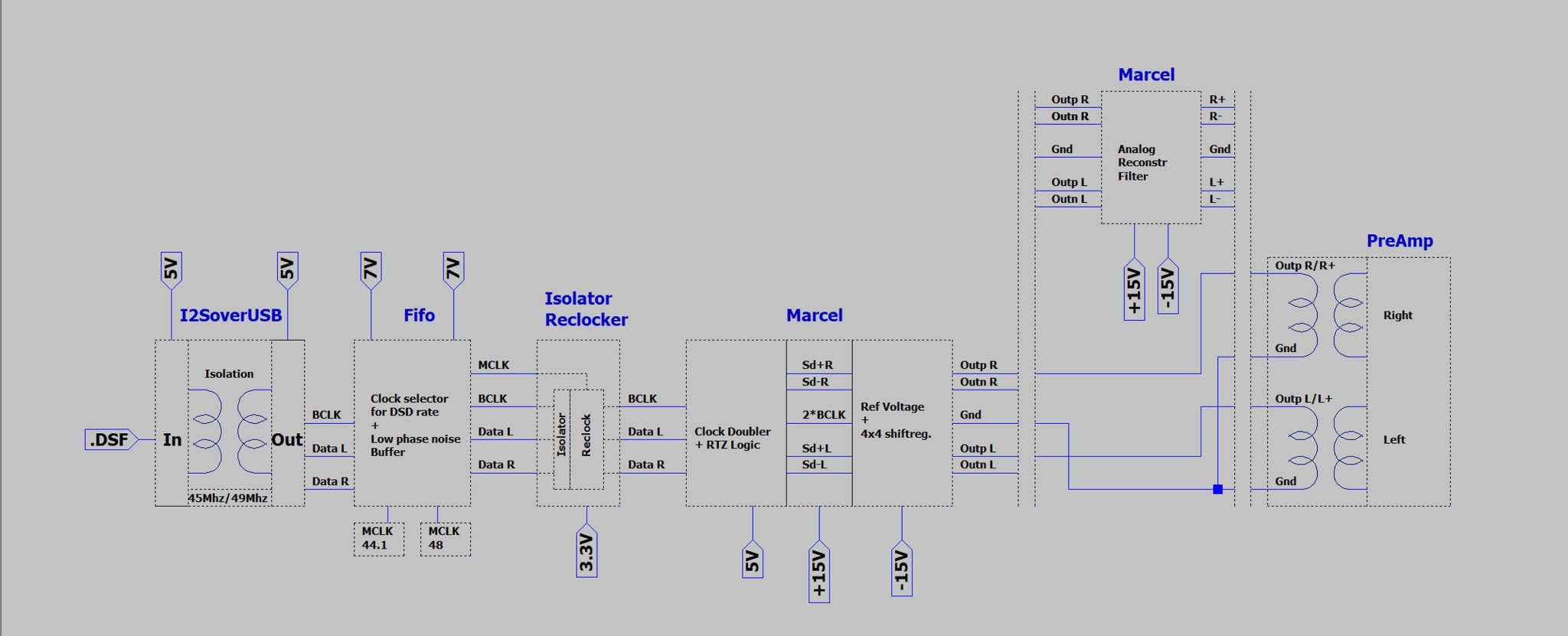

From previous postings I thought to have understood that you used a transformer instead of Marcel’s reconstruction filter and that your line amp had also a transformer as IPS.
Now I get the impression there is only one transformer.
In that case I will have the overview diagram changed accordingly.
Hans
There are a pair of transformers at the input to the line amp. They are essentially part of the line amp.
DAC Analog output from dac board -> DC blocking caps -> non-uniform directional cable of some length as needed -> RCA input connector on line amp -> transformer on line amp PCB -> amplifier active electronics -> ...
Also, I am okay with ordering some of those three way RCA connectors from Amazon. Could take a few day, have to see.
