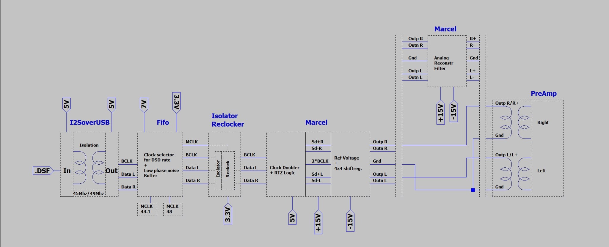

Hans,Here is what I got from the current situation including supply voltages in an overview diagram.
The second power supply for the outputs of the FIFO buffer is not 7v. It can be somewhere between about 3.3v and 5.5v depending on what voltages the dac digital inputs need. Also, the reason for two power supplies for the FIFO buffer is because it uses isolation too. There is a clean side and a dirty side.
Mark

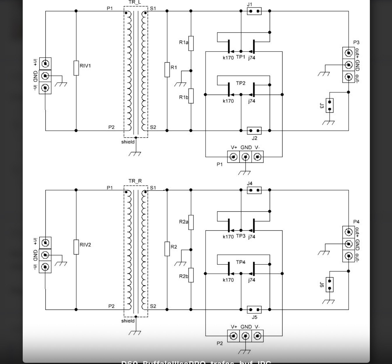

Is the transformer output stage something like this as promoted by Bisesik?Tried that with Andrea's balance dac board outputs. To some extent, the same problem as doing it with opamps. There is some loss of detail. Again, perhaps that's because of element matching issues where low level musical sounds are not exactly equal and opposite between dac output phases. Maybe that's where .01% resistors could make some difference, don't know.
As an aside, could be that using a small film cap followed by a FET buffer would sound better than a large cap and no buffer. Smaller, better caps do tend to have less SQ problems than physically large caps. We have tried that idea here too. We found that all FET buffers we tried have a sound, and it isn't necessarily better than the sound of a good combination of a burned-in electrolytic and a small film cap in parallel. That said, we haven't given up on the FET idea. May just needs more work.

O.k. thank you.Hans,
Mark
I took these figures from Andrea's site, but I'm happy to change this.
By applying two voltage, just as on the USBoverI2S, is meant that they are from independent sources, just like all other voltages in the diagram.
With the interlink termination I advised to use 100R+2n7, but 100R+1n will be better and at the same time you could remove the 270pF at the Dac side that you added.
This will minimally affect the the level at 20Khz.

Mark,Tried that with Andrea's balance dac board outputs. To some extent, the same problem as doing it with opamps. There is some loss of detail. Again, perhaps that's because of element matching issues where low level musical sounds are not exactly equal and opposite between dac output phases. Maybe that's where .01% resistors could make some difference, don't know.

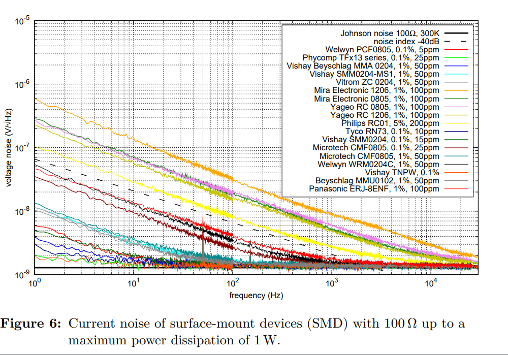

What metal foil resistors may bring to equation is they are likely to help reduce signal-correlated noise. From the numbers someone might not think it can be a problem, but after have tried some different so-called low-noise metal film resistors I could find no other physical explanation for the difference in sound other than resistor Excess Noise. It is known that metal foil resistors are tend to be lower in excess noise than metal film due to construction details. It is also known that manufactures of resistors such as Susumu make resistors intended for audio use. The audio resistors are lower noise than standard Susumu resistors, but the tradeoff is that some of the other specs aren't as good.

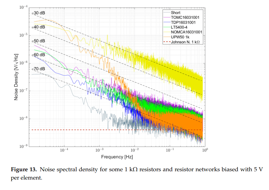

In most textbooks resistor noise is divided into thermal noise and current noise. Excess noise is just another terminology used for current noise. And as I already showed in post #1625 current (or excess) noise in this case is very small in relation to thermal noise. As you haven't done proper AB testing the obvious explanation for the perceived difference in sound is expectation and subjective bias.What metal foil resistors may bring to equation is they are likely to help reduce signal-correlated noise. From the numbers someone might not think it can be a problem, but after have tried some different so-called low-noise metal film resistors I could find no other physical explanation for the difference in sound other than resistor Excess Noise. It is known that metal foil resistors are tend to be lower in excess noise than metal film due to construction details. It is also known that manufactures of resistors such as Susumu make resistors intended for audio use. The audio resistors are lower noise than standard Susumu resistors, but the tradeoff is that some of the other specs aren't as good.
BTW for more information about resistors noise this over 60 year old paper is good read.
https://conradhoffman.com/papers_lib/TI_Noise_Prec_Resistors.pdf
You are guessing, nothing more. Small numbers do not mean inaudible. It is already known that signal-correlated noise is much more audible than Johnson noise. Two very different things. Besides, how do you know that end cap noise is white? Guessing again. It may sound nothing like what you are assuming. How do you do know it isn't popcorn noise or frying noise? You don't....the obvious explanation for the perceived difference in sound is expectation and subjective bias.
Not guessing. The resistor noise in this case is almost all from thermal noise, you can't escape that even with your audiophile mumbo jumbo.
What you fail to understand is that metal foils do not have lower excess noise than low noise thin films. Metal foils have better tolerance and stability.
