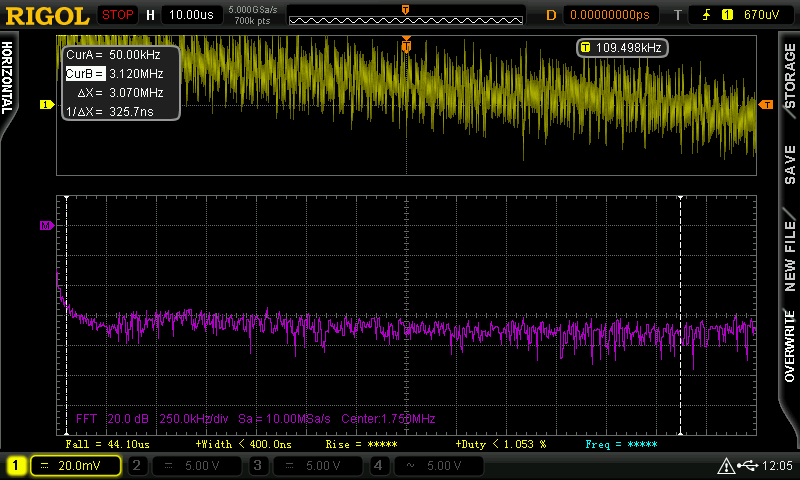

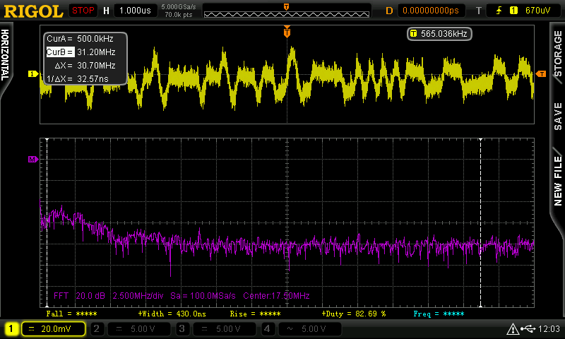

Playing a low level sine wav what I find is that with 3' long cable from dac output to transformer input, at the transformer input it looks just about like the unfiltered output of the dac (which is to say pulses at RF). Coming out of the transformer, scope vertical amplifier noise floor and ambient EMI/RFI dominate what can be seen. Only thing I have seen so far coming out of the transformer is some line level audio when I play music.Mark, how much out-of-band noise do you measure at the output of your filter with the various modulators? Could you measure the total quasi-peak-peak or RMS noise when playing silence through the modulators?

Tried that after the transformer. No spurs, just a flat noise. Some of it just scope amp noise above 1GHz. Tried shorting the probe, removing the probe from the scope, etc. Environmental and scope amplifer noise dominate.
I would expect quantization noise to dominate from a hundred kilohertz or so to a few megahertz, but if I understand you correctly, you see no difference between DAC connected or probe shorted even there. Thanks for trying!
