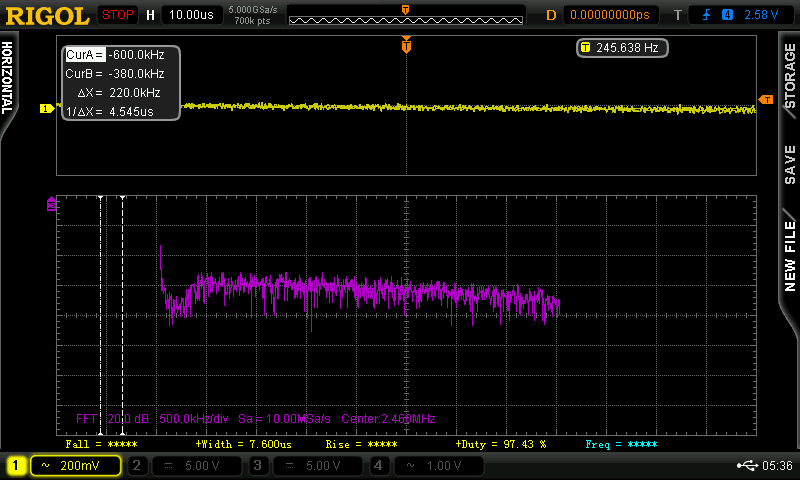

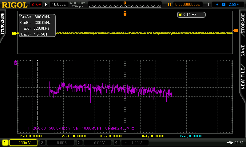

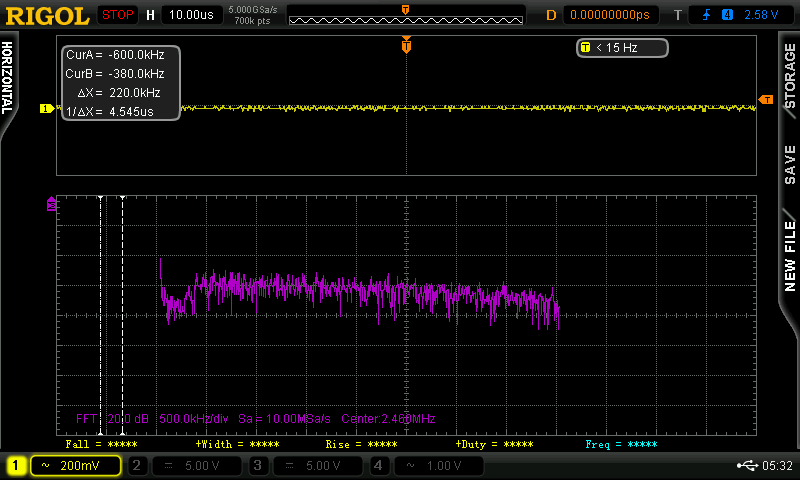

After some adjustment of the scope settings, and after waiting for a quiet point in the music, got this:
Once again it is after the DC blocking caps and with the transformer loading the dac output.
EDIT: Also found the FFT display lags the channel 1 trace. If set to single sweep mode, the FFT display will update a couple of times after channel 1 yellow trace displays. To get this image required putting the scope directly into STOP mode at the right time. In that case the FFT display does not continue to update.
Finally, You start to see something closer to what I have observed.

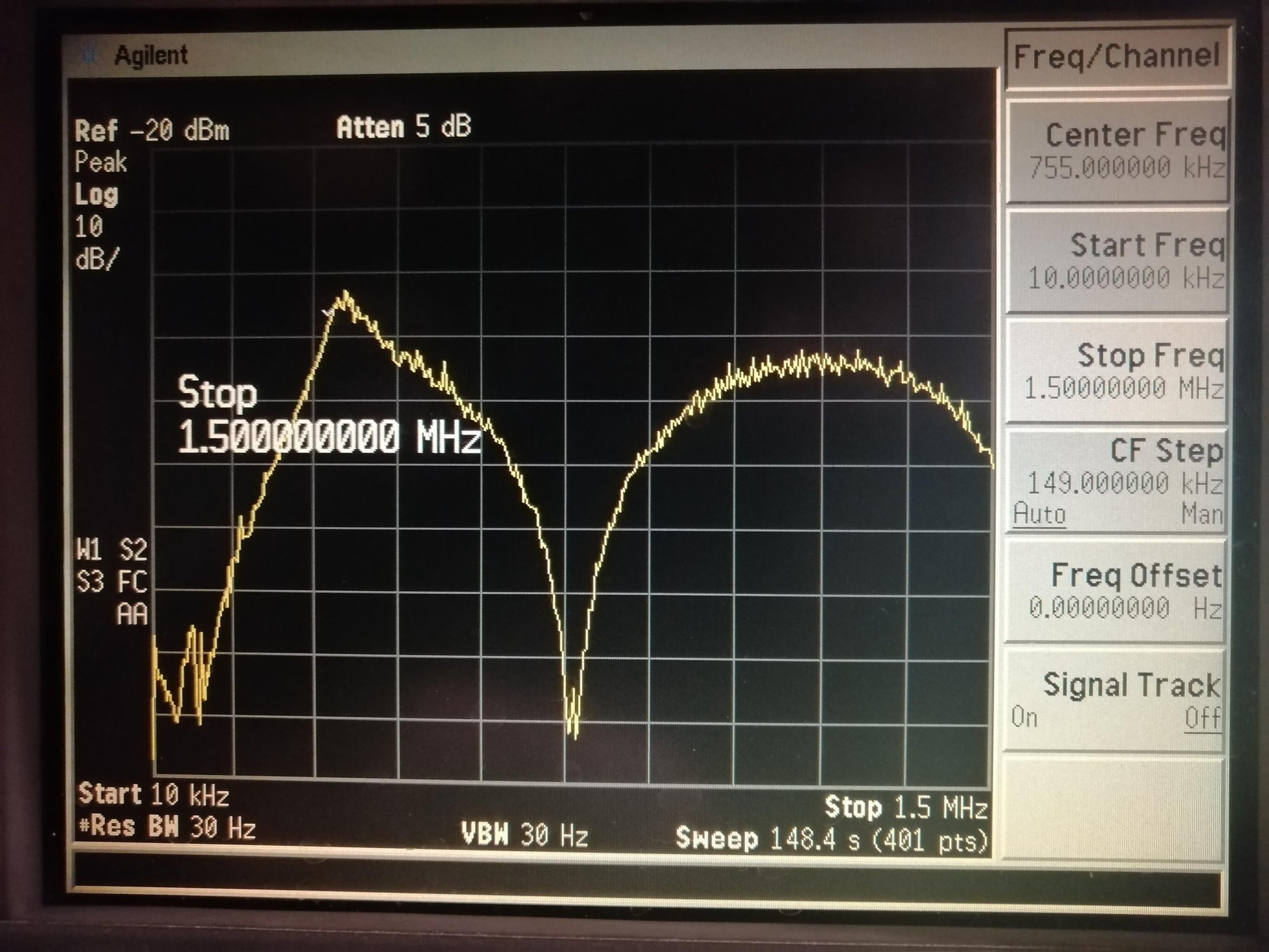

would like to point out that these shaped noise floors are depending principally on the modulator algorithm, not the filtering quality in the audio band, neither from presence or absence of the audio signal.
And as visible, it can have a noise peak level above the floor close to 60/70db high, and in a ~wide band, so not insignificant energy.
And this is inherent in DSD processing, (single bit) - if you don't see it then it's a problem of the measurement.
With multibit noise shaping the peaking can be less, the distribution different, but not absent altogether
...if you don't see it then it's a problem of the measurement.
Its pretty hit or miss with this scope whether it shows the 'correct' shape or not. It really depends if I get lucky when I hit STOP. Out of a few tries I might get one that doesn't look too flat. Also, the scope doesn't trigger properly in NORMAL mode, so its just free running unless I set the sweep rate to capture individual RF pulses at the dac output. However, at that sweep rate it doesn't make a very nice looking FFT down where we expect to see the dip before the noise starts rising.
Oh, well. Maybe I'll get a more suitable RF spectrum analyzer at some point.
