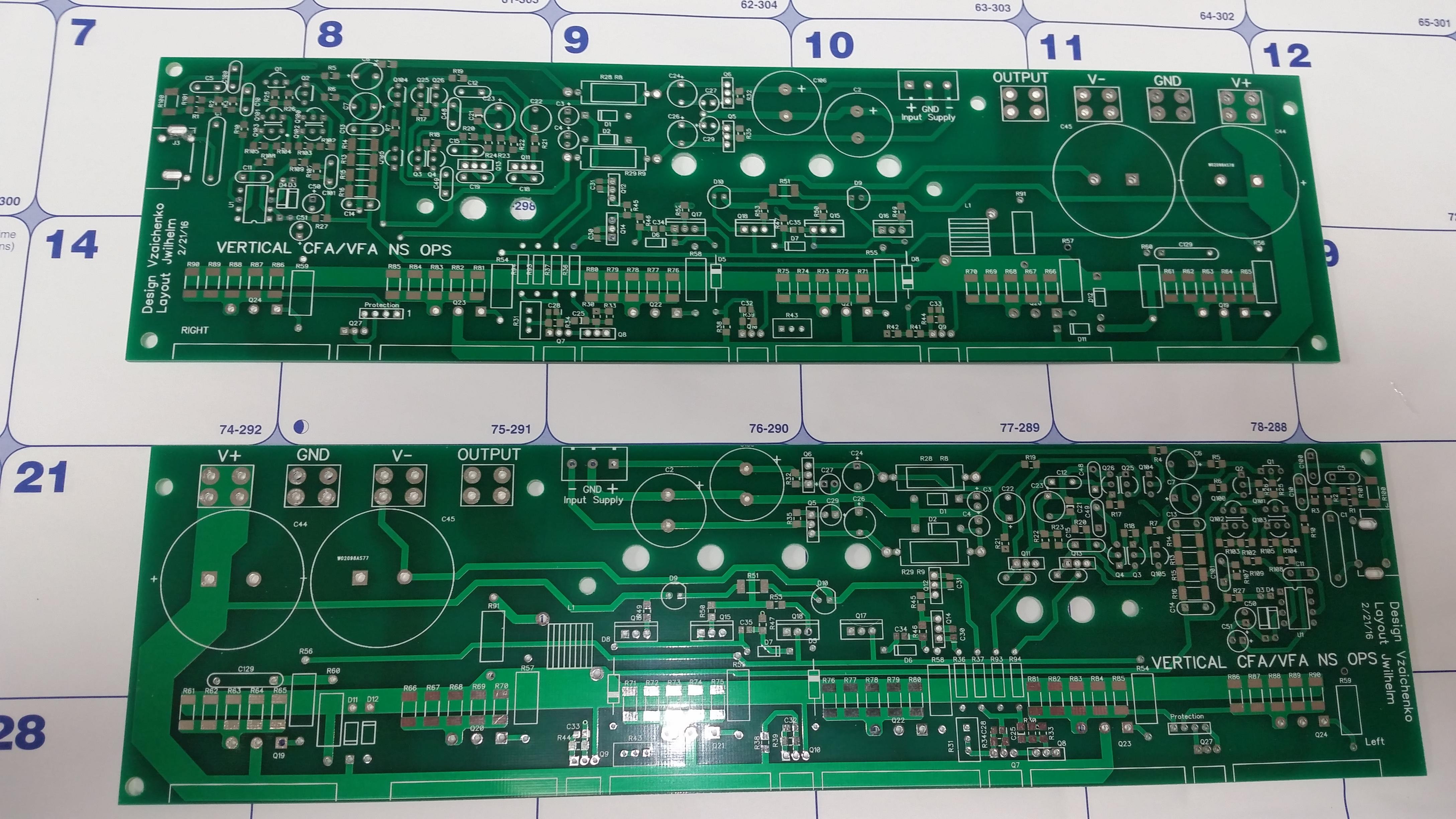

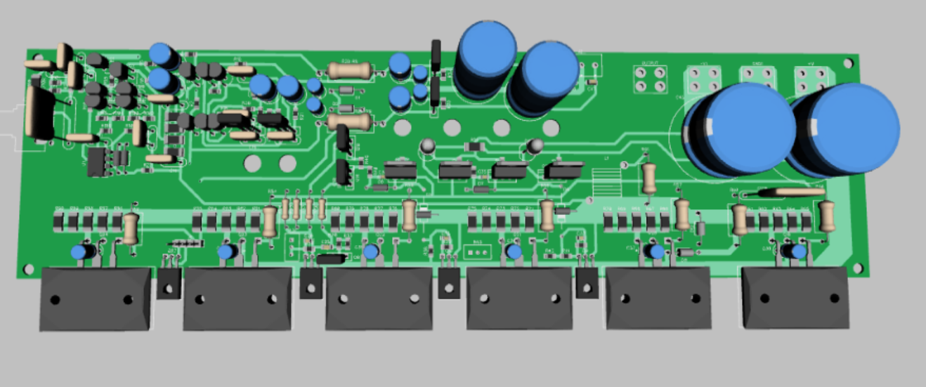

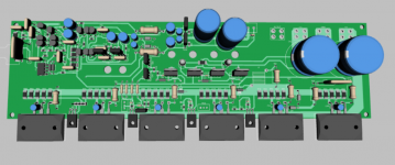

I finally managed to come up with a layout for one channel of the CFA/VFA combination design. This will still mount flat nicely on a 6" x 12" heatsink. One more channel to go.
Nice! We will probably add 2 small capacitors to CFA option - I will let you know later today.
Jeff, please check that C24, C25 are in place - see IPS schematic here:
VERTICAL CFA IPS + NS-OPS
Those caps can be 10pF or 15pF - does not matter. But they need to be there (eliminating probability of light ringing at high swings).
I was just afraid they could be removed in the Diptrace file I've sent you earlier. Schematics in the thread are all ok.

Hi Valery,
Will the NS-OPS work with MJL41194/93?
By the way! It will.
Just be careful when testing with a square wave - don't go above, say, 100KHz. They close really slowly, comparing to modern outputs.

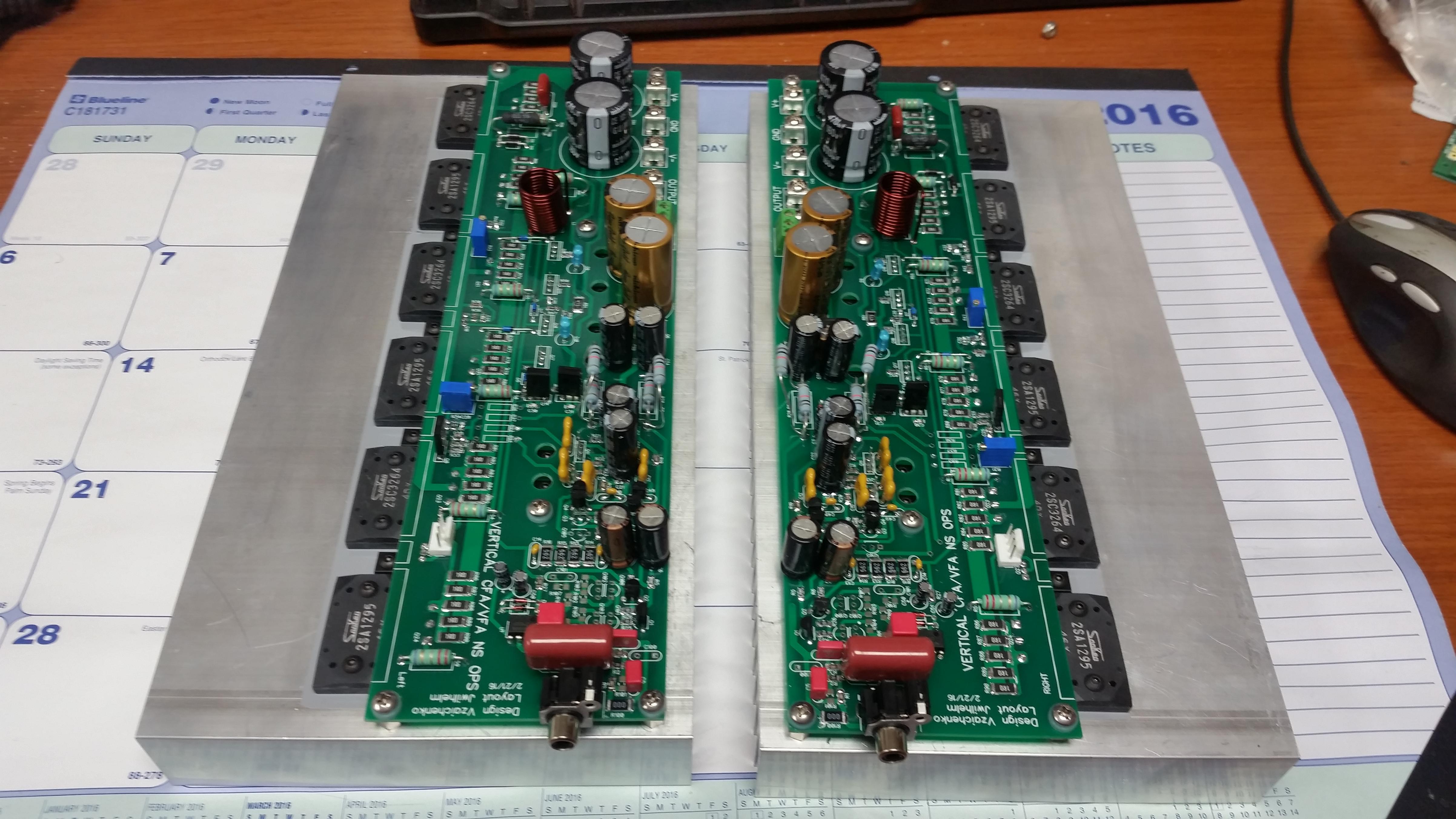

I've got one channel up and running on a 63V supply. Sounds great so far. The 60hZ hum isn't there with open input either. This one's dead silent!
Excellent! Is your input lifted or not (10R or jumper)?
