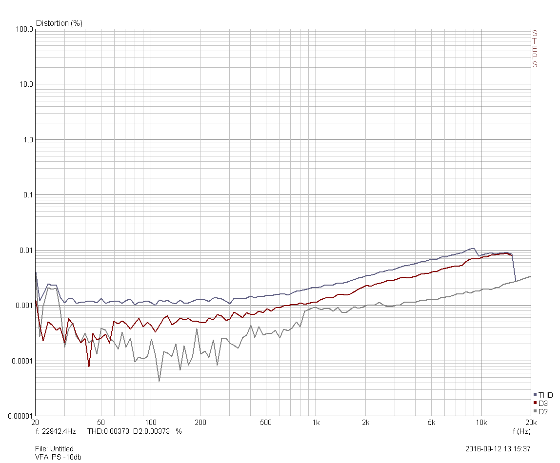

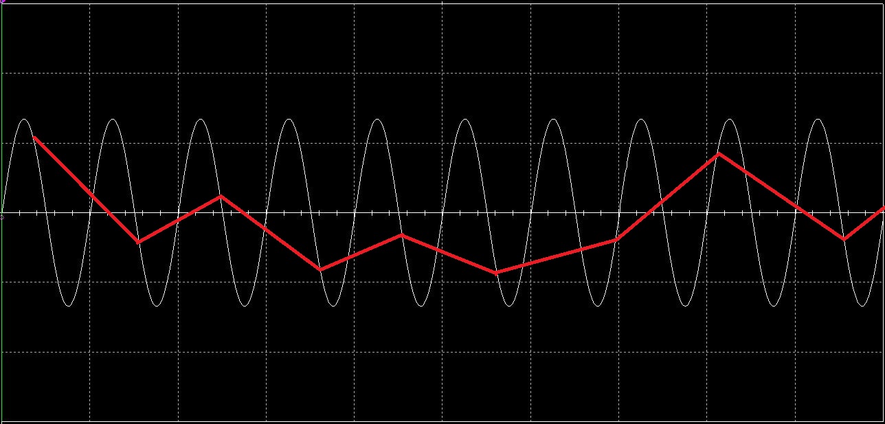

Here is what i have.
This is the VFA IPS.
Tested at clipping levels direct on dummy load.
First is the 20Hz test
Second the 20KHz
Ummm... did you measure with integrating RC? The curves look like the peak values are measured at some moments in time. How often the values are taken? Normally, DC offset does not change that fast.
I just ran some quick sine sweeps through the VHex+. No sign of DC offset even with hard clipping right up to 30kHZ. The highest offset voltage I saw was 10mV. It usually wanders around at less than 3mV. Nice balanced little amp!
OK, that's what I expected. Let's test X4 front-end with no servo, but with 220uF electrolytic in series with 1K resistor, connected to the feedback junction point. I expect it to be somewhat similar.

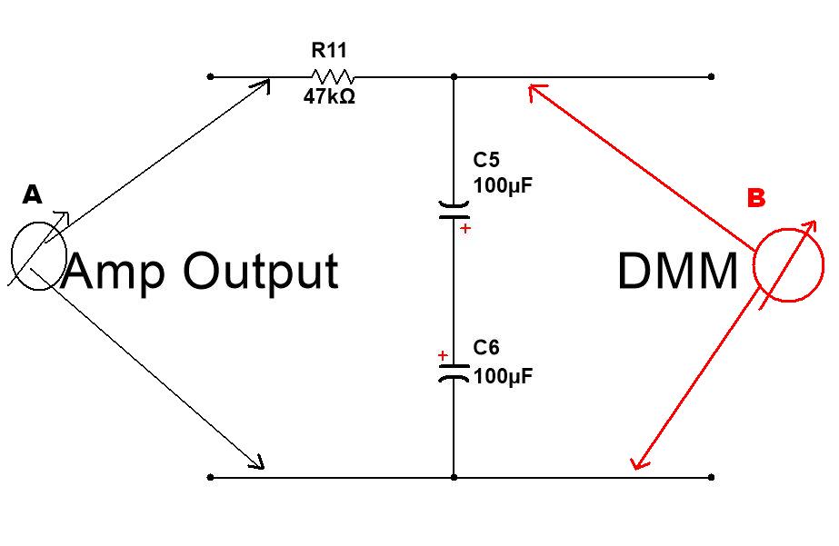

I have attach the low pass filter on the dummy and measure pre and after using an A and B multimeters.
after the filter (B multimeter measure no d.c)
What i post earlier is what the A multimeter show.This set for save interval 0.5sec
Yes Valery, maybe we can do this without servo but this way never we know why this servo not serve well.
I can't understand,meter A say v.d.c,and this occurs only when clipp levels or near thisRight. Multimeter A shows the peak values of AC curve, taken every 0.5S then. It makes sense to place both multimeters behind the filter. DC offset never changes that fast - it's a slow process.
Why meter B don't measure any d.c when meter A show d.c.v even if used simple as voltmeter(not record mode)?
Meter A shows you instantaneous values at different places of AC curve. In order to see, if there is a DC component in your AC signal, you need to integrate. Meter B shows correct DC values, as it is placed behind the integrating circuit. Meter A shows instantaneous values every 0.5 sec, wherever on AC curve it appears at that moment.

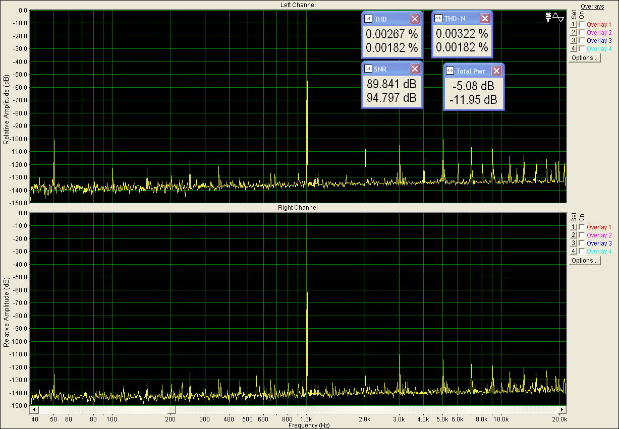

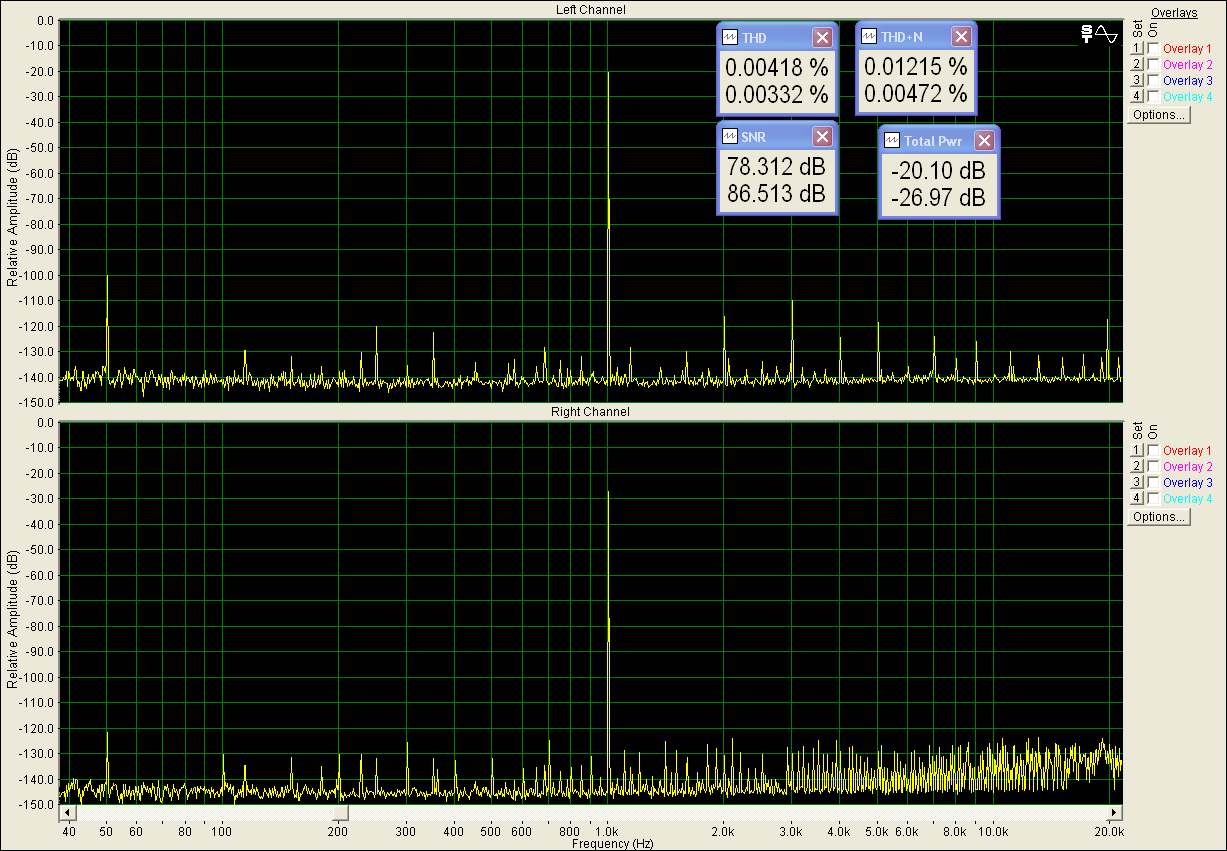

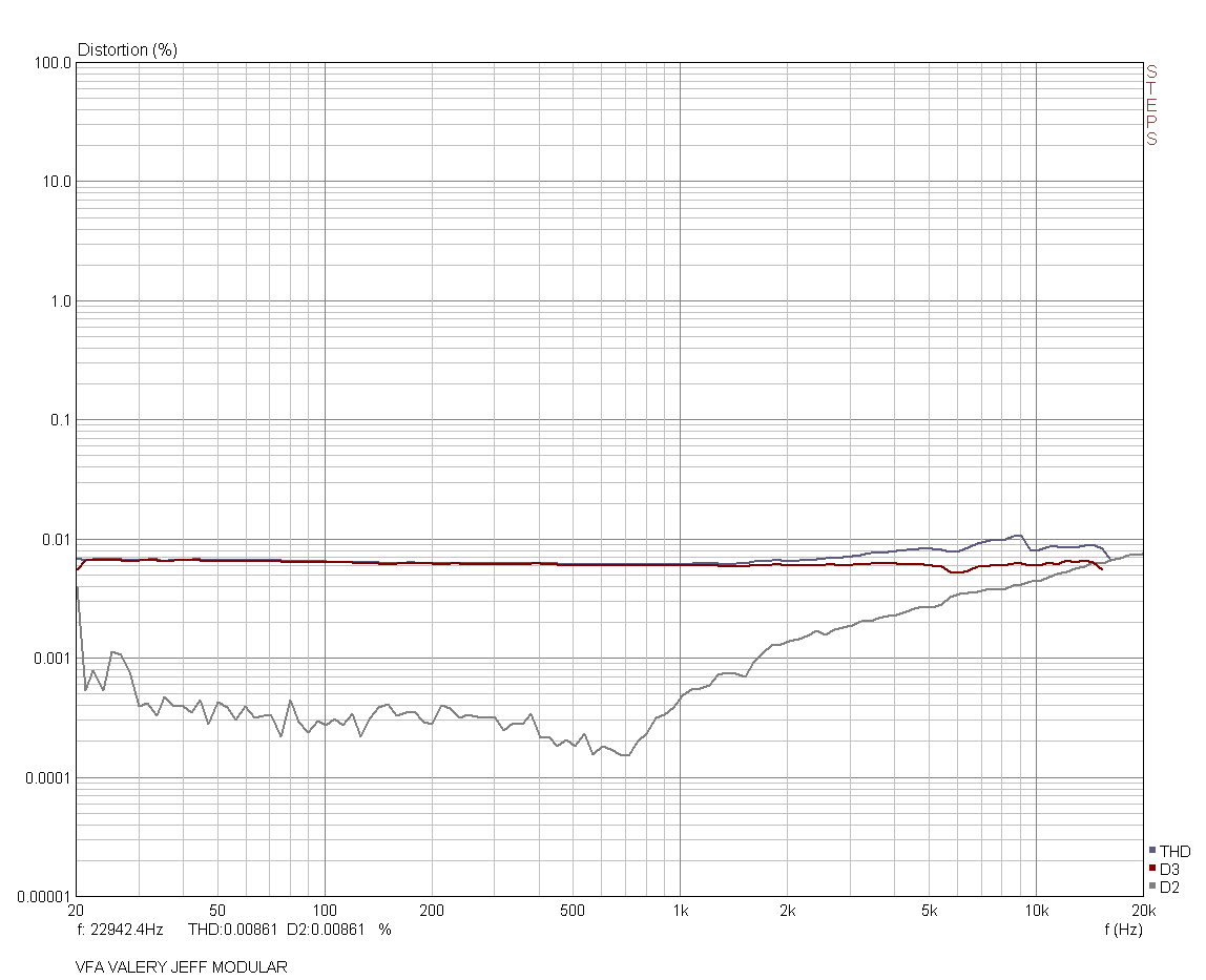

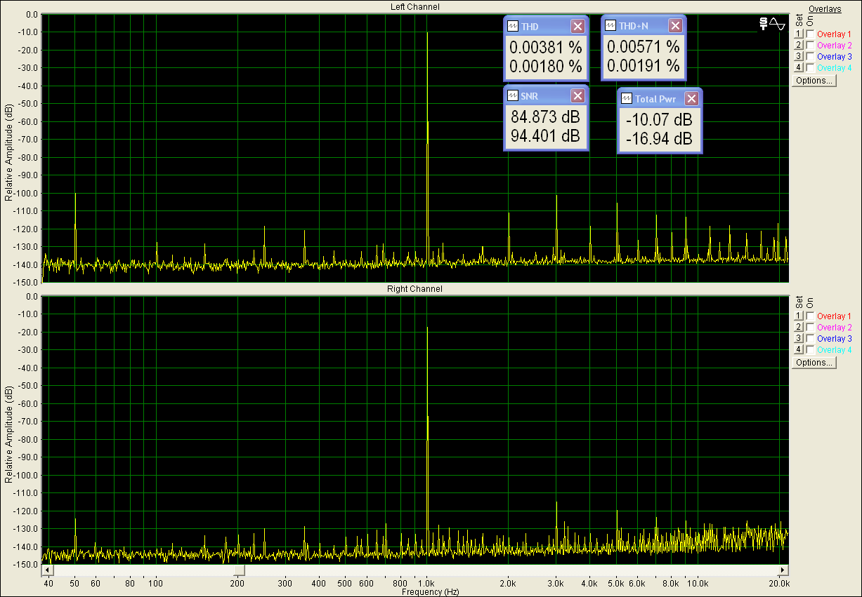

Modular distortion measurements.
Where left channel is the amplifier,where right channel is the sound card loop.(out to in)
Please keep in mind that this is what my sound card can measure.

If my memory serve well your recommendation is 35mA idle current,8mV on R22 emmiter resistor,without load,then the amplifier driven with 1Khz sinewave for a 10v RMS out on the load and trim the bias clamping for 5mA increasing(9mv on R22),right?Not bad at all. Interesting - the card's harmonics increase at higher amplitudes, but the amp's ones stay virtually the same, even slightly decrease )) Possibly - slight under-biasing. Plus, the bias clamping spreader may be not tuned-up for the optimum.
