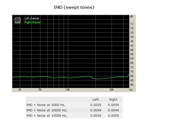

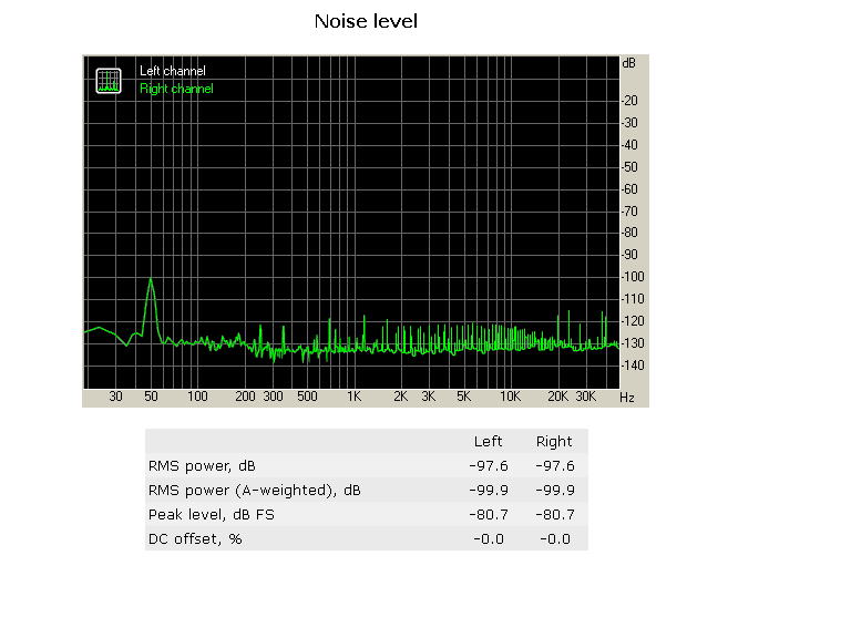

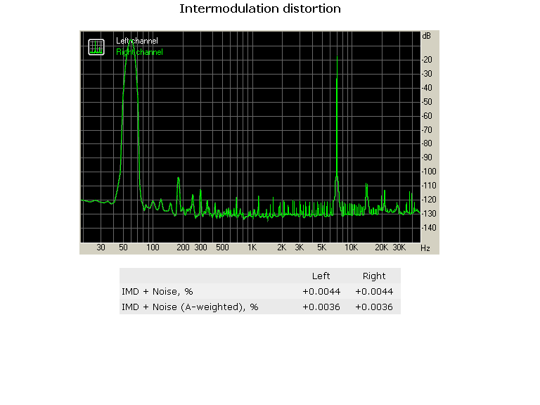

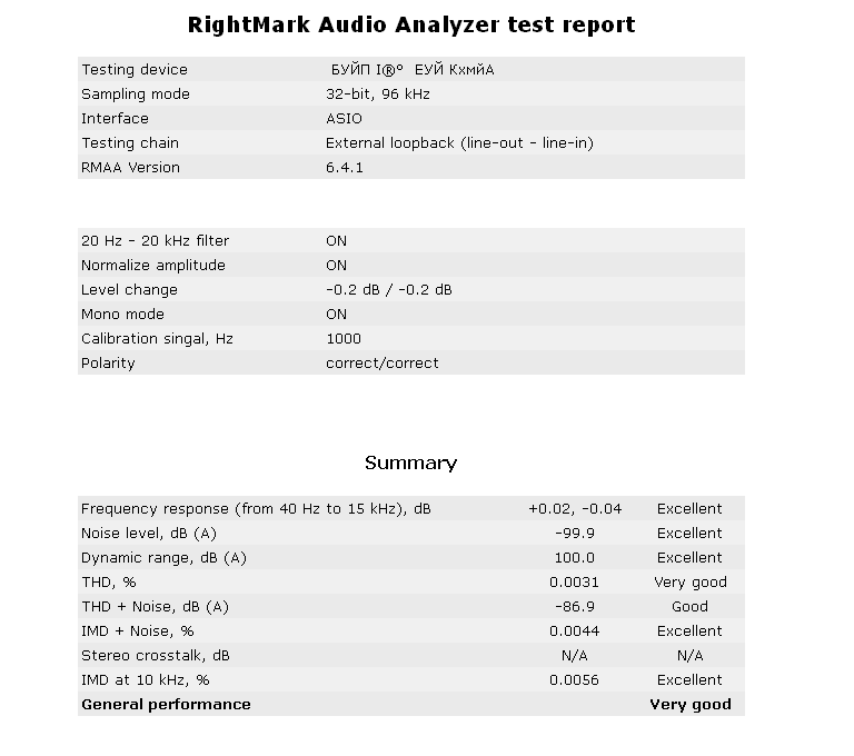

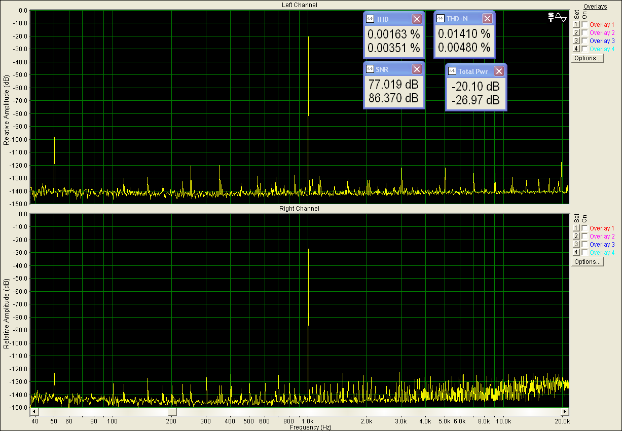

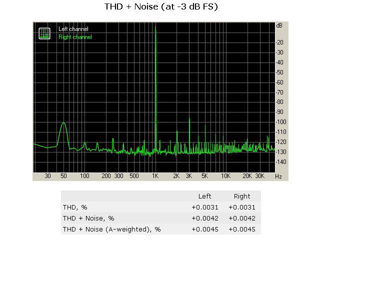

Right Mark test
Also looking good, assuming certain sound card limitations
Nice IMD. I normally measure 14+15KHz, but it's low in any case.
Zero offset at the output+zero input signal=zero output voltage.Right. Zero offset at the output = zero current through the load. Meaning - it doesn't matter if it's there or not ))
Zero output voltage=zero current through the load.Meaning-it doesn't matter if it's there or not
Yes i wish to have something better

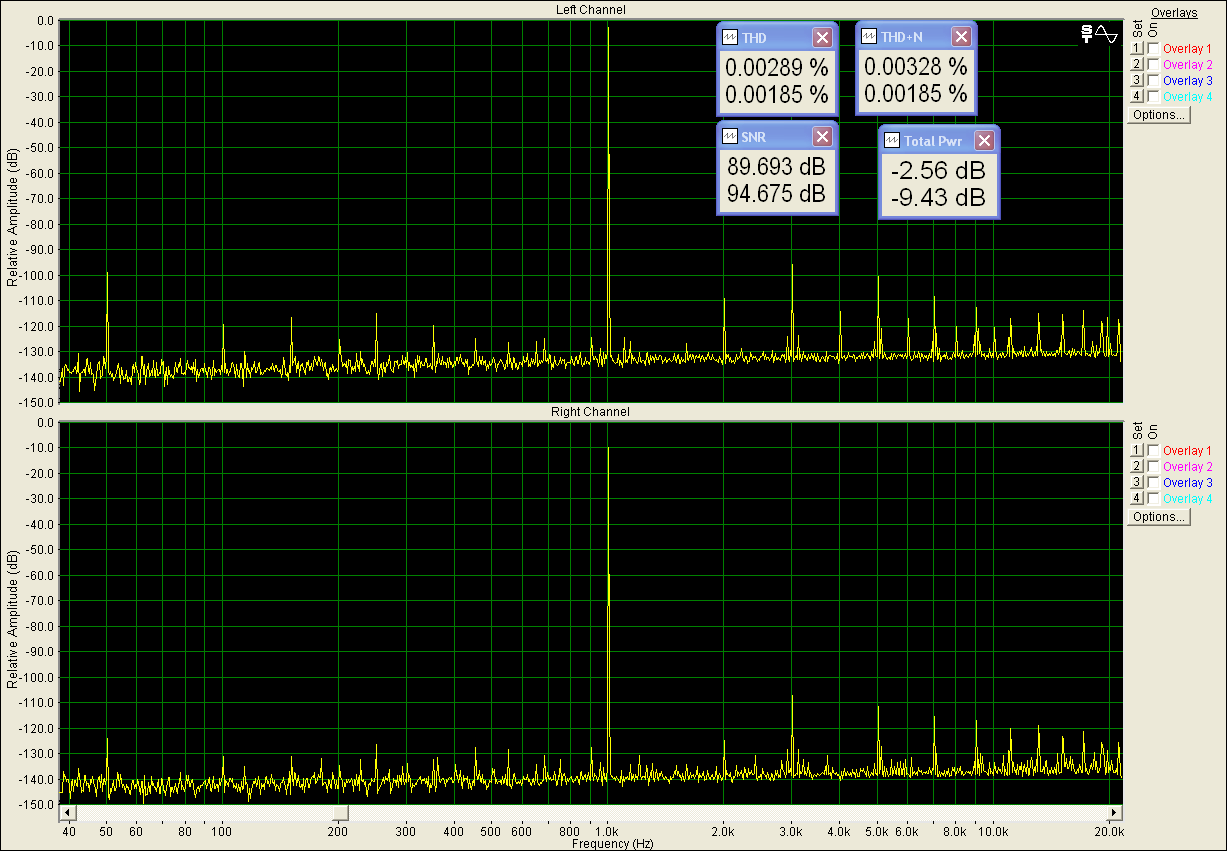

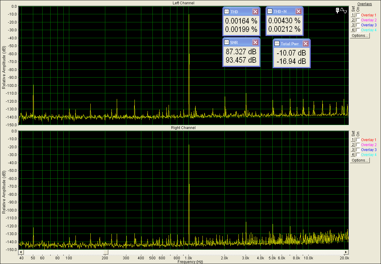

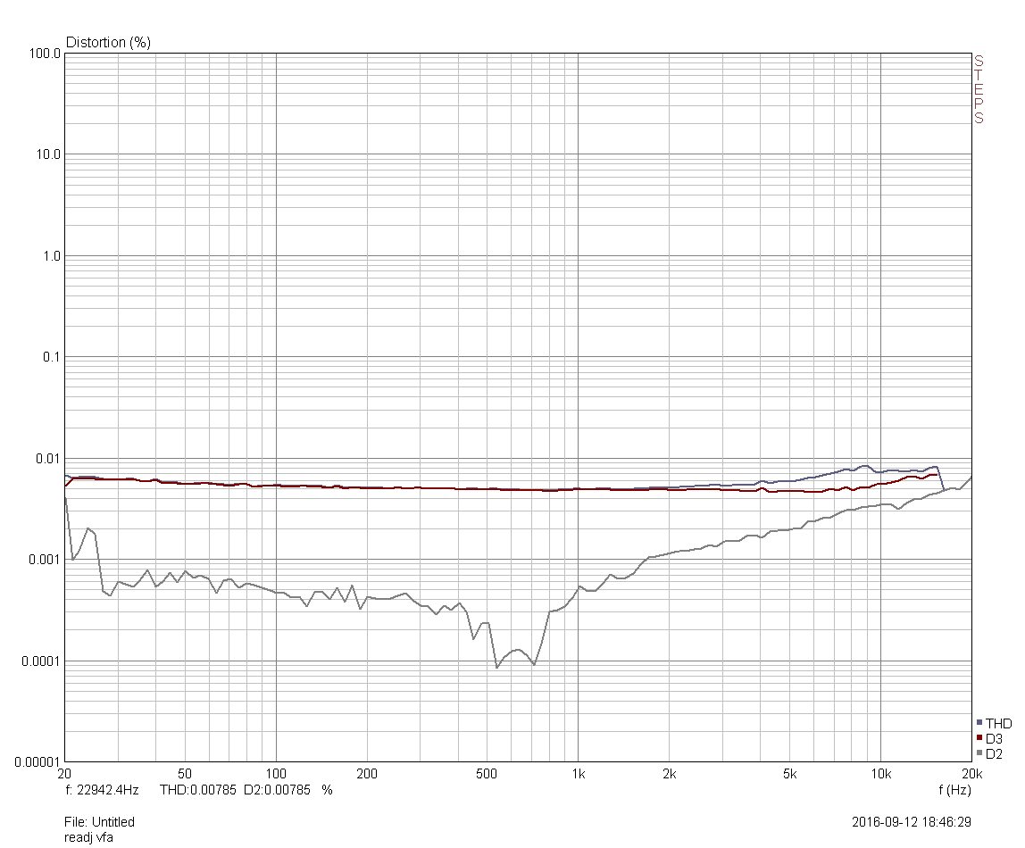

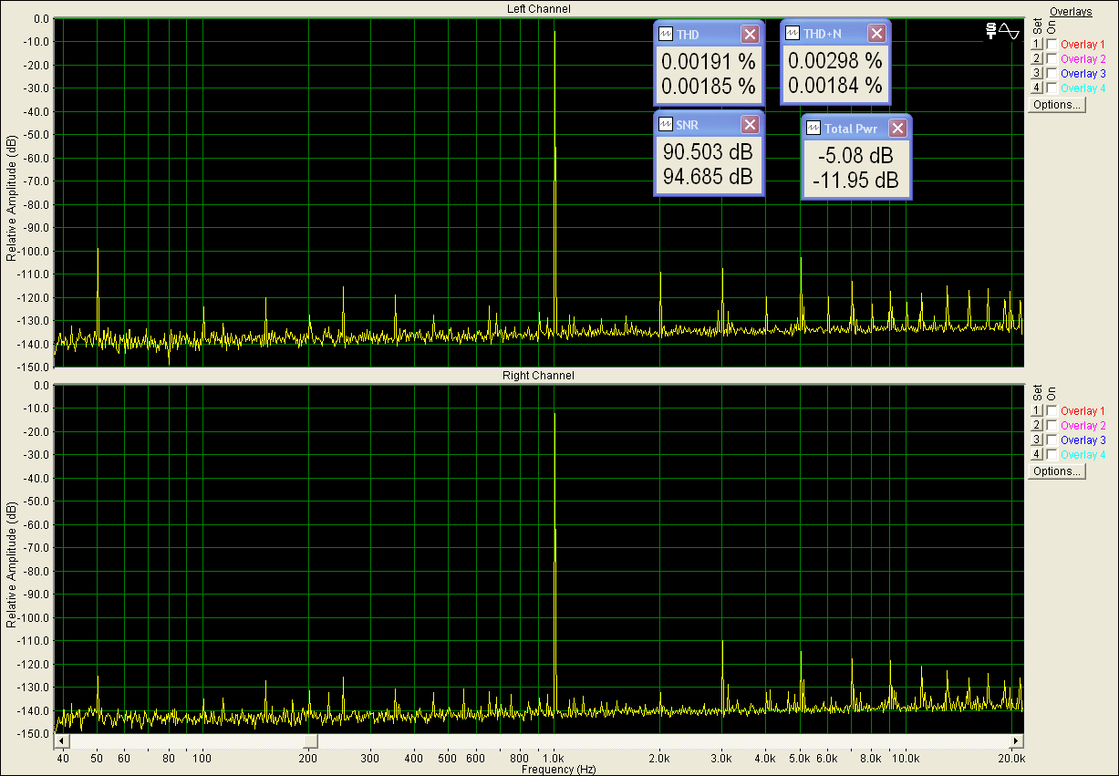

Bias and clamping readjusted and amplifier was tested again.
Now an even lower distortion level measured.
slightly increasing at higher power - meaning, the bias is good
This is a question that i want to ask.
What is the point that you see and understand that the previous measurements has been taken with an under biased amplifier?
Thi is valid for class AB output stages.
Imagine, you measure THD at relatively high output swing - say, 20V RMS (50W @ 8 ohm).
In case your OPS is under-biased, you will have some crossover distortion, but it's pretty much "masked" by the high-level base frequency tone.
Now, measure THD at 2.8V RMS at the output (1W @ 8 ohm). Crossover distortion stays roughly the same, but the level of the base frequency is much lower - THD value increases.
In correctly-biased OPS, crossover distortion's influence on overall THD is lower, than influence of the other sources' of distortion. In this case - lower swing -> lower THD.
