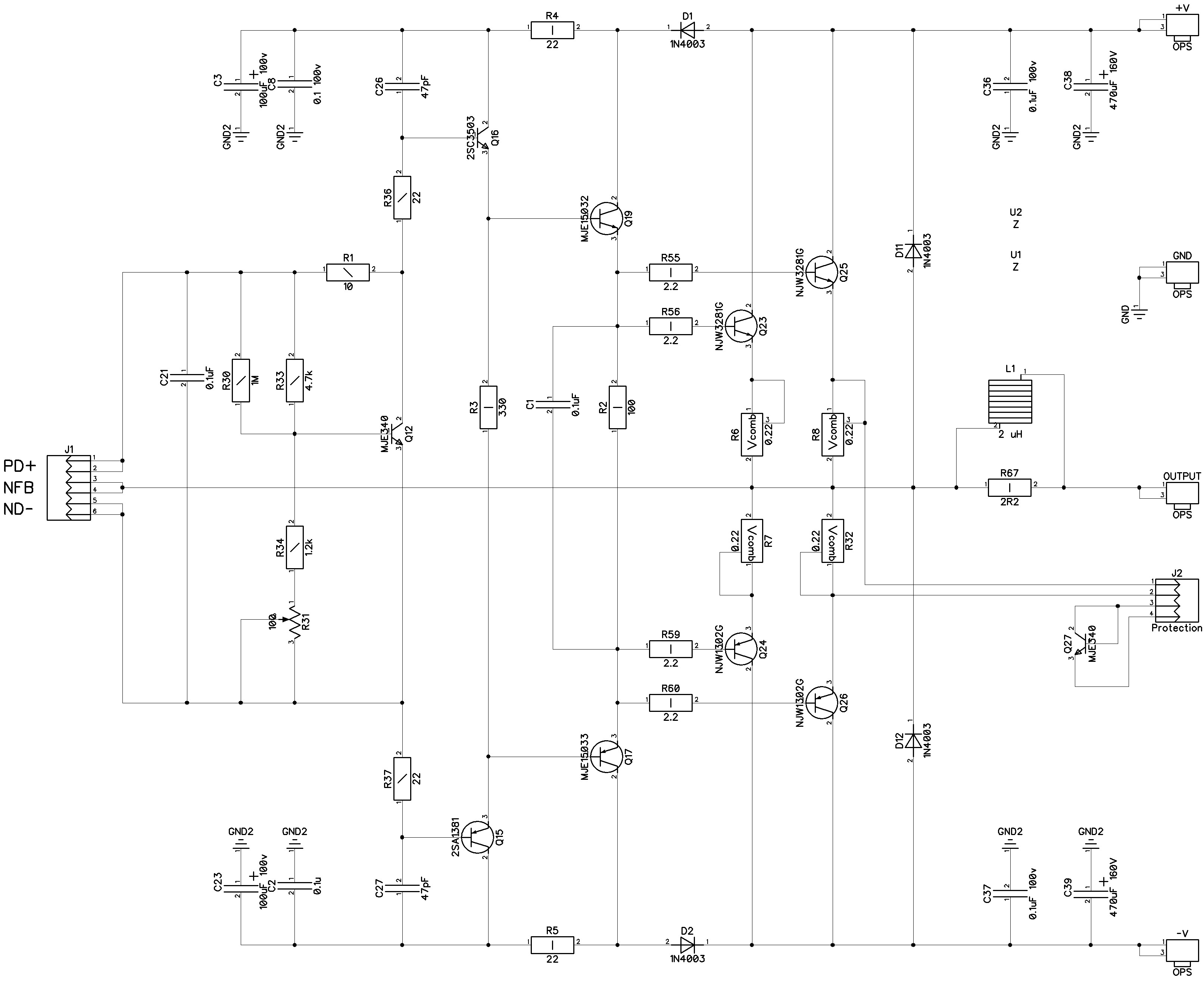

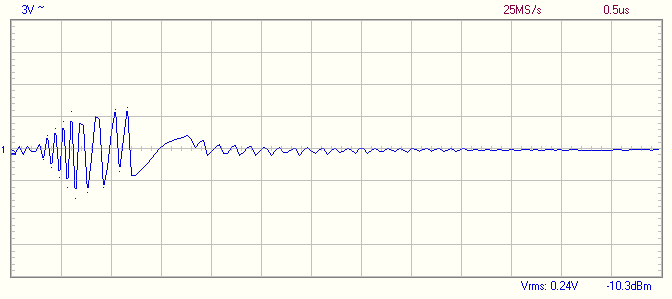

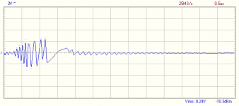

This output board has been pretty interesting so far! I've been trying to nail down a proper set of values for the bias circuit, but it's not going well. I installed 1k2 for R34 and a 200R trim pot and wasn't able to acheive any bias current. I replaced R34 with 1k1 and wasn't able to lower bias enough. i reinstalled 1k2 and wasn't able to turn bias off. I think I'm seeing high frequency oscillation bursts on the output.

Jeff this looks like oscillation bursts.
Let's go bold and implement DynaDrive schematic, cutting a couple of traces - its phase characteristics are dramatically better, so the issue is going to go away. Also note the values between the pre-drivers and drivers emitters.
If it goes well, we will publish the changes - Terry will be able to implement them as well.

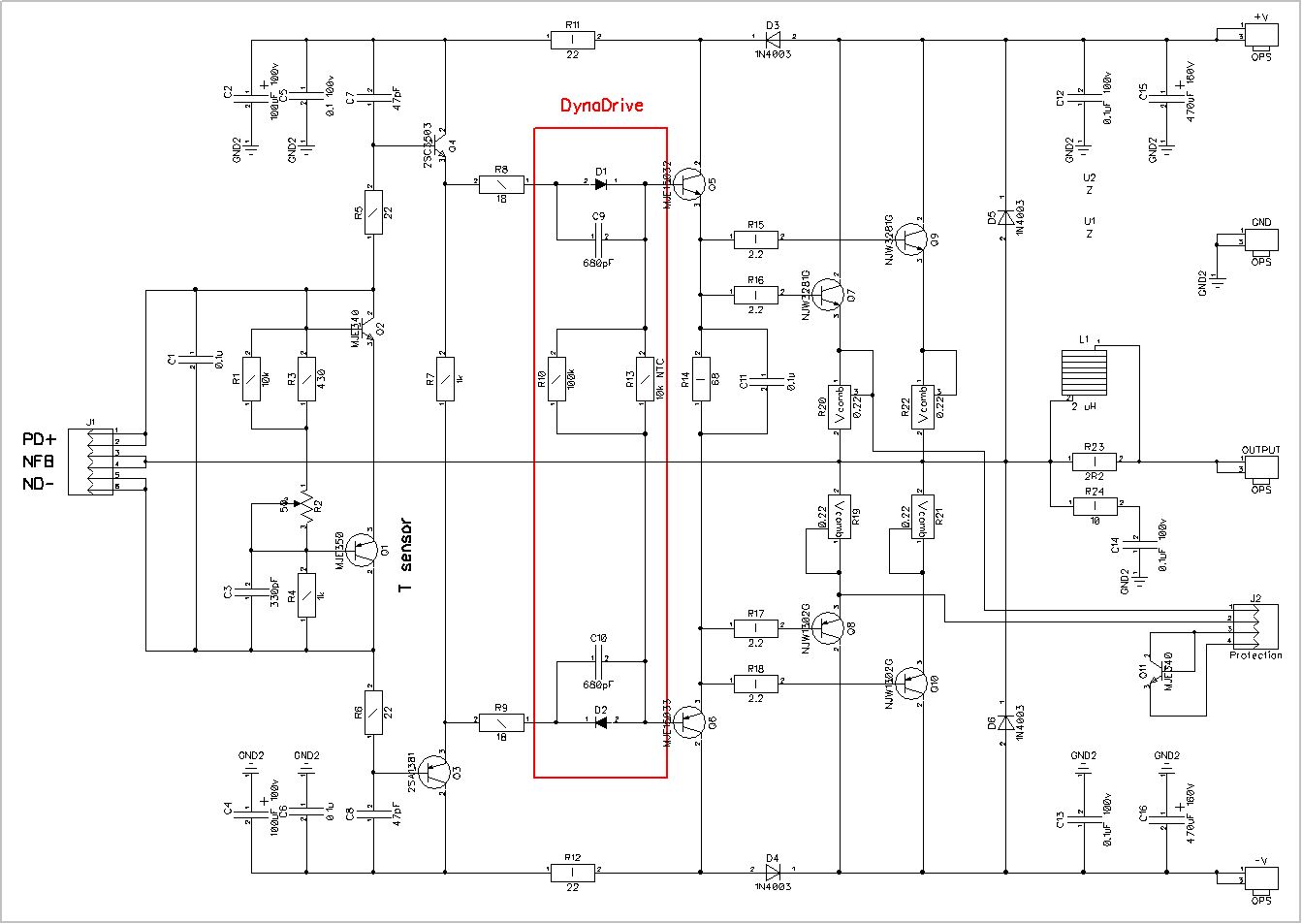

Hi Terry and All,
Jeff has tested the updated circuit.
I gave it the name DynaDrive. It's based on NS-OPS, but is significantly simplified, missing all the clamping mechanism. However, the diodes in series with the drivers' bases compensate a lot of the OPS non-linearity. In addition to that, phase response is significantly improved.
Jeff's tests went well with Vertical-VFA and X4 front-ends. There are still some strange "bursts" approximately once in a second. We are still thinking about their nature. There is a possibility they are related to this particular layout of the OPS.
I have attached the original mini-OPS and the one with DynaDrive circuit.
What I would recommend - on your test board, leave the spreader as is (you will only have to decrease the value of the resistor in series with the bias trimmer in order to increase the bias).
Just add the DynaDrive circuit (you will have to cut 2 traces at the drivers' bases). If you don't have 10K NTC in hand - no problem, just use the normal resistor.
Then try it with Vertical-VFA and/or X4. These are going to play nicely.

I'll do up some instructions for modifying the boards later this evening. It's pretty confusing trying to follow the schematics and figuring out what traces to cut. The DynaDrive circuit can be butchered onto the bottom of the board fairly easily. Updates to the bias spreader are pretty ugly, not worth the effort.

Why the clamping is missing?
Jeff, did you build the right channel to see if it works properly? I haven't checked to see if maybe the vbe was ok on that one. I'm letting mine sit until you get a little farther along. I'm also going to wait for the newer layout for the X4. I still have a problem with one of the boards and don't see the sense of listening to only one channel.
For simplicity 🙂
NS Modular boards you've got are, let say, the "full option" ones. Top notch.
We still love them, but some people may be "scared" by the level of complexity.
DynaDrive OPS is almost as simple as a normal EF3.
But better performance.

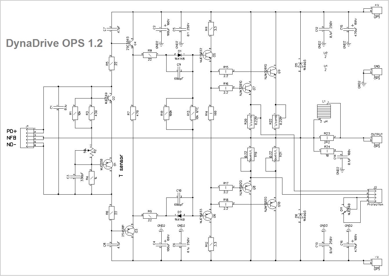

DynaDrive OPS 1.2
OK, we decided to re-work the mini-board.
Looks like the issue is mainly in the layout - some long traces and not enough rails decoupling.
I have slightly updated the schematic (attached), Jeff is going to re-design the PCBs.
