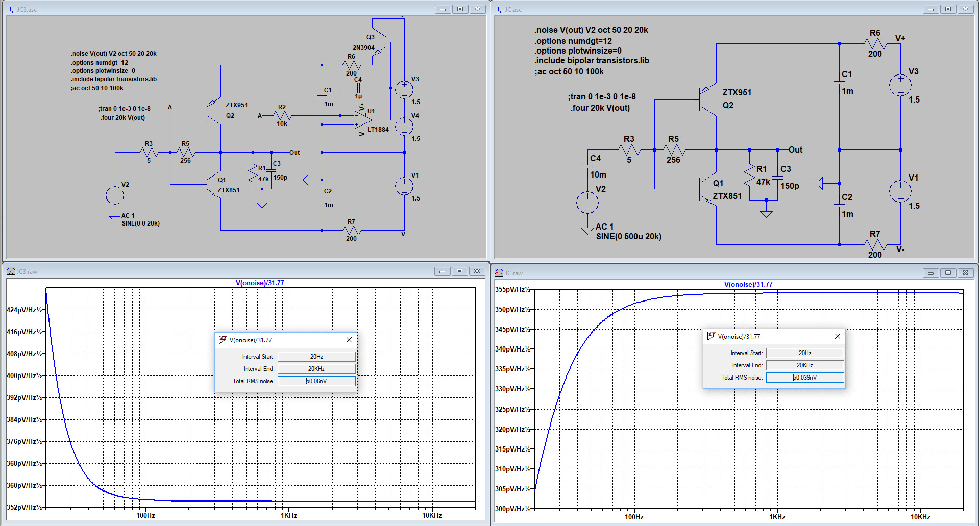

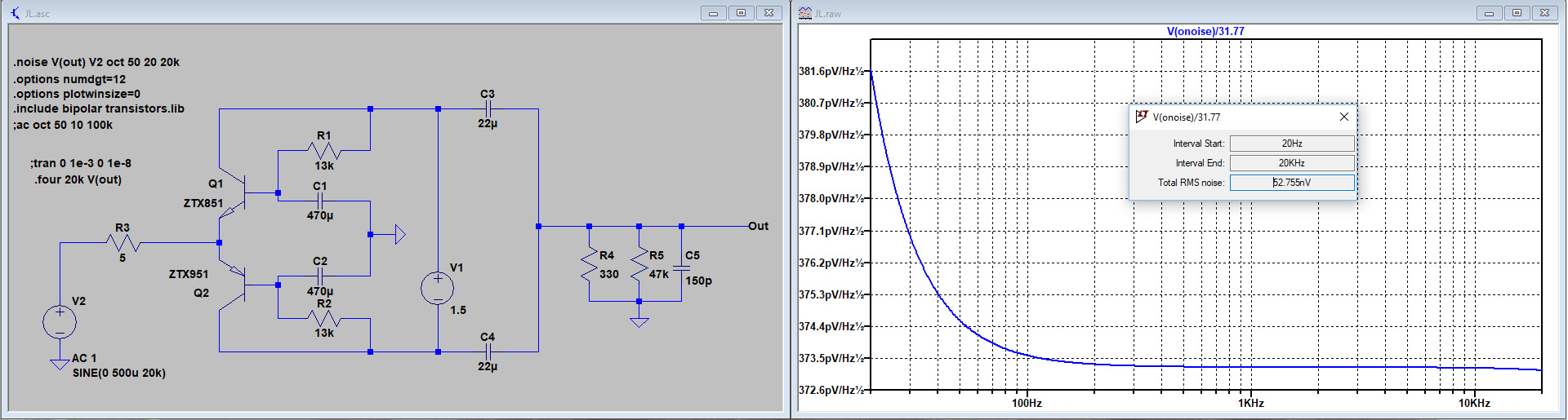

I've redone the sims for a 5R source resistance with the adjusted 1R2 and 1R5 values for the ZTX devices.No. My 1980 measurement of 0.28nV/rt(Hz) was with a 5R (IIRC) resistor.
Since the Leach-ML gain changes a bit from 34.47 to 31.77 with the 5R resistor, I also changed the JC-ML version to this exact gain.
In the sim below, noise including 5R becomes 0.37nv/rtHz but unfortunately not the above mentioned 0.28nV/rtHz.
I mentioned that things are a bit more complicated and that's because the Leach topology has no connection to gnd, preventing DC current from flowing into the Cart, but with the JC topology an undefined amount of DC current may flow into the Cart.
I can't remember where to find this, but John Curls comment was that this makes the sound a bit muddy.
There are two ways to block this DC current, 1) an ugly 10mF cap or 2) a servo.
I don't like caps in series with an MC Cart, so my preference would be the servo, but I have simmed both. As can be seen, both produce the same 0.35nV/rtHz noise.

Mea culpa, mea maxima culpa.I've redone the sims for a 5R source resistance with the adjusted 1R2 and 1R5 values for the ZTX devices.

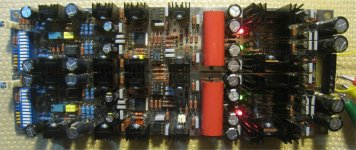

Sure, I did one at the about the same noise or slightly better, about 10 years ago, see attached. Left channel is 0.26nV/rtHz, right channel 0.29nV/rtHz. Could be much lower, but I wanted it for high input impedance (at that time I had a 2mV high output MC cartridge which was optimized for 47k input impedance), so some trade off was unavoidable (input stage is emitter follower with no gain, but it adds to the input referred noise another Rbb). The input current noise was about 3.7pA/rtHz, so it is good up to 40-50ohm source impedance without impacting the overall noise. Rohm 2SD786/2SB737 transistors.
Full schematics including the RIAA stages and Gerbers on my web site; it was built by a bunch of people, always with very good results.
