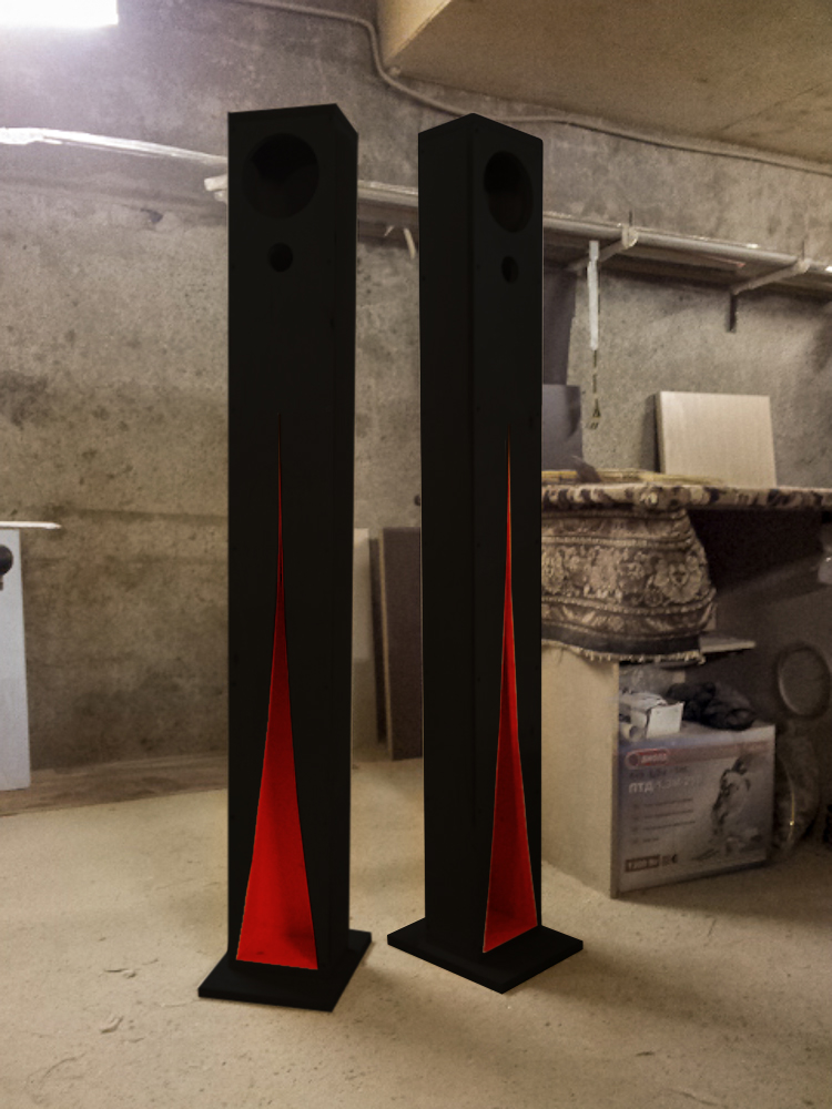

Hi guys
I just found this thread today (DOH!) and have been reading through it with interest. I love the idea. But then I read this:
This gave me an idea. How about extending the slot so it runs over the top, all the way to the back. Here are some sketches of my idea:
The original KaZba:
And with the modification:
Could this be a solution?
Next, how about a KaMba, which would be the same thing, but instead of a Z-baffle, an M-baffle? Anybody willing to try?

Interesting idea but that would not get the mid/tweet closer to the woofer for integration. This would allow more bass to jet through the aperture at the narrow spot on top. The upper bass and low mids still go out the big aperture.

With the right combinaton of colors, K-slot speakers may look just like "Dracula", just on time for Halloween
