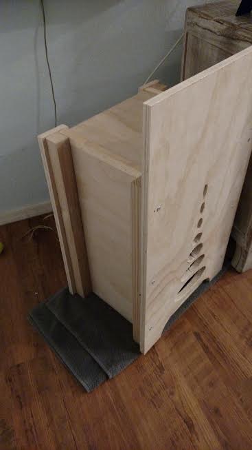

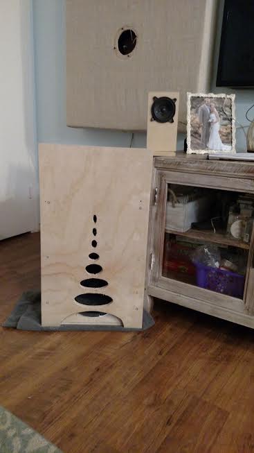

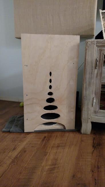

Well the perfect opportunity afforded itself to dip my toes into some Kazba goodness. The trailer needed a new ramp. That's about a half sheet of 3/4 plywood. What to do? Got some old Sony's laying around. All I know about them is that they are 3.5ohm and would dispense alot of low even 20hz sludge in the pushpull sub they were intended for. And that was about all they were good for! So I went to work and quickly nailed and bolted this together running the front baffle wild cuz you never know maybe the Faital Pro will go good in there. Well, let me tell you, sounds alot better than the cube it resided in. Plays loud too and responds to the knobs on the amp. Ran some hip hop, jazz, William Blakes, "limit to your love." I turned it around and and it definitely sounds better with the Faital Pro closer to the bass, so I need to invert the front baffle. Many thanks to all your contributions that help guys like me put stuff together. Now, how do I convince my wife that four Dayton Reference 12's are needed to make this thing really fly? Isn't there a rule somewhere like the 1-2 months salary for the engagement ring that says 1-2 days pay isn't too much to spend on the bass support for your system?

Wow! Nice design with the gradient elliptical K aperture. Great idea and it looks really nice - better WAF than the curved traditional aperture. In a way, it gives more band pass loading yet still has the aperiodic nature of the K. I am glad it sounds good. Are you doing a z baffle dipole because I can't tell without internal photo or read photo.

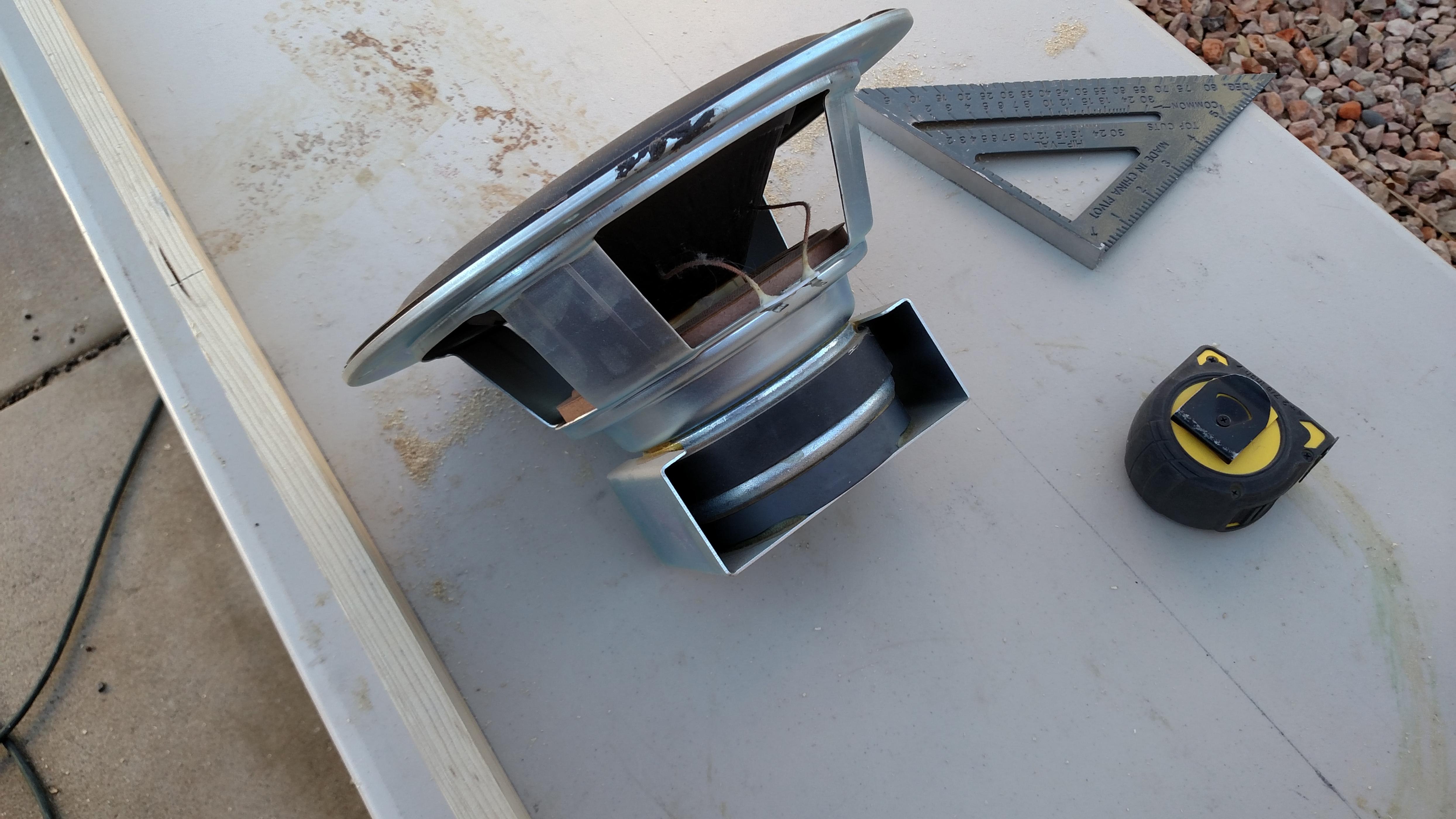

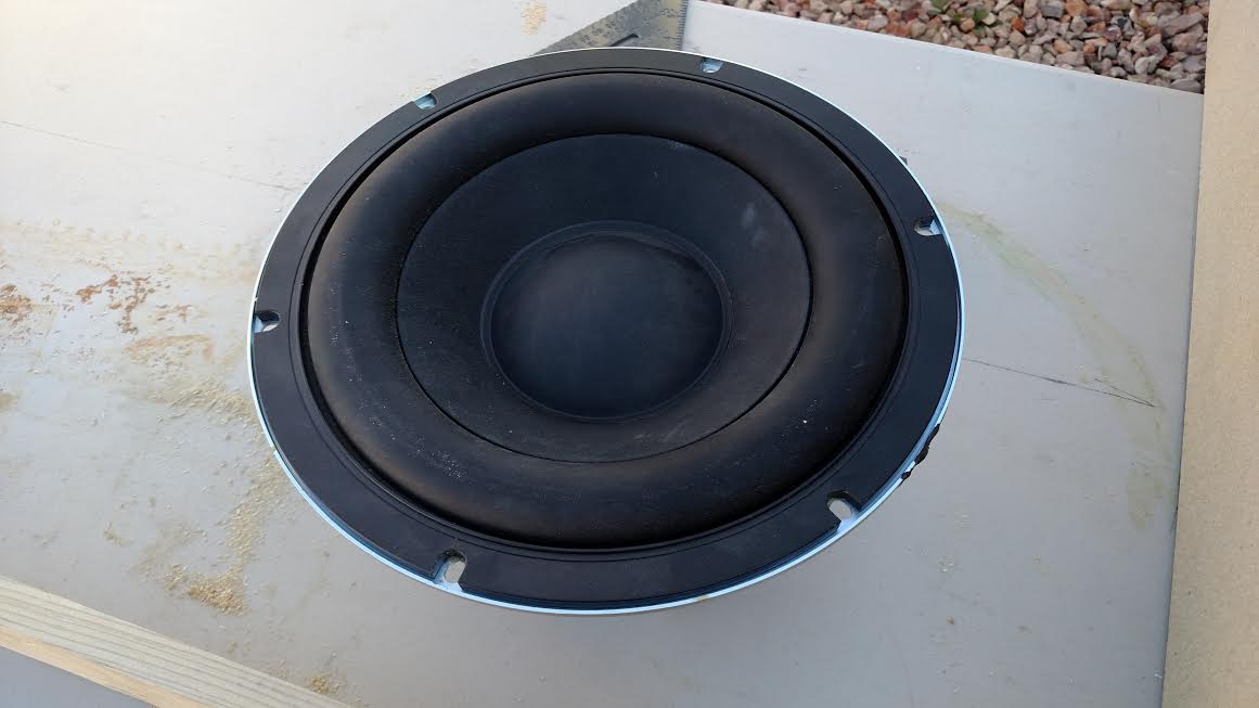

Any photos of inside Z baffle before K aperture was installed? What size Sony woofers are those and are you using 2 per speaker? Still using stock Sony subwoofer amp with its tone controls?
Real curious what Qts and Vas and fs your drivers are - might be a recipe for other to try similar driver. I had good luck with woofers designed for "ported" boxes rather than OB boxes. So Qts of about 0.35 to 0.40 seems to work. Moderate Vas and low fs are good.

There are two in inside and they are 10". Unfortunately I was in a hurry thought I had taken a pic of the inside but didn't. I'm using a Dayton 250 watt plate amp the original Sony bit the dust a long time ago and they've been sitting. Hard to find specs on them. I was able to find that they are 3.5 ohm and that was about it. Makes sense because there were two wired inside a push pull arrangement. I'm looking forward to the days of mini DSP but right now this is working out. There may be some resonance at higher volumes even with the 3/4. I felt the thin area on the hole and it feels like it is resonating. I'd like to get a hold of a piece of Corian or something real solid, assuming that is non-resonant and see if it makes a difference. All in all though I think this dipole is the way forward for me and the look is cool and that matters to me too. I looked into all the possible enclosure types and I think I've picked a "team". I'd still like to build a horn for the 55-2421's that are sitting around collecting dust like the Sony's were.
Several pieces of 3/4in ply 3in wide screwed and glued to the inside of the K aperture laterally will really reduce flex.

Wow. Very cool looking Kazbaesque K-baffle. You get extra style points for the multiple elliptical apertures. That's not a bad idea for a subwoofer application. It may have an effect similar to a horn throat.
I've done a couple TL exits with multiple holes to approximate a K aperture, but never anything front loaded like that.

They're DA270-8. Nice driver and half the price of the reference. I've noticed the Kazba bass seems quite deep even compared to the same driver sealed. Funny thing I wasn't to worried about getting the deepest notes because I'd planned to build a sealed 12" or finally finishing a tapped horn for my sub. How deep do you suppose it is going before it seriously rolls off? How do the transients & group delay (whatever that is) compare to a sealed cabinet?
