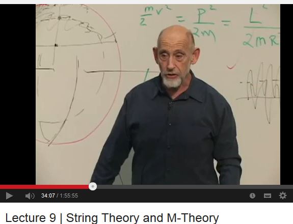

Lecture 9 | String Theory and M-Theory - YouTube

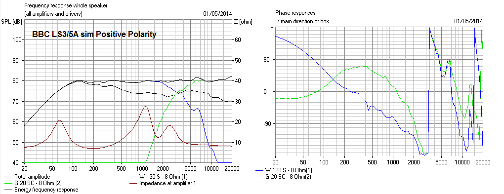

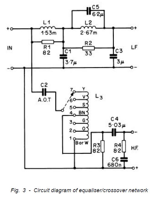

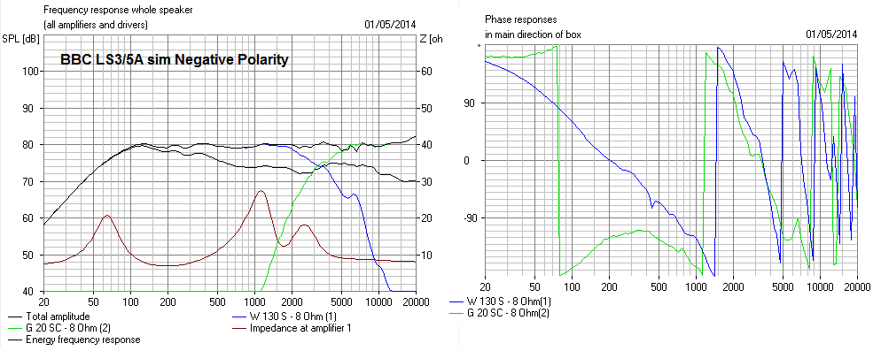

I did an analysis of the crossover elsewhere. This Visaton driver sim has all the essential features except my ugly attenuator on the treble. It would be nice to lose or redesign that, since it spoils the amp friendly rising top end impedance of the LS3/5A. The positive polarity version might be more practical.
