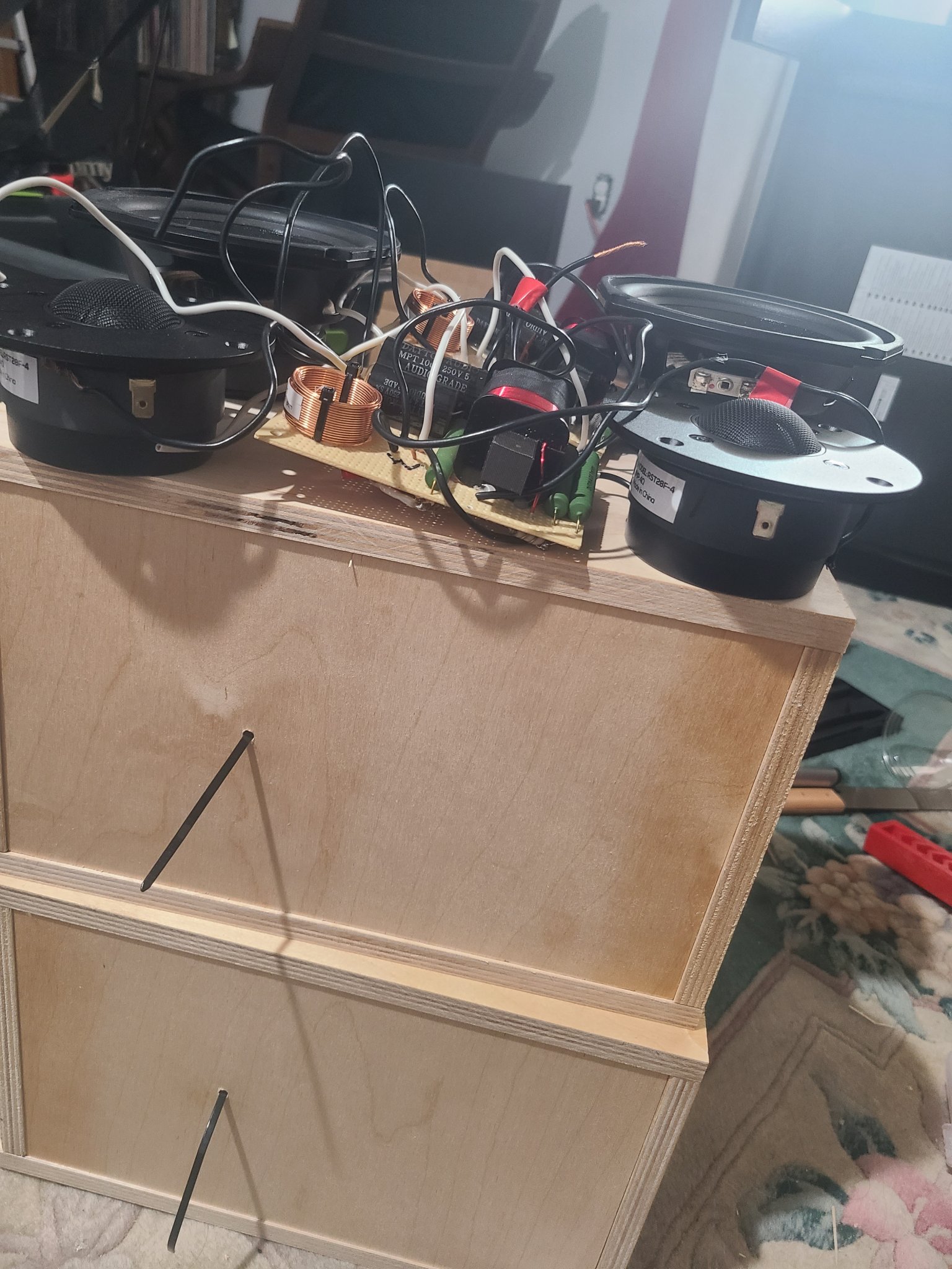

How does this ported differ from TL version?Hi Bryguy,
Just keep the box dimensions exactly the same. The port when sealed with a plug doesn’t significantly change the volume (thickness of the tube is negligible). You are right, a stopper/bung placed on the vent exit will return these to original sealed alignment. Remove plug when extra bass is needed.
My Rockvilles are still unfinished. Maybe I should give them some boiled linseed oil now that they are really going to be staying in my office as near field speakers. The cabinets were made by my friend C.B., now retired but he used to be the carpenter/model maker for the Smithsonian. The oak used in the battens were salvaged from a razed civil war era barn near Rockville MD. Hence, the name. The same oak is used on the laser wood burned badge on the back.
Vunce did a nice job with the roundover radius on the vent. I like the white PVC color too.
The TL has a very different sound as the bass is deeper and has more of an extended slower falloff. You can hear more articulation in the bass with a TL. Bass reflex is less extended but more compact cabinet. Midrange is also more open on TL since driver does not suffer as much compressive effects.

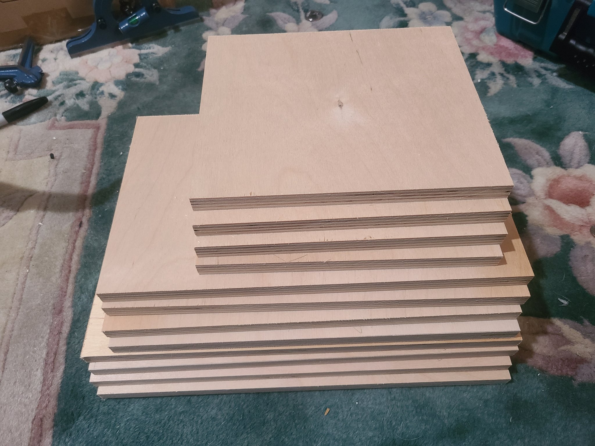

You have a personal CNC router?
When making just two oddly shaped rebates, there is a trick to making a reverse template. There is an explanation somewhere in the multi-way forum on how to do this. CNC is useful for making production runs or if you are handy with CAD/CAM programming.
I do, although I barely know how to use it. It's just one of the dinky DIY ones you can buy online for <$300 new. It's called the Genmitsu 3018 ProVer. It's actually quite nice for how inexpensive they are. It's kind of loud, and the motor is weak, but it can make surprisingly accurate cuts. I've only used it so far to cut out tweeter holes on very small baffles, as well as just playing around a bit with scrap wood. I highly recommend them.You have a personal CNC router?
Found one at a huge discount on Facebook and I just had to pick it up. I've figured out the basics, but I still am not sure how to import CAD files. Sure it's not too difficult, but it's not something I've played with yet
Oops I didn't see the second part of your message. Thanks for the tip!When making just two oddly shaped rebates, there is a trick to making a reverse template. There is an explanation somewhere in the multi-way forum on how to do this. CNC is useful for making production runs or if you are handy with CAD/CAM programming.
