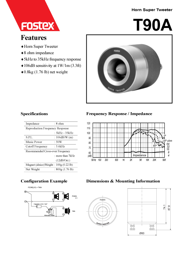

A logical extension of the homage speaker along the STAFT direction would be to use a larger fullrange driver or two (such as Fostex FE208Sigma), slap on a back-loaded horn to get more bass, and use an expensive horn-loaded super-tweeter (such as Fostex T90A). So perhaps the Fostex people did know how to make good sound.
![Fostex T90A.jpg Fostex T90A.jpg](https://www.diyaudio.com/community/data/attachments/797/797928-682c93255b4af2b1f34e46bf27b47a8a.jpg)
They just could not come up with a catchy acronym.

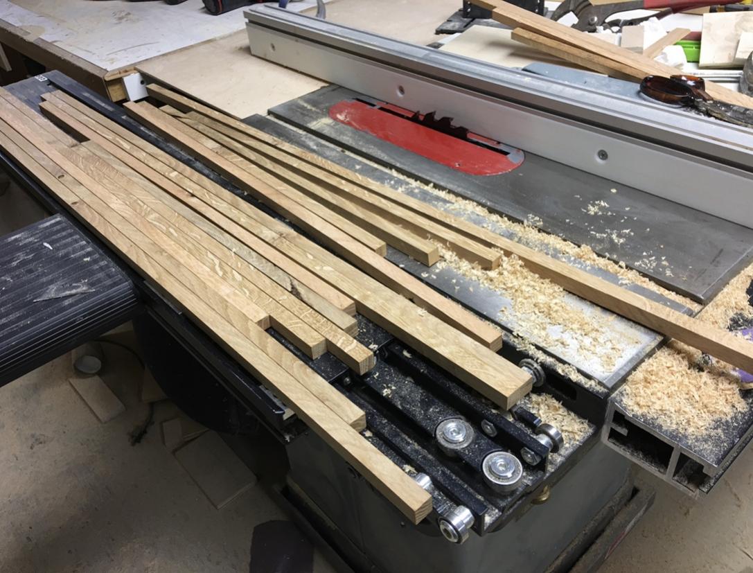

Xrk - - How do you cut panels from XPS foam sheet? Do you use a band saw, a tables saw, or perhaps a straight edge plus utility knife ?
I may start using XPS foam sheet to make prototypes and mock-ups...
I used a table saw to cut most of the panels for my FAST TL’s. You can get consistent, square cuts this way, especially for the internal baffle pieces.
A 1” snap off blade utility knife works great for hand cutting with a drywall T-square. Extend the blade and hold at a low angle for clean cuts.

Can you cut the XPS with a heated wire polystyrene cutter?I used a table saw to cut most of the panels for my FAST TL’s. You can get consistent, square cuts this way, especially for the internal baffle pieces.

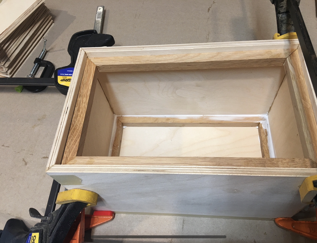

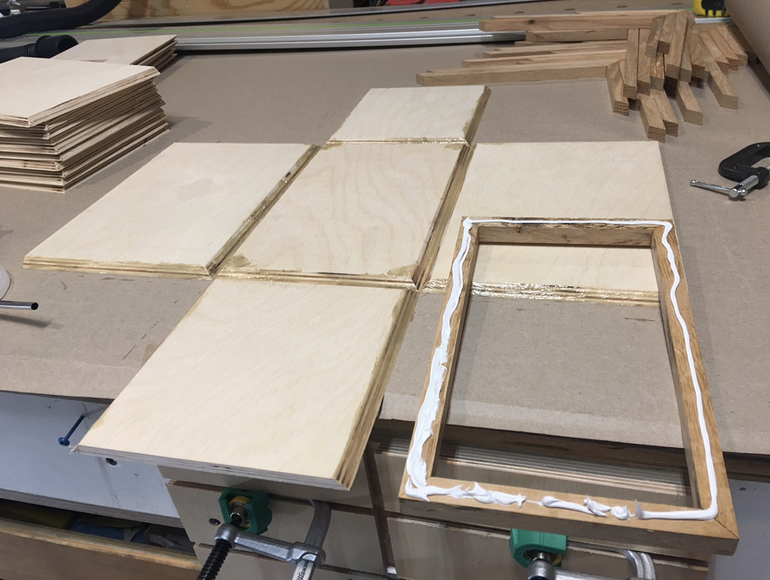

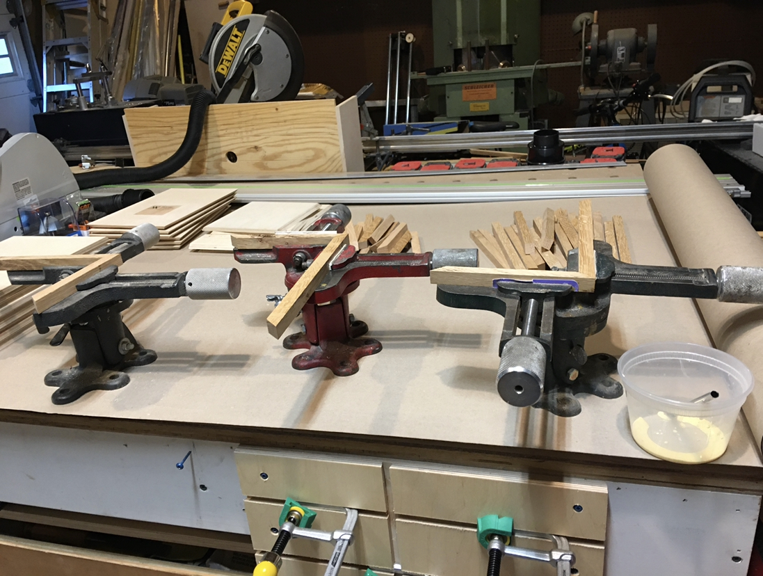

More progress, cutting the old white oak into uniform 5/8in square strips. Gluing the inlays in. Gluing the mitered strips with a framing clamp (with V staple applied already).

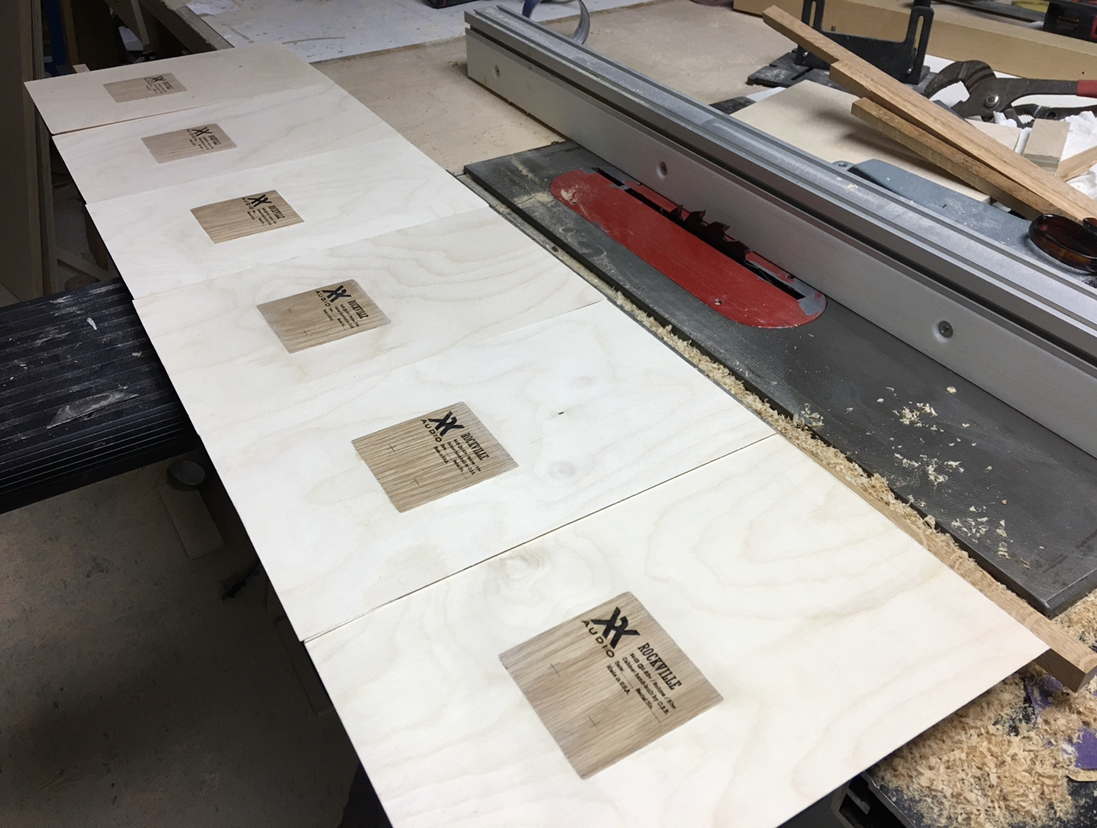

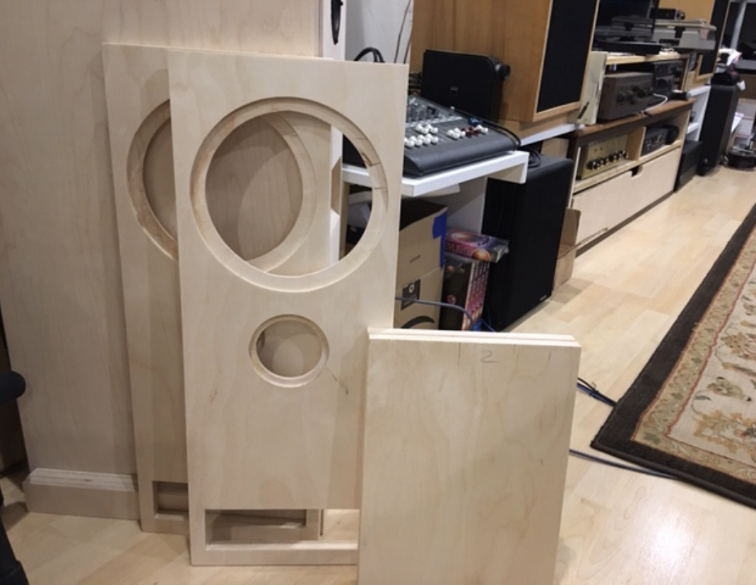

Thanks, Vunce. These are coming along well. The baffle cutouts should be done later this week and the new “Rockville” speakers will be born.
Rockville, Maryland is the location where the old barn wood was found. Also the name of a historic Civil War battle. The heritage of the oak battens providing the background and stability for the main panels and the inlay in the back makes for a nice backdrop to this special speaker.

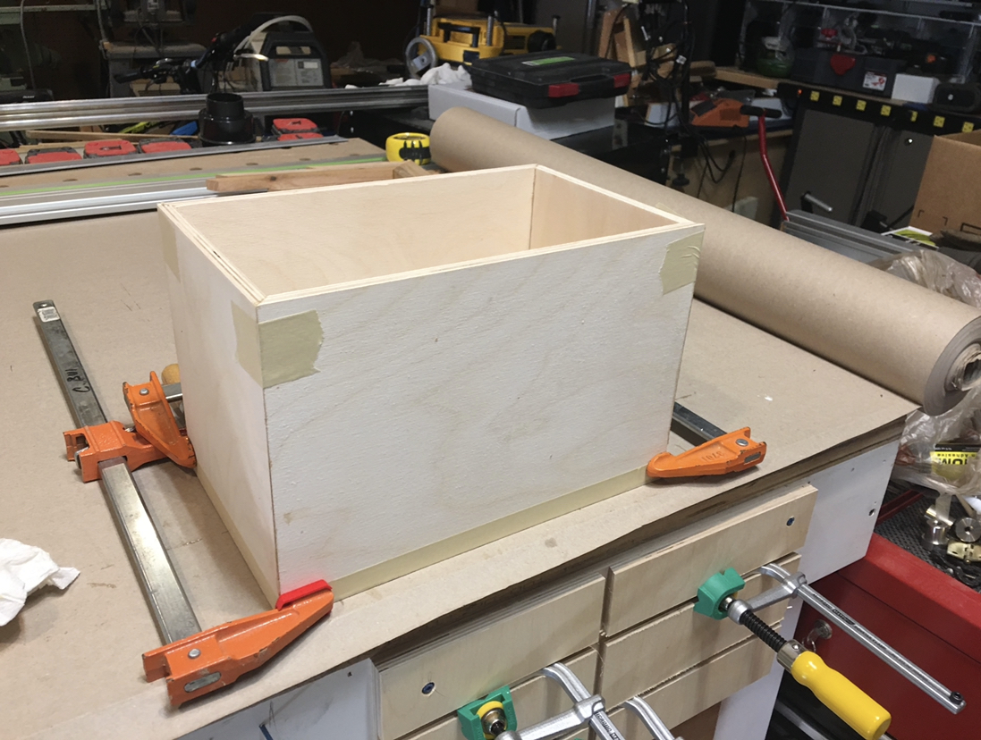

Was able to mount the drivers and crossovers for a listening session last night. Very nice design X. The driver integration seemed spot on and the phantom center stage was very enjoyable. I will get some pictures together.
still need to sand the cabinets, install the damping and drill the baffles for the mounting screws. Mounting screws are to arrive Tuesday.
Taking suggestions on finishes for the cabinets.
