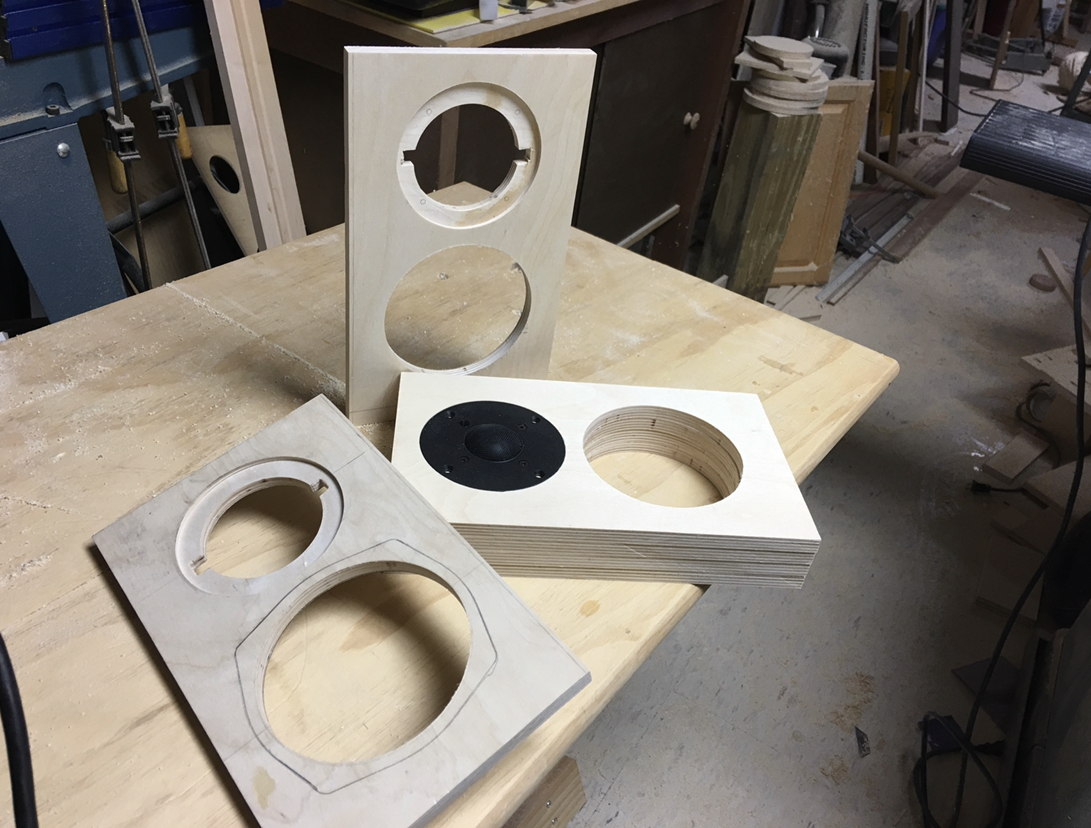

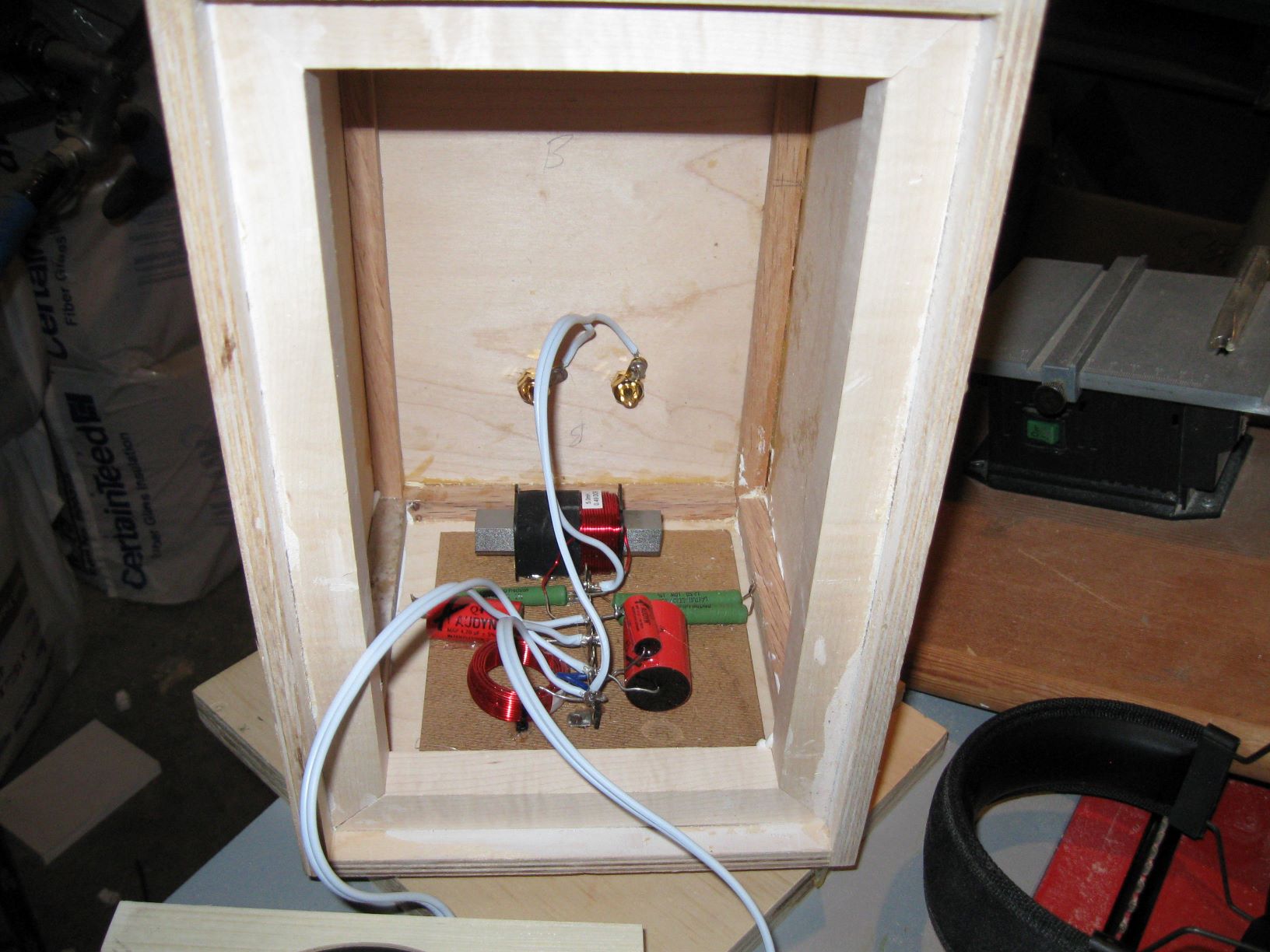

Here are some images from my build. I used bigger battens for the front frame to give more room and bite for the mounting screws. May not be needed but I still don't have the screws.

Thanks for the comments.
I used a clamp to hold the front baffle on tight when listening, but I plan on using foam gasket material to seal the cabinet up tight.
The pincushion rebate was not as hard as I first thought. Cut a 1/4 circular rebate then used a forstner bit to cut the corners out. After a little work with a super sharp chisel (there was blood) and several test fits, the woofer dropped right in. It took a small part of the time needed to make a template for the router.
I wanted to sand the cabinets before lining with noico material.
The last thing I am not sure of is how many magic eraser pads and where do they go?.

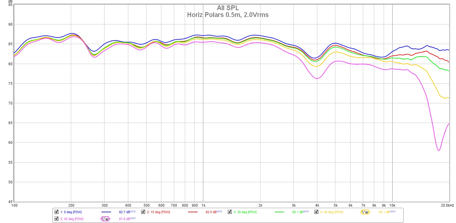

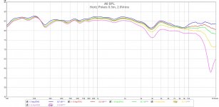

I just took some polar data for this speaker. It looks pretty good if you stay within a +/-30deg (60deg cone inclusive) horizontally. The sound is very even.

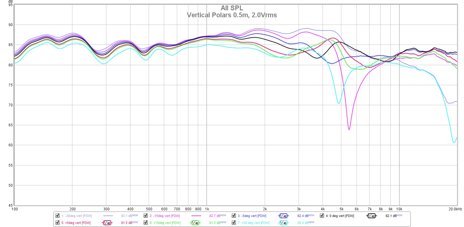

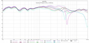

As for the vertical polars, it suffers the same problem as all non point source speakers in that there are nulls when you move beyond the +15deg/-5deg (20deg inclusive) vertical cone biased towards angles above the tweeter. It is better to be above the tweeter than below it as there is a deep null at 5.5kHz when 15deg below the tweeter axis. So for desktop use, make sure the stands are not too tall so that your ear height is below the tweeter.
Here are the horizontal polars at 0.5m and 2.0Vrms:
attachment.php
I think that the above is a very respectable performance for a tweeter crossed at 5.5khz. There really is no detectable "beaming" if you are within the 60deg cone.
Here are the vertical polars at 0.5m and 2.0Vrms:
attachment.php

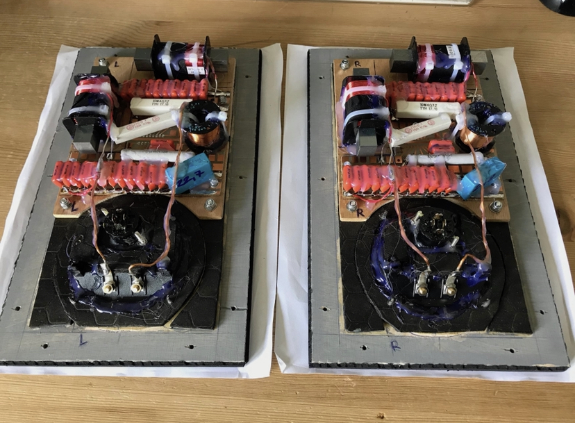

I love your crossover layout - very good use of “gumdrop” film caps!

The m&m red caps story was that I had 200 of them ( 1uF 100 V ) - so I measured each and every one until I found exact match sets for both speakers, so the crossover capacitors and resistors are matched to be within 0,1% except for coils... nobody is that rich to buy multiple coils and then select the best... eventually un-wounding extra wire from the coil...
Also by connecting multiple capacitors in parallel - you drop esr rating down - so no bad practice after all...
The low ESR is nice for bass impact but probably less important for a tweeter high pass. In any case, 2% to 5% is probably all you need relative to tolerance for parts on a XO. The new precision series parts from Dayton are 1% (resistors and capacitors) and well priced. For inductors, you can always measure and unwind a turn or two but really, it's not goiung to matter for a crossover. I like the fact that you used what you have on hand though.

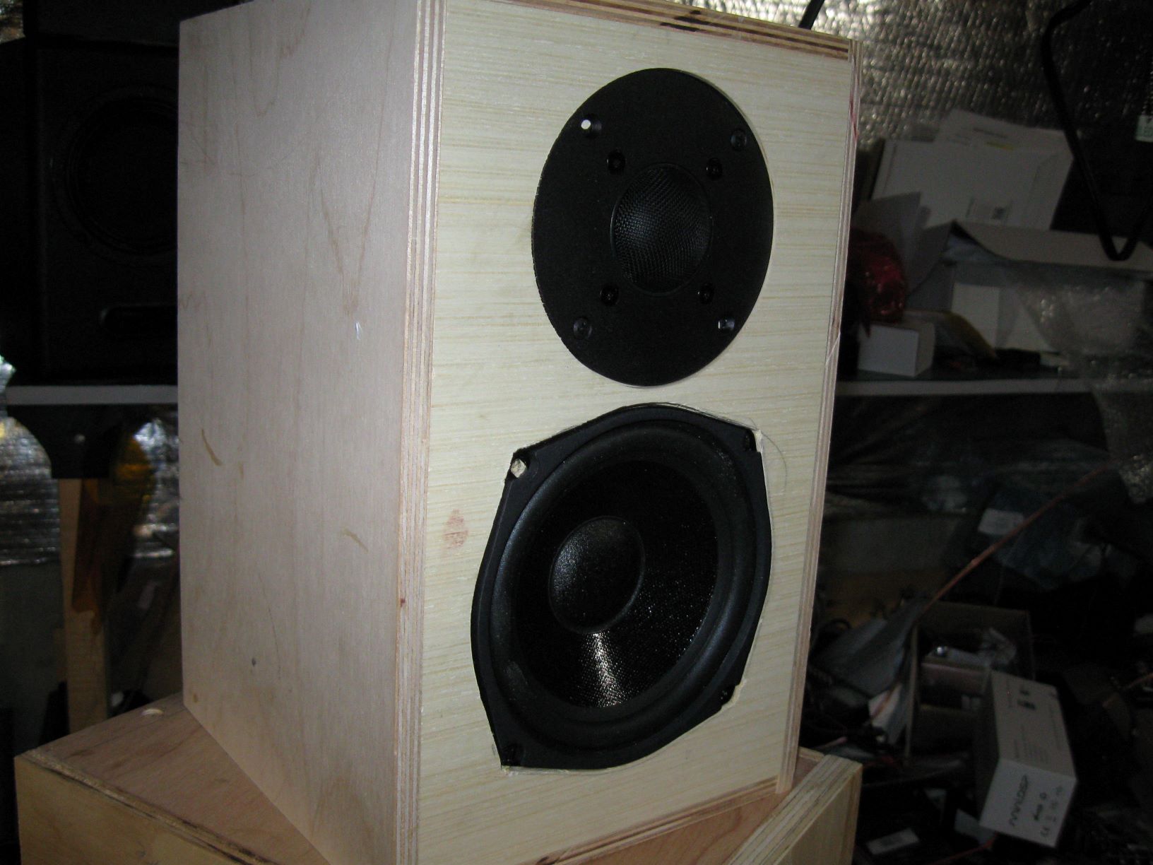

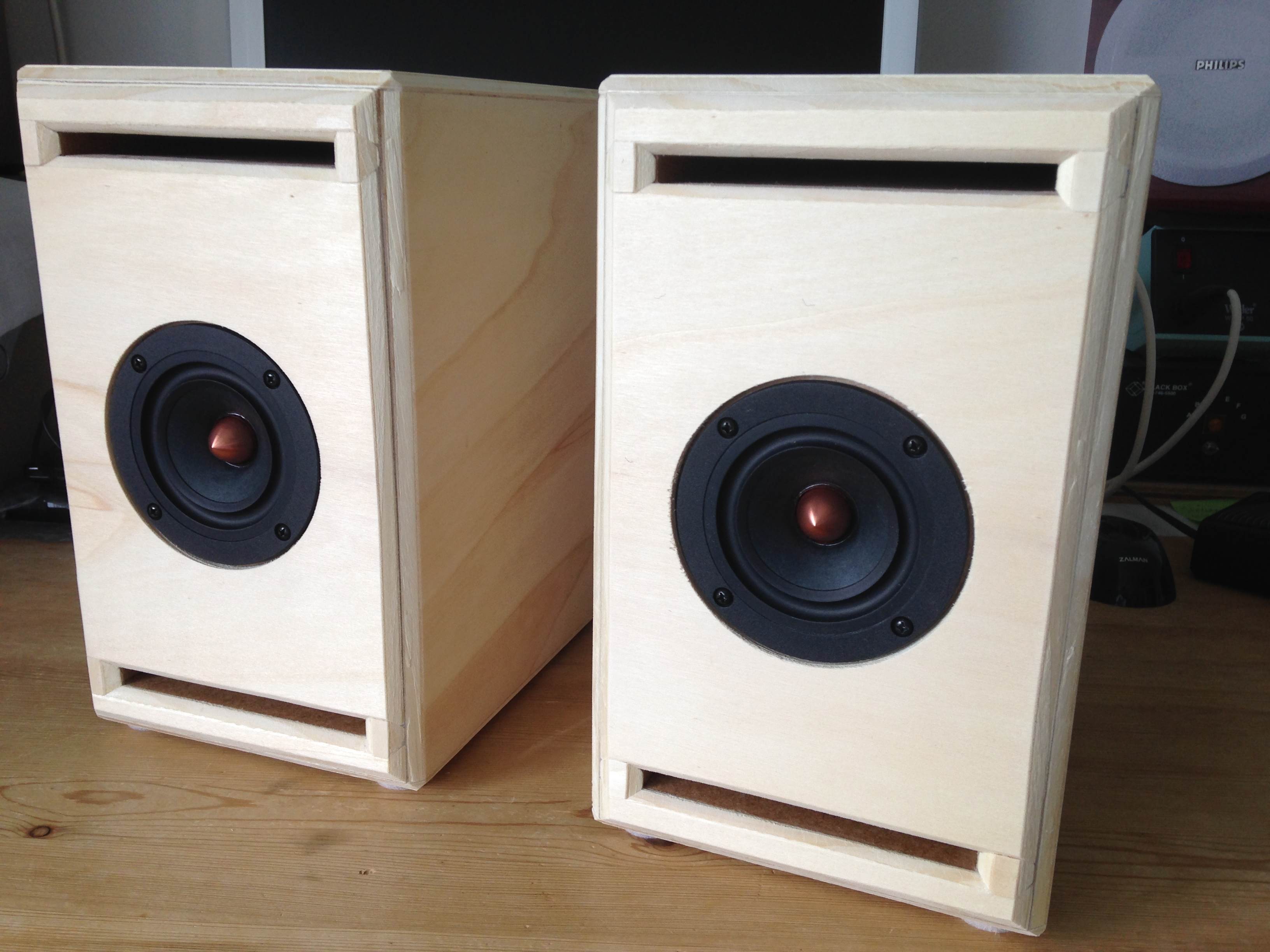

Finished

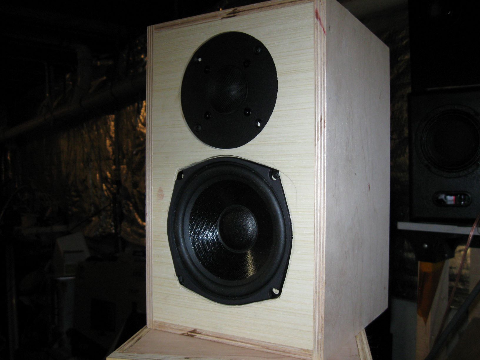

I went ahead and installed the noico sheets and the melamine pads after a good sanding. Drilled the baffles for screws and put gaskets around the front battens, speakers and rear connectors. Screwed the baffles down tight with screws I had.
These speakers sound really good. They seem to my ears very balanced through the spectrum. Before I installed the damping and before X posted the polars, the speakers were on top of another project speaker above my ears at about 1.5 meters away. They were so quiet in the crossover range and now I see why. I was in that 15 degree notch. Without the damping and at ear level they were a little busy in the midrange as can be expected.
Last night I moved them to the living room and placed them below my ear level on about one foot stands. Like X did I placed them next to the TV but did not connect them to the TV sound. Instead I used a Rpi music streamer into an ACA amp. Watched most of the football game with the TV sound off listening to these speakers. They did everything very well and were easy to enjoy with out causing listening fatigue even if the drivers are so new and possibly stiff. I'm really happy that I built them.
Thank you to X for all the design work. Well done.

Hi Lost Signal,
Your boxes look great. Just a little more sanding and some stain/oil and you will be in your way.
Thanks for the listening impressions and for building the speaker. Great way to watch a football game without commentary but enjoying your own music. 🙂
