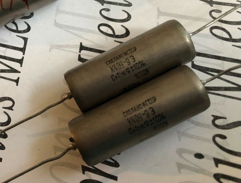

I've rarely seen any deterioration on sealed paper caps (K40, Sic-Safco, Gudeman, Vitamin-Q, Westcap, Hopkins... ) IF unabused (overvoltage, overheating) , and yes , they are VERY, VERY nice on crossovers
All the sealed Russian caps test perfect in my experiance, zero leakage, even beyond their rated voltage. The MBM's are not sealed, and are almost always junk so ignore those.
None of the Russian caps have a direction marked (some people claim they do), but they dont. I always test them for myself on an oscilloscope to determine the outer foil.

As usual, one lead of capacitor is connected to external layer of the roll, another lead - to internal. That connected to external - should go to lower impedance point at the schematic (usually to output of previous stage, since its output impedance is lower than input impedance of next stage).
How to distinguish leads? Try to connect oscilloscope leads to leads of capacitor, at maximum sensitivity of scope. Then touch capacitor's case by hand. See difference in hand induced noise.
Correct.All the sealed Russian caps test perfect in my experiance, zero leakage, even beyond their rated voltage. The MBM's are not sealed, and are almost always junk so ignore those.
I do not recall them having any direction, nor any of the leads are connected to the casing.
I even used a 200V one in a 300V situation (by mistake ) for years, without any issues.
