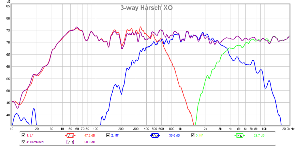

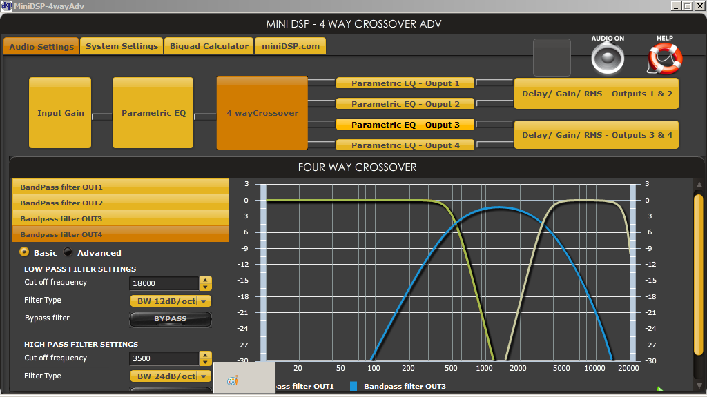

So I got to thinking if this can be applied to a 3-way by mirroring the XO topology. That is Butterworth 4th order for the low pass on the woofer, Bessel 2nd order for the mid high pass and Bessel 2nd order for the mid low pass (or Bessel 2nd order bandpass for mid), and a Butterworth 4th order for the tweeter high pass. So what this means is that pretty generic components can be used in that a special wide band mid is not required anymore as the filter is already a fairly steep 2nd order. And for the woofer and tweeter, we can use 4th order filters which are great for controlling distortion, and preventing cone breakup leak-thru from the woofer.
As I had a 3-way XO test bed already handy, it was just a matter of putting the XO settings into miniDSP. So here is the electrical XO I implemented in miniDSP:
![495707d1437975878-s-harsch-xo-harsch-3-way-minidsp-xo.png](https://www.diyaudio.com/forums/attachments/multi-way/495707d1437975878-s-harsch-xo-harsch-3-way-minidsp-xo.png)
And here is the resulting acoustic XO that was measured (yes the SPL levels are fairly low so that I did not wake up the family during sweeps). As you can see, the curves are fairly common and innocuous. The 1st order textbook curves of the B&O were especially hard to achieve in practice. With the Harsch topology 2nd order and 4th order are much easier to get. The tricky thing is what to do for the time delays? Well, it is exactly the same delay assuming driver acoustic centers are already time aligned. The mid needs to be delayed from the woofer by 0.5/fc_low and the tweeter needs to be delayed from the mid by 0.5/fc_high. For my case, I used a 500Hz and 3500Hz XO points:
![495708d1437975878-s-harsch-xo-harsch-3-way-xo.png'](https://www.diyaudio.com/forums/attachments/multi-way/495708d1437975878-s-harsch-xo-harsch-3-way-xo.png')

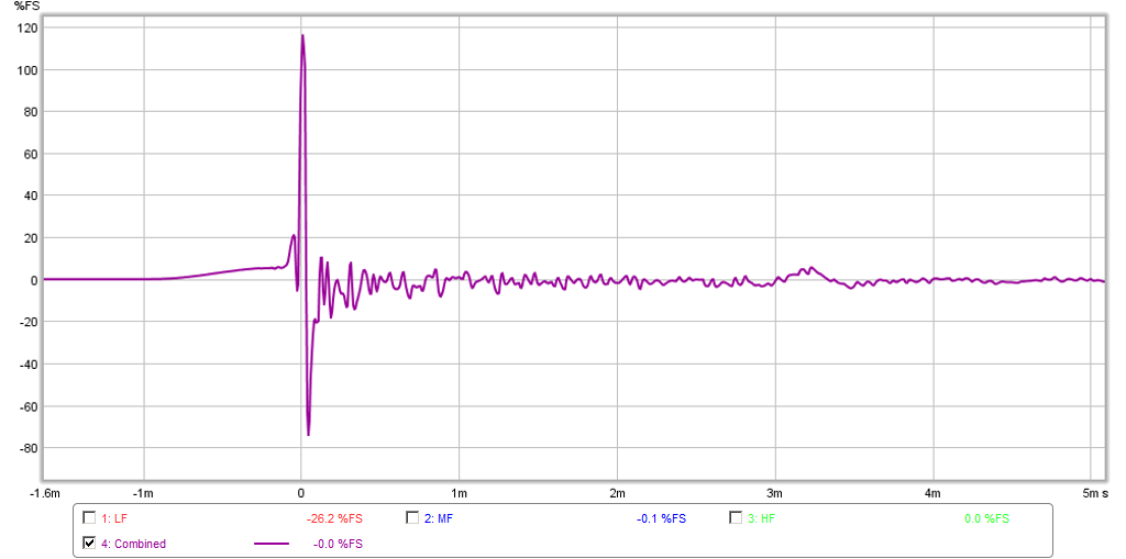

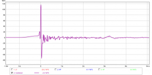

Here is the resulting Impulse Response:
![495709d1437975878-s-harsch-xo-harsch-3-way-ir.png](https://www.diyaudio.com/forums/attachments/multi-way/495709d1437975878-s-harsch-xo-harsch-3-way-ir.png)
And here are the resulting Step Responses - I know there is a little pre-rise but overall it is much better than a jumbled up-down-up-down mess you would see with an all LR2 or LR4 XO:
![495710d1437975878-s-harsch-xo-harsch-3-way-sr.png](https://www.diyaudio.com/forums/attachments/multi-way/495710d1437975878-s-harsch-xo-harsch-3-way-sr.png)
This is still a work in progress. Does anyone see any problems with it? I think this works. I am still having a problem getting the phase to be wrap free - it seems to wrap at the centeral frequency and not at the low and high XO frequencies. Anyhow, still debugging it. This XO may be useful for folks looking for an easy to implement quasi-transient perfect XO using IIR filters in DSP. How does it sound? Fantastic! My speakers are essentially 98dB sensitive and super loud and clean with this XO. I am really enjoying the sound and how the percussive sounds like guitar and drums really have a "live" feel to them.

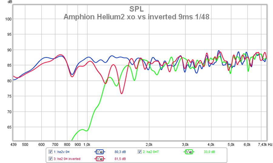

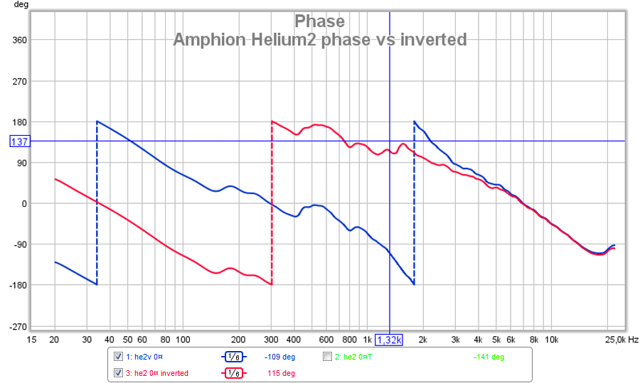

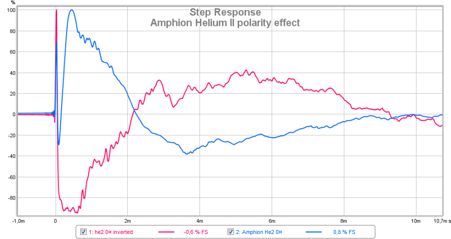

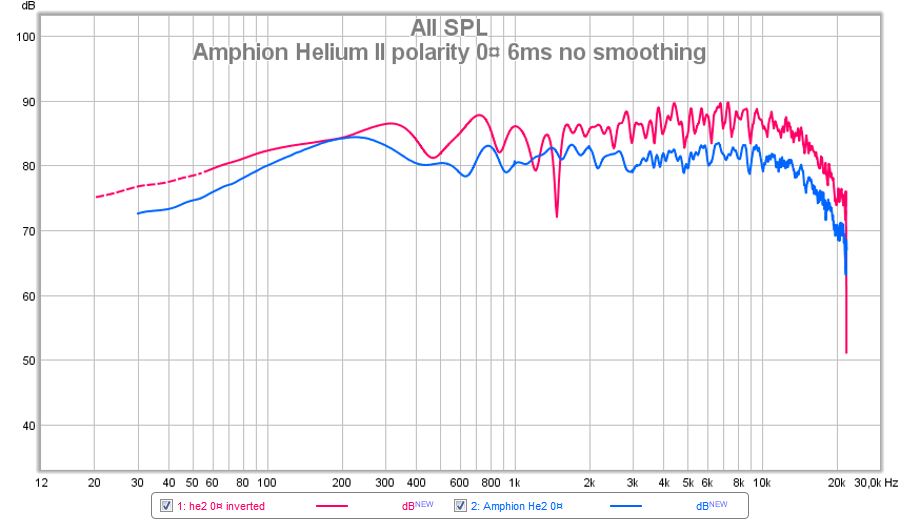

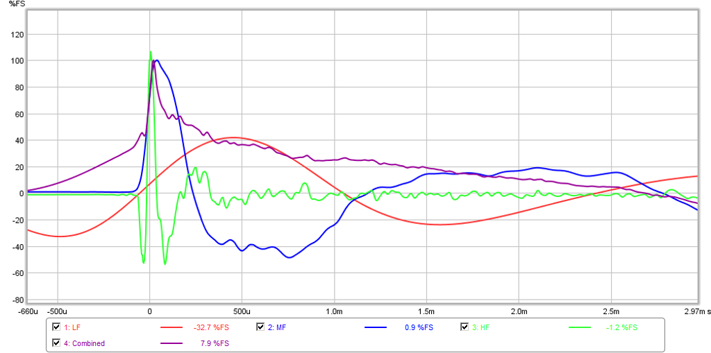

This kind of asymetric xo is an old trick. I ran to it when I measured my Amphion Helium IIs. It has like B2 for bass and LR4 for tweeter. I can't hear the difference! Here "inverted" is the factory default setting, it gives nice step response!
- S. Harsch XO
