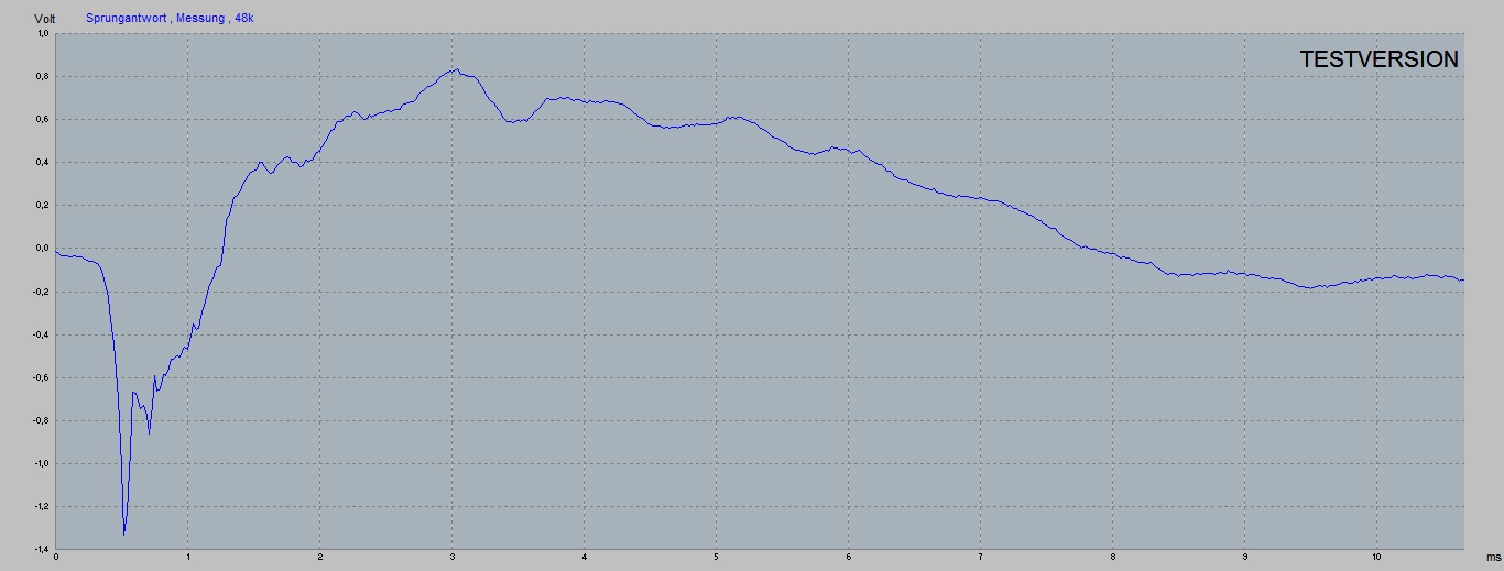

Here you can see the step response of a Beyma 8cx800Nd with a subtractive crossover with 2nd order HP and 1st order LP. There is an additional delay for the woofer using a Bessel lowpass at some kHz. Because the group delay of the woofer isn't Bessel-like it might be better to use another filter type for the lowpass that gives a better group-delay consistency but that would have to be found by experimentation.
The measurement is inverted however but that doesn't matter.

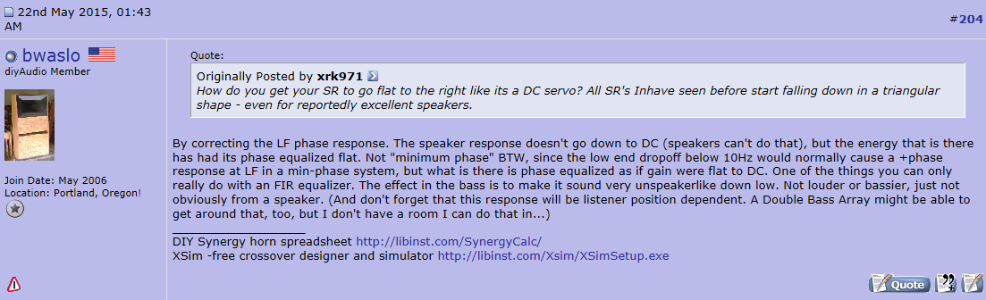

Next stepup for impressive looking SR is those that linearize phase down low even FR fall off as the SR seen at the very bottom this post, this i also tried out and made it with RePhase, it can sound impressive but a thought here is that for old recordings they were probably not mixed with such filter so a little afraid it becomes a effect in that producer probably had more normal group delay when doing his mix. Below captured picture show bwaslo answer to xrk971 regarding the nearly DC coupled looking SR seen at the very bottom this post.
bwaslo (LINK: http://www.diyaudio.com/forums/full-range/273971-group-delay-questions-analysis-21.html#post4333659)

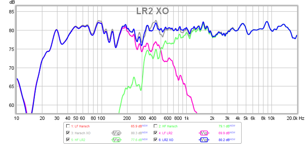

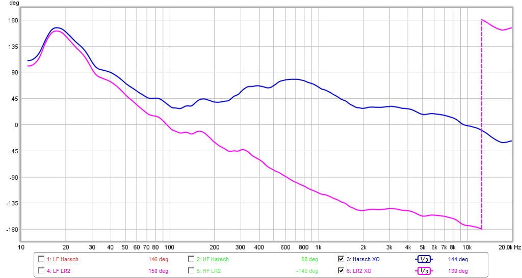

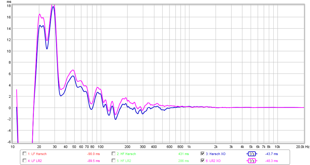

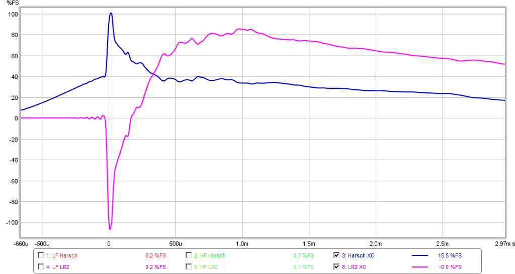

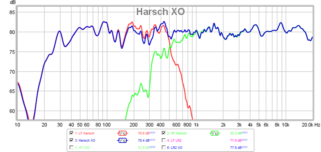

Harsch XO compared with 2nd Order Linkwitz Riley XO
The Harsch XO was implemented at 400Hz electrical frequency but acoustic XO is closer to 500Hz. A 1.62ms delay between mid/tweeter and woofer was used:
The LR2 XO was implemented at 310Hz for the low pass on the woofer and 400Hz for the high pass on the mid/tweeter to get an approximate 500Hz acoustic XO frequency. A 0.22ms delay was used to time align the drivers:
Here is the comparison of the step response, the LR2 XO tweeter goes the wrong way (and this can be seen in the time series trace below):

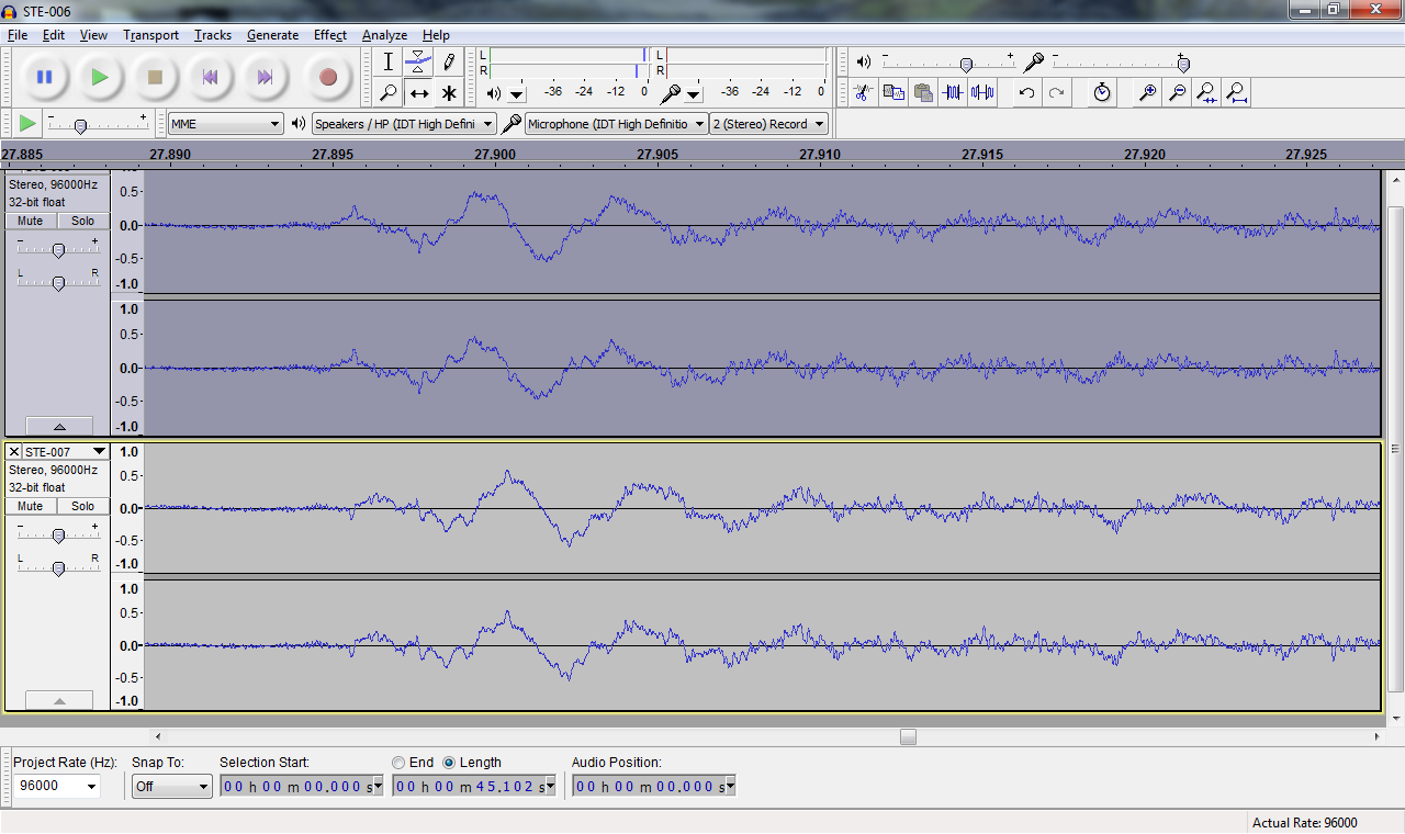

Here is a screenshot of the time series for the Harsch XO (top) and LR2 XO (bottom) - as you can see, the traces are sometimes 180 deg out of phase.
Here is the comparison of the phase for both - Harsch phase varies a lot less and doesn't wrap:
Here is the comparison of the group delay - the Harsch has about 1ms less GD:
