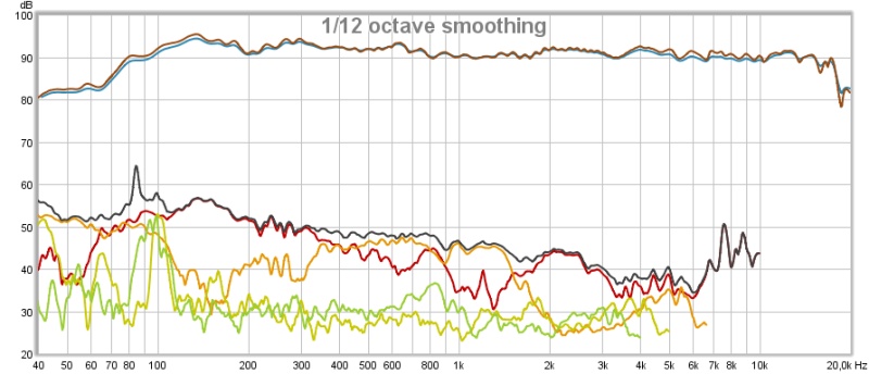

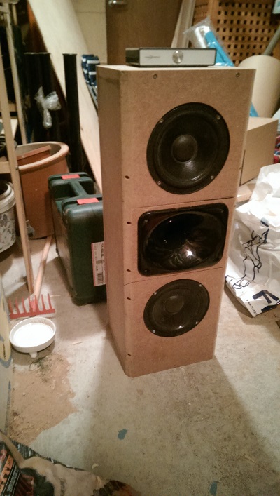

My first try of Harsch (comp to LR4)

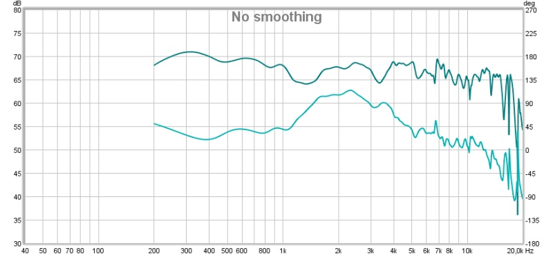

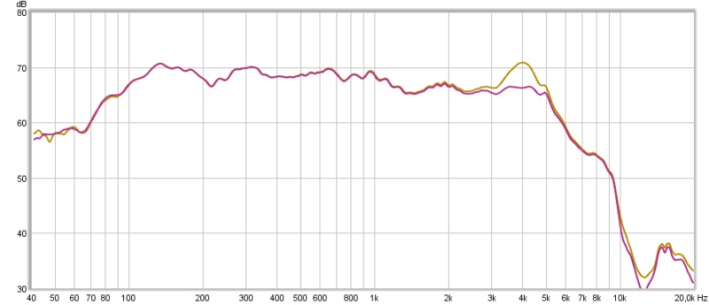

I've made a test speaker to see if I like compression drivers (well one at least) and to test an idea of how to control vertical directivity. I looks like this:
It's a Beyma CD10Fe on Eighteensound XT120 between two woofers (5") that were salvaged from a small floor stander from Audio Pro. Dimensions of baffle are 25x69 cm (10x27"). (The reason I'm so detailed in this post is because I've never really looked at crossovers before, so please tell me if I'm doing something strange.)

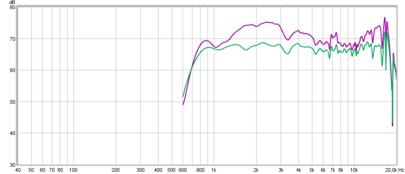

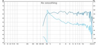

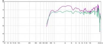

I first used a little PEQ (minidsp, only subractive) to flatten the curves:

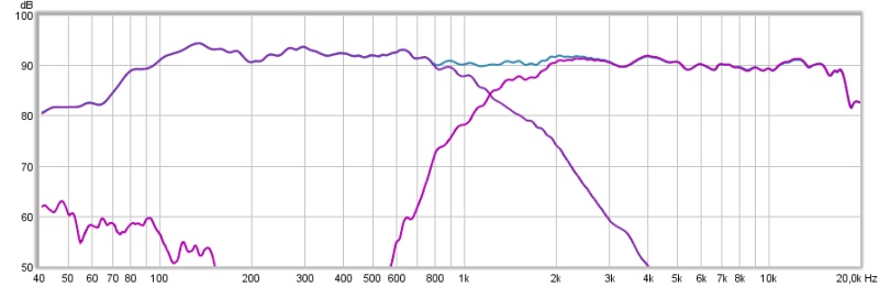

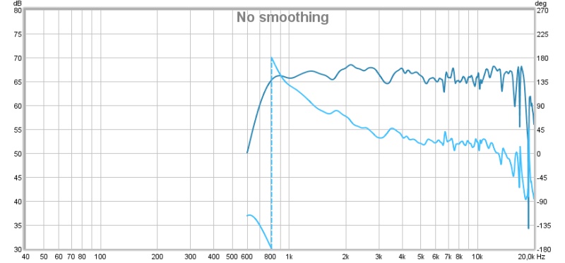

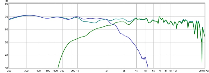

This is how I first set up the xover (LR4 1300 Hz):
Looks quite nice IMHO.

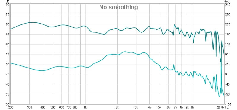

With phase:
Distortion:

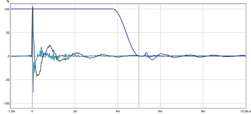

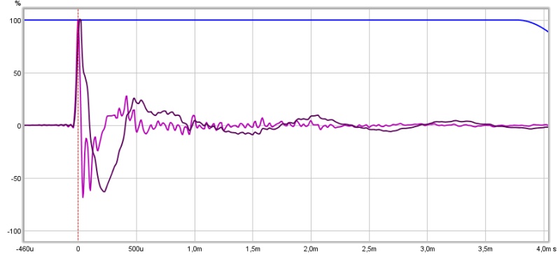

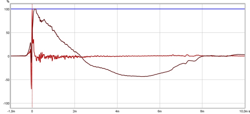

How about step response?
Oh. Not very good.

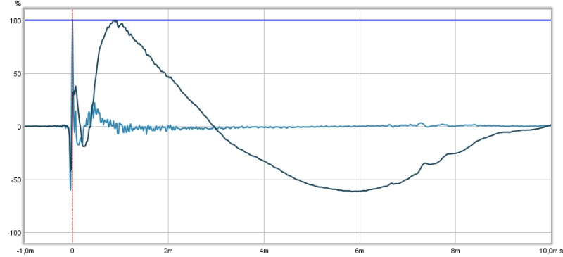

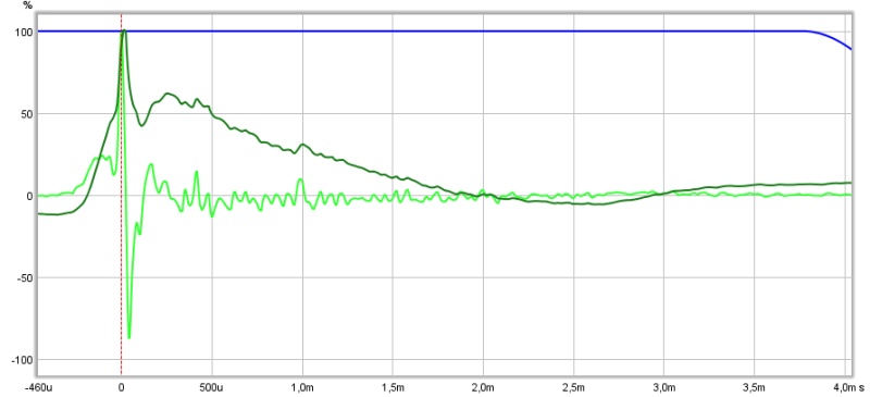

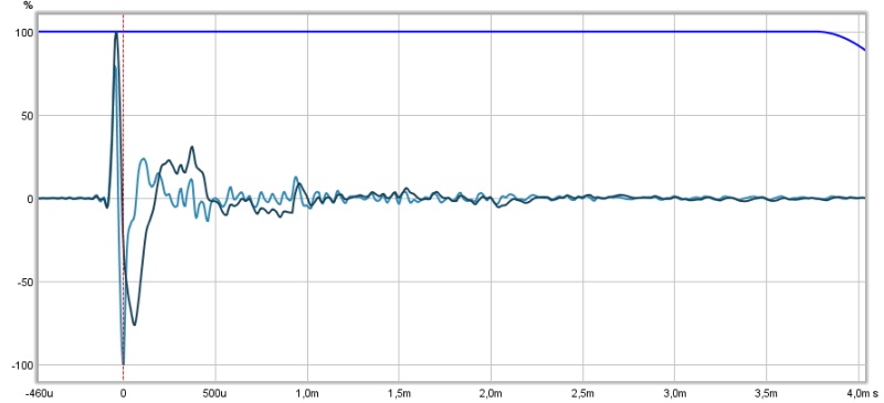

Lets test the Harsch method (1300 Hz as well):
Much better phase.
Much better step. Impulse is still first -70 % before +100. Fixable? I chose a reasonable delay from a physical point of view (deep waveguide) and then added the delay from the Harsch method. After that I tweaked (increased slightly) to get a cleaner step response.

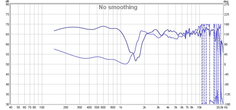

Flat phase before crossover?
You are correct in your assumption that there was something wrong in the wiring, either the amplifier (TPA3116) has incorrect markings, or I've misinterpreted the markings on the woofer. I can't seem to get it working though, is it because the phase needs to be flat before adding the crossover?

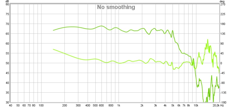

Here is how they measure before adding crossover (wired so I get correct direction on step response):
Woofer:
Tweeter:
Together:

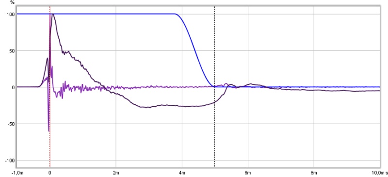

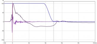

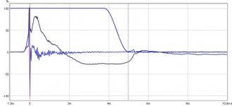

And this is what happens if I follow the method:
That is, setting 0.3 ms delay in the woofer for physical time alignment (is there a way of getting this from the measurements?) and setting 0.38 ms delay on the tweeter (0.5/1300 Hz). Impulse/step response:

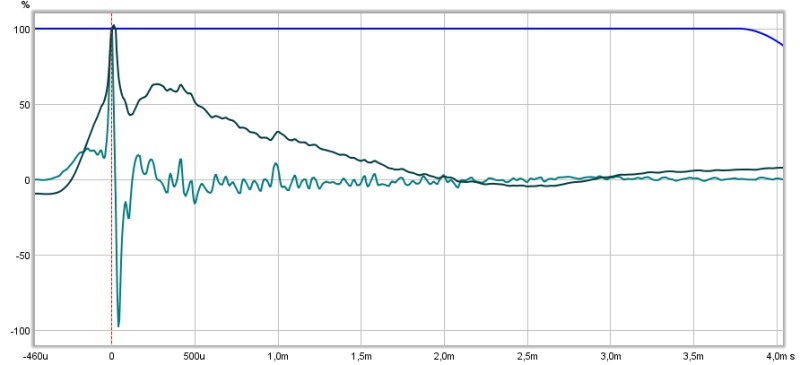

If I then invert the tweeter I get this:
Is it all due to the phase slope of the tweeter? If so: can I add something (all pass filter) to correct this in the minidsp?
Note: all measurements at 1 m distance, 1.3 m height and windowed (2 ms before, 5 ms after). Directly in front of tweeter.

Use the "overlay" feature in REW and plot the step response for woofer and tweeter with the phase such that both go up. The overlay will show the delay between the tweeter pulse and woofer rising edge. Adjust delay to move these together. A delay shifted more than 180deg will require a phase flip on tweeter. That means your delay of is off by more than a half cycle at the XO frequency.
You are close. You also can tell when you do it right in that combined response will fall a little below the plain woofer response.

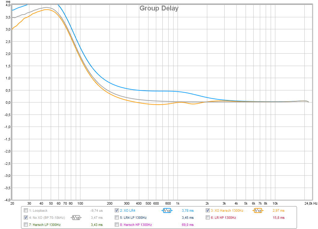

onni,

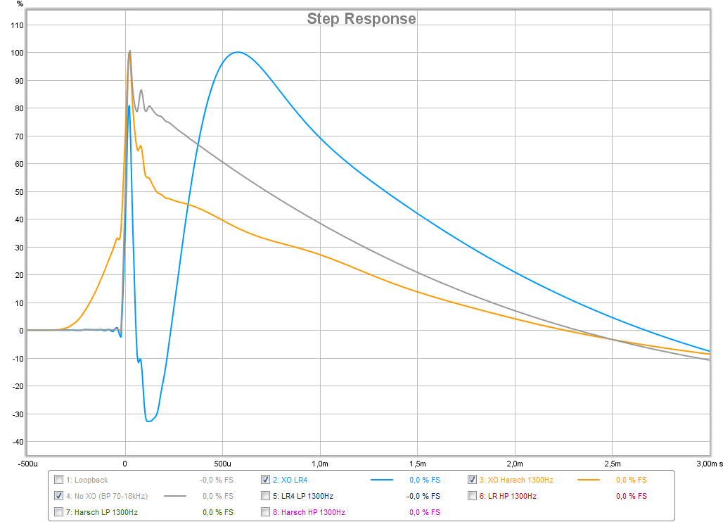

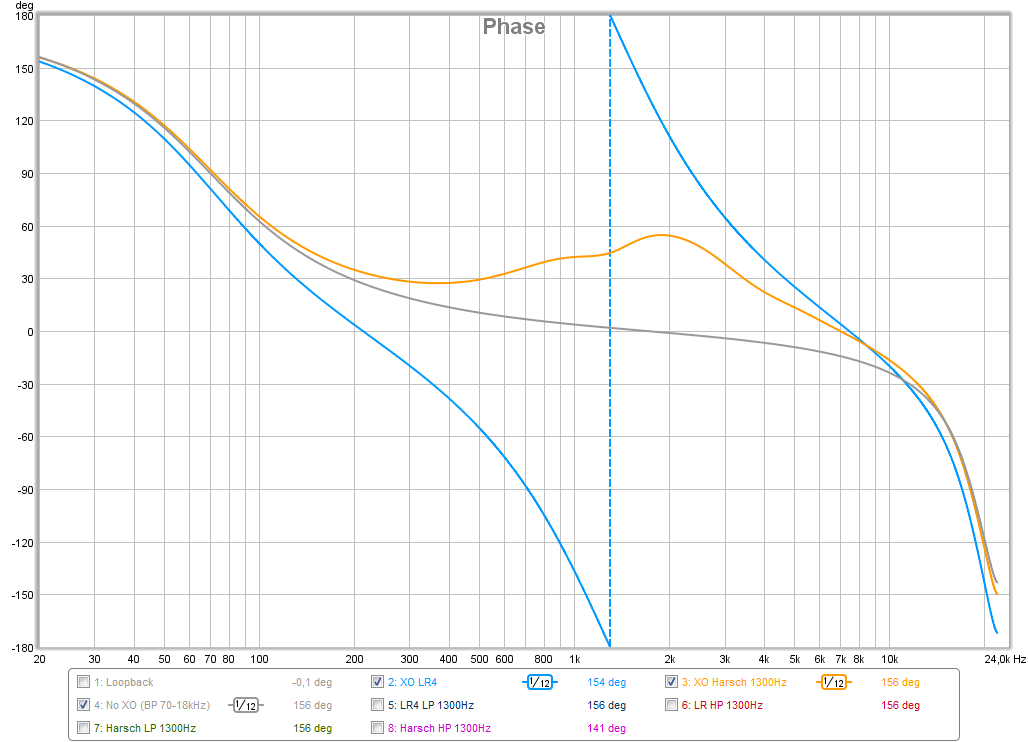

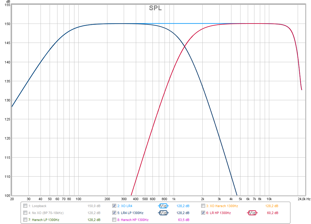

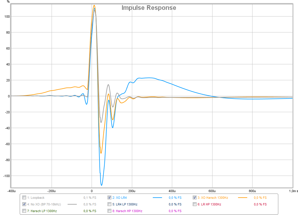

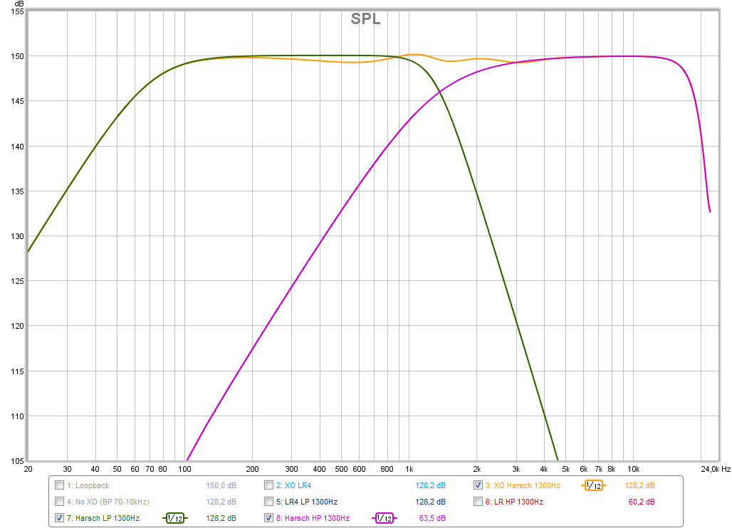

Hope below plots can help as target curves, these are made in JRivers digital DSP engine, soundcard then hardwired between analog I/O and REW can be made listening inside loop because of a genius JRiver virtual soundcard addition to sound system. System bandwidth are set with a BW2 HP at 70Hz and BW2 18kHz LP but the LP get steeper because of REW and soundcard bandwidth limit of 24kHz cut off. So they are real electric measured filters that you can use as ideal target curves your system should replicate in acoustic domain. Attach two frd files you can import to REW as visual target slope in "All SPL" or in "Overlays" window, these are normalized to 67dB at moment but just offset them to other SPL leves in REW is no problem. HP these plots is set the textbook 0,38mS (1/1300x0,5) delay, add or subtract to this setting to calibrate the physical acoustic offset at 1300Hz you probably have.
FR plots are 1300Hz Harsch and LR4 XO, IR/SR/Phase/GD are Harsch/LR4/Bandpass 70-18kHz with no XO.

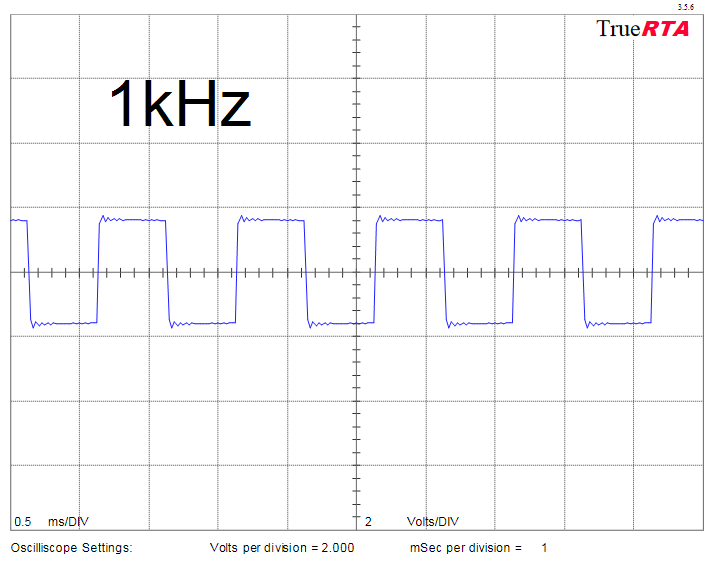

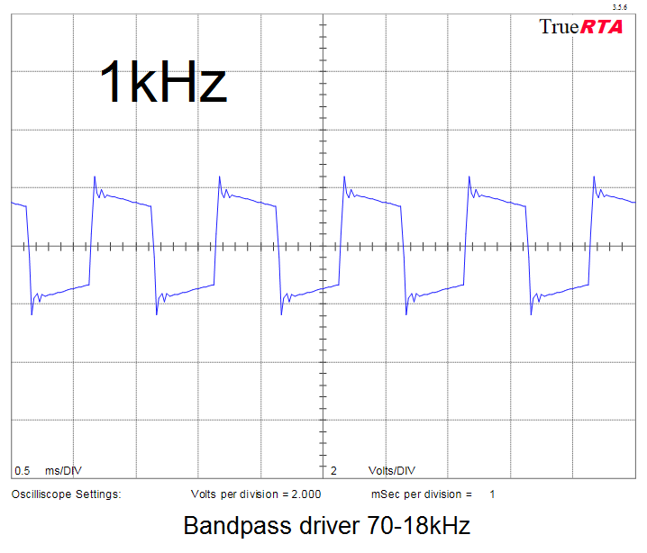

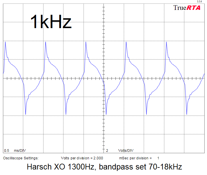

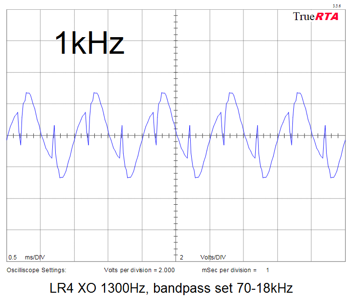

Square waves study for Harsch/LR4/Bandpass 70-18kHz with no XO/Soundcard loopback no filters.

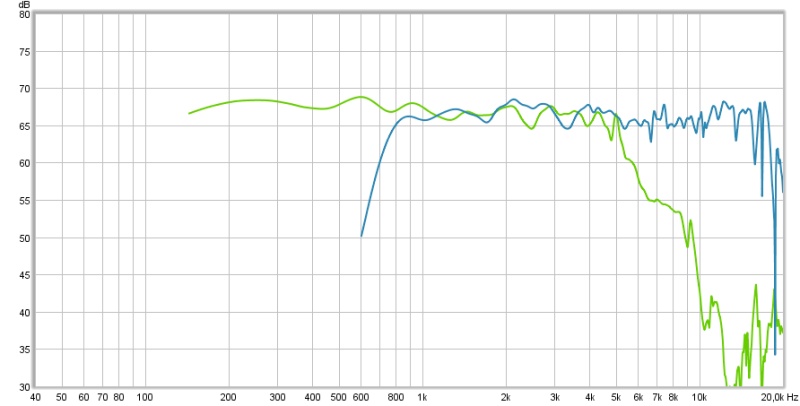

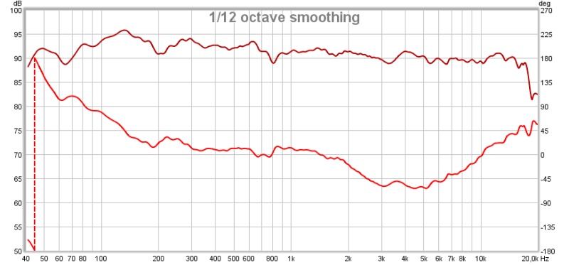

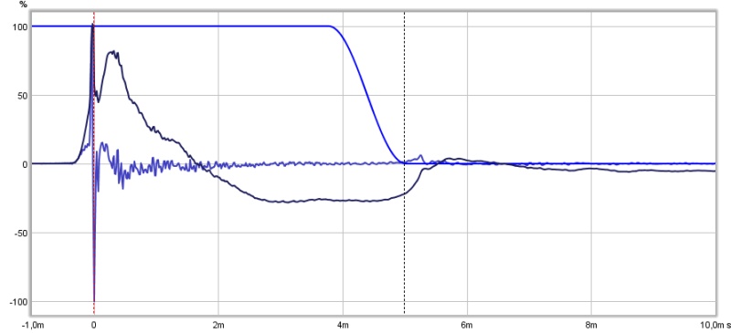

Now I get something that seems more reasonable, problem was to get a frequency response that is even at the same time as a good impulse response. The phase was shifting too much for the CD when using a 1300 Hz XO.
Here's a 1700 XO:
And a 2200 XO:

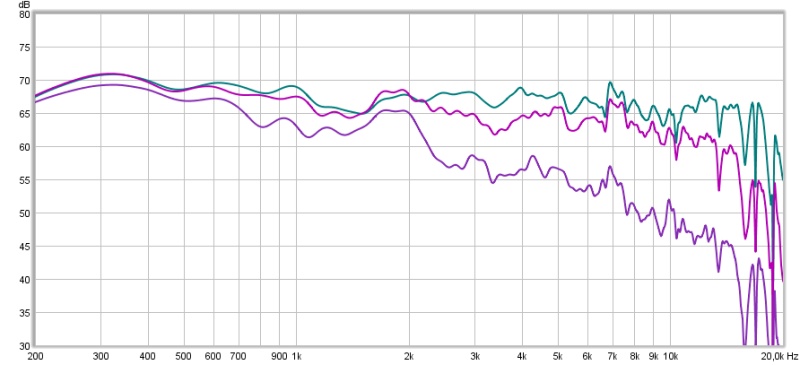

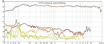

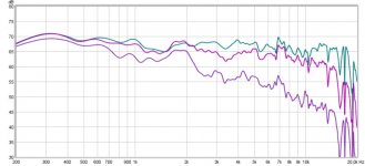

Horisontal polars (0, 30, 60 deg) for 2200 XO:

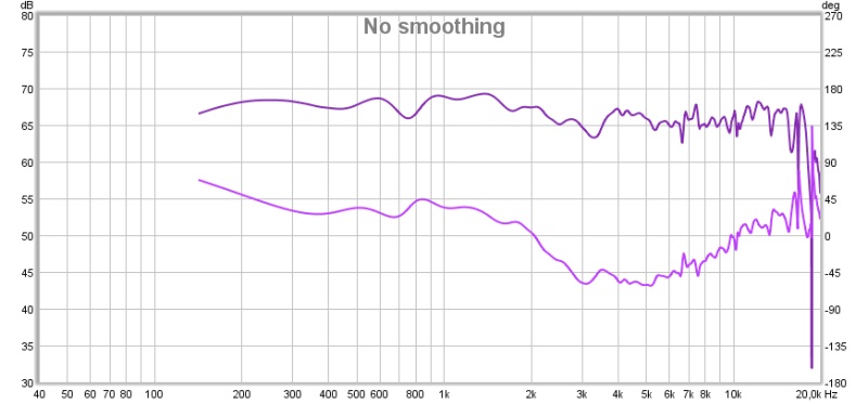

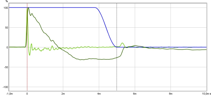

I feel like it's mainly the crappy impulse response of the CD that messes stuff up:
Raw.
Without HP. With PEQ.
With HP (1700) and PEQ.

That looks good. Glad you got it figured out. Check the throat transition from CD to waveguide. Make sure it is smooth - no overhanging lip or rough edges. That can cause the bumpy FR on the CD.
The tell tale sign you got it right is the combined dips a little below woofer only:
