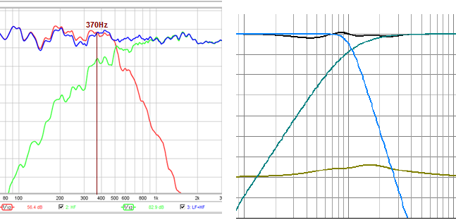

Hi X, if you aren't yet sure that the Harsch crossover traded off tonality for transient, then look at it like this...
From previous driver tests we have come to a conclusion that the main variable that contribute to tonality is the flatness of the frequency response. Now look at the ideal/theoretical response of the Harsch crossover, where there are "wiggles" above and (especially) below the crossover frequency.
There is phase "rotation/shift" around 370Hz. This is audible. Perfect total response is where both drivers contribute positively over certain wide bandwidth. It means, when the woofer pushes, the tweeter should also pushes. Visually, the summed response should be above both woofer response and tweeter response. In your LR2 we can see a perfect example where there are huge/wide overlap of such condition. This contributes to audible DETAIL / DYNAMIC RANGE.
To make the trade-off more reasonable for Harsch XO, the trick is then to move this "wiggles" to area where it is less audible. I would say to move this 370Hz point to no more than 300Hz (based on my own listening experience). Better if you can put it down to absolute 200Hz. This frequency number is based on study regarding human ears sensitivity to localization and what contribute to tonality.

Will point out that those wrigles are relative low Q with relative soft phase change curve, meaning less real world audioable resonance or non audioable for most.
I think the point is not the wrigles or the Q, but the phase change, or phase overlap between woofer and midrange/tweeter. I have paid attention to this (including the maximum frequency it is allowed to happen) as a criteria in crossover design since several years ago. It is some kind of "secret" for me (because I can relate it with the quality of my speakers).
Oh, BTW, I think X has mentioned how the Harsch didn't have phase (180deg) wrap. I'm not sure about this but I guess that phase wrap is okay as long as the response is linear. Harsch OTOH has that phase turn below XO point.

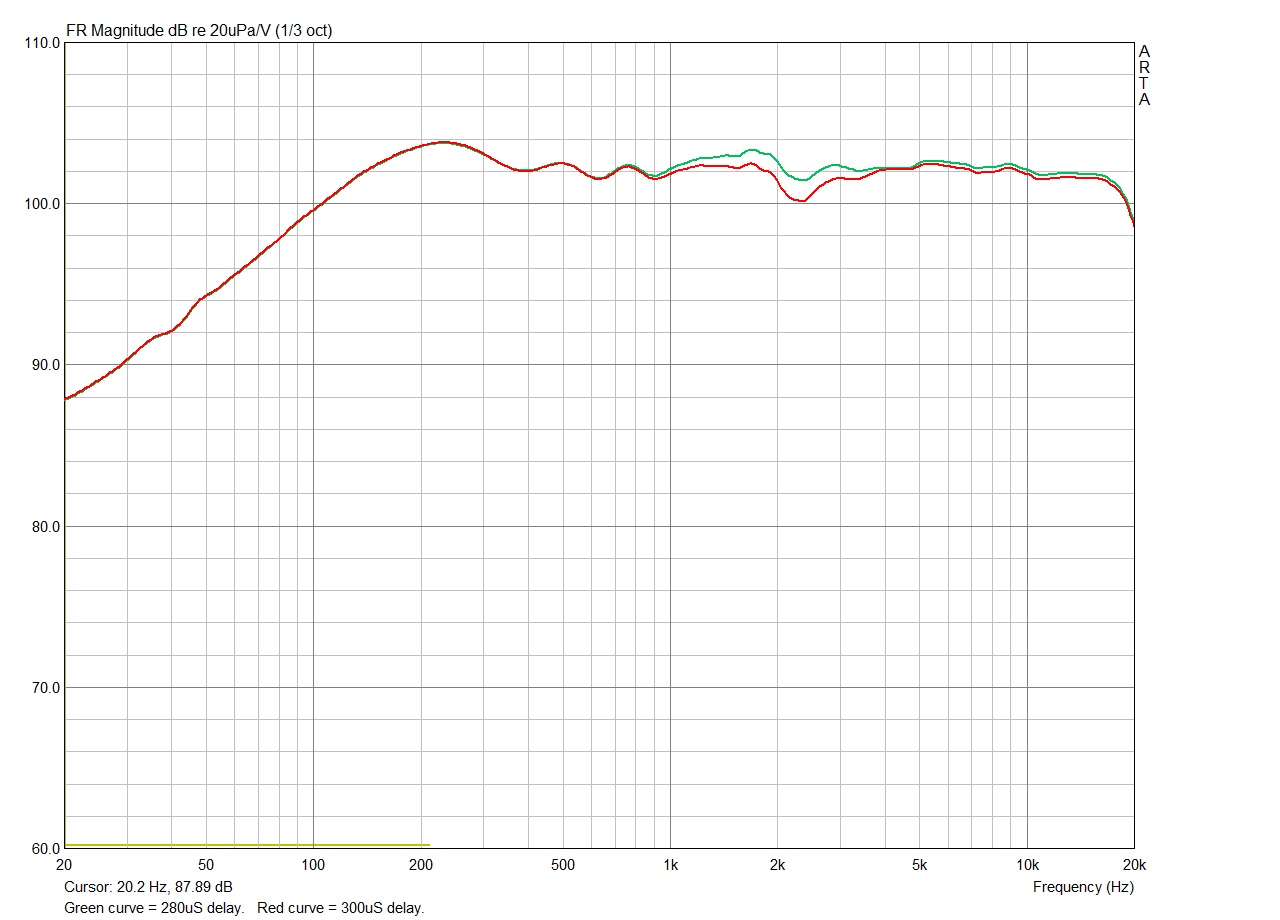

I recently finished construction of an MTM design using an old pair of Vifa M18WO-09-08 drivers together with a Vifa XT25TG30-04 mounted on a Pellegrene elliptical waveguide No 85125 in a Parts Express 1cf enclosure.
When I first started this project I had already decided to make this system active with a LR4 Xover implemented in a Minidsp since I’ve had significant success in the past with this device.
However, after having read about the S. Harsch Xover, I thought it might be interesting to try it out on my new MTM system, just to see what all the hype was about.
I started, as I normally do, by taking a 1m and nearfield response of the bass/mid-range driver and port together with a 1m response of the tweeter. I then constructed the target curves defined by S. Harsch and set about making the acoustic responses of the bass/mid-range driver and tweeter fit the target curves via the various biquads in the Minidsp.
The results are shown attached. The Xover frequency is set for 2KHz and I found that the flattest response was obtained with a tweeter delay of between 280uS and 300uS, which is reasonably close to the recommended 250uS for this Xover frequency. The measured step and group delay responses are also attached. I think the FR could be made flatter with 290uS, but the Minidsp can only increment 20uS steps (1/48KHz = 20.83uS)

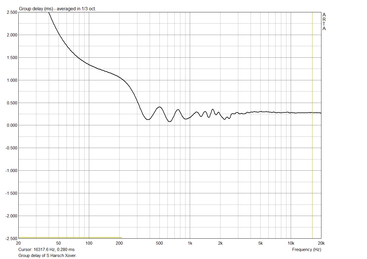

One of my observations was that the measured acoustic slope of the tweeter without the Xover is (predictably) only 12dB/Oct., which is the same slope as the target. So if the tweeter response is made to approximate the same slope as the target, there can’t be any attenuation at low frequencies.
In my system as described above, the response of the tweeter’s Xover, ie the voltage response across the tweeters terminals, takes the shape of an inverse Linkwitz Transform with only 19dB-20dB attenuation at all frequencies lower than 800Hz. This worries me because with a 100 watt amplifier driving the tweeter Xover, the tweeter will potentially have to handle 1watt of signal power at all frequencies below 800Hz ie, 5.6 Vp-p signals.
I suspect that this could cause significant amounts of IM distortion, which may not be masked by the low frequency signal.
This issue together with the substantial amount of overshoot it creates on square wave signals really limits its appeal to me.
Peter

Very informative results indeed. Agreed on the point about tweeter protection. A Harsch 2-way that's not FAST would require a very clean and robust tweeter that can go down low, which the XT25 isn't even with waveguide loading. I suspect a conventional dome with great low-end credentials would do better by allowing the Bessel to be dialed in as the tweeter's intrinsic roll-off would occur well into the stop band. Perhaps something like a waveguided SEAS 27TDFC/TBFCG or even Scan 6600. The large Heil AMTs would like do well too, being clean to 700Hz. Now that's a thought.

Thanks for trying this out - you did a fantastic job of matching it to the textbook curves and the final SR shows it. You might try flipping it around as Quip suggested with BW4 on tweeter and Bessel on woofer. Or maybe add an additional PEQ at somewhere below XO to help attenuate the tweeter some more. Great results though. How does it sound?
