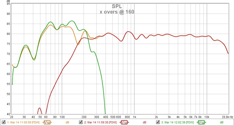

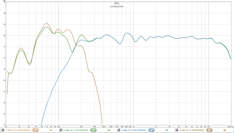

Crossover @ 160HP LR4 & 125LP LR4. I'm sure these should be corrected. Now if I could get some direction in Target filter choice for the full range drivers this will improve dramaticallyIi'll bet. Getting close to goosebumps.

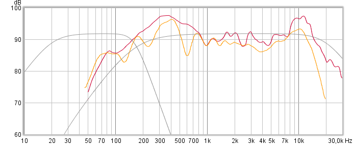

Thanks advises for measurements, from beginning its not worlds smoothest and maybe not a wish in this SLOB system, guess that is up to owners how much time offered to smooth it out in precision style of Barleywater, intend focus to get XO region acceptable for this exercise, below red trace is manufactures response times OB simulation in Edge and orange is what mkane77g had pages back.

I get that, however if one would EQ out a reflection at the measured spot, the result would never be right at the listening spot. The peaks/dips we see in the measurement look like floor bounce to me. If this is floor bounce at close measurement distance, it will hit somewhere else at the listening position. All that EQ for crossover perfection would be invalid.
Look at the IR, the Filtered IR, the wavelet and first find out what's happening. Solve that (even if it's only temporary) so you can make sure the speaker hands over to the next without the room or other boundaries being involved. Anechoic like measurement conditions for crossovers is why we measure up close. Raise the speaker if needed...
Yep, it is about fine-tuning delays. But you have really poor summation/attenuation despite slopes look symmetric. First switch polarity of either to see what happens, then start adjusting delay so that relative difference changes +/- 0.2ms per trial/measurement - make a series of 3-5 changes/measurements and then start tinkering! Reflections in the room make this very difficult...

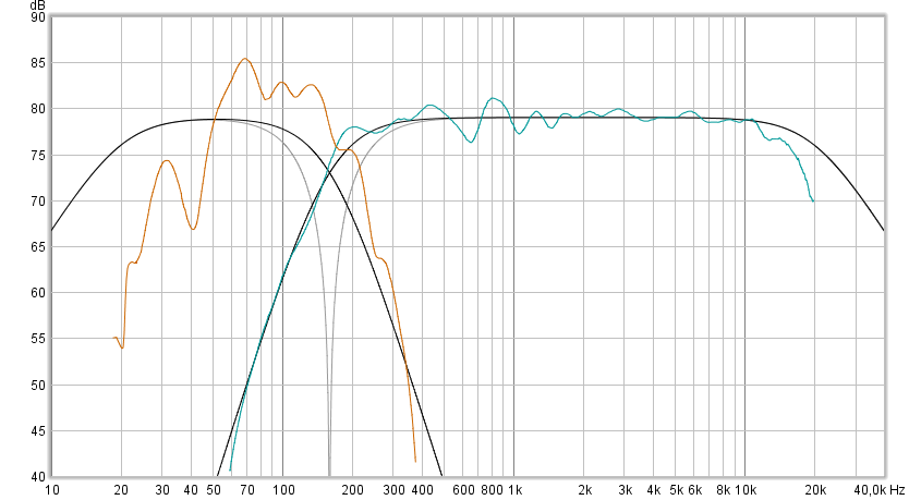

Yes if can trust we only measured direct sound and there no reflections from boundaries involved woofer should be corrected and if it has electric LP @125Hz LR4 in miniDSP then maybe try lower it to LP @80-100Hz LR2 or BW2. Is it possible you add target curves to published plots because it would be faster than each time have to scan curves here in the other end : )
Also if you have a cloud drive can you share sessions REW mdat-file and share a link public or via PM.

Not sure understand right maybe lack of native language, are you listenening to it now and it sound is close to goosebumbs or you need a new target for house curve : )
No matter how it sounds we ain't there even it should happen sound good, we need to have the two pass band right and get their SPL level in line plus found the deep such out when one driver have reversed polartity while delay for tweeter is upped in small steps.

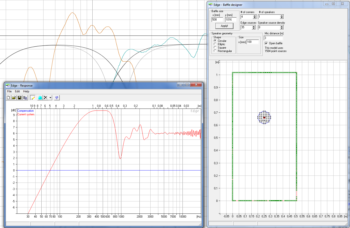

BYRTT, you simulated the Eikona in OB, what were the baffle dimensions, can you do same without crossover?

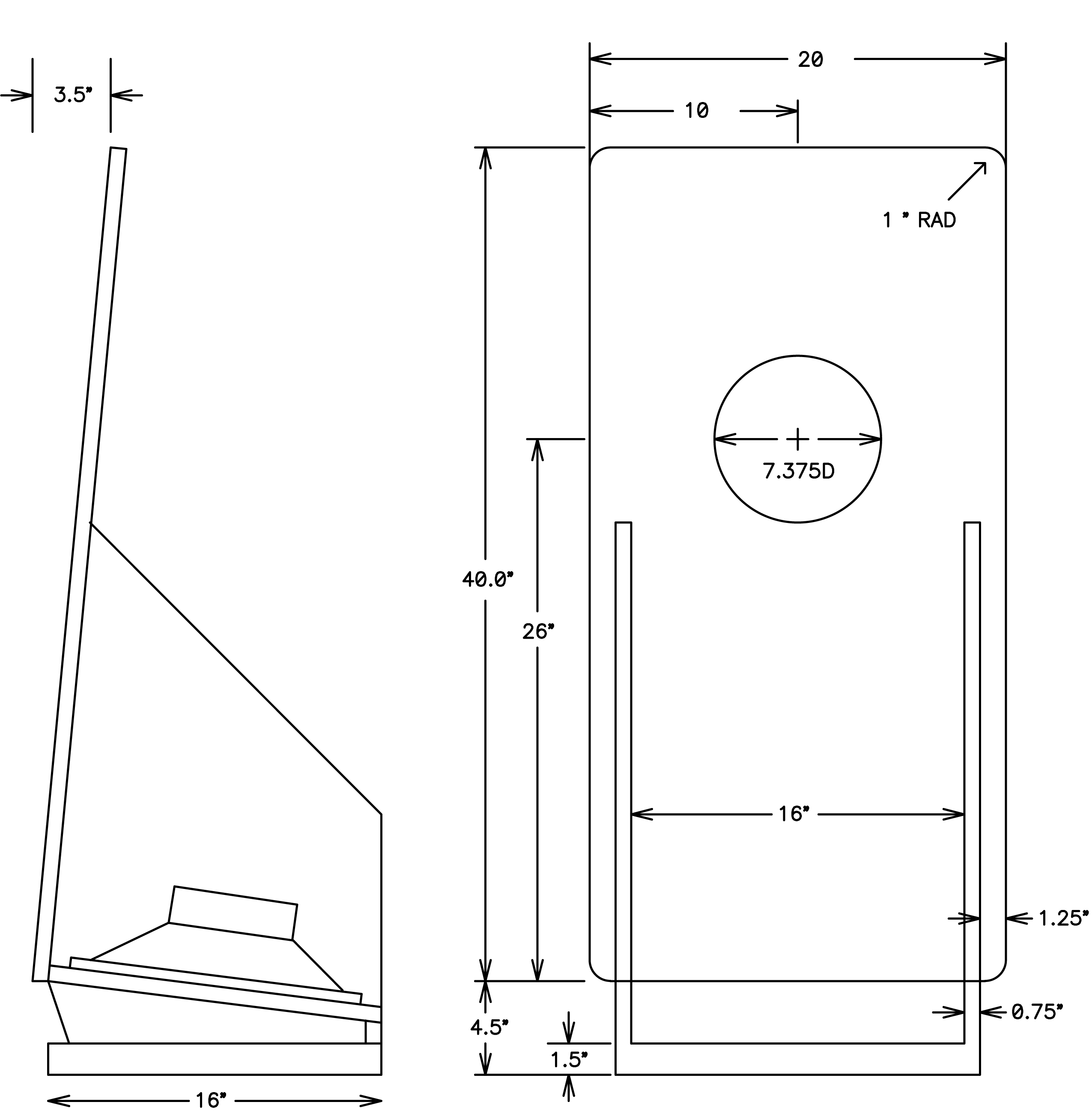

mkane77g shared a sketch pages back size numbers and BS plus diffraction is below, many curves had been looked at or manipulated down the road but pretty shure that red curve is nothing but a traced curve of manufactures website response that is commanded times exported file from Edge. Have never worked with OB and could see when ticked on in Edge diffraction was worse and roll off steeper than if driver had a say 3,5 liter sealed cavity behind same baffle, manufacture response without any baffle step loss looked close to cover a 80Hz BS2 roll off but live measurements and that simulation showed we had to up point of XO frq.

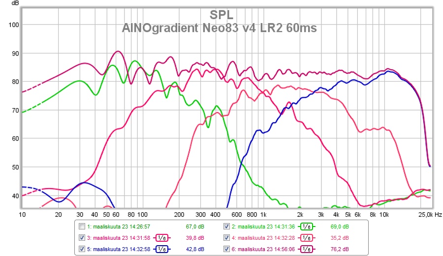

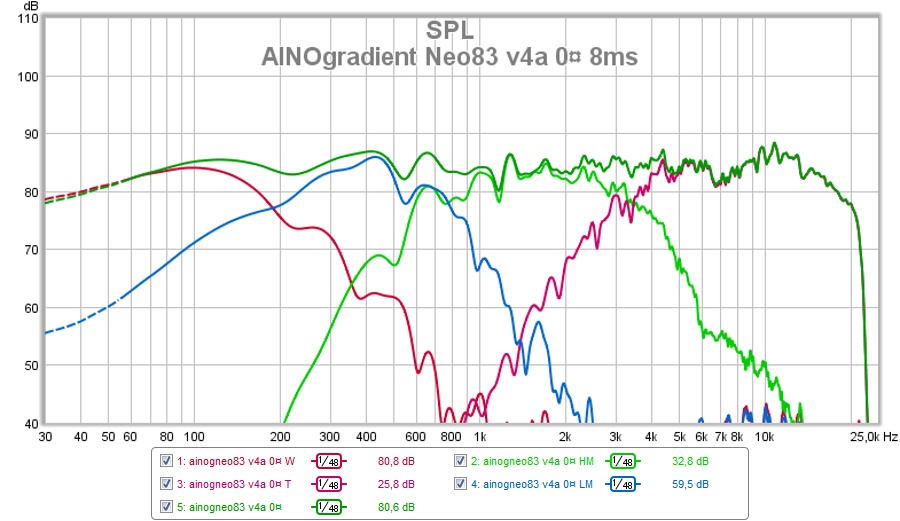

Low freq LR2 in-room should look something like this (8/60ms right window)
Mkane77g, you don't get summation at all, relative delay is almost 180 deg wrong. Please remember that with OBs very often the reflected sound from front wall is louder than direct sound, and REW picks up the loudest signal...
