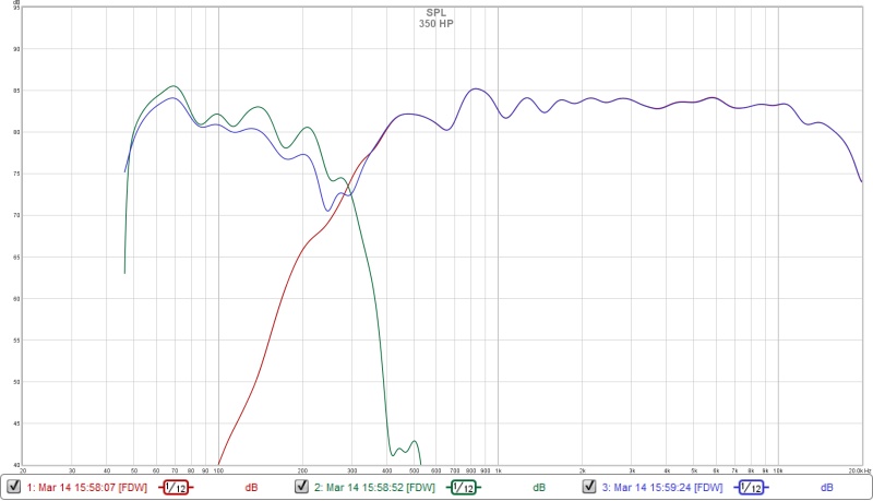

Use the REW EQ tab to implement the correct filters and then upload curves to miniDSP. Read up on that functionality. You can do it with 2-5 measurements with the proper technique.
And please move up away from 100Hz XO. That’s a bad spot from distortion standpoint and time delay standpoint. Try 350Hz. Move lower once you know how to do it. You can’t get BS2 on Eikona at 100Hz because it has natural falloff that will not allow you to implant a BS2 falloff.

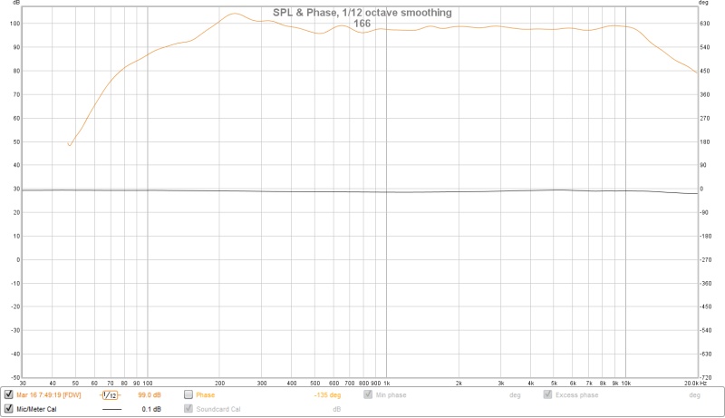

Nope, this is the result of a REW sweep of the left and right channel simultaneously at the listening spot after DSP correction.
There wouldn't be a whole lot of difference if I took a minimum phase version of the impulse. For all practical purposes it would look almost identical.
This would not have been possible without damping panels, but you guys, measuring up close should mind the reflections you get. To get the crossover right you have to keep the reflections out of the measured signal.
Place speaker in the middle of the room, same for the microphone, remove clutter around it and use 6 cycles of frequency dependent windows. If needed, place something absorbent between the mic and speaker position on the floor. You have to avoid the reflections to get a useful crossover.
I see way too many peaks and dips in these graphs...
That's because I am measuring at the listening spot with both speakers running. I did measure at 80cm once to try, but the result sitting at the listening spot was not so great.
This time around, I tried to do it all with speakers at their place, and mic at the couch, ear level. It sounded better than anything else I tried.
That means that yes, room is taken into account with this. And speakers are tailored to this room only.

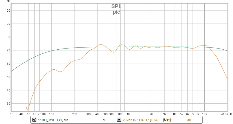

You can't boost a null, your IR probably shows a reflection causing the dip.
You can pump in any amount of boost you'd like, all that does is raise distortion.
Look at a distortion graph with the measurement without boost at that dip and with.
You'll see the distortion rise. It's better to figure out what the cause is of that reflection, and cure that for the crossover process, it doesn't have to be anything permanent.
Look at it like this, speaker is putting out 80 dB SPL, the reflection eats 20 dB from that, due to it's phase being opposite of the speaker signal, right there at the microphone. Now raise the SPL level by 5 dB, all that does is raise the reflected level by 5 dB as well. You may see it creep up just a little bit, but no where near as fast as the level of boost you apply. And at a slightly different spot, just a bit closer or further away you will have a peak because the reflection will have moved. Again, this is the primary reason to avoid reflections in these crossover measurements.
Thanks. That's exactly what happens. Boost just raises the entire dip. this measure is taken on Fr driver only, no x overinvolved. Beem messing with Eq all day and it's darn hard to figure what needs what without affecting something else. All good after a few whiskeys though.

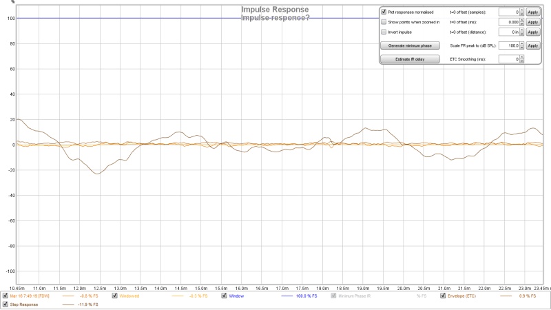

You can see it in the IR, if you zoom in on the first ~ 15 ms. You should see a single clear peak with that fullrange, some wiggles directly after that maybe (depending on the driver) but it should look reasonably clean after that, every peak after that big one has a cause. The bigger the peak (or a cluster of little peaks) the more it will eat away from the FR curve you want.
To get a great crossover, you shouldn't have any big peaks after that main one. And big being relative. If you select the [v] STEP as well on the IR graph in REW, you'll see a sudden change of direction there as well. That's your room and everything in it.

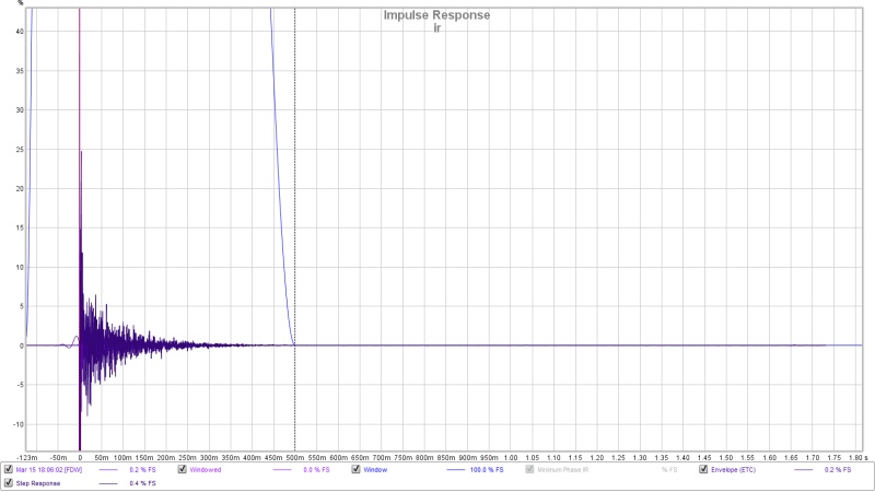

I do and I'll go over it again, this time with a fine tooth comb. I've got to finish making dinner for my wife. Hope it rains all day again tomorrow thanks again.Remember me linking this from your miniDSP thread? Why Can't I Fix All my Acoustic Problems with EQ?
ir ...................................
Look at the time scale on the bottom, see how it starts in ms? Now zoom in so you get that first peak, and have the scale on the bottom display out to 15 ms. Right now we see all of it, we only want to look at the start.
You can click on the controls (upper right button) and have it set to: Plot responses normalised. Next to that there's a limits button, there you can set the scale you want to display.
Set Left s to -0,002 and right s to 0,015, if you have normalised active set % top to 110,0 and % bottom to -110,0 (for now) and press Apply Settings.
